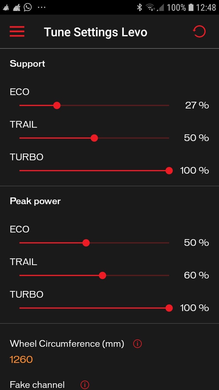

So if I increase in BLEvo speed limit from 25 to 30 kmph for example and than turn off BLEvo, turn on Mission Control and start ride in MC I will have still 30 kmph speed limit?
Yes that is correct
You will see that your wheel size in MC has changed to a smaller circumference (depending on what version of MC you are running)
Yes that is correct

I have one more question. In such situacion MC will not show distance correctly. But will it show burned calories correctly. Thats the only reason why I want to use MC and not BLEvo during riding (BLEvo does not show burned calories / wats during a period of time).
I suspect not but to be honest I do not know how MC calculates burned calories data.
But will Specialized know? Especially if it is changed back before you take the bike to the shop for whatever reason? Surely setting the limit to 32Kph the same as USA should not effect the life of the motor/battery ect as I assume they must test it at this speed for US riders?
My understanding is they do not log anything on the older version of MC. If you change it back before a shop visit no one will know.
However, I am not sure about what is logged on the latest version of MC which came out last week.
I think it takes data from engine power meter. BLEvo shows legs’ watts but only at the moment. Probaly from the same source as MC. Maybe @PaoloBLEvo knows if MC shows correct calories after changing wheel size.

Yes. But if you change wheel circumference in order to change speed limit will Motion Control calculate burned calories corrrctly?
To be honest I don't know how MC calculates the burned calories.. In BLEvo I use only biker Wh and the wheel size is not important.
