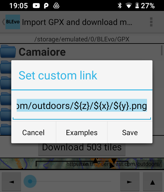

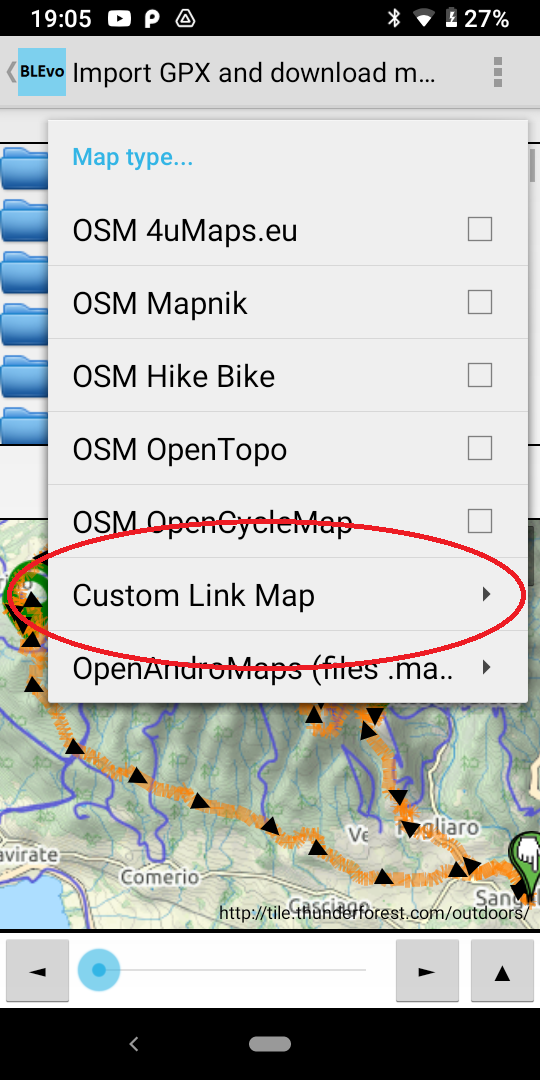

In this new version I have added the link configuration for maps. In this way everyone can put the maps they want as long as they are compatible with the format specified by open street map.
Here you can see some examples of the links
OpenStreetMap Wiki wiki.openstreetmap.org

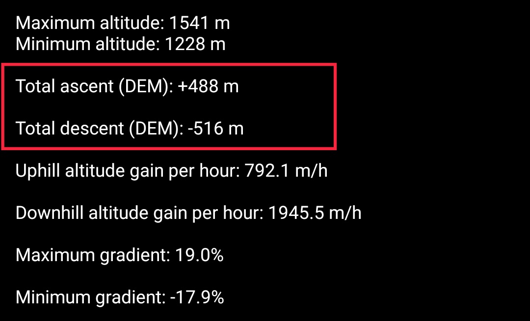

- Added maps with customizable links
- Correct ascent calculation with DEM
- Fixed display of the tour map with invalid values

Trying to use this map - Israel Hiking Map
It is a local map based on OpenStreetMap, but I don't get anything in the app.
I typed the following text in the link box: "https://israelhiking.osm.org.il/Hebrew/Tiles/${z}/${x}/${y}.png", which is the map link used in my OruxMaps app and works well. I also tried to input some x,y,z values but it did not work as well.
What am I doing wrong here?

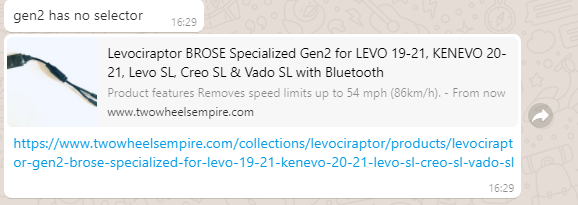

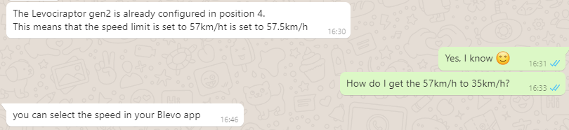

@PaoloBLEvo Thanks for the fast answer, but not an answer to my question. According to 2wheelsempire, the manufacturer of the Levociraptor, you can not change the selector on the Levociraptor GEN2 - it is always on 4. See below the picture from the communication. This seems very strange to me.
I do not want my speed limit at 57,5km/h. I want it at +/- 35km/h. Is this possible?
Sure you can..
You should use the BLEvociraptor app or BLEvo to change the speed limit..
Please check the documentation on www.levociraptor.com

I'm having trouble loading this map - Israel Hiking Map (based on OpenStreetMap).
Could you please help and see what is wrong?

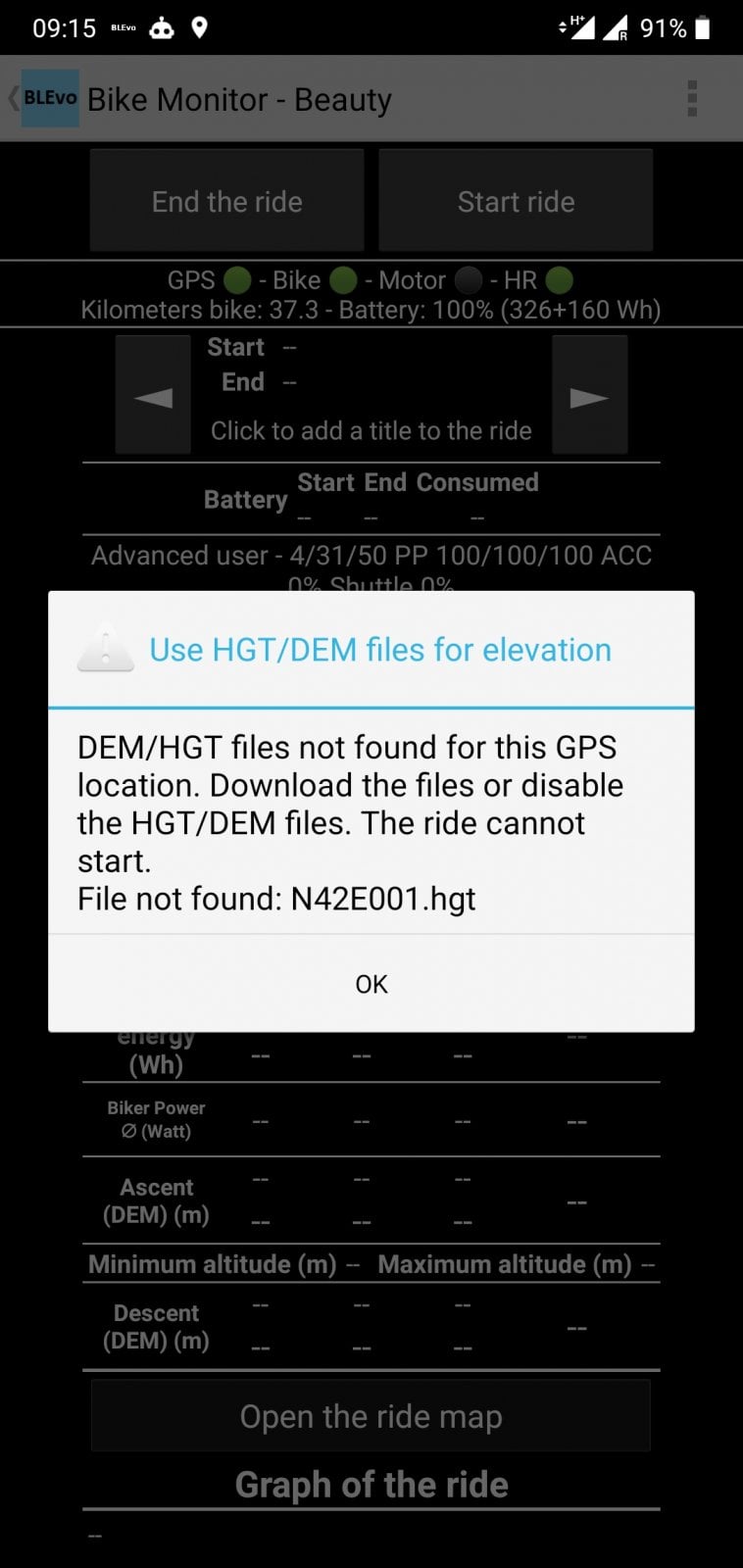

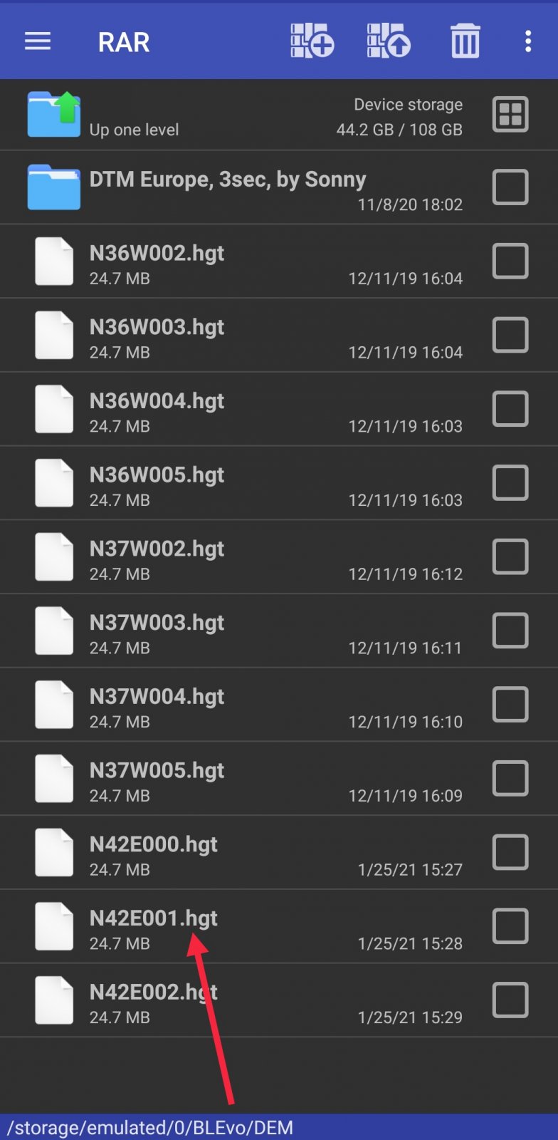

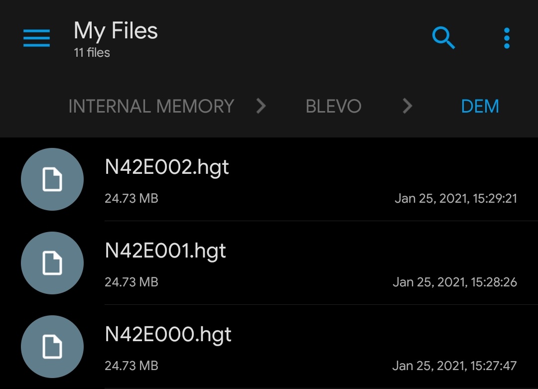

When I start a ride on my Creo I get the message " "DEM/HGT files not found for this GPS".
But the files IS present in the /Blevo/DEM folder !
What am I missing ?
Thanks.
Absolutely 100% - the screenshot is from RAR file manager but here you have another...
BTW...today it happened again !

I checked the link.. Are you sure that the link you provide follow the rules for tiles server?
I saw that if you try something like that
it doesn't work.
May be the link is not correct.. or the server doesn't handle the tiles like the library wants.

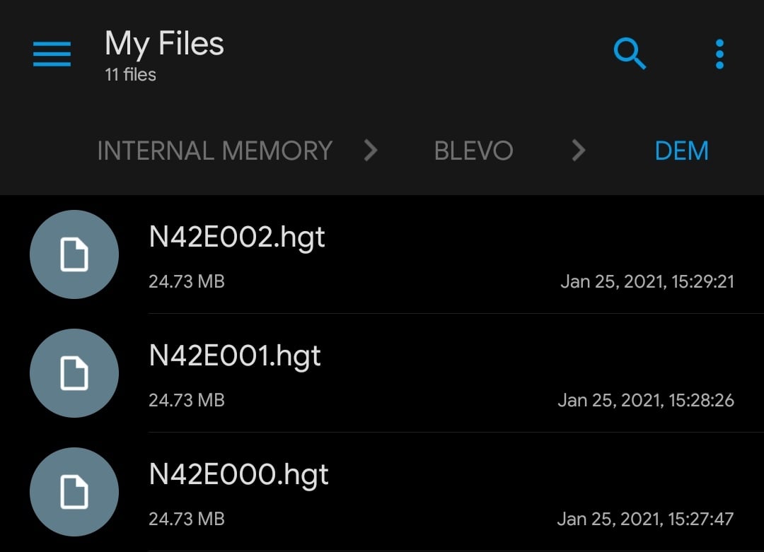

Paolo, I get the error message but the second time the ride starts without changing settings.
Check the screenshot : it has DEM numbers.
Does that mean it works ?
My phone is a OnePlus 6
Blevo runs with all permissions and no battery optimization.

Very very strange.. which phone you have?
But do you receive this message only one time? If you retry to start the ride starts?
The same thing happened to me, but then it allowed to start the route. After installing Levociraptor I disabled the DEM height in settings and now I use GPS height + barometer.
it doesn't work.
I got it working.
Contacted IHM developer and got a working link to use. BLISS! :)
