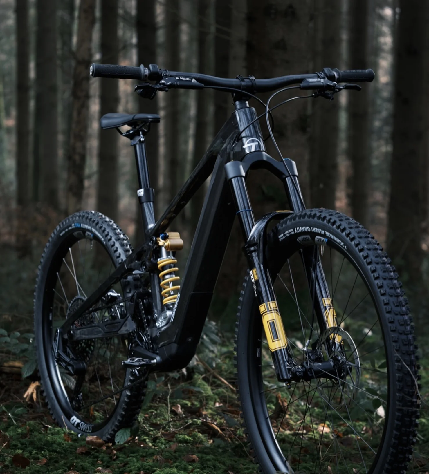

We just ordered one for my wife at our local Thömus dealer. Every bike is custom. All details are specified by the customer. Even just configuring the bike is a wonderful experience.
How did you spec it? Enjoy it!

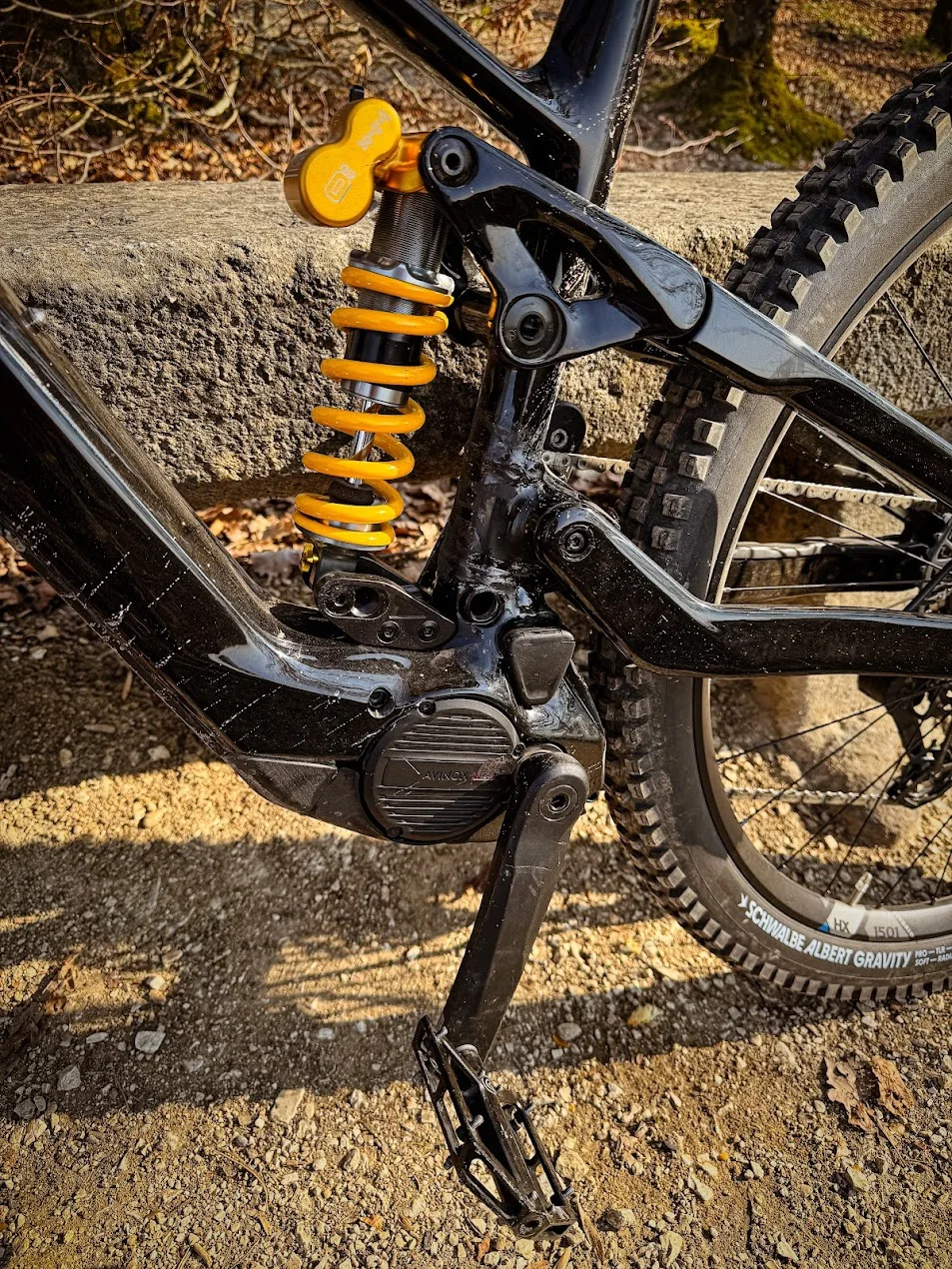

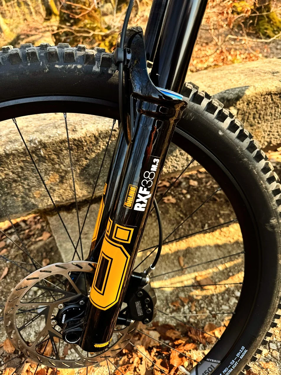

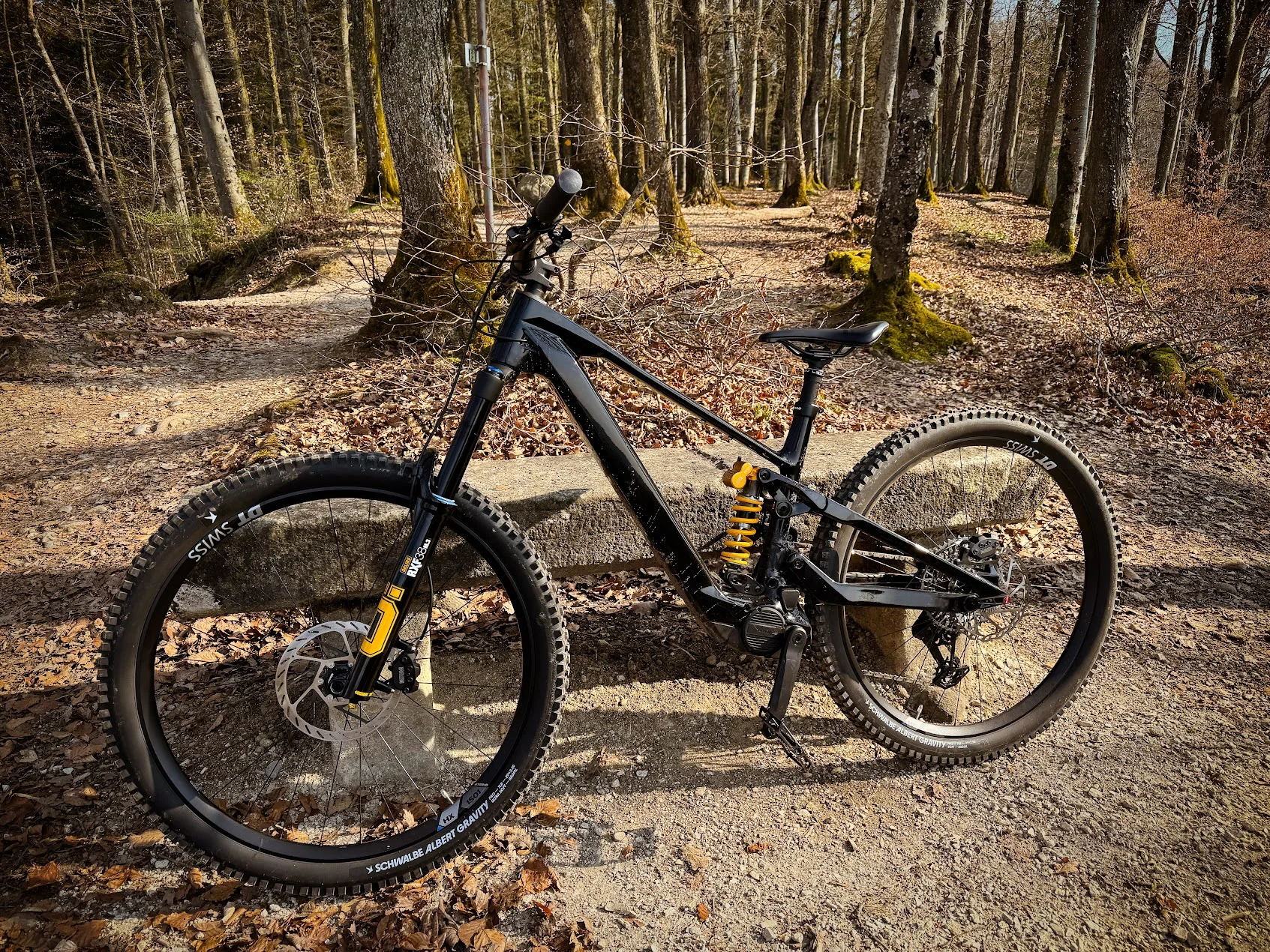

I rode the Oberrider LT today for about 1.5 hours – the 29/29 LT version in size M with the 800 Wh battery, weighing around 23.5 kg, fitted with Albert Radial tires. Normally I ride a Levo SL 29/27.5, size S3, with a Lyrik / Vivid Ultimate setup, Magura 220 mm brakes, weighing 19.6 kg, also on Albert Radials.
First impression: the bike feels great. The Öhlins suspension is on the firmer side, but not uncomfortable at all. The setup was already quite close, although of course it was still a test bike.
Uphill, the power is insane – no surprise there. Shifting almost feels optional :D. I rode it on my home trails, so I know those sections very well.
The bike felt very stable, although not quite as agile as the Levo SL. The rear suspension worked almost unnoticed, which I’d say is a very good sign. Same for the high pivot: in corners and under braking, the bike stayed active and composed.
On my favourite trail (+100times ridden), my PB on the Levo SL is 1:07. In a direct back-to-back comparison, I did a 1:09 on the Oberrider, and overall I really liked it. With the right component choice, the Oberrider seems very versatile and capable of adapting to different needs – from a relatively lightweight build at around 20 kg to a full top-end enduro setup at around 24 kg.
I had never ridden a DJI-powered bike before, but I’ve owned a Levo Gen 2 and now a Levo SL, so I had a pretty good idea of what to expect. Still, I was surprised. I only rode it on trails and mostly in full blast mode, but honestly, the difference to the even higher support modes seems irrelevant to me. I’m 95 kg, and in full blast mode I used around 45% battery in one hour with 600 vertical metres. To be fair, I was also pretty cooked uphill – DJI really redefines uphill flow. The motor power feels very good and controllable. With just three crank rotations, you’re already at 25 km/h.
One downside I noticed is the battery swap. To change the battery, you have to remove the motor, so the idea of buying both the 600 Wh and 800 Wh battery combo loses a lot of appeal. And with no DJI range extender clearly on the horizon, that may remain a limitation.
For me, this is definitely a bike worth considering as a true 2-in-1 option:
With a lightweight build using the 600 Wh battery and something like a Fox 36 / Vivid Ultimate setup, you could end up right around 20.5 kg and still have enough range for a 2000 hm tour or 1.5 hours of full-blast riding at home.
Best of both worlds.

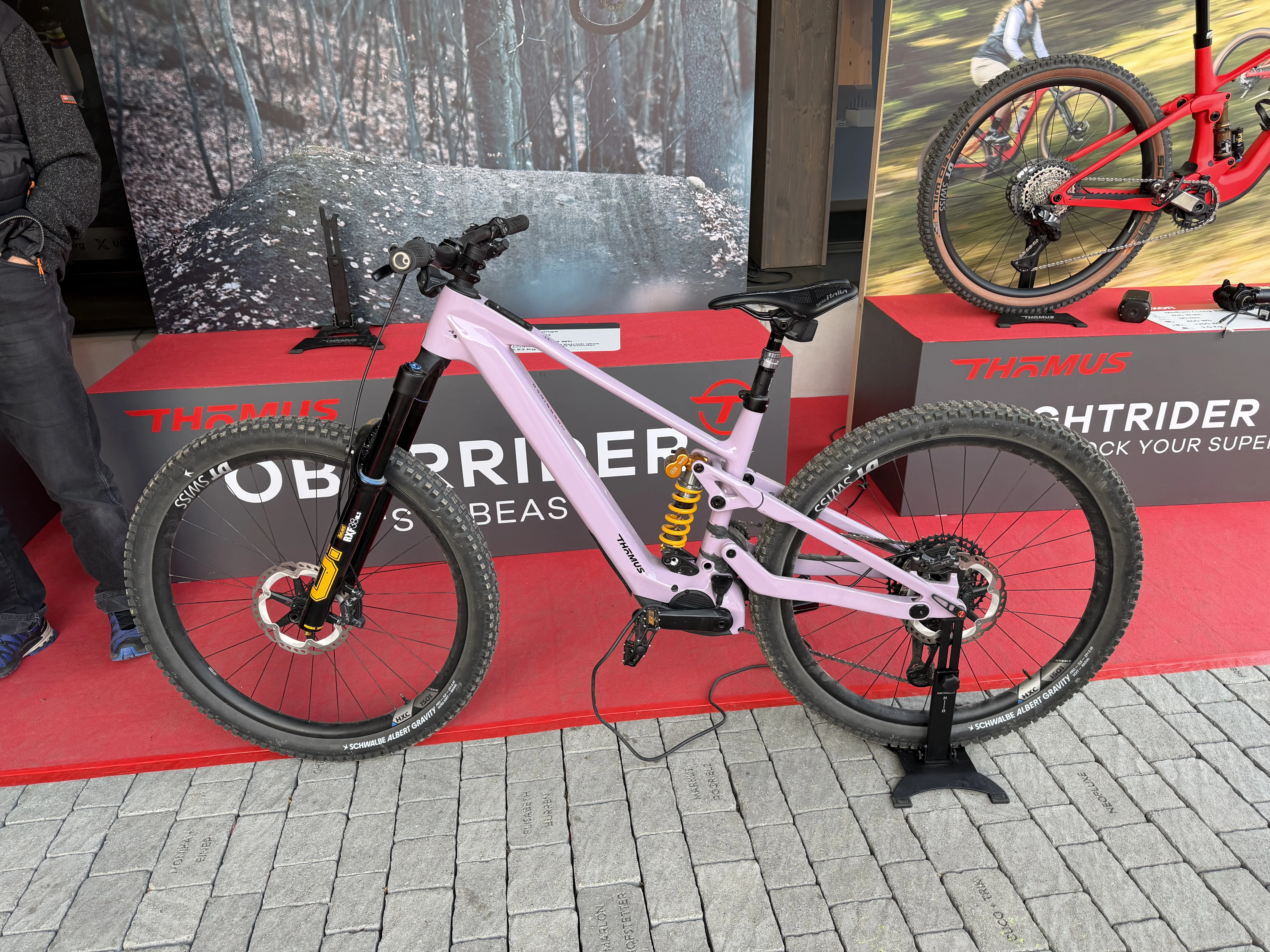

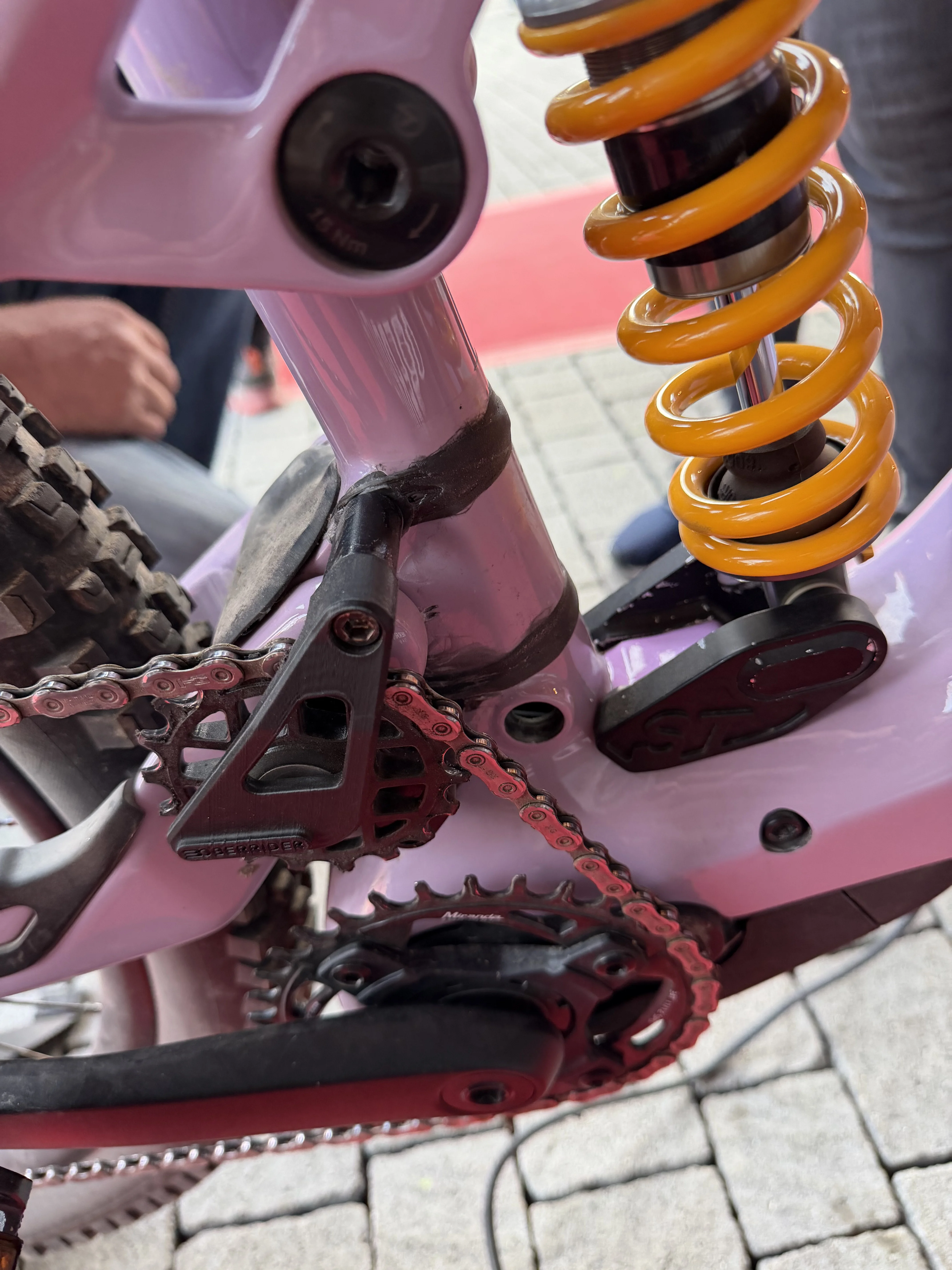

Is that the new motor? It's got a heavy chamfer around the housing on the non drive side
Looks like it's been leaked by Megamo.
Post in thread 'Avinox M2' https://www.emtbforums.com/threads/avinox-m2.44718/post-670336
I guess if it's your first ride you can't compare it to the old M1.

yes itßs the new one the guy from the shop tould me, but no specs
What is with all the leaked M2 bike pics that there are no pics from the transmission side? Where there a bash guard on the bike? If so, how was it mounted?

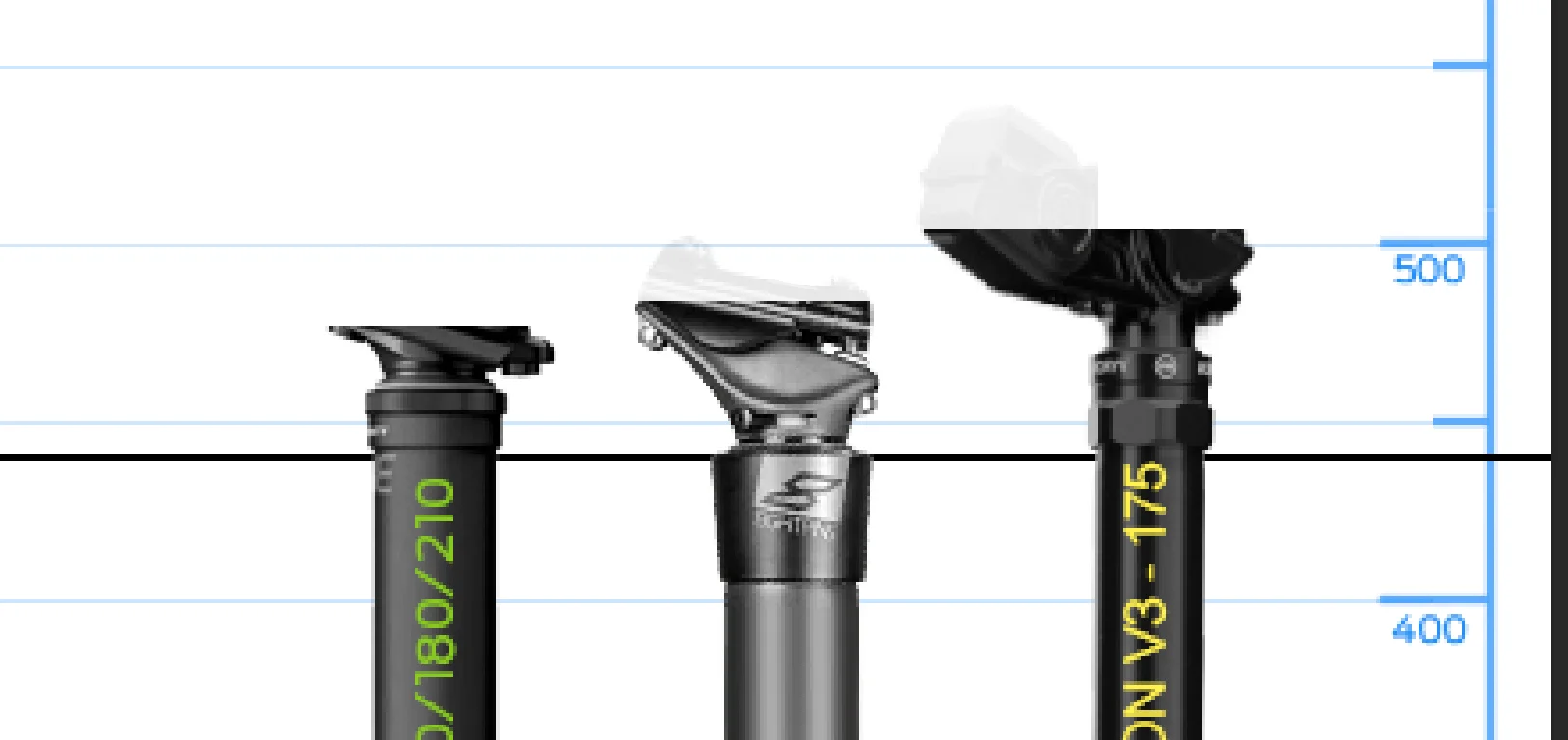

Pretty sure the seat tube thing must be length to top of eightpins collar as it is more or less flush to the actual seat tube. So potentially a saving of at least 25mm over running a conventional dropper. Based on my current bike that means for me at almost 6 foot I could happily run the Eightpins with 205mm of drop.
It all depends on the dropper really... With a 440mm seat tube, my OneUp dropper would put the seat rails at about 475mm, but the Eightpins will be 485mm as it has a very tall seat clamp. So for me this would actually be akin to having a 450mm seat tube, which is really the only reason for me not buying it, but it is a big reason.
I do like lots of ballsack clearance for bike parks, and I probably have short legs. On the Medium Oberrider, it looks like there would be over 300mm of uninterrupted seat tube, so plenty of scope to make it shorter.
This image shows OneUp, Eightpins, and Magura Vyron v3 droppers (cut off at seat rail height) on a 440mm seat tube...
