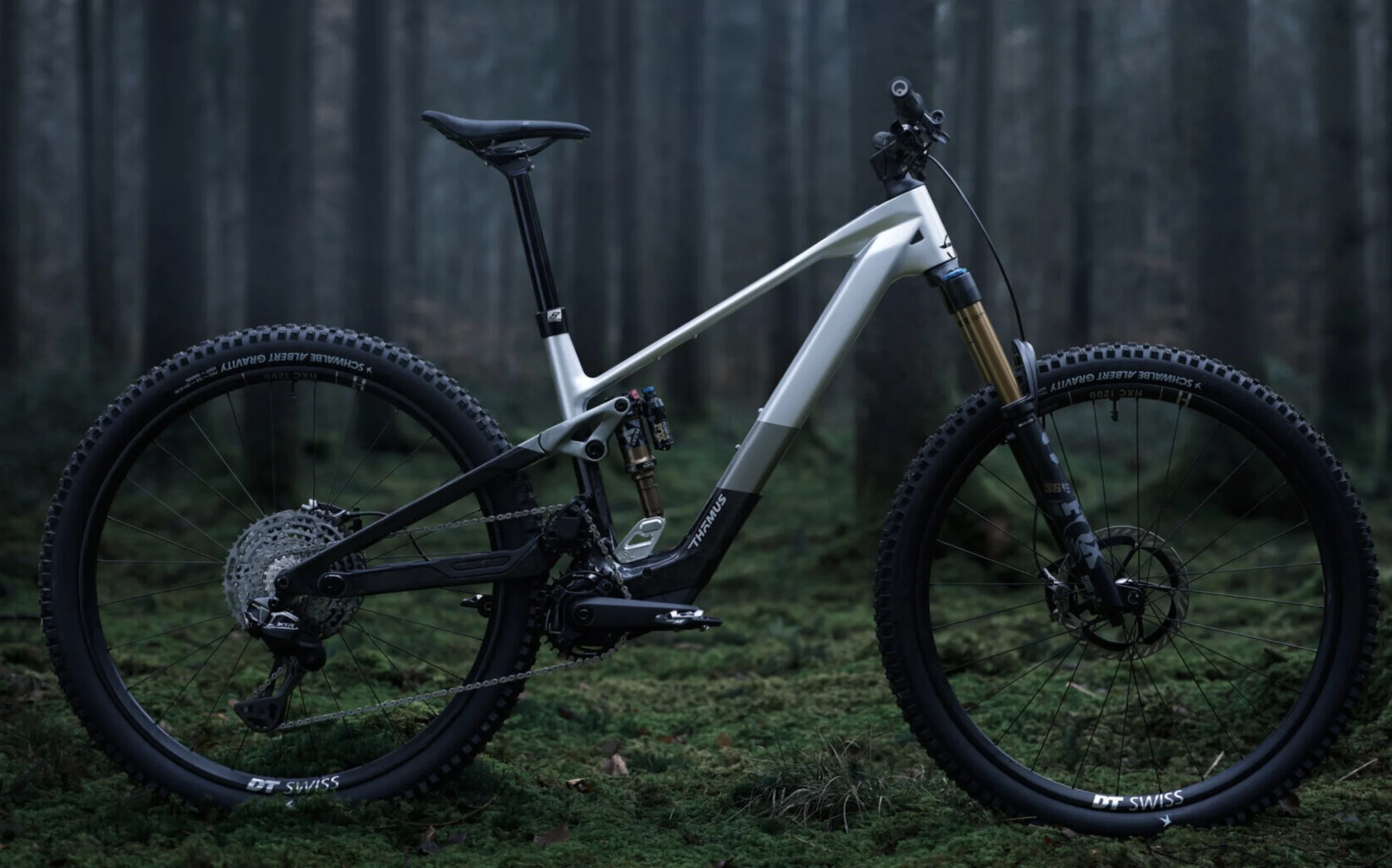

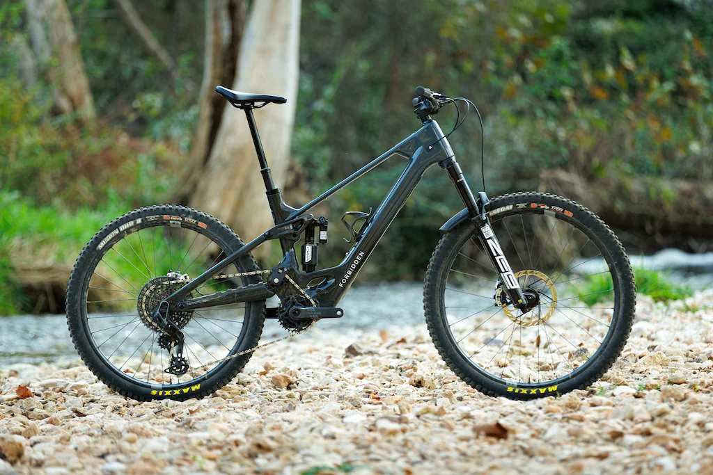

To do proportional (or size specific) rear centers without making rear frame components unique, the front triangles for each size are just designed with the pivot points further rearward with each increasing size. Same parts and kinematics just mounted further back.
Forbidden does this:
I have a hunch now looking at this that the reason the winning Trek / Norco / Velduro HP design always seems to share rear centers across the size range is that the shock is mounted in front of the seat tube so can't shift rearward per above. Forbidden uses a shock tunnel, so shock can just move further back down the tunnel.
In order for it to work with the Trek / Norco / Velduro HP design the S size would need to mount the shock awkwardly forward of the seat tube such that in the XL it was right up against it. That may not be possible from a packaging standpoint.
Hold on... the Forbidden DOES use a vertically mounted shock. So they made different rear triangles for all sizes?
Oh hey there you go - I was only thinking of their dreadnought/druid muscle bikes cause that's what I've got.
I'm guessing the answer is that they've got the same rear ends somehow but you'd have to overlay the different sizes.

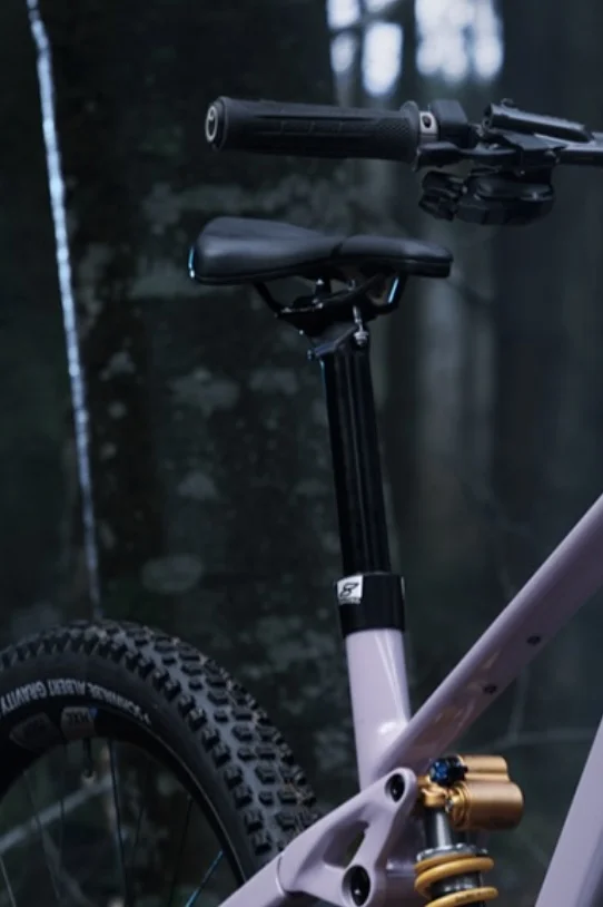

I don't know a ton about the EightPins dropper that can be seen in the video on the Thomas, but I think that it has a short stack length and always drops all of the way down so that might make up for the 470mm STL.
I have longer seat tube with EightPins too and it is ok: frame L, inseam 84cm, seat tube 475mm, cranks 165mm -> EightPins NGS3.0 188mm real travel. But it's true that with a shorter seat tube, I could have up to 210 mm of travel.
Nah, its down to cost of multiple molds and having to rework kinematics on each chainstay lengths.
Simply put, it costs a lot less to run one chainstay length across.
Plus the outer lying sizes represent fuck all of the sales. So they make the rear end to loosely suit m and l and every other size can get fucked rc:fc ratios.
Nailed 2, 3 and 4 :p . Except you forgot that we are the masters of concatenated words (I'm German btw).
Donaudampfschifffahrtskapitänsmütze is a totally valid word.
i own a Eierschalensollbruchstellenverursacher
Agree 100% with your last point. That is definitely happening.
But if rear end parts are the same and the only unique part is the front triangle for each size that moves the rear end attachment points further aft for each bigger size, then you don't need a reworked kinematic or additional molds.
Actual chainstays stay the same, but get moved further back away from BB via offset attachment points. Shock & links moving with them.
That is my understanding of how forbidden are doing it (their pedal bikes at least)
Seat tube length is a deal breaker: 396 mm on small, 440 on medium, 470 on large. The seat tubes would fit well on the next size up (e.g. 400mm is good for medium, 440 large...).
Yeh, I'm a bit puzzled by it, almost like a typo. The rest of it seems so well thought out
Pretty sure the seat tube thing must be length to top of eightpins collar as it is more or less flush to the actual seat tube. So potentially a saving of at least 25mm over running a conventional dropper. Based on my current bike that means for me at almost 6 foot I could happily run the Eightpins with 205mm of drop.

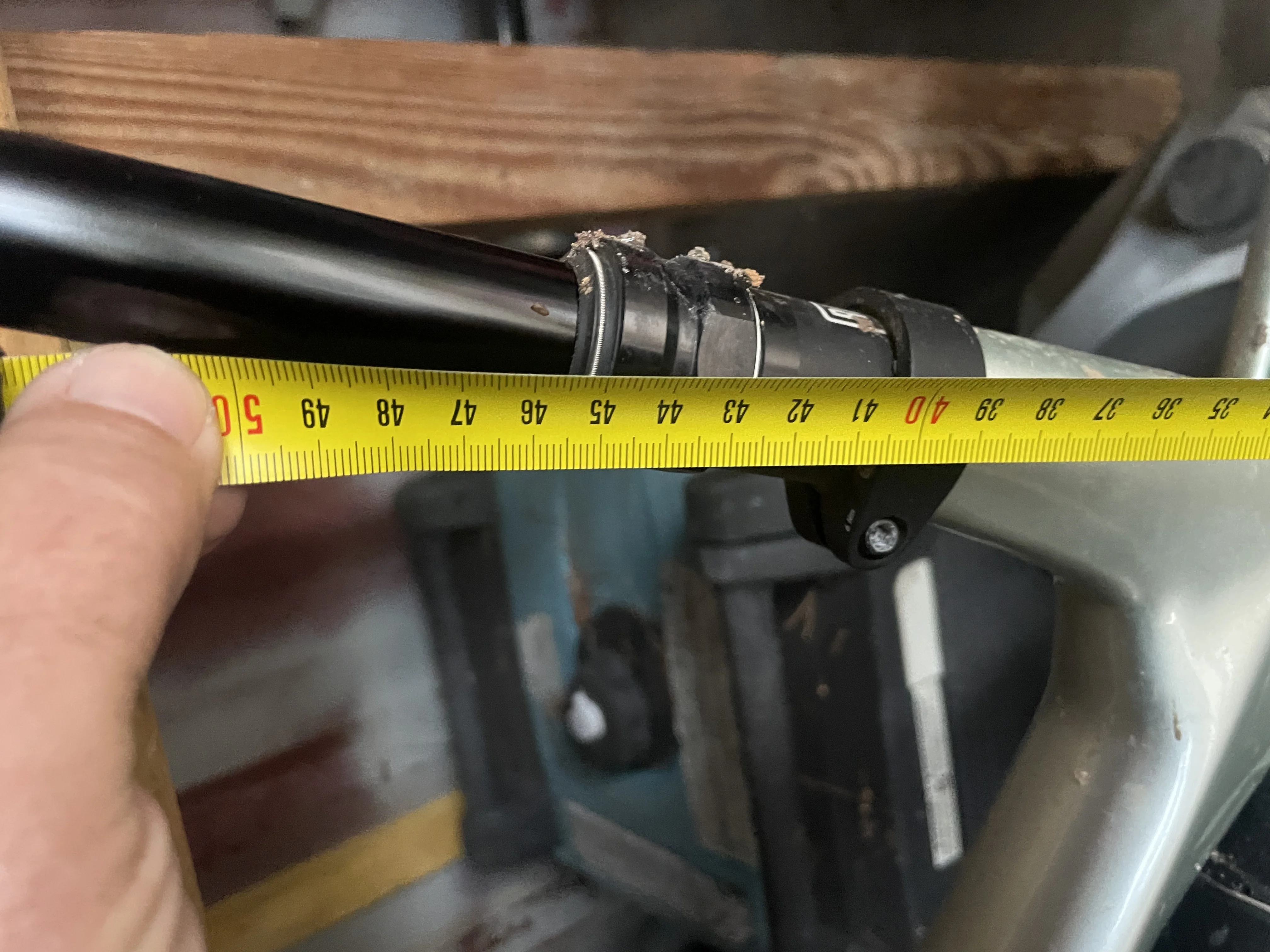

I also think like you. My Strive On Small is given for 395mm but if I measured to where the top part of adjustable part go in bottom part it's 450mm so 10mm higher top of eighteen pins on Medium size of this bike ( 440mm). and the reach will be very similar also with Strive On small at 450 mm and this one on Medium at 455mm
PS: I use a 200mm dropper seat on my Strive On Small so with the original 150mm dropper this measurement would be around 500mm!!! yes I have also pinned 145mm cranck that is why so high
The Strive/on is well known to be a bike where you need to take a bike one size down. I usually take medium but on Strive on I had to take a Small.
Look like the Thomus M will be very similar to my Strive:on Small for the reach and seat tube length.
specialy you can adjust reach by 10mm
What I miss in the geo spec is the wheel base length.
It would be a non standard way of measuring seat tube height if they’re including part of the dropper post as the measurement.
with Eightpin the setup is very different so it will never be possible to measure as on a regular bike.

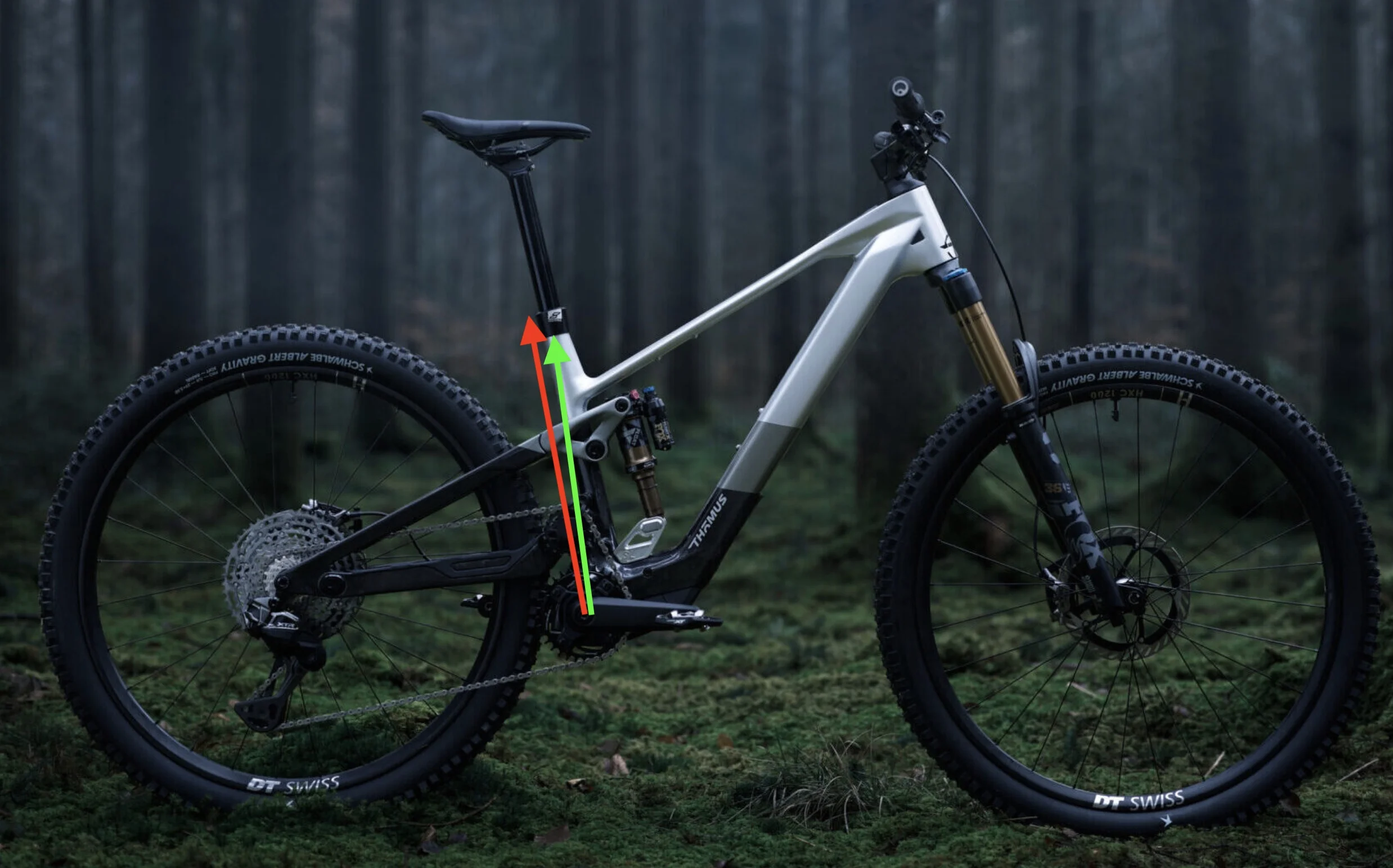

with picture you see it better
the question si do they take measurement like green or red arrow? any way still very different from measuring on a regular bike setup

the question si do they take measurement like green or red arrow? any way still very different from hearing on a regular bike setup
if they have a 506mm seat tube like the green arrow, then whoever designed it is not in touch with the market demands of enduro riders.
If it’s the red arrow, then it’s still very high (let’s say the dropper has 30mm stack - which is high for a dropper) - it’s still 476mm seat tube height. Which is high for a bike that has no need for it to be that high.
What if you wanted to use a normal dropper? Like sram AXS? Is that possible?

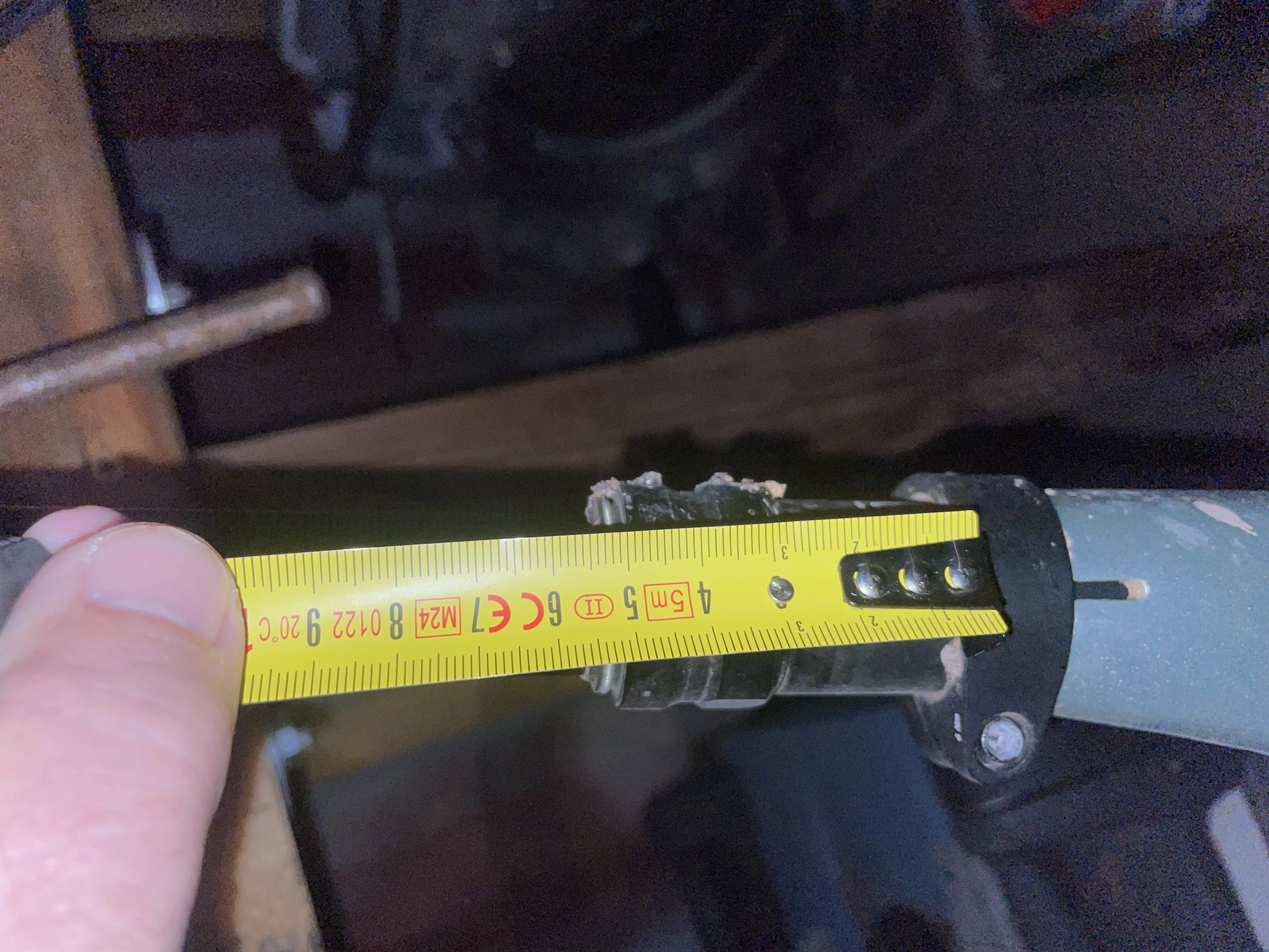

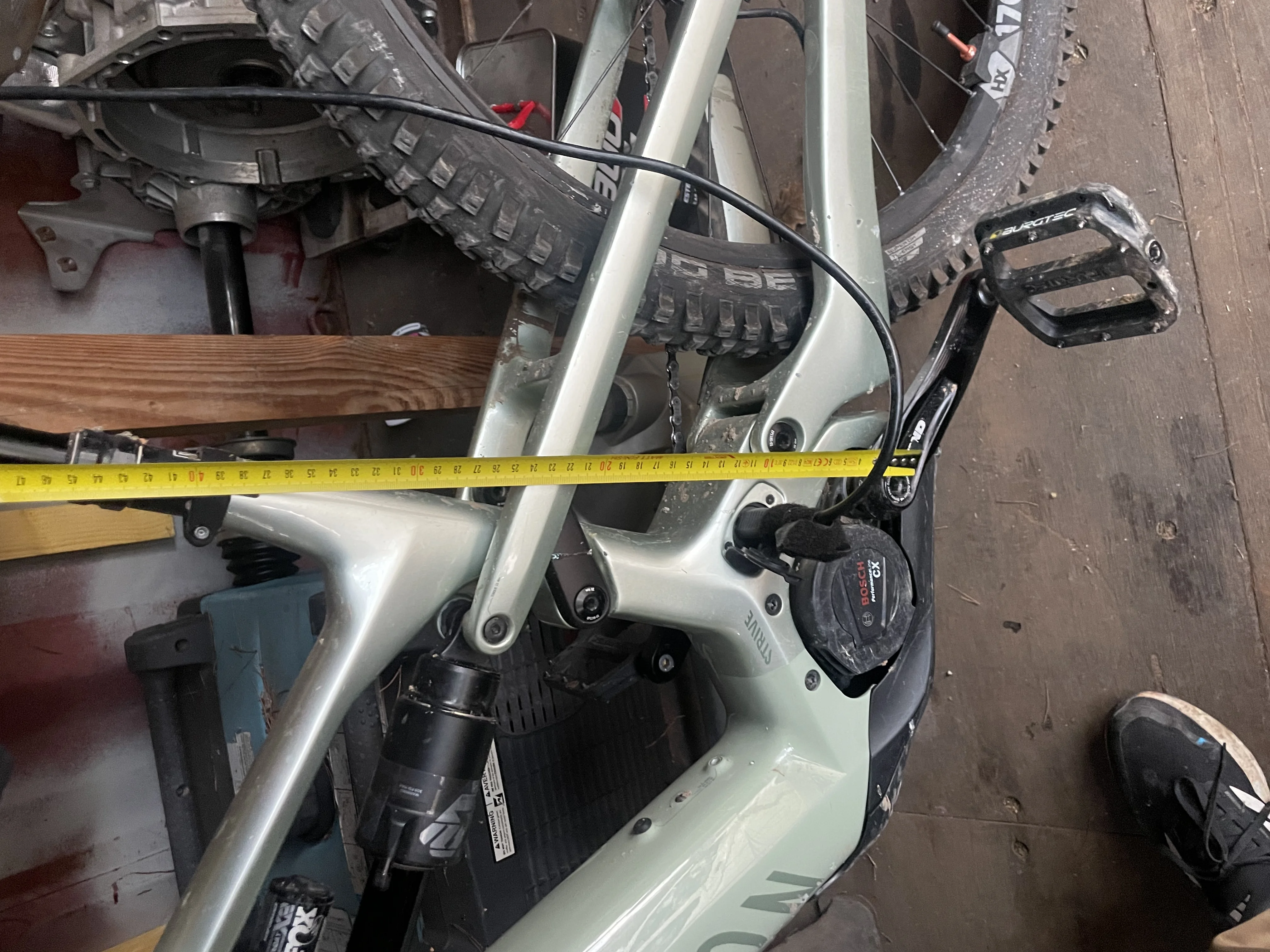

on picture you can see that on my Canyon the seat tube is 55mm higher than seat tube top. this is with a 200mm dropper with the original 150mm dropper from Canyon I was 105mm higher. I'm now much much lower than all my friend who are same size like me because the strive on allows me to use a 200mm dropper on a size S
I agree. Canyon had an excellent low seat tube. Allowing you to run a long 200mm dropper. Exactly how it should be. Low seat tubes allow the rider to choose a suitable length dropper
High seat tubes do the opposite.
on picture you can see that on my Canyon the seat tube is 55mm higher than seat tube top. this is with a 200mm dropper with the original 150mm dropper from Canyon I was at 105mm . I'm now much much lower than all my friend who are same size like me because the strive on allows me to use a 200mm dropper on a size S
Seat tube is about 30mm higher than standard across the whole range.
