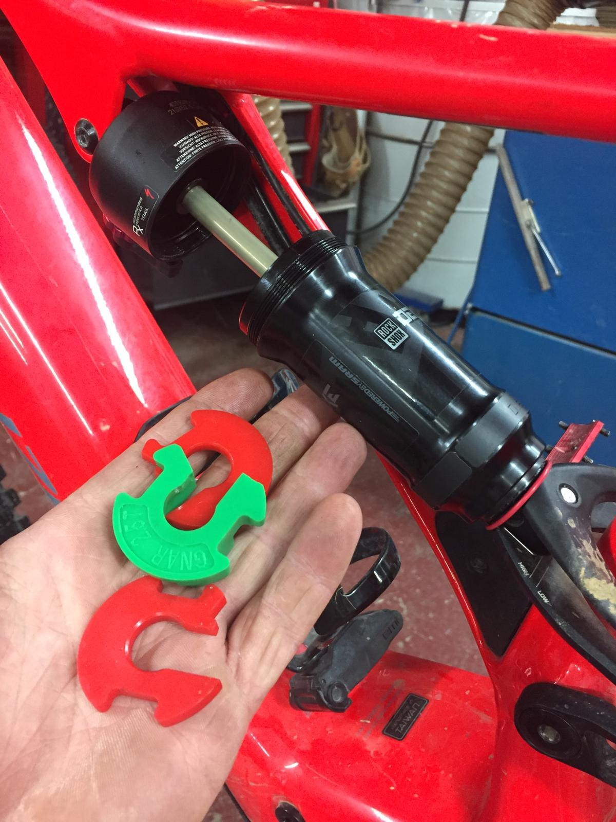

I find that rear air shocks come with too many spacers for heavier riders. The increased air pressure we need for the correct sag causes excessive ramp up and stops full travel.
If it is the problem it’s an easy fix. Empty all the air out of the shock, open it up and see how many red spacers there are inside. At your weight remove them all. Refit shock and set correct sag then go for a ride. Could be you’ve removed too many and bottom too easily but then just put another one back in and try again.
Videos on SRAM website on how to do this. It’s pretty easy, you just need to make sure everything is meticulously clean before opening it up. Can be done without even removing shock from bike. You may need a strap wrench, as the air can can be difficult to unscrew, but mine was £8 on Amazon.

hmm, good shout, ive never opened it and even though im not that heavy, I do have to use 275 psi.. if I use less I use full travel constantly.
fortunately I have a strap wrench so one less thing to worry about, cheers !!

well, I opened up my shock and there were the max amount of tokens in it.
removed the gnar dog and pumped it back up but now its losing air pressure ????
yea, I lubed the seal with sram better etc etc.. FML :(

If it was holding pressure before you removed the tokens it is unlikely to be losing air now. More likely you have not equalised it by cycling the shock every 10 psi added. The way you described your problem with the shock originally sounds like it is packing...ie too much rebound not allowing the shock to return before the next hit.

I equalised every 50psi.. and it seems to have settled now, ill check it tomorrow.
as much as I would love a high end shock, assuming this doesnt keep leaking, I will persist with trying to get a half decent setup on it.
I've had to pump it to 270psi now to get the sag right, it was 240 before.

if you take out the volume spacers you will need more air to reach sag.

well by way of an update I went to Cwm Rhaeadr today with my two red tokens and 270psi
the bike definitely felt different and the main thing I can take away from today was that I didn't "notice" the rear end like I usually would. its usually so harsh but today I just didn't notice apart from the fact that my fork now feels a little too soft.. possibly a coincidence but all in all, a big improvement.. thanks to @RustyIron because I just assumed that the shock wouldn't have been rammed with tokens..

If you're struggling to set up a fairly simple air shock I really wouldn't recommend you to go out and spent a grand on an EXT coil shock.
I could go into great detail as to why. But just don't.
im not going to regardless of whether I can afford it or not, I simply wont get the value out of it as a rider.
ive only just stared setting up the shock to be fair. I had no idea all those tokens were in there and was too lazy to open it and find out, judging by today its already improved and I think it will be fine for me..
something odd I noticed was that the bike seemed more lively, I was getting more of out pumping with less tokens, it seems the wrong way round in some respects although I did put more pressure in it of course.

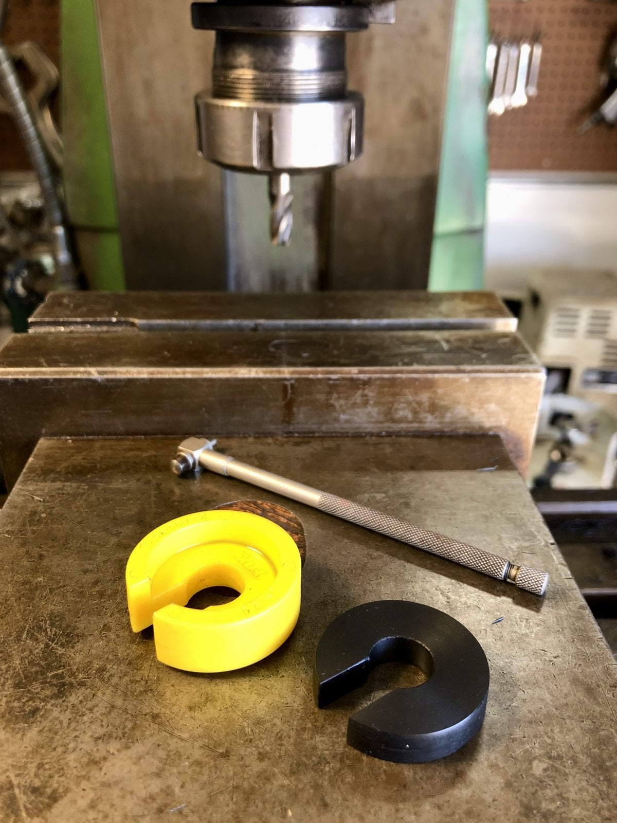

Less tokens means larger air chamber which means more air volume which equals more compressibility.
If you get the MegNeg upgrade later you can adjust both the positive and negative air volume.
What bike did you put your magnet on? I read that some bikes make more of it than others due to suspension design
