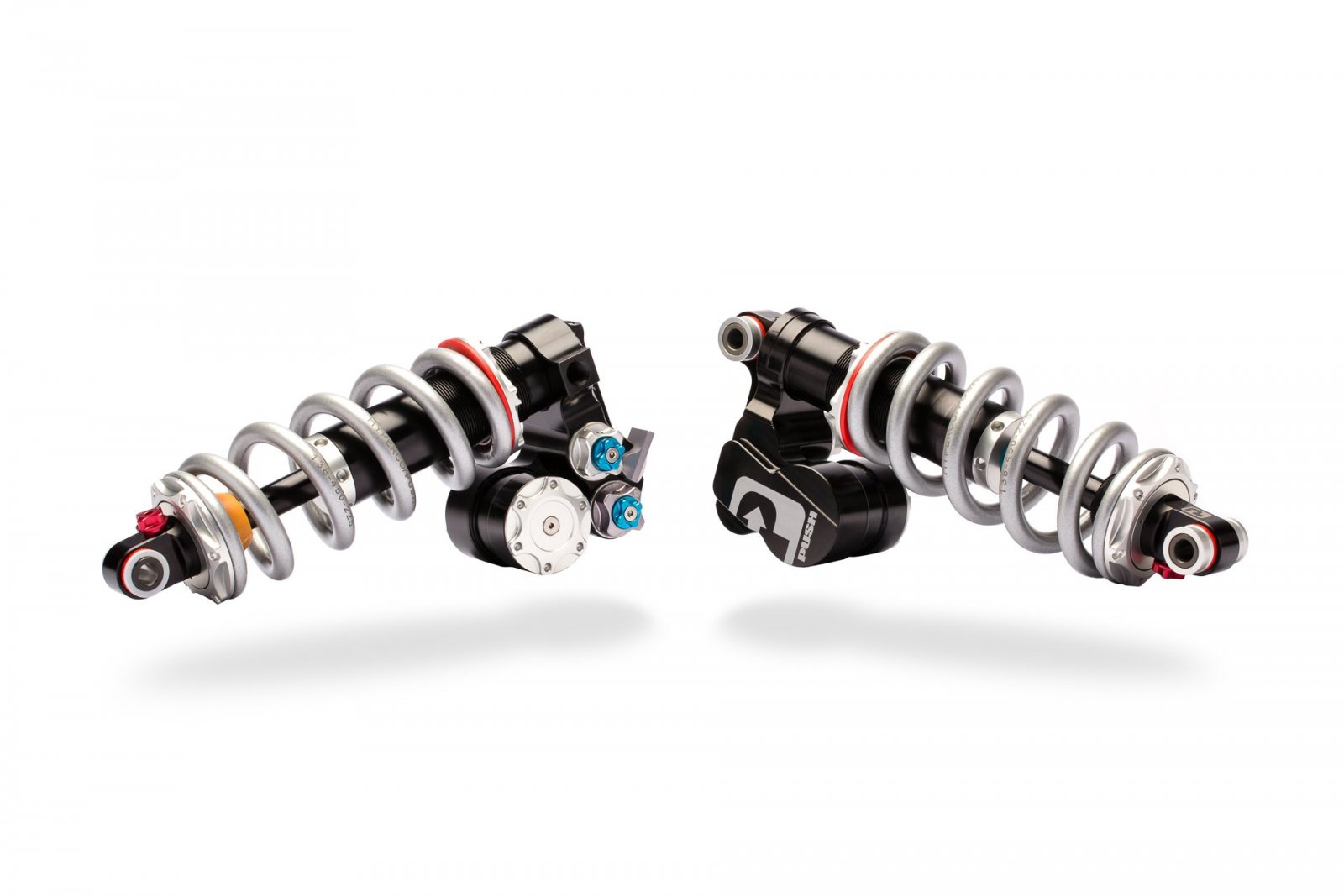

There has been a lot of buzz about Öhlins the last couple of years and I have been continually disappointed by these over priced suspension components.
The Push elevensix is the best rear shock I have ever ridden, but they don’t make them for Specialized bikes.

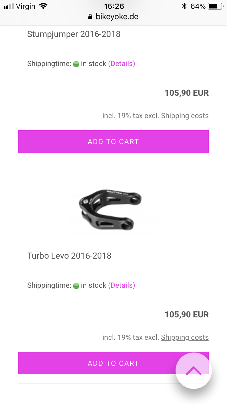

Could you use a bikeyoke for the levo to get the push coil shock to fit
