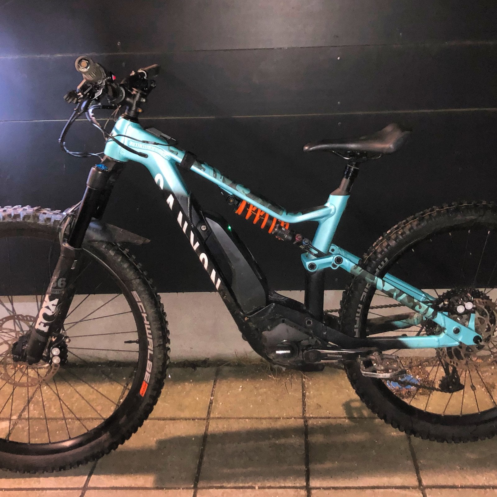

Yea someone has, I definitely recall seeing a fox dhx2 fitted. And I think 230x65mm works too.
But yeas, a progressive spring is a must, this bike blows through the travel quick. I swapped my standard dps out for a dpx2 with a lot of volume spacers and it was a lot more poppy.

Yes the dhx2 fits perfect and gone 230x65 once you get it set up there’s no bob peddling and loads of grip/plush,win win all the way

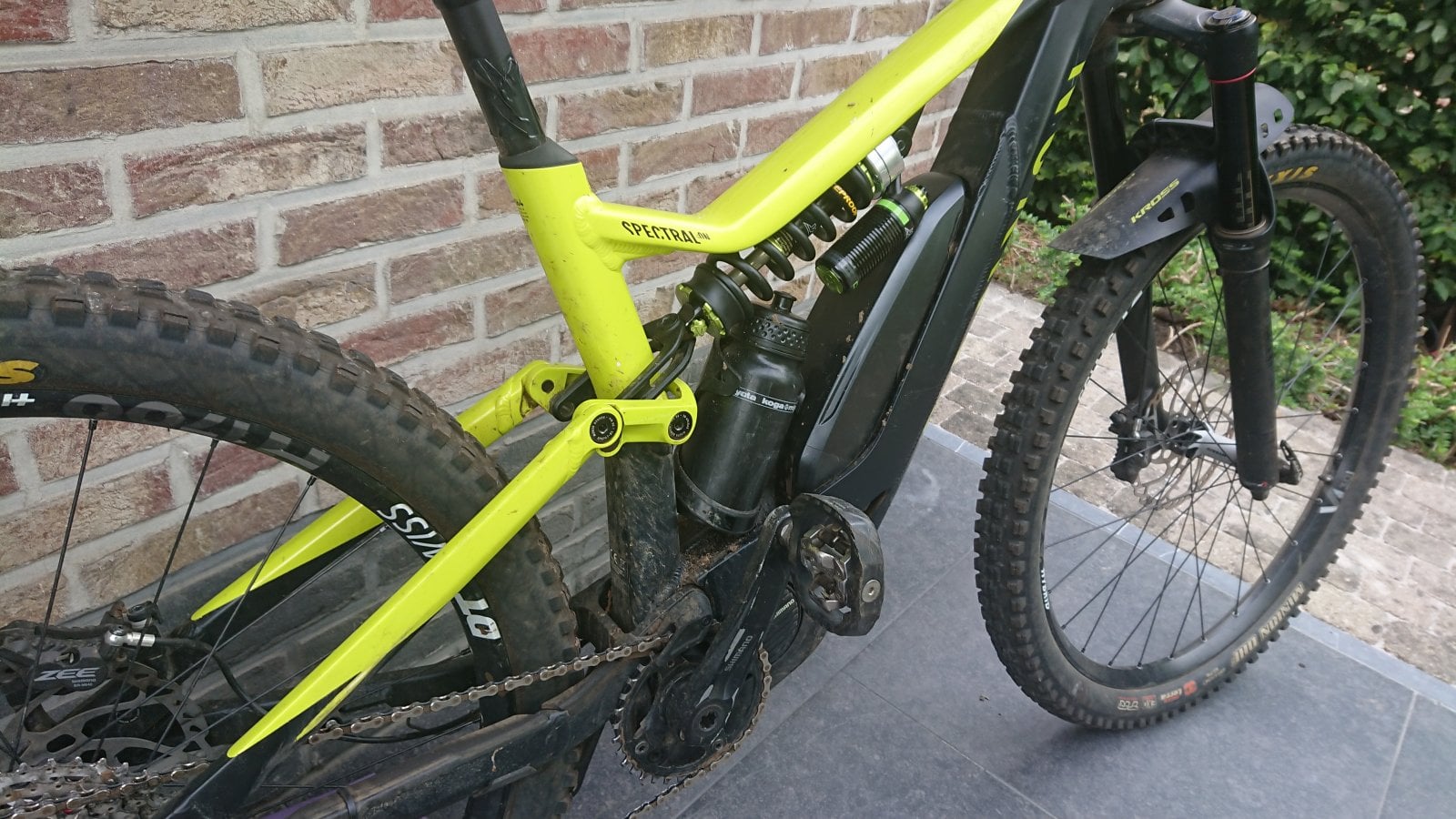

I fitted marzocchi bomber cr 260mmx62.5mm big improvement over the air shock also fitted the coil conversion kit to the fox36 rythem forks can just blast throught anything now. Only problem i had was the water bottle rubbing on the spring so removed cage and soaked it in boiling water and bent it back refitted and bottle clears the spring.

You need a 230 x65 I fitted a fox dhx2 I had a 500 spring and weigh 74 kg fitting wad straight swap that with 170 mm forks up front makes it a different beast cracking to ride
Ok good to know, thanks for the info.. going 170 in the front as well.. thinking about cane creek 450-550 progressive spring for the shock.. im about same weight as you. Bomber cr (fox van rc), dvo jade are top of the (budget) list right now.

The bomber shaft is alloy might not stand up to ebike jd suspension do a spring calculation for £5 they said 475 for me but I’ve had 500 and 550 the 500 is quite soft (springy ) ?compress really well for jumps

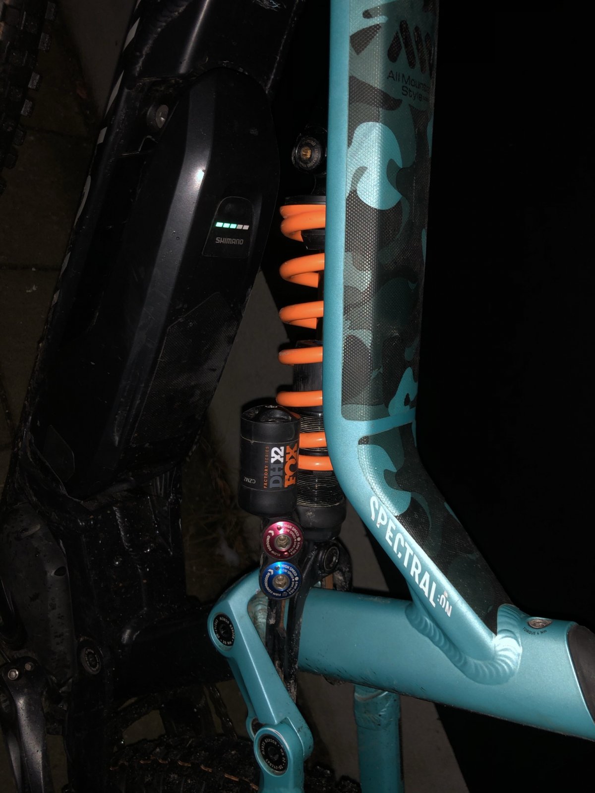

yes mate fitted a fox dhx2 230x 65 to my al spectral on pics on this thread black bike you’ll love it just used 450spring I weigh 73 kg

[QUOTE = "NichlasLindHolgersen, post: 262348, membro: 15463"]
Domani proverò il mio dhx2, ho bisogno di spazio per il 630wh il mese prossimo
View attachment 52270 View attachment 52271 View attachment 52272
[/CITAZIONE]
ciao , volevo chiederti come sei riuscito ha montare il fox al contrario , io nella mia non riesco poichè l'attacco della forchetta del carro non coincide con l'anello del mono.Ti sei servito di qualche modifica o adattatore?

Im going to test my dhx2 tomorrow, need space for the 630wh next month
Hi, in the hope to increase the performance of the rear end I'm very tempted to replace the standard air shock with a dhx2 as you did. Are you satisfied with this variation? Does dhx2 works flawless with the 630 wh battery? Did you use some spacer/tool to install dhx2 as you did? Thanks a lot! ?
