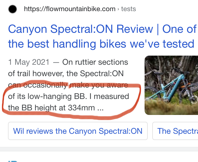

So what is the BB height on a Spectral :ON?

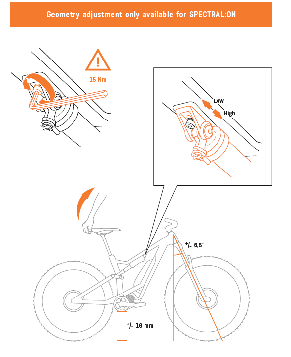

Your bike has a flip chip, is it set in the high or low position?

334mm is pretty low
My levo in comparison is 347.5mm
Are you referring to the mounting of the rear shock to the top tube? Or is there something else that can be flipped? Also, thanks for actually responding to his question.
I didn't even know this was a thing. Does the 2022 Spectral:On have it? I just went and looked and there was nothing obvious. I looked at all the pivot bolts around the rear shock and I saw no "High / Low" markings. Just torque settings and tool references.

I'd like to know too whats this flip chip you're talking about on Spectral:ON?
Also, shorther cranks help with pedal strikes.
I am pretty sure Canyon has omitted this feature.
maurocif
Nov 3, 2020
27
31
Rome
In my 2019 Spectral:ON this feature is not achieved with flip chips but with a variable setting point of the rear shock:
I suggest you to check if the same solution has been applied to 2022 models.
