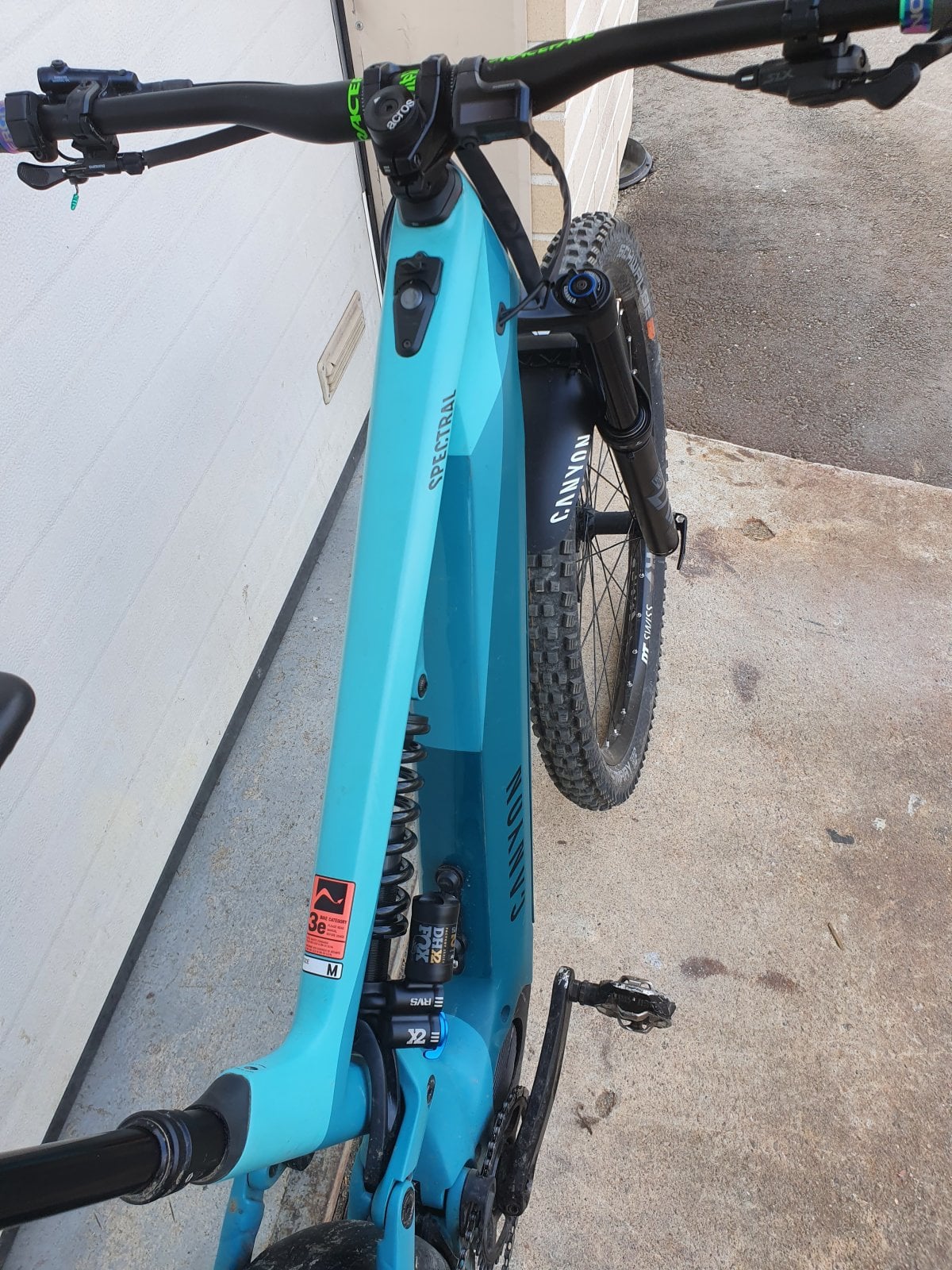

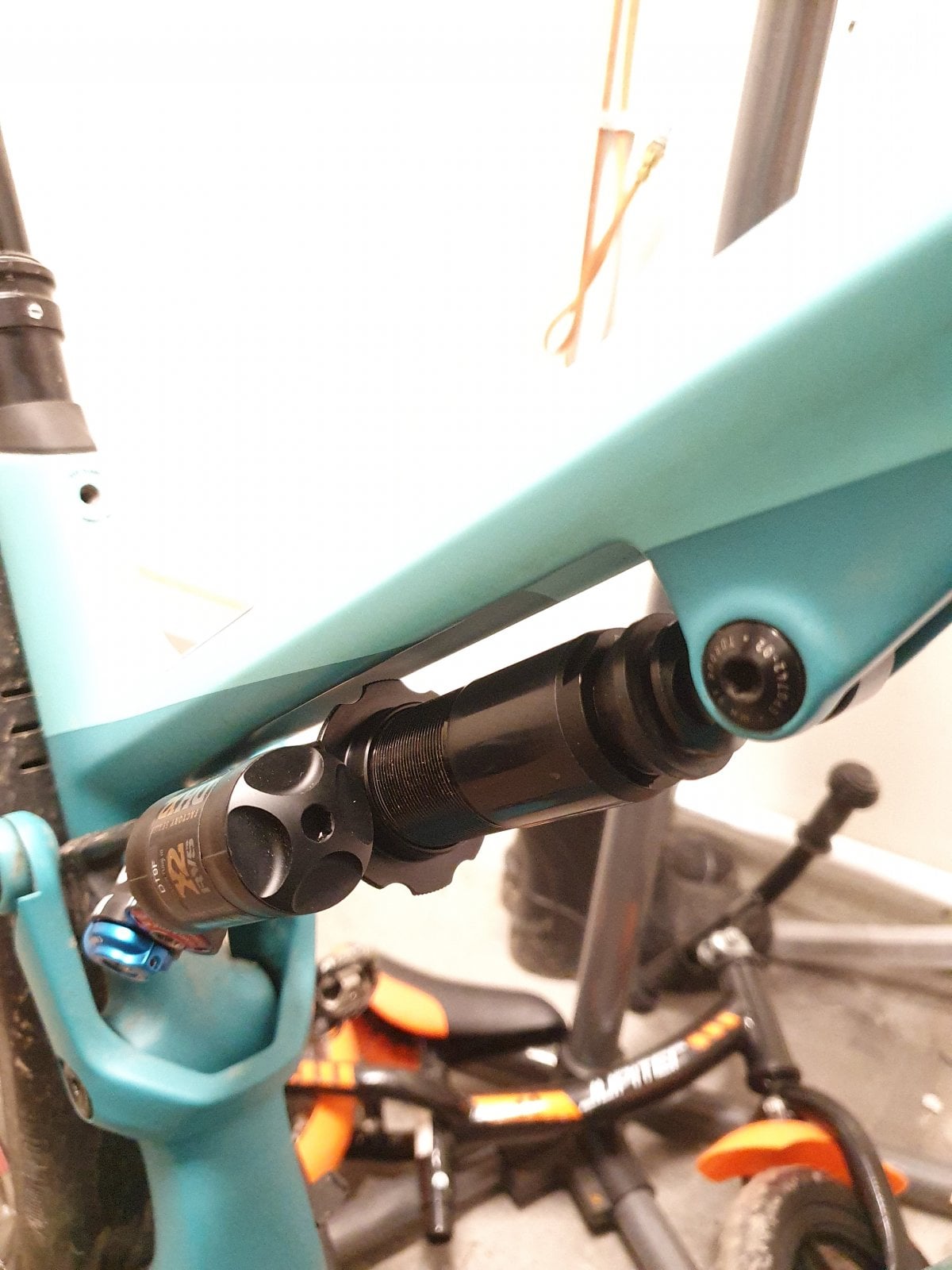

I installed Fox DHX2 on my medium frame to try it out. I really like the feel of a coil shock. I did first 30km loop today, and at first I ran through the travel pretty easily with very little compression damping (drops but not huge). Once I added more compression damping situation got much better, but more testing is needed to get a good feel of the bottom out resistance and ride feel. I might order cain creek progressive coil to try it out.
For reference I'm 75kg kitted and I have 400lb coil on.
When you install the shock, it needs to be mounted piggy bag towards the back of the bike due to tight fit. Otherwise when suspension compresses the coil meets top tube. Mounted this way wide part just fits in the recess under the top tube when compressed.
