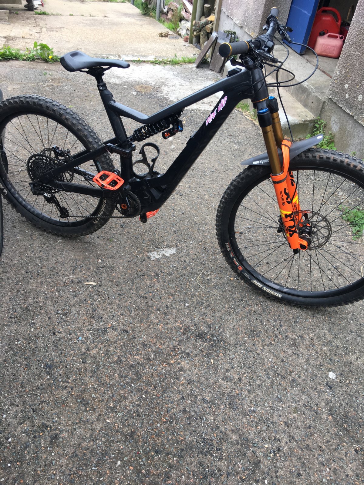

And it worked out pretty good! View attachment 33591
Hello, I'm a spectral on owner like you
I've only been using fox dps, which is pure shock for 4 years, and I'm looking for coil shak because it's broken
Someone said that if you use a coil shock on a yoke strut, the shaft of the coil shak will become overloaded and break, which can also lead to frame damage
Has your coil shock setup been available for a long period of time without any problems?
I fitted marzocchi bomber cr 260mmx62.5mm big improvement over the air shock also fitted the coil conversion kit to the fox36 rythem forks can just blast throught anything now. Only problem i had was the water bottle rubbing on the spring so removed cage and soaked it in boiling water and bent it back refitted and bottle clears the spring.

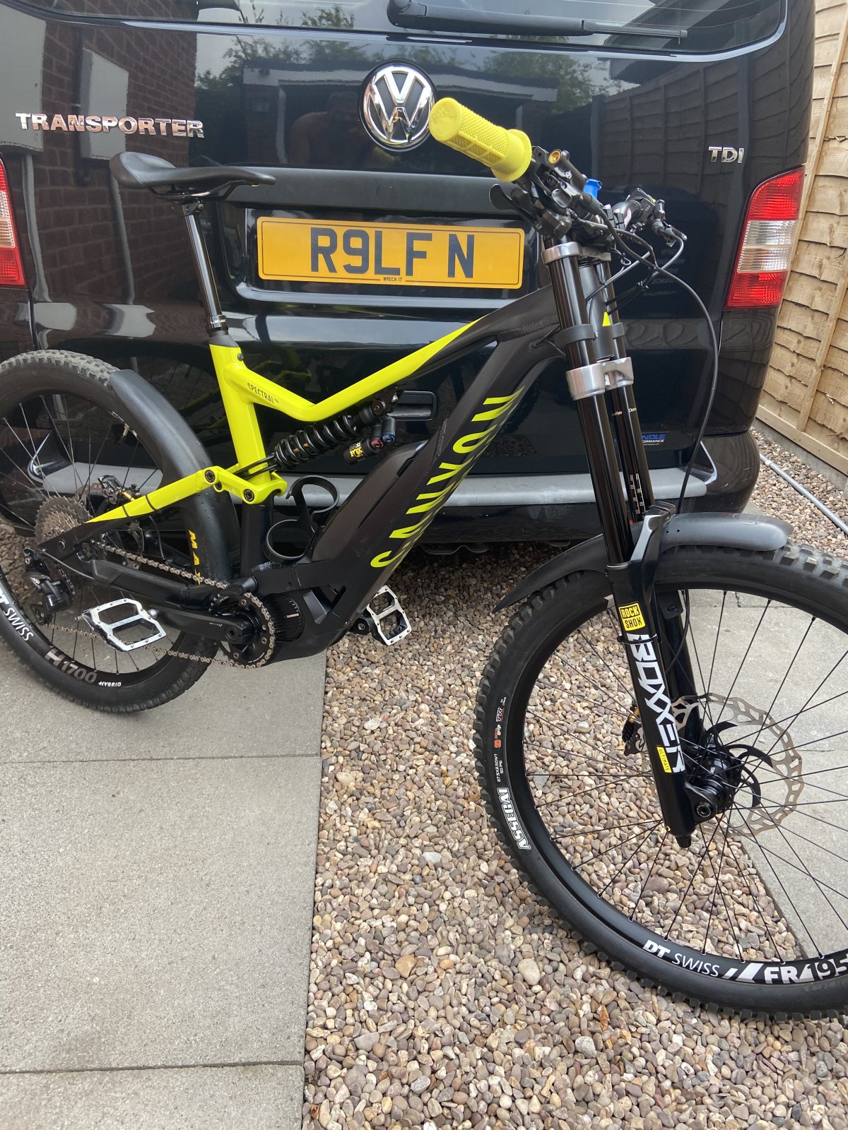

fox DHX2 230x65 loving the coil

Im going to test my dhx2 tomorrow, need space for the 630wh next month

Yes the dhx2 fits perfect and gone 230x65 once you get it set up there’s no bob peddling and loads of grip/plush,win win all the way
