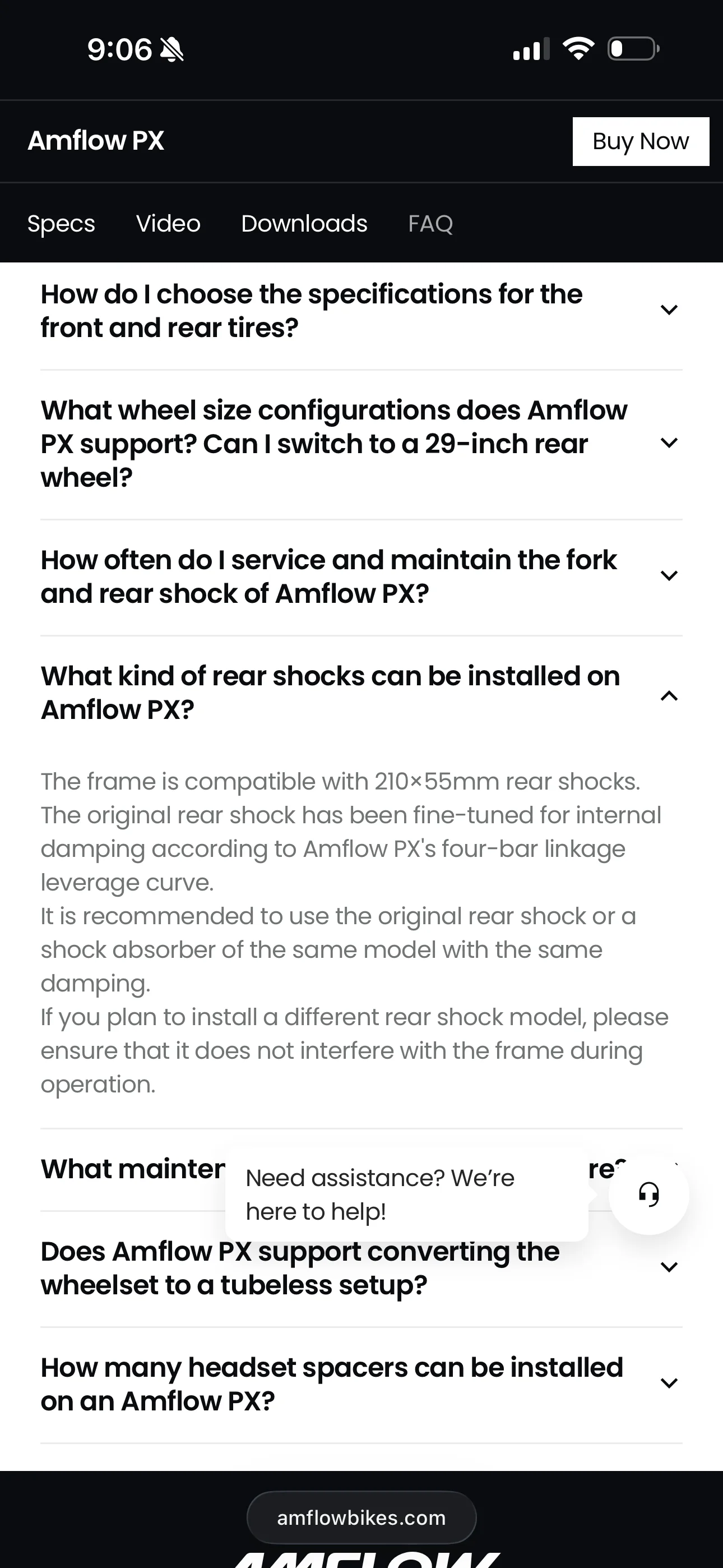

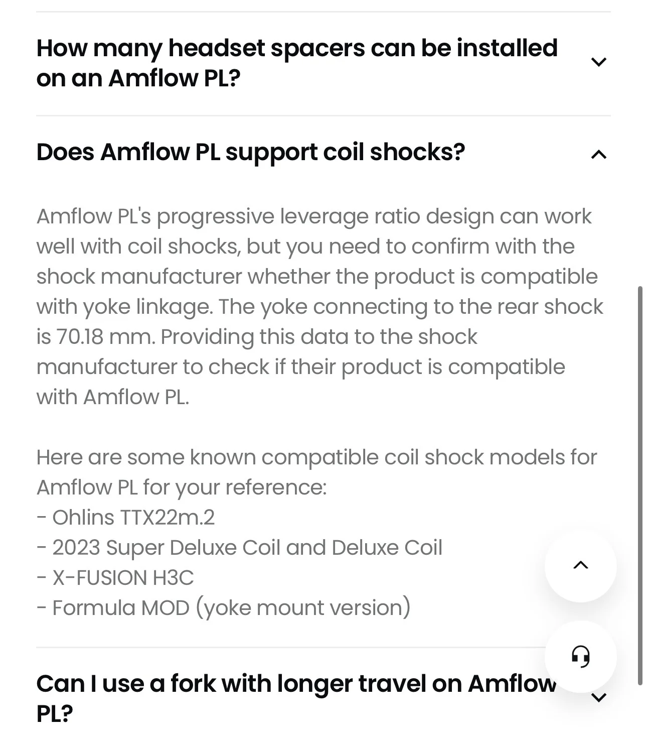

Where did you read you shouldn’t use a coil shock at? Can you post or link it? They used to give specific coil shocks that work well on the bike. I run ext storia v4 on my pl carbon.

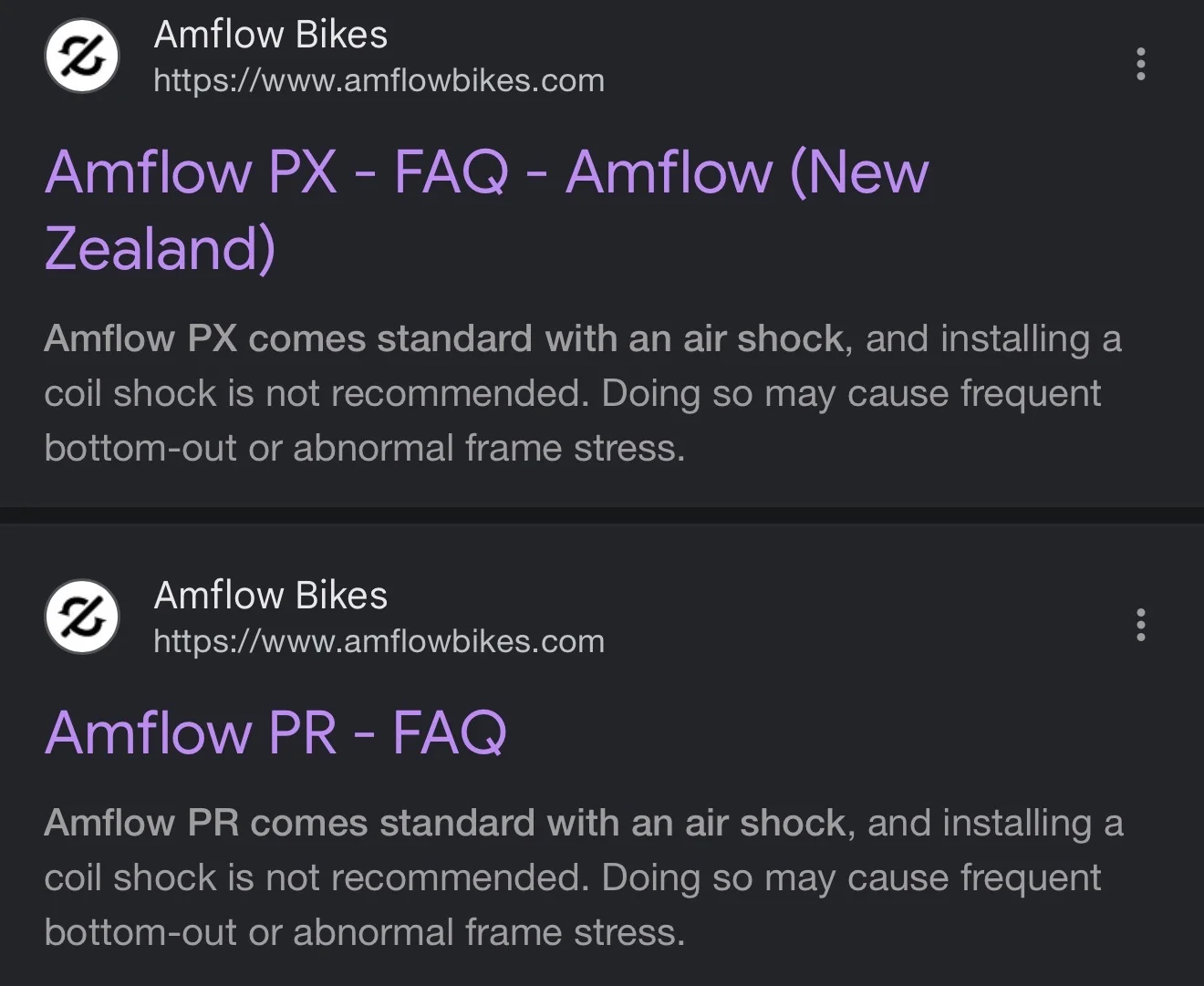

I found this wording in Google’s snippet for the official Amflow PX FAQ, although I can’t currently see the same sentence in the live FAQ body. This is what they write-
“Amflow PX comes standard with an air shock, and installing a coil shock is not recommended. Doing so may cause frequent bottom-out or abnormal frame stress.”
So google not Amflow?

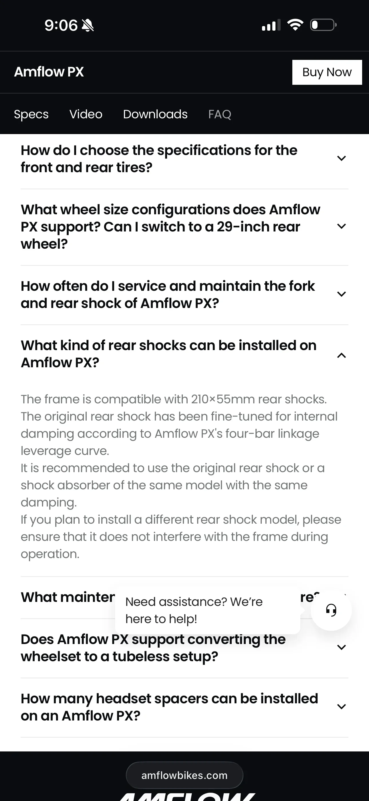

This is from Amflow. It’s just saying make sure it doesn’t interfere with the frame not that you can’t use a coil. They used to specifically recommend ohlins, ext, and something else. You’re good going coil.
I think what Amflow were saying in the FAQ from the Google search was just that a badly setup unsuitable coil shock that would blow through its travel with frequent bottom outs wouldn’t be recommended.

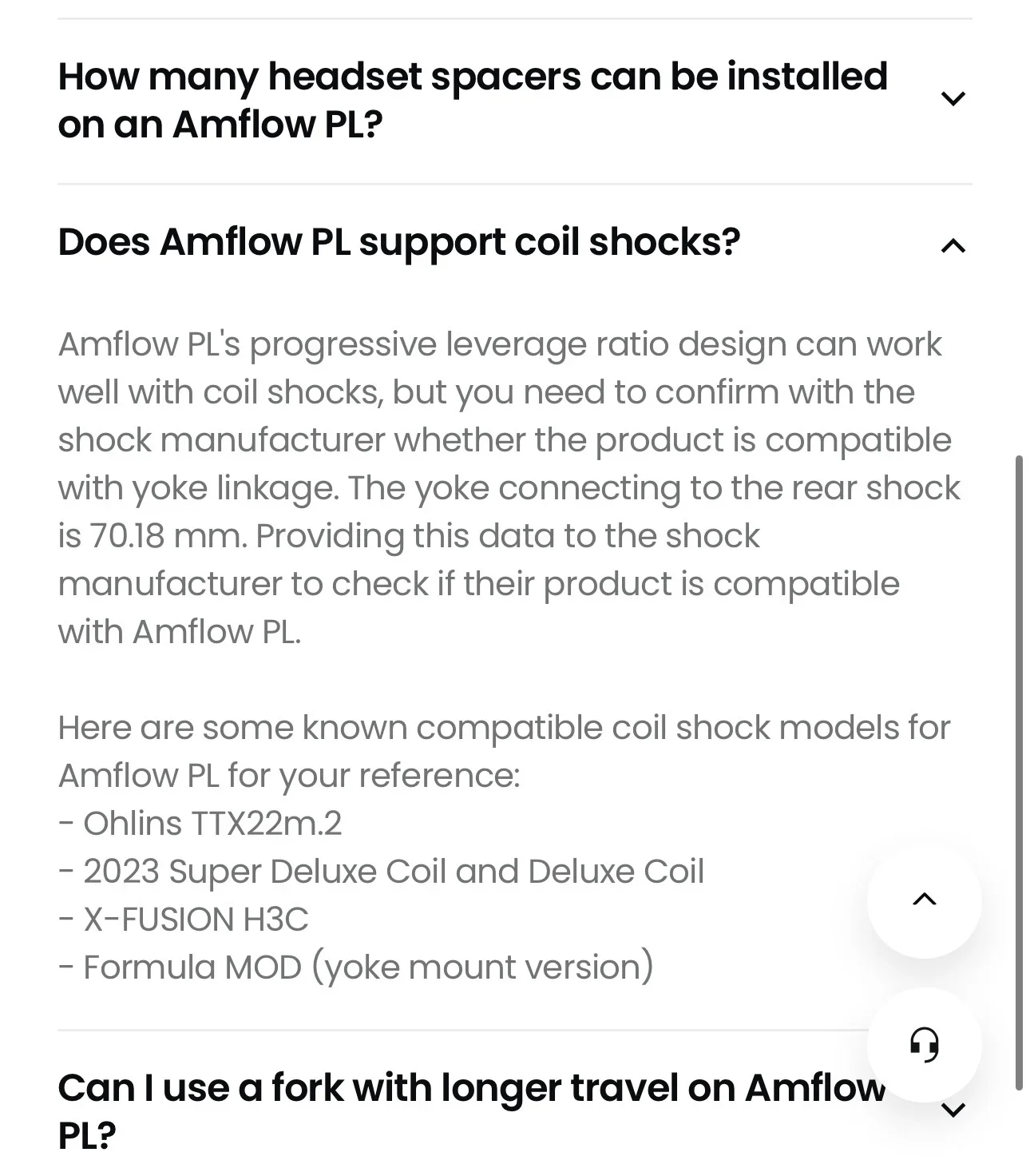

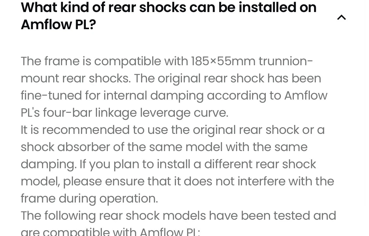

That’s because the air shock that comes on an amflow is tuned for it. Nothing to do with one not working well. It’s the same style suspension design. They say the same thing on the pl. No bike company is going to encourage you to change the shock on their bike when they don’t sell frame only option. They are trying to let you know this is what they think is best. They also don’t want to encourage modifications by people that probably don’t know what they are doing.
Ext has a specific amflow tune for their coil shock as well.
Apart from bottoming out, the yoke design sideloads the shock quite a bit. At best, this scratches the inner body (would need replacement), at worst you snap the piston.
Specialized has the same type linkage If you use a shock will a small shaft it will snap

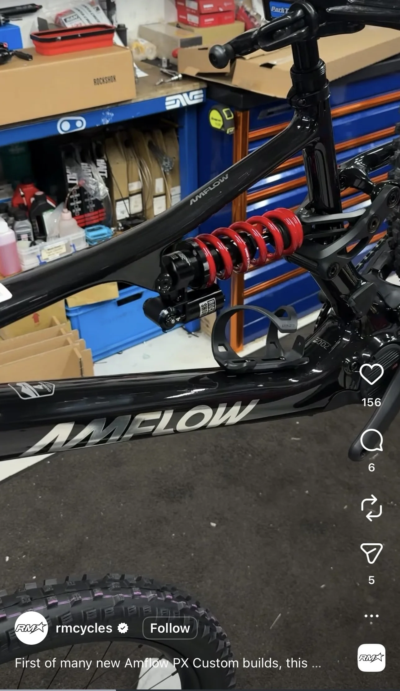

I went with Push coil and coil forks now its way smoooth
