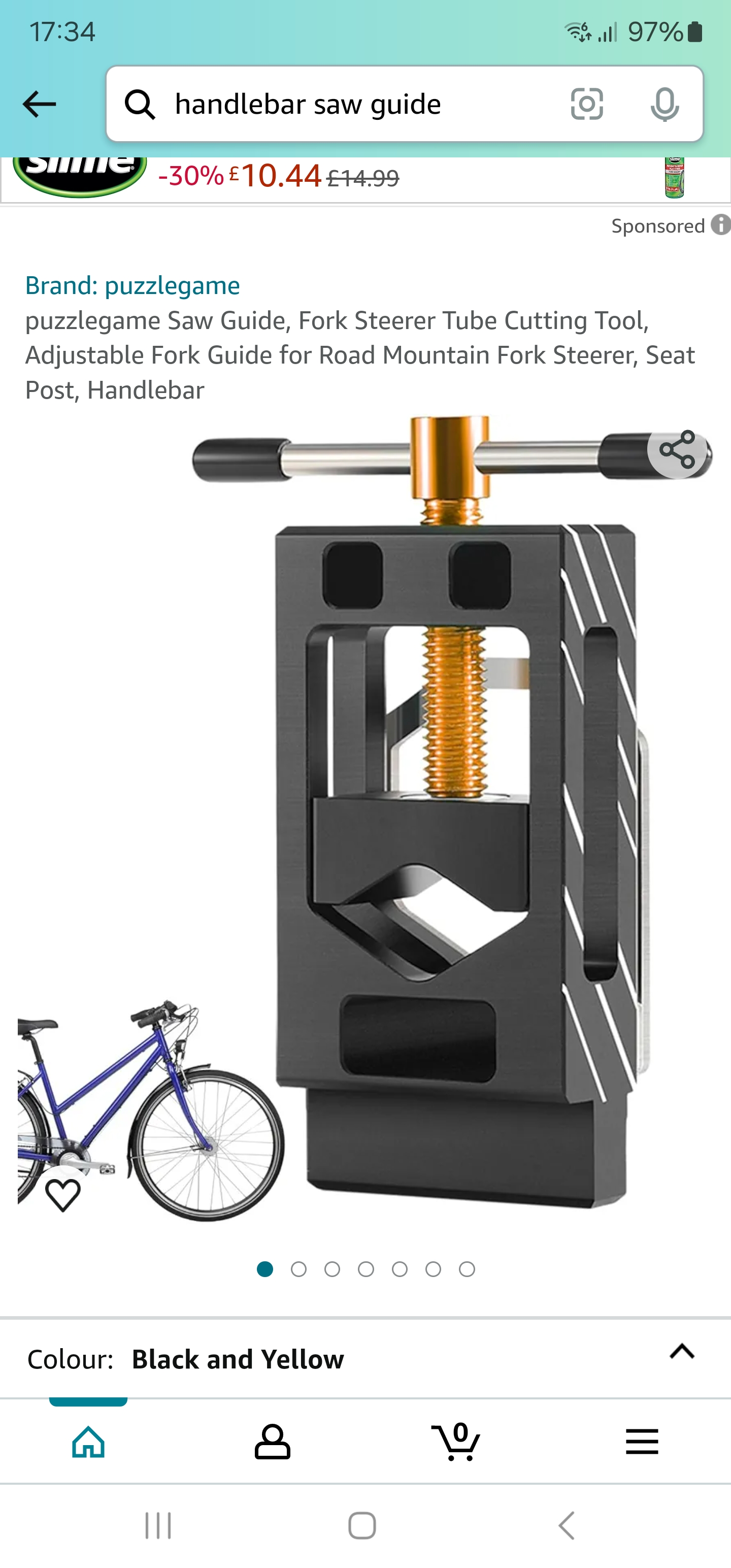

Darren66
Mar 7, 2020
125
87
uk
Or this, £16 from Amazon

Peaky Rider
Feb 9, 2019
839
532
Derbyshire Dales
Might have looked into that save for the fact I've done the job with the aid of two jubilee clips, side by side, with a blade width gap between to guide the saw.
Either the new blade I put in the junior hacksaw was rubbish or cf bars are really tough.

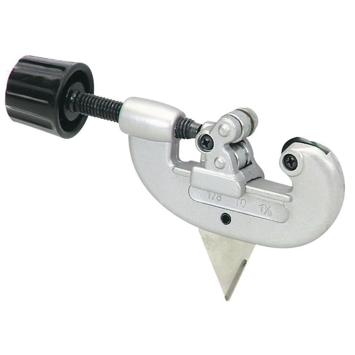

Use a tube cutter, cut is straight and no dust. View attachment 142205
IMO that’s the wrong tool for this job. If the circular cutting disc is not extremely sharp too much pressure needs to be applied to the end of the bar for a clean cut.
It won’t make any dust …but you could accidentally crush the bar end. Carbon cracks are difficult to see or detect.
On a carbon arrow the shaft had to be flexed before each shot. If you hear a creak or squeak while flexing the shaft …it’s garbage, toast, dangerous etc.
TurboJoe
Jul 11, 2020
19
10
San Jose, CA
All I can say it works for me, many times.
