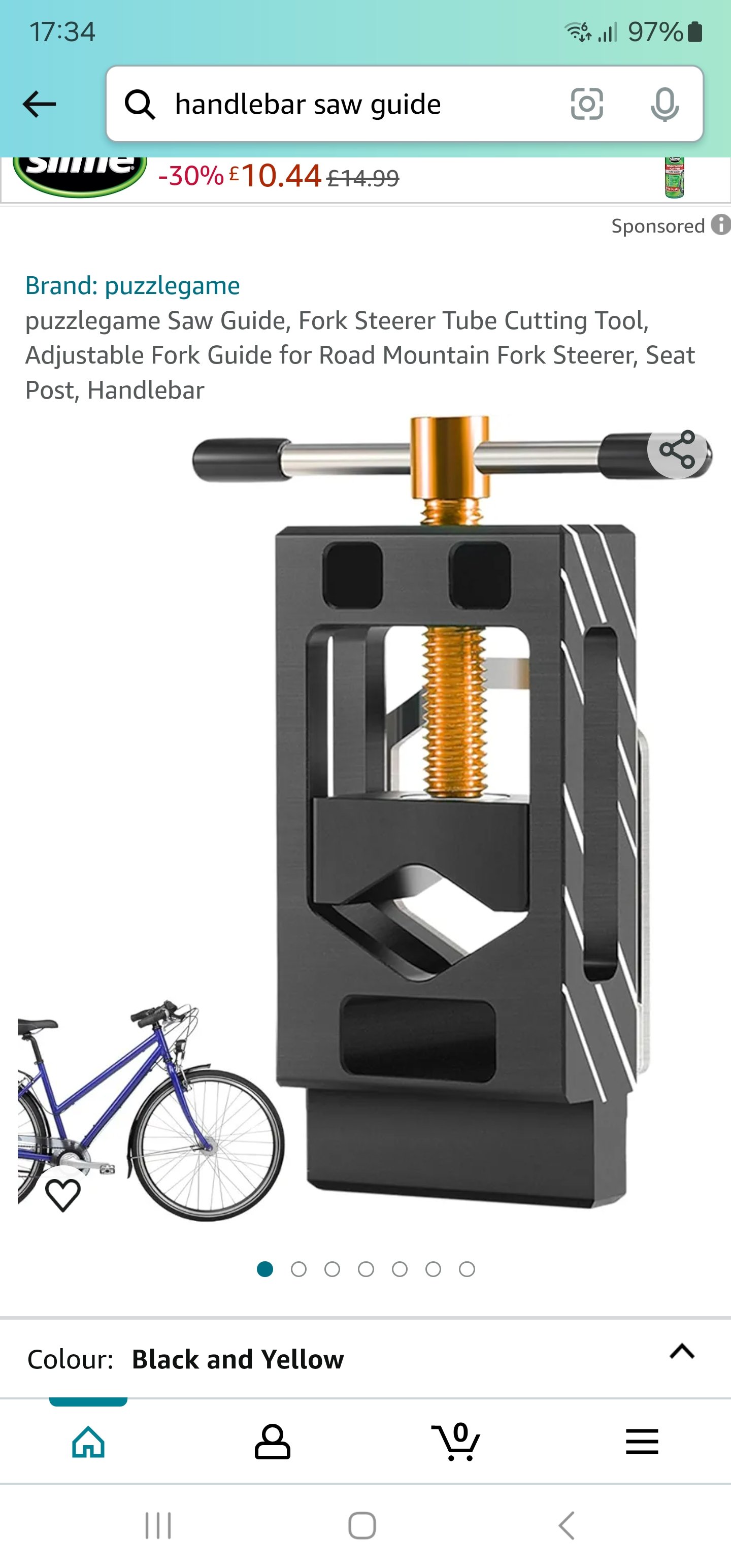

If you don't mind spending a few bucks ParkTool has a blade and guide that really makes it easy.
Or this, £16 from Amazon
Might have looked into that save for the fact I've done the job with the aid of two jubilee clips, side by side, with a blade width gap between to guide the saw.
