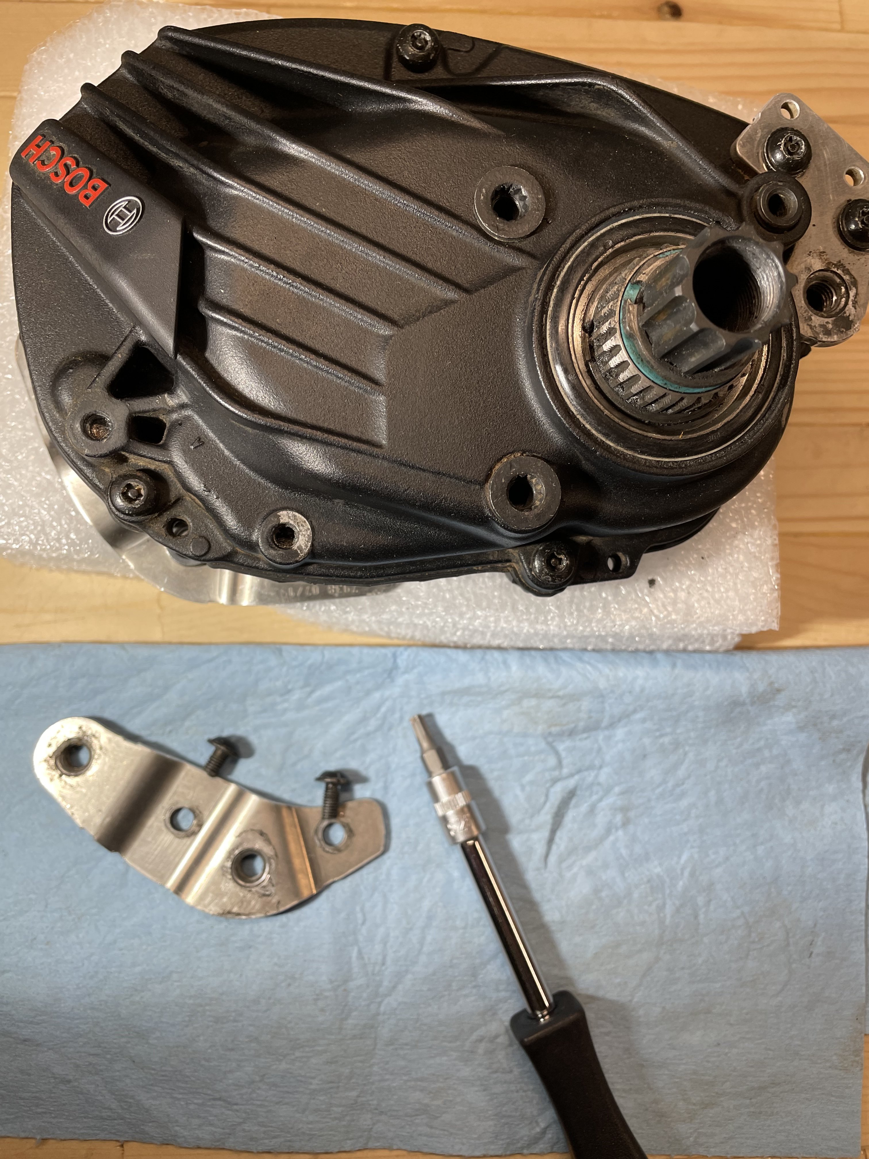

Oh yeah. Chasing that clicking, ticking, squeaking, rubbing noise can be fun🙄.
A few days ago my son-in-law brought his bike over with a clicking/squeaking noise. He thought it might be a motor or hub issue. Turned out to be a broken seat.
On my neighbor’s bike; bracket bolts on one side sheared offf. Noisy at first but became obvious shortly after. Possibly incorrectly torqued or a casing during a jump. Had to replace the motor.
I’ll try to fix this, but I think the drive side casing will need to be replaced. And both brackets.
