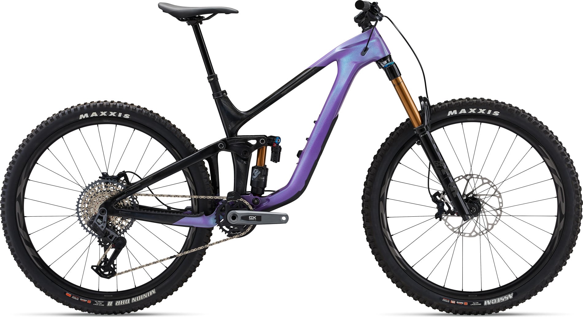

Giant just announced 2024 Reign builds (non electric).
Looks like they will spec T Type transmissions on their SRAM builds and they're also going wild with the colors, Reign E+ should have a similar build.
