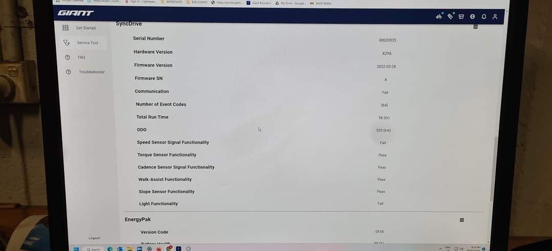

I saw a report on Fb from a guy from Australia that had a Trance E+ motor warranty claim refused because the Giant service tool registered the 6A event code during diagnostics.
I have to point out that the user did not say the 6A event code locked his motor, he only reported that the diagnostic tool registered the code.
There were also screen shots of the diagnostic tool screen showing the code and some "Fail" results with some sensors.
So the credibility of the report is questionable, it is not necessarily the tuning box that causes the 6A event code.
As there were also "Fail" codes for some sensors,probably sensors gone bad(because of higher heat inside the motor), could also that be a reason for the 6A event code.
I can imagine that if someone runs a motor that was designed for 32km/h plus 10% reserve, let's say that's 36km/h max at speeds over 50km/h it will overheat to much and damage the electronics.
I follow all Giant E+ forums and groups pretty regularly and so far this Fb post was the only report that I have seen so far.
One more interesting thing, in the diagnostic tool on the left side it says:
Number of event codes
On the right side it says [6A],
so that could also mean, 6 times an event code was detected.

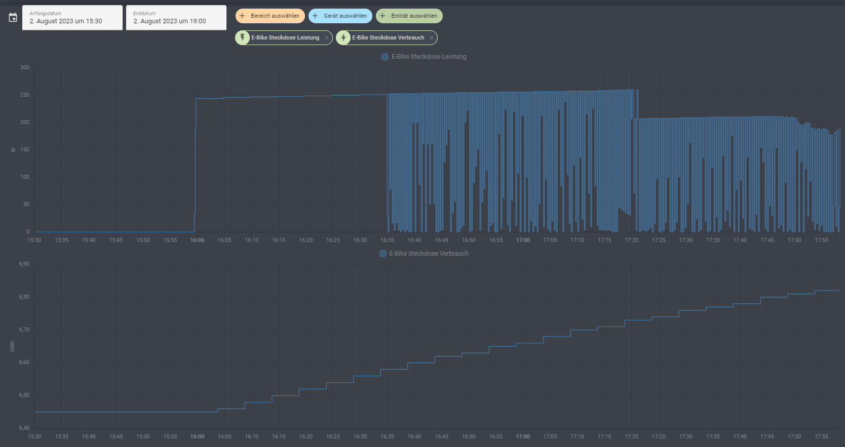

Even After the Update I have still this strange behavior after 30min of charging. Battery was at ~30% before charging.
The average charging speeds slows down, but it seems the battery will reach 100% . After unplugging the charger for a few seconds the charging will continue stable for a while.
I could also press once then power button while charging and the LEDs turned on white on both sides.

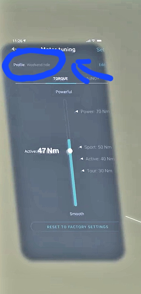

Hey guys, does anyone here also own the 2023 Trance E+ Elite?
Looking at this promo video (time stamp 0:58) you can see additional functionality of the motor settings on the bike, that our Reigns lack.
As seen in the video it's possible to set the torque in 1 Nm increments from 20 to 85.
Can someone maybe confirm it is indeed like that on the Trance, or is this just a teaser for a future app update. Which would probably be a first for Giant...throwing out teasers...
It's the exact same motor as on the other models.
So I put my money on the claim that the app wil not be any different and you can't set the torque in 1 NM increments.
Marketing Video with a fancy animation - that's what it is.
Just my 2 Cents
Just my 2 Cents
Also asked in the Trance thread, will see if anyone can confirm. 🤷‍♂️
Wow good catch 👍 You have to really pay attention to see this!
My vote goes to future release of the app...

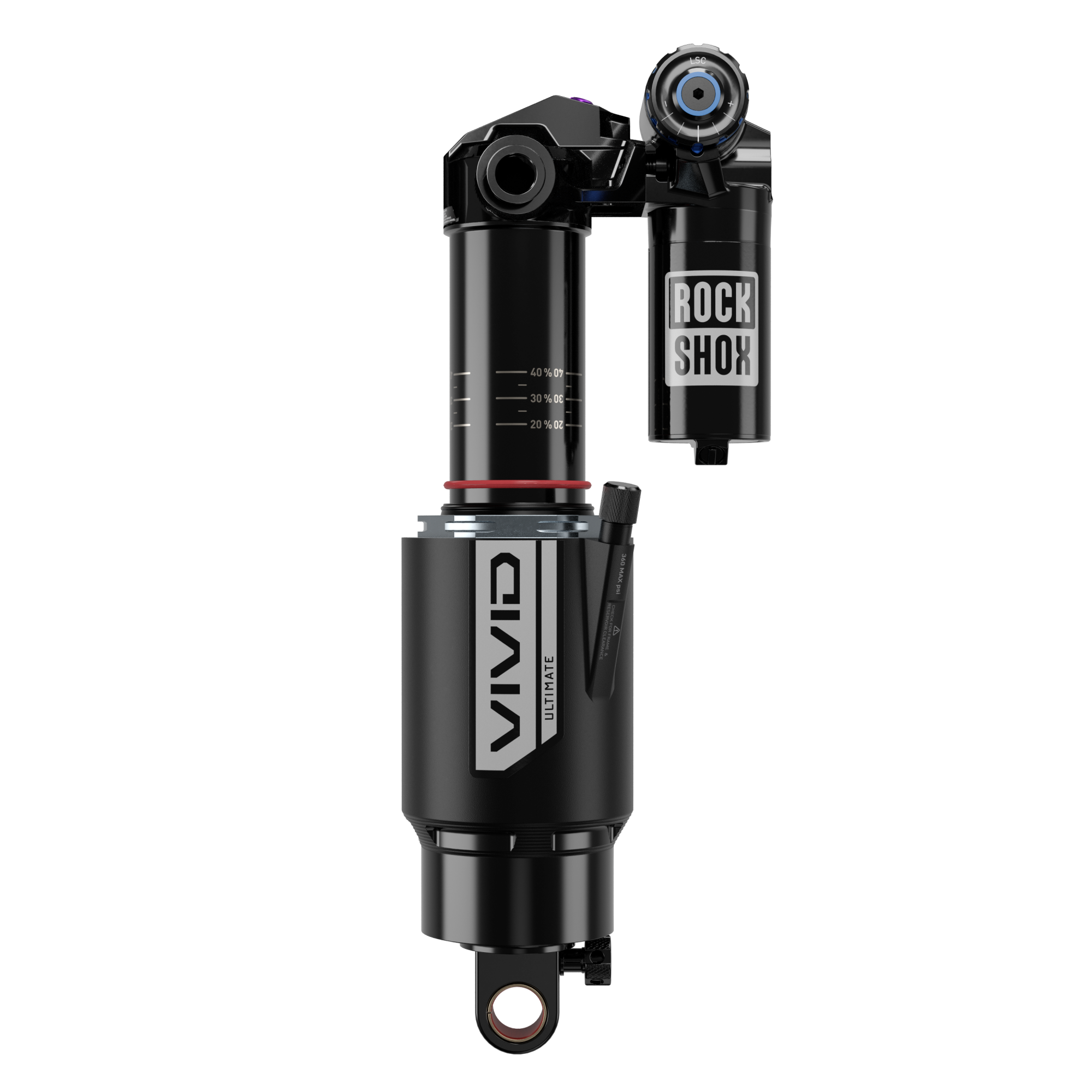

For those looking to replace that Float X2 that is always broken or need to be serviced, Rockshox is about to release their 2024 Vivid.
They even bumped the regular service interval from 50H to 100H and the Ultimate version comes with HBO.
Bye bye X2.
Can you even tell the difference between air shocks?
You can definitely tell the difference between a not riding because your X2 is in for service and something that doesnt break.
I have a Trek Rail with a RS delux select (super basic) and the difference between that and a properly working X2 is staggering. Trouble is the X2 is so damn fragile.
I would bet on that new Vivid for reliability and performance any day
