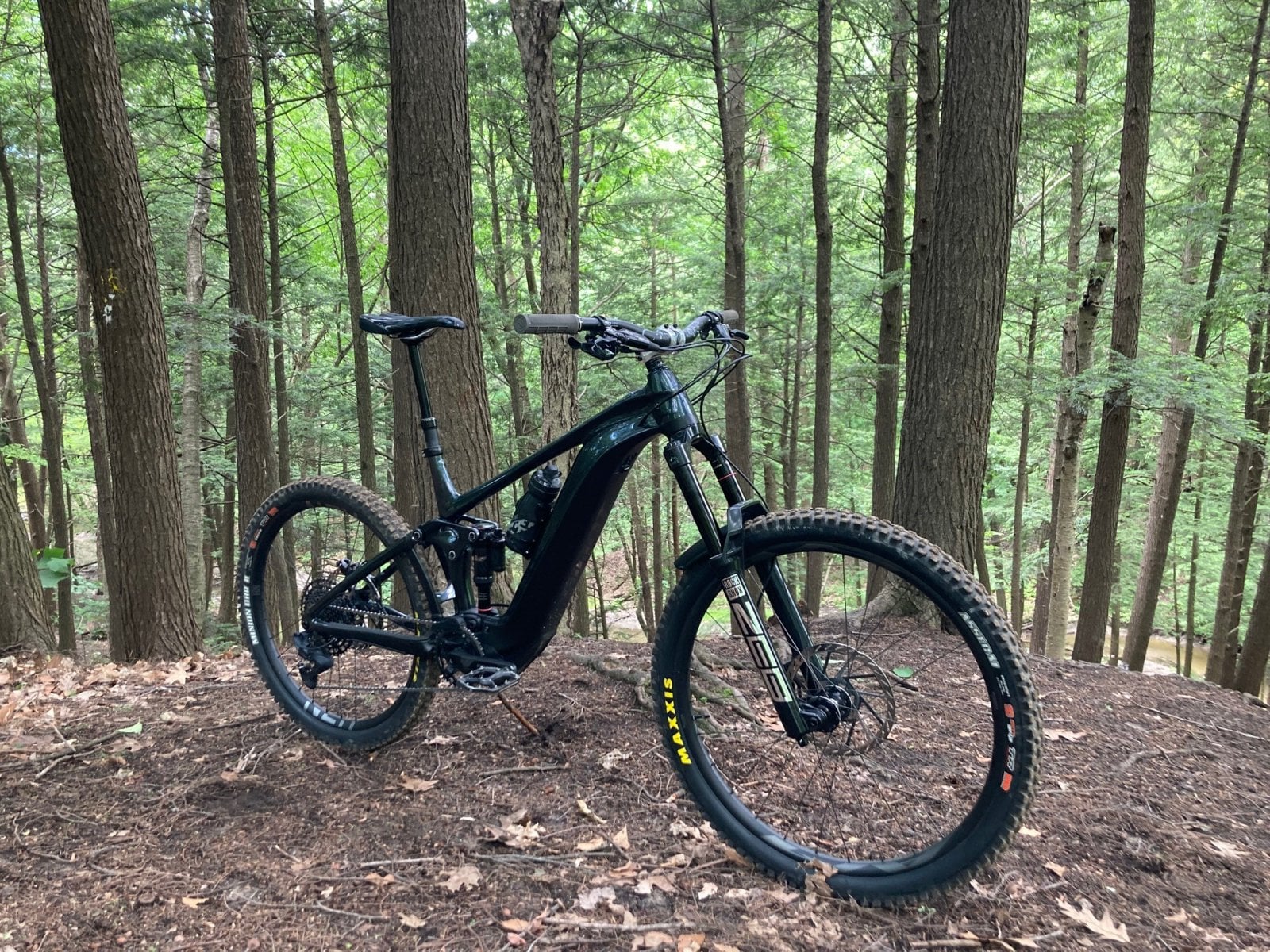

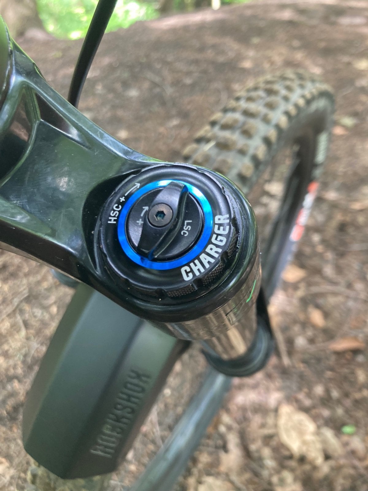

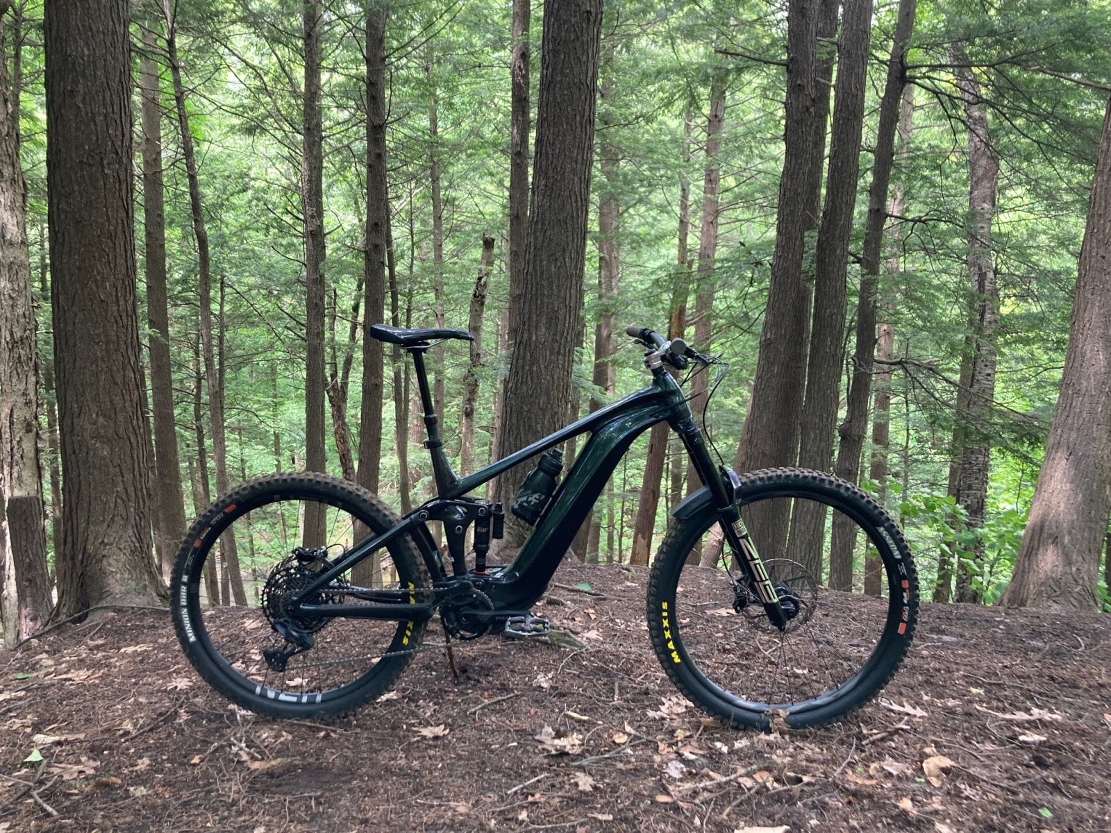

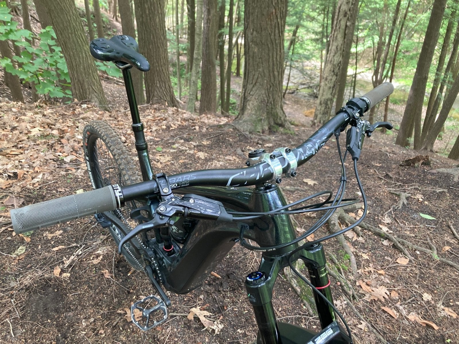

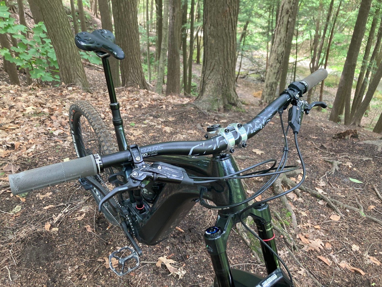

My Reign E+2 with a few new upgrades, posting again with the main components upgrade list :
  • Rockshox ZEB Ultimate
  • Rockshox Super Deluxe Ultimate
  • SRAM Code RSC w/ MTX Gold pads
  • SRAM HS2 220mm F&R
  • Chromag OSX 35 bar (800mm)
  • Chromag BZA 35 stem (50mm)
  • Nukeproof HZN V2 rear wheel
  • Maxxis Assegai maxx grip front & DHR II maxx terra rear, both double down casing.
Next up on the list would be a One up V2 210mm dropper & NOBL TR41 I9 Hydra carbon wheels with a lighter GX cassette, but most likely not before next season.

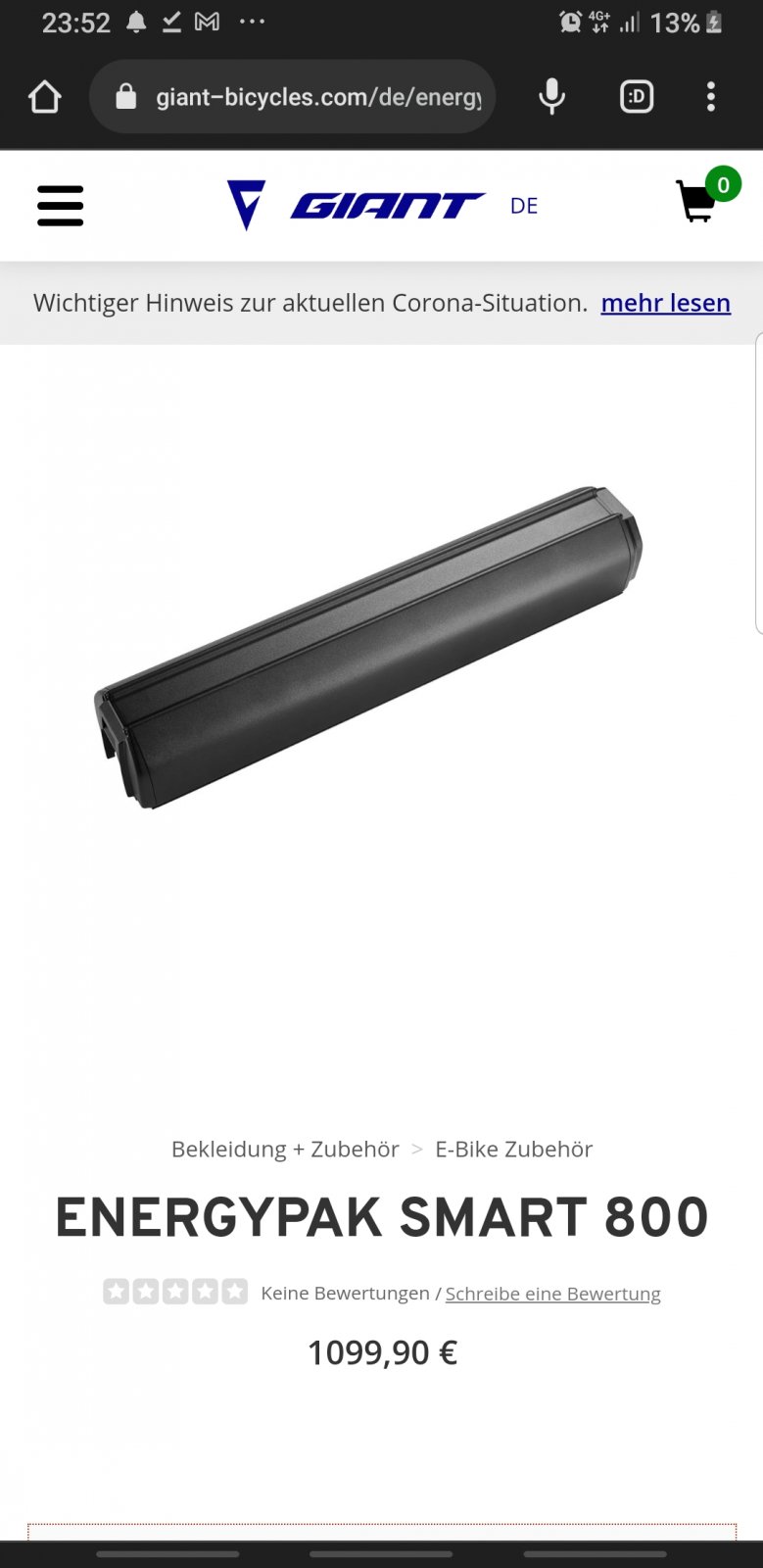

Does anyone know the difference between these 2 batteries please?
This is the one fitted in my 22 reign 625wh part no. 244M36625l-02V
I have chance to buy a used 625wh battery from an explore e+2 2021
Part no 244M36625l-01V
Same part no. Apart from mine ends in -02V the other is - 01V
Wondered if the V2 just a newer version of the V1 or something different.
Cheers.
