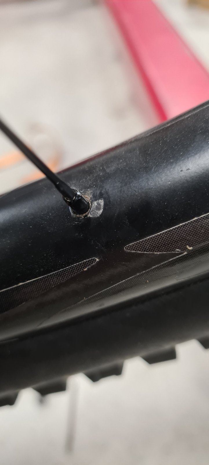

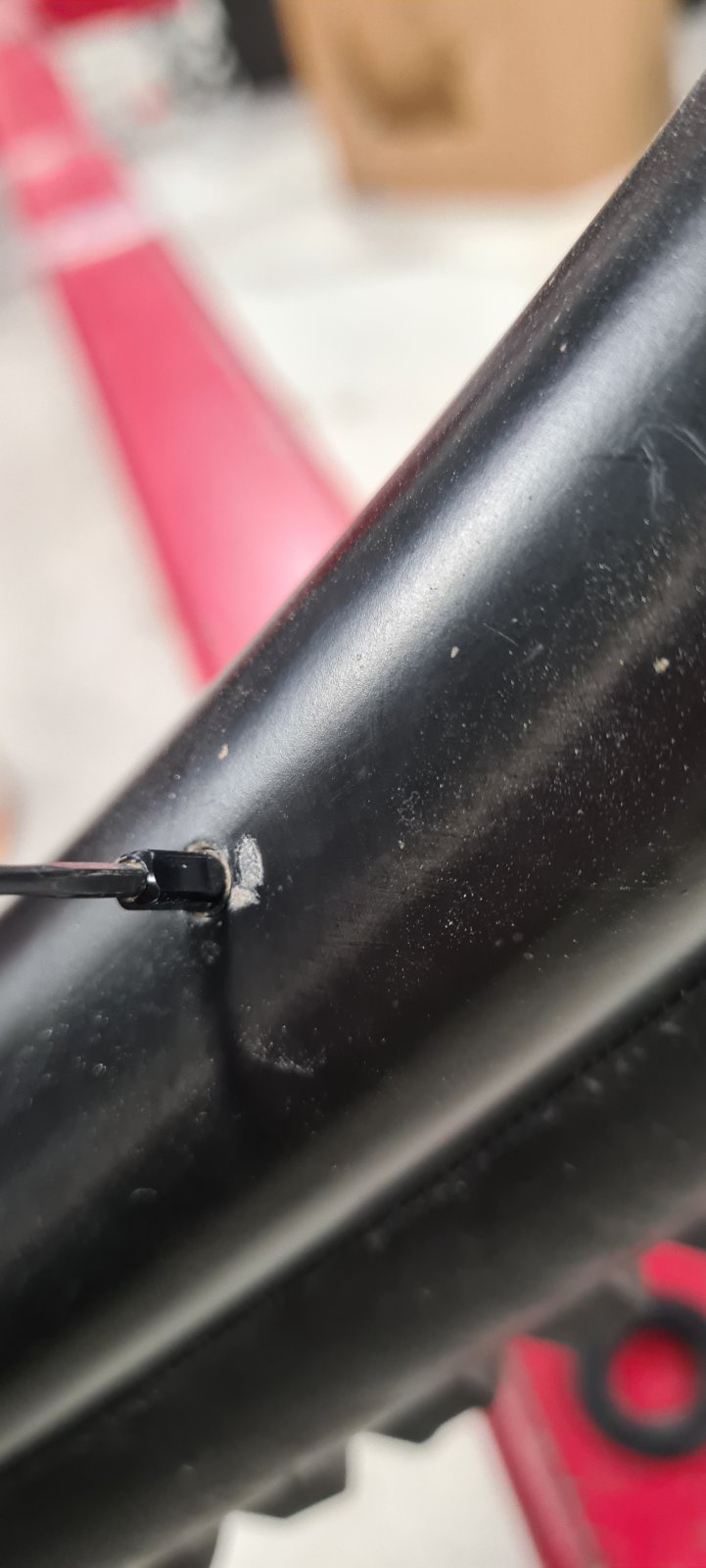

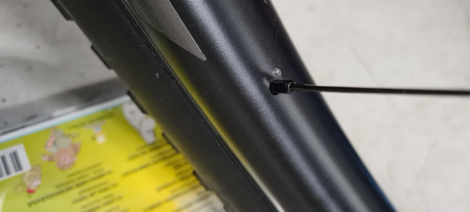

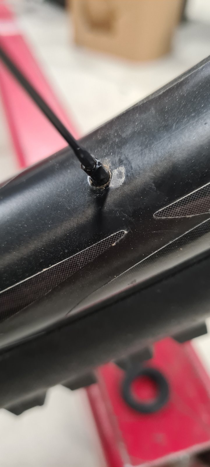

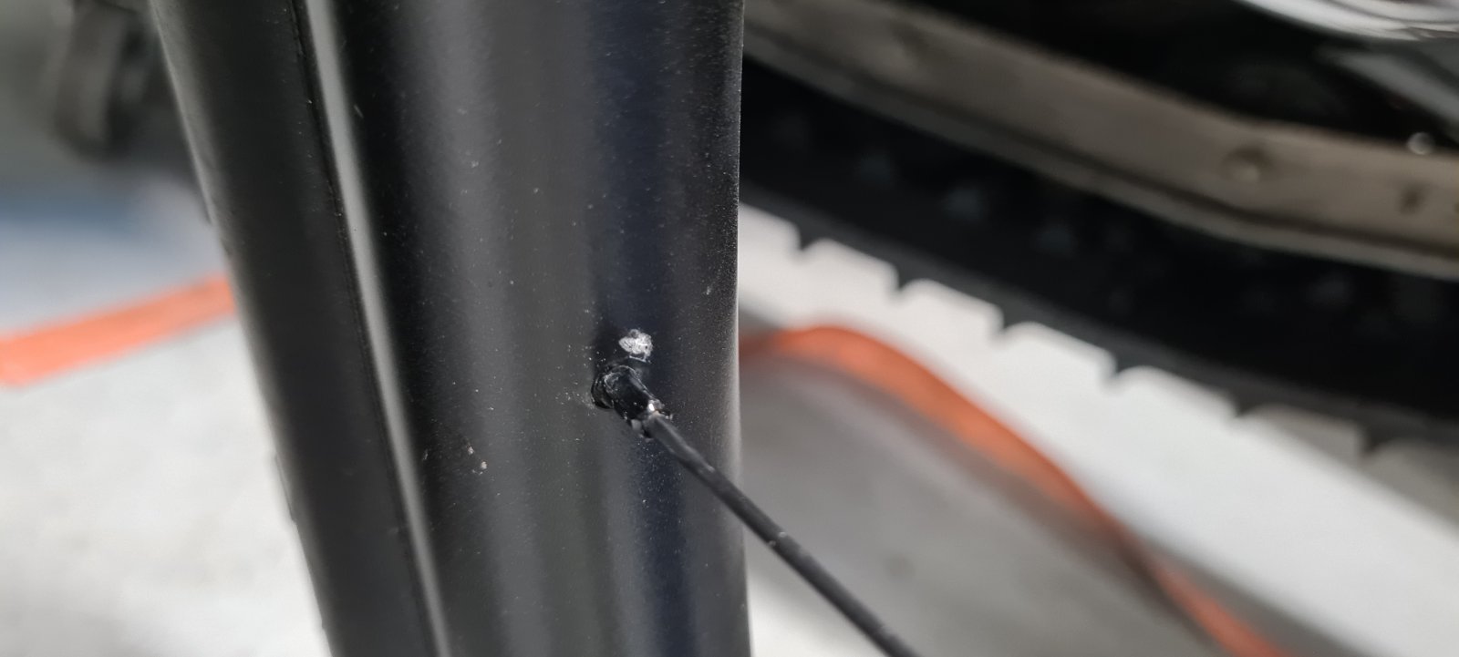

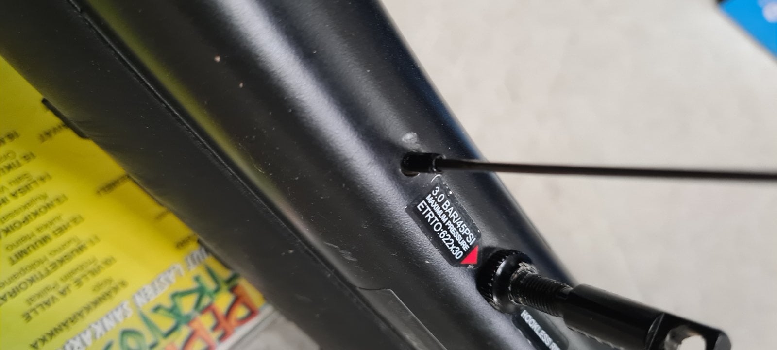

Hi guys... Do anyone has broken the eTRX carbon rim? mine is fault after 5 or 6 ride... the tyre was perfect, i hadn't any puncture and the pressure was still high. i think the side of the carbon rim is collapsed.
this is the photo. i'm still waiting Giant for the warranty
PS: do you have already tryed to use a 205x65 shock instead of hte 205x62,5?
Yes, rear wheel cracked, no marks, and no rocks in my area.
Surface damage has now appeared on my rims next to the spokes. There are front and back. These damages are only near the spokes.

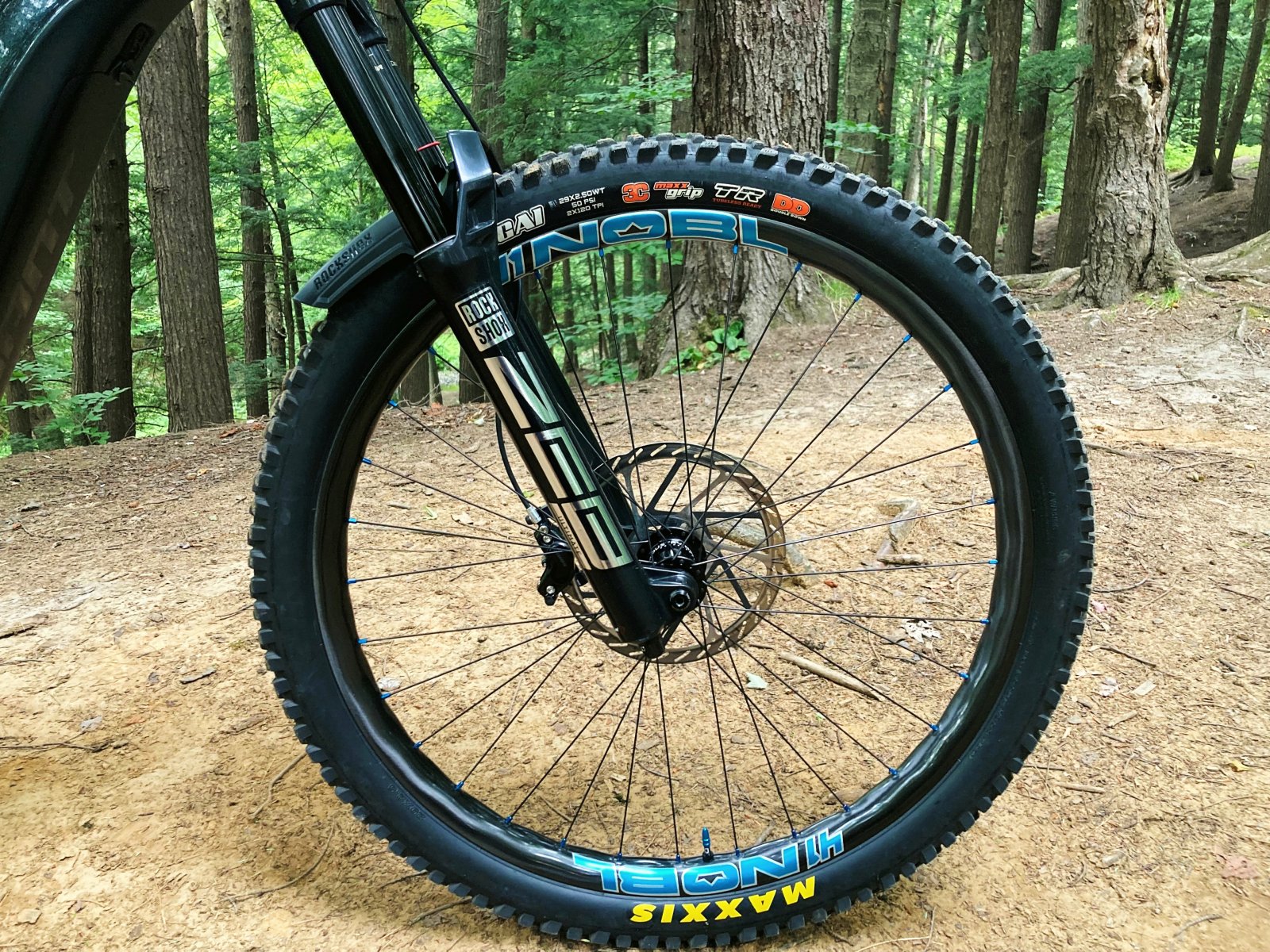

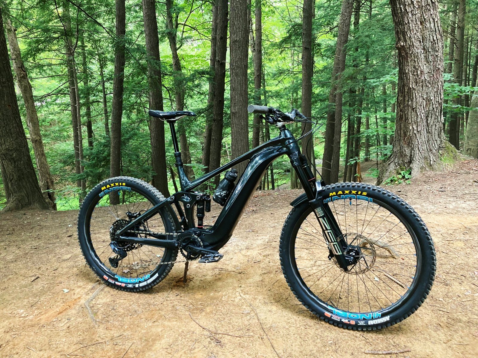

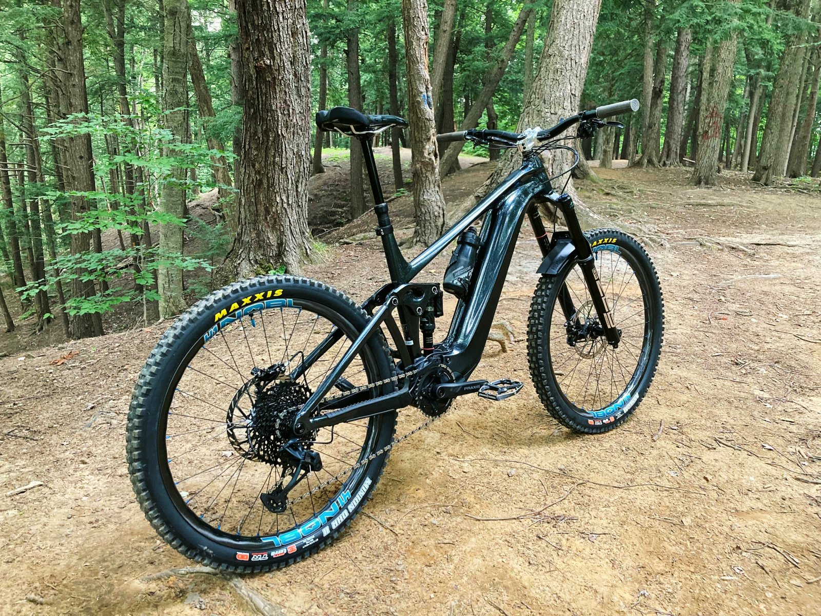

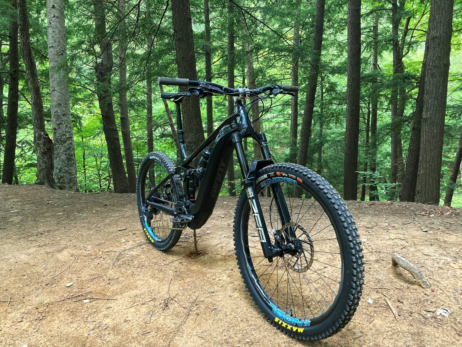

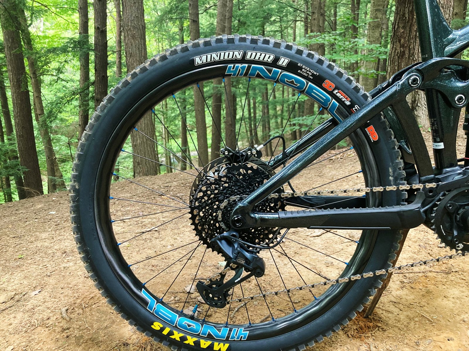

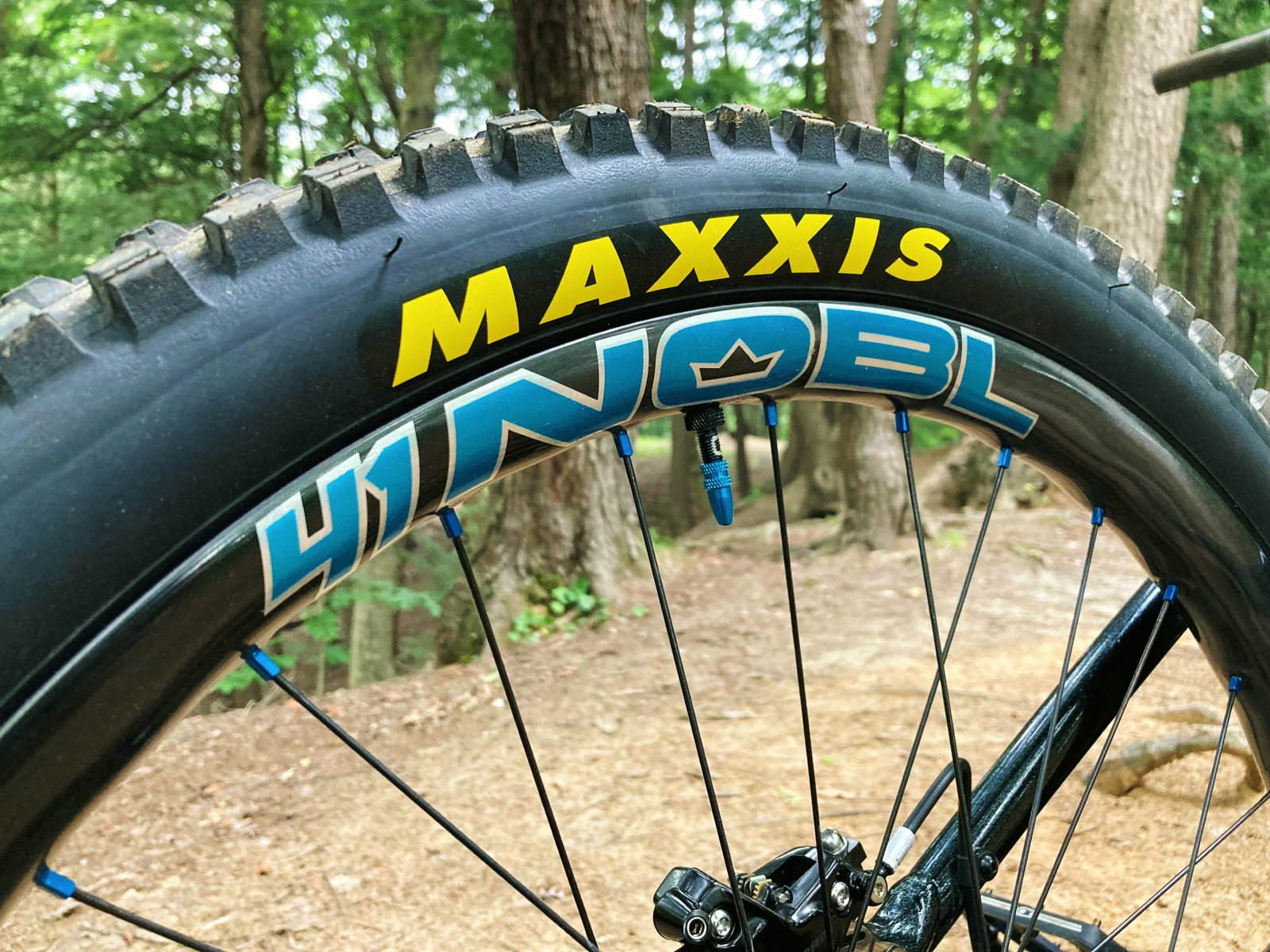

New wheelset day!
NOBL TR41 i9 Hydra with new SRAM GX 10-50T cassette, GX chain & fresh DHR II.
Stickers came out more turquoise than the darker blue I figured out, but still looks nice as the bike is dark anyway. Compliance seems pretty much on point for carbon wheels, can't wait to them to test them properly.
Bike lost around 1.3LBS with the new wheels & cassette, feels maybe a little bit easier to pedal as all the weight was rotational, but could be an impression. Quicker engagement of the Hydra hub is definetely noticeable even on an ebike and welcomed.
