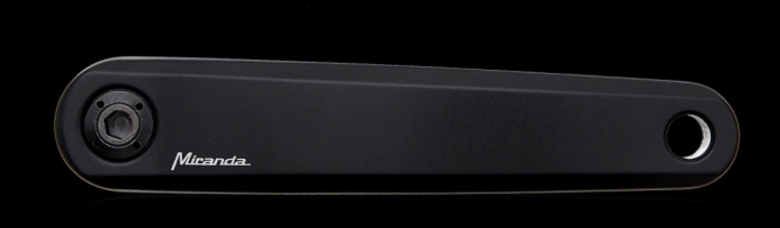

Just ordered Miranda 150mm cranks arms straight from their site. It comes with mounting bolts so that made the decision easy for me. Couldn’t find a better option closer to home in Alberta, Canada. Honesty a really great value even with having to pay shipping/exchange.
Delta Cranks 150 Q.0 RF Isis Cold-forged aluminium alloy Standard (Black) for E-BIKE
I hope I ordered the right ones. I’m not sure what Q is can get away with. These are Q0.

View attachment 92789Just ordered Miranda 150mm cranks arms straight from their site. It comes with mounting bolts so that made the decision easy for me. Couldn’t find a better option closer to home in Alberta, Canada. Honesty a really great value even with having to pay shipping/exchange.

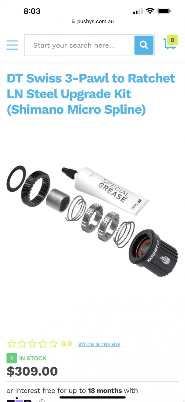

Has any one tried swapping out the 3pawl free hub to ratchet?
I’ve seen this kit online, although I already have 54t ratchet kicking about.

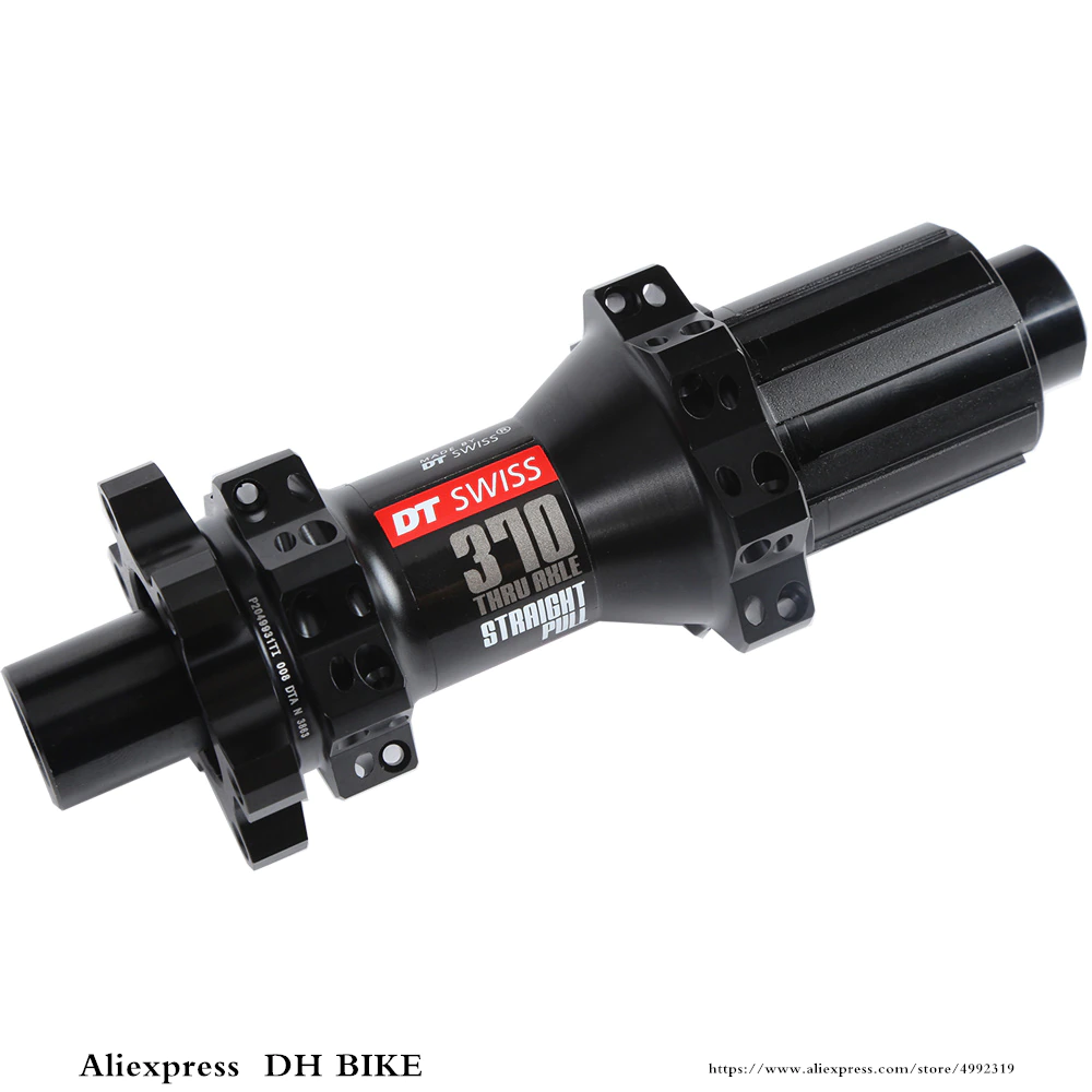

Seems the reign 1 and 0 have a 370 hub?

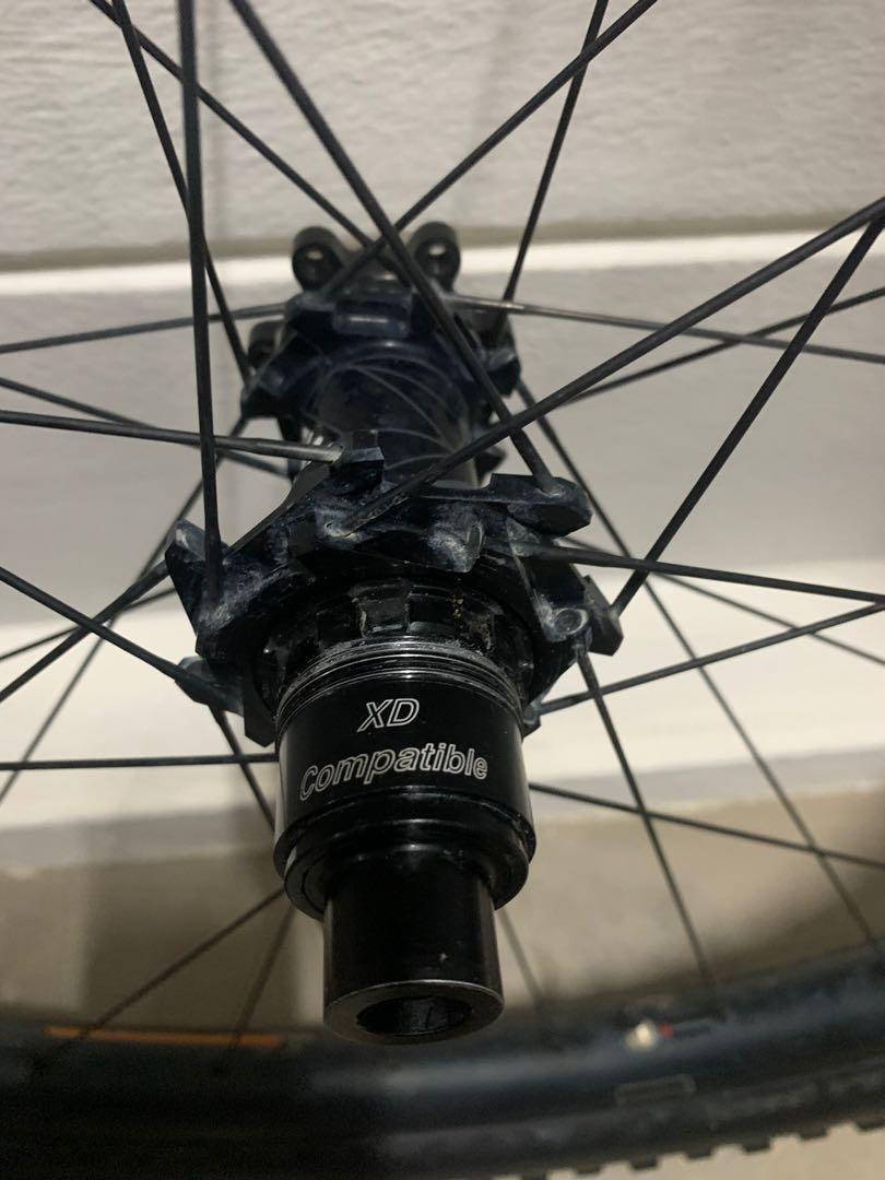

My 2020 reign e+1 stripped the threads inside the hub out so this bike will probably do the same.

Save yourself 100E and get the new (2021+) 350. Same engagement, few grams more and slightly narrower bearing spacing. Damed if I could notice those differences and I like black and white more than black and red. Easy choice for me.
in any case DT Swiss ratchet is tough to beat for reliability vs performance

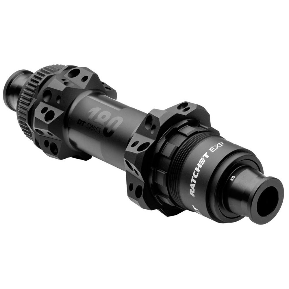

Are the giant hubs are DT Swiss 180s ?
On the Reign E+0 TRX wheels they are DT 240's I can't find any info on the E+1 TR1 wheels
E+1 has the DT Swiss 350s( I guess), because the ratchet is a marked DT Swiss 3 pawl design.
How can you be sure it's the 240s on the E+0?
because that’s what it says on the Giant Australia website. In hindsight that maybe just the TRX wheelset. Under hubs on the bike it just says Giant TRX hubs
I watched the recent YouTube video with EMTB and give all my pedal strikes on my Medium, I just had to try it. @Rob Rides EMTB just posted another great video with shorter crank arms on his Turbo Levo. So excited! Might be able to go back to the low setting on the flip chip.
So I screwed up and ordered the wrong Q. These are the correct ones:
the giant tr hubs look like in-house machined shells that use DT Swiss rear freehub and internals - similar to Specialized Traverse wheels that use the DT Swiss ratchet system. Below are pictures of the Giant TR, DTSwiss370 and DTSwiss180 straight pull rear hubs
The spoke anchor in the DT Swiss shells are different to the Giant hub.
The Giant wheels are also laced with sapim spokes which indicates that the wheels are probably not built by DT Swiss.

My take, I would not spend money converting the Giant/DT 3 pawl internals to ratchet (tools and conversion kit are costly) - it is more economical to buy a DT Swiss HX or EX replacement rear wheel on sale or build a new wheel using a quality hub, spokes and rim.

Inside the hub where the pawls engage there’s a toothed ring That threads into the hub.,
The threads stripped out,
Was all good my local giant covered it under warranty
