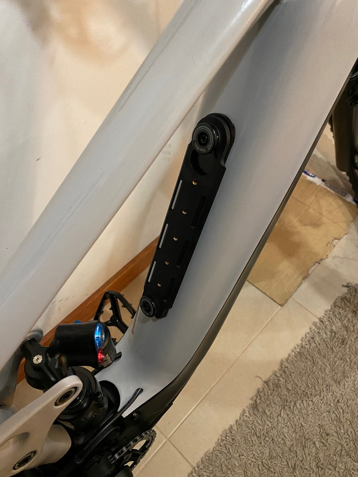

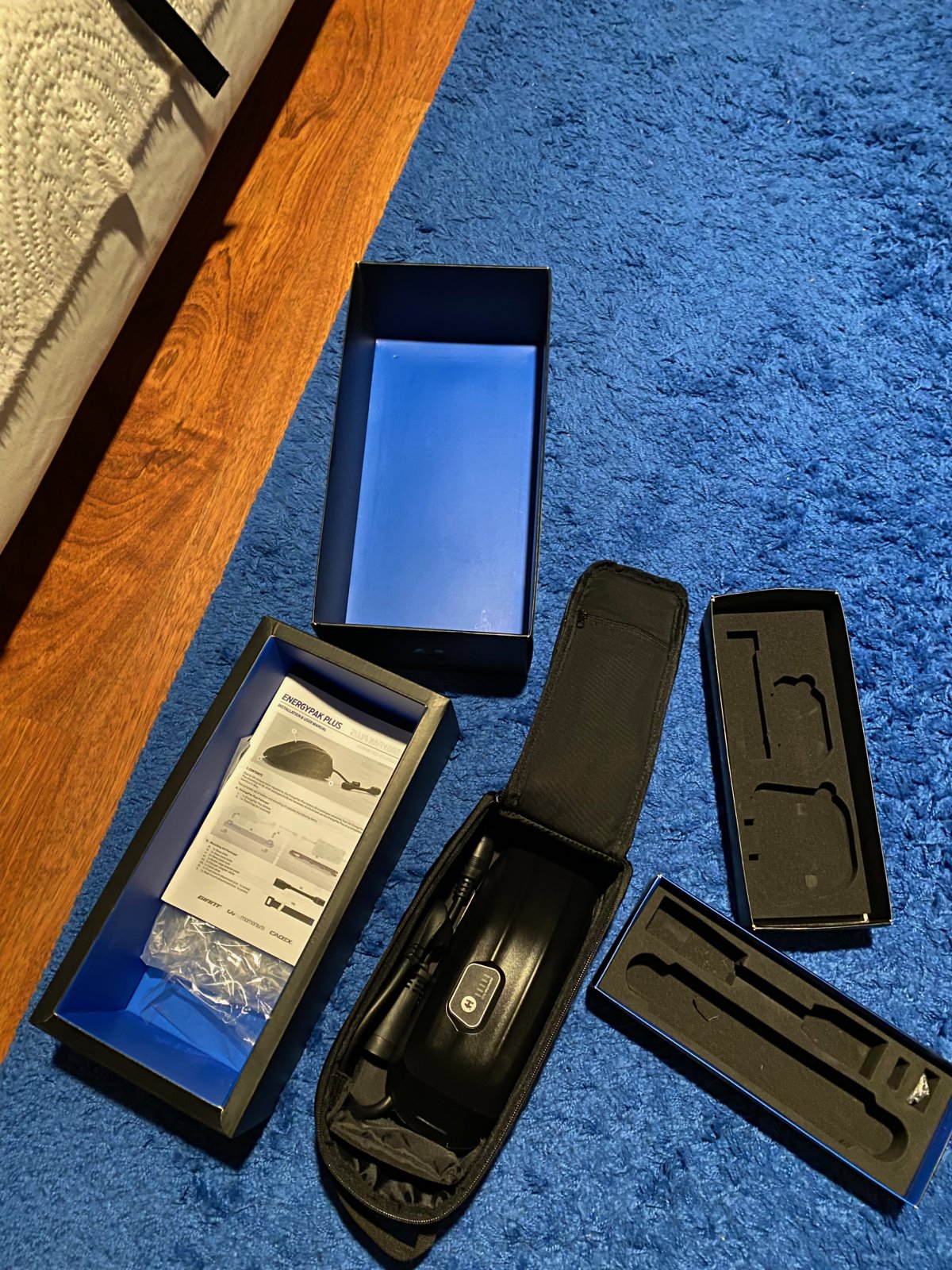

I have the EnergyPak Plus 250 Wh range extender and even though I’ve had it for 5 weeks now (for as long as I’ve had my Reign E+ 1 with the 625 Wh battery) I have not used it yet as I’ve just went through the process of installing the support.
From what I’ve read you can plug it in and turn it on at any time, but the bike will only draw energy from the extender when the main battery reaches about 5%. Then, once the extender runs out of juice it switches back to the main battery to use those remaining 5% or so. I’m not aware of any way to change this behavior.

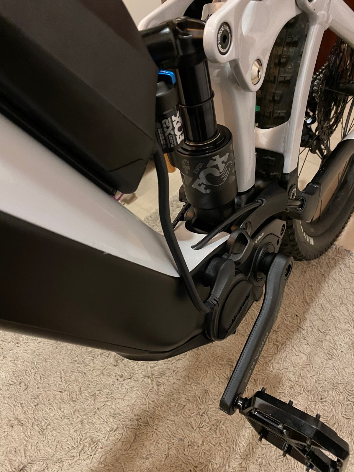

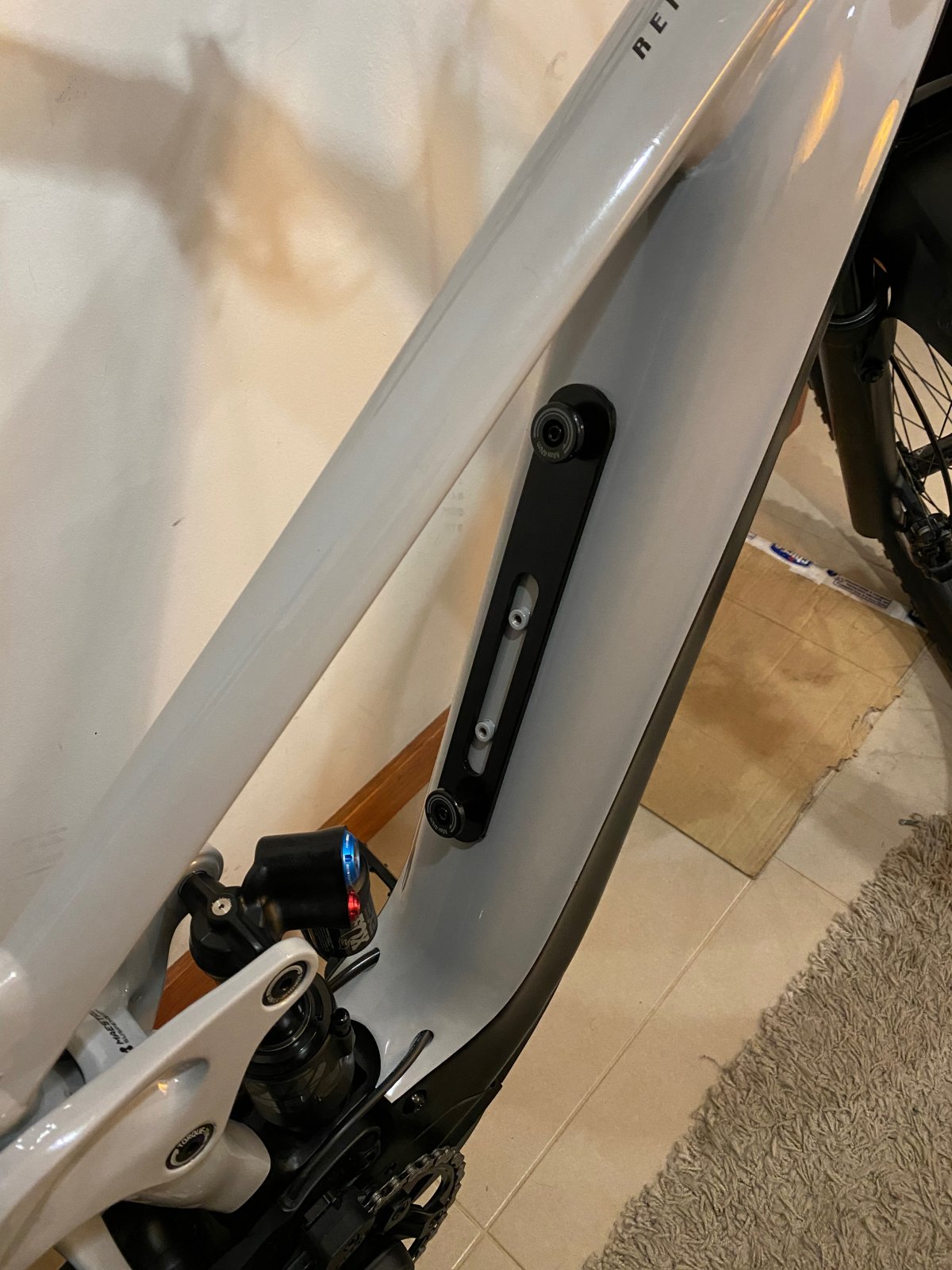

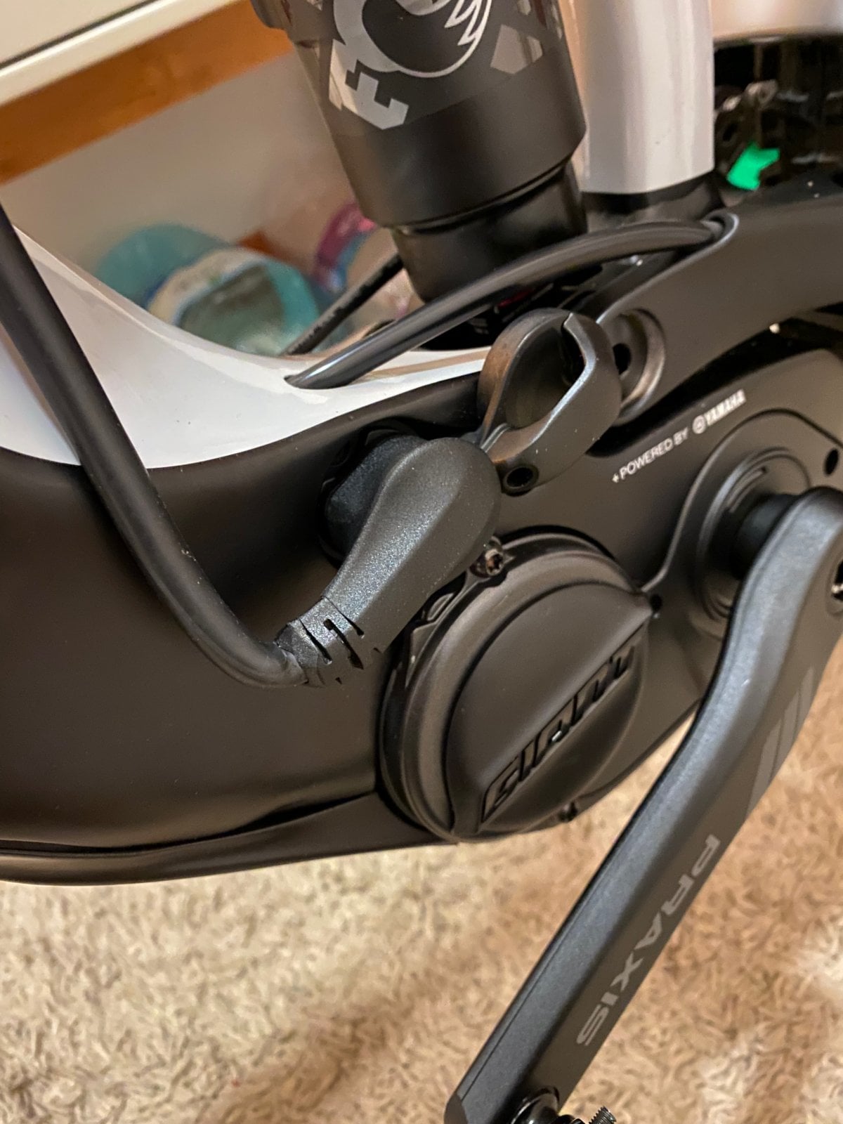

Here are some random notes and some pictures:
  • Packaging is nice for both the extender and the mount, feels premium, almost iPhone like;
  • It doesn’t look terrible with the E+ 1 colors (doesn’t look good either, in my opinion);
  • The aluminium support rests against the frame, so I’ve put some electrical tape beneath to protect the paint job;
  • The bottle cage mount holes in the frame are left open and the holes to mount the extender support itself are flush with the frame, so it looks fairly easy for water to get in;
    • Since the bottle cage mount holes aren’t flush, it is unlikely that water gets in if I have the bottle cage plastic piece that comes with the kit attached (even though I don’t use a bottle holder);
    • The mount holes look more problematic - I’ve stuffed some tape in it, let’s see how it goes (I hose down my eBikes - a Stance E+ 1 and this Reign E+ 1 - and moderate/heavy rain and wind don’t get in the way of my rides as both the 5/10 TrailCross GTX and the FOX 3L waterproof stuff do their job properly);
  • The actual cord is very short and it is a very tight fit when connected to the bike as you can see in the pictures - it definitely doesn’t feel that it was made for this bike, even though it works (let’s see if the bent cable won’t break or if it won’t damage the bike);

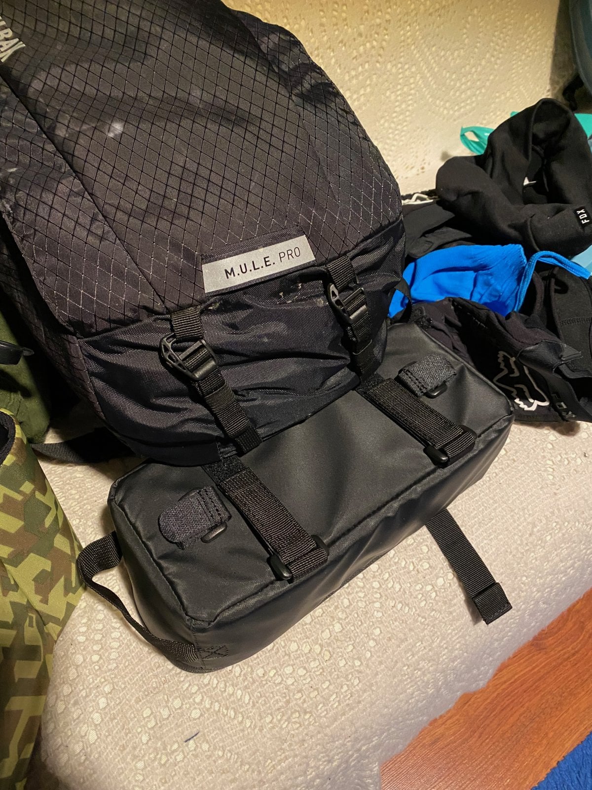

  • It comes with a nice carrying case - it's not completely useless for me as I can attach it to the Camelbak MULE Pro's bottom straps if I don't want to carry the battery inside the backpack or mounted in the frame.

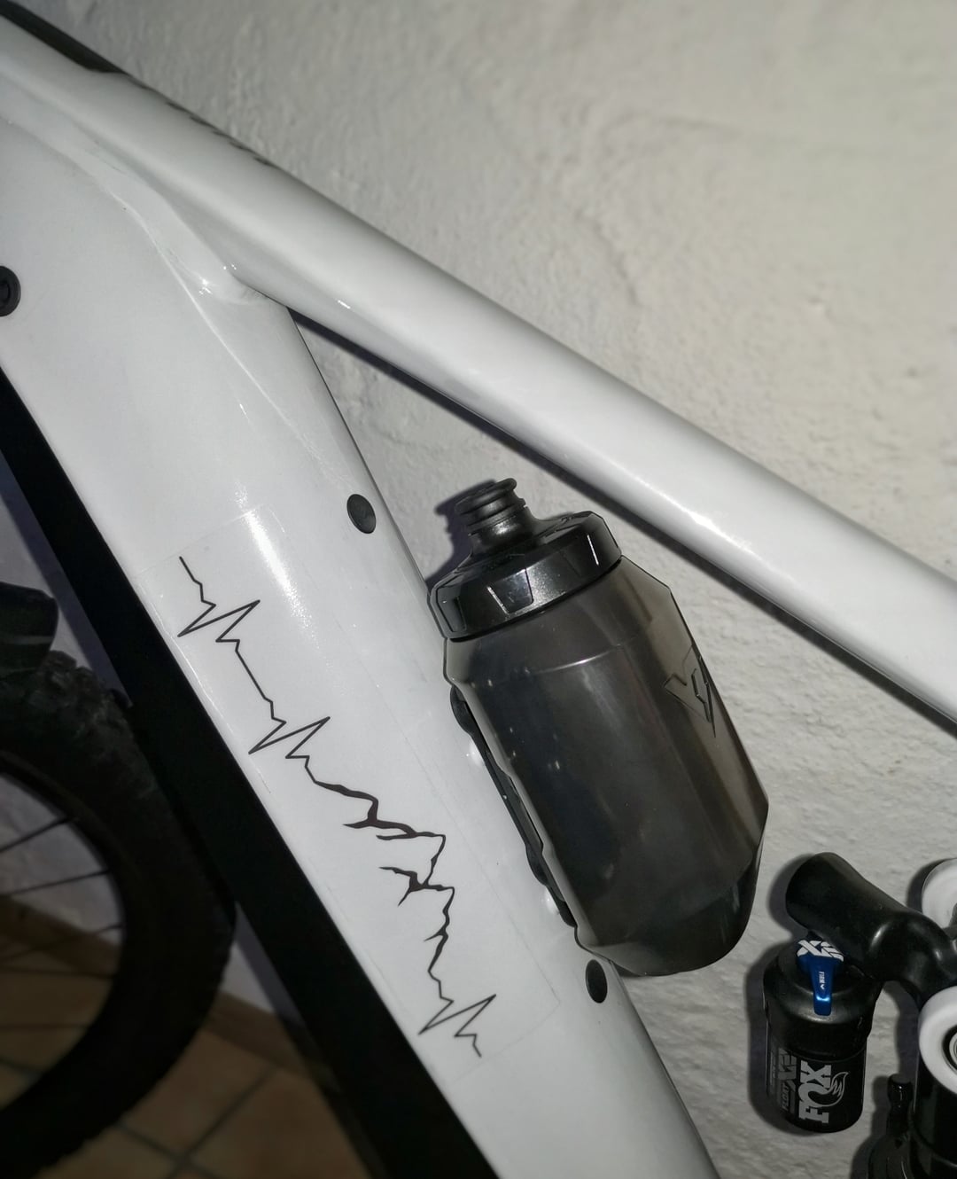

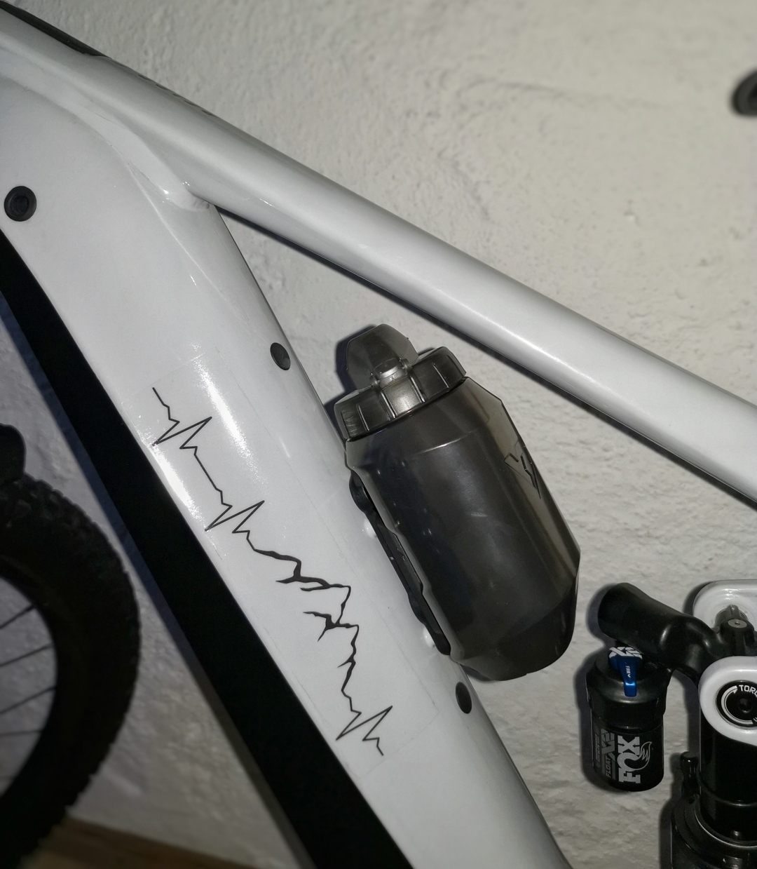

I'm using a 600ml YT Thirstmaster 4000 on Medium Frame - lots of clearance. Even when mounted on the rail of the battery Extender ❤️
There is a noticeable difference between Thirstmaster and normal Fidlock 590ml bottle though. With 590ml you have a nice cover that allows you to enjoy water without mud and dirt.
The Cover from my 450ml and 590ml Fidlock bottle fits to the TM 4000 too 😁
But more importently if fits into a Medium frame where the FL 590 doesn't.

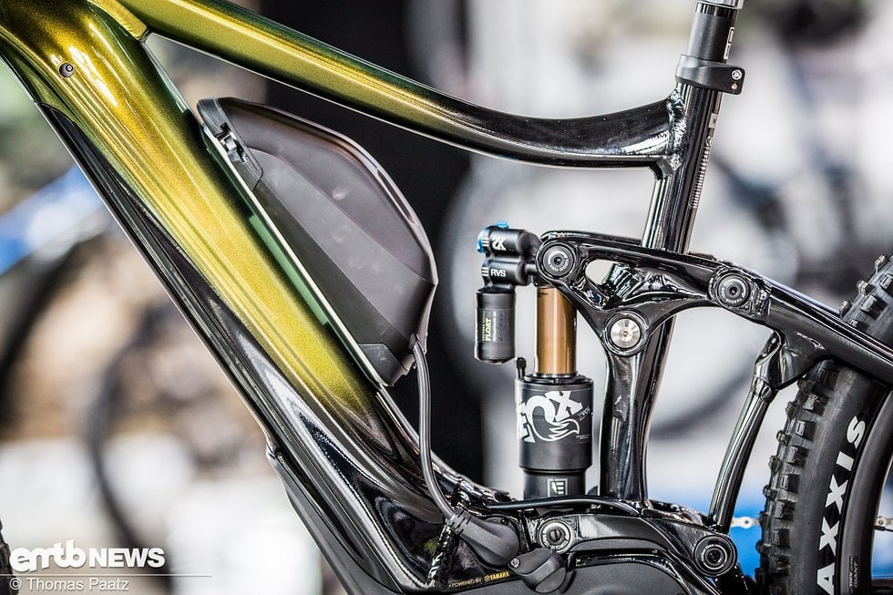

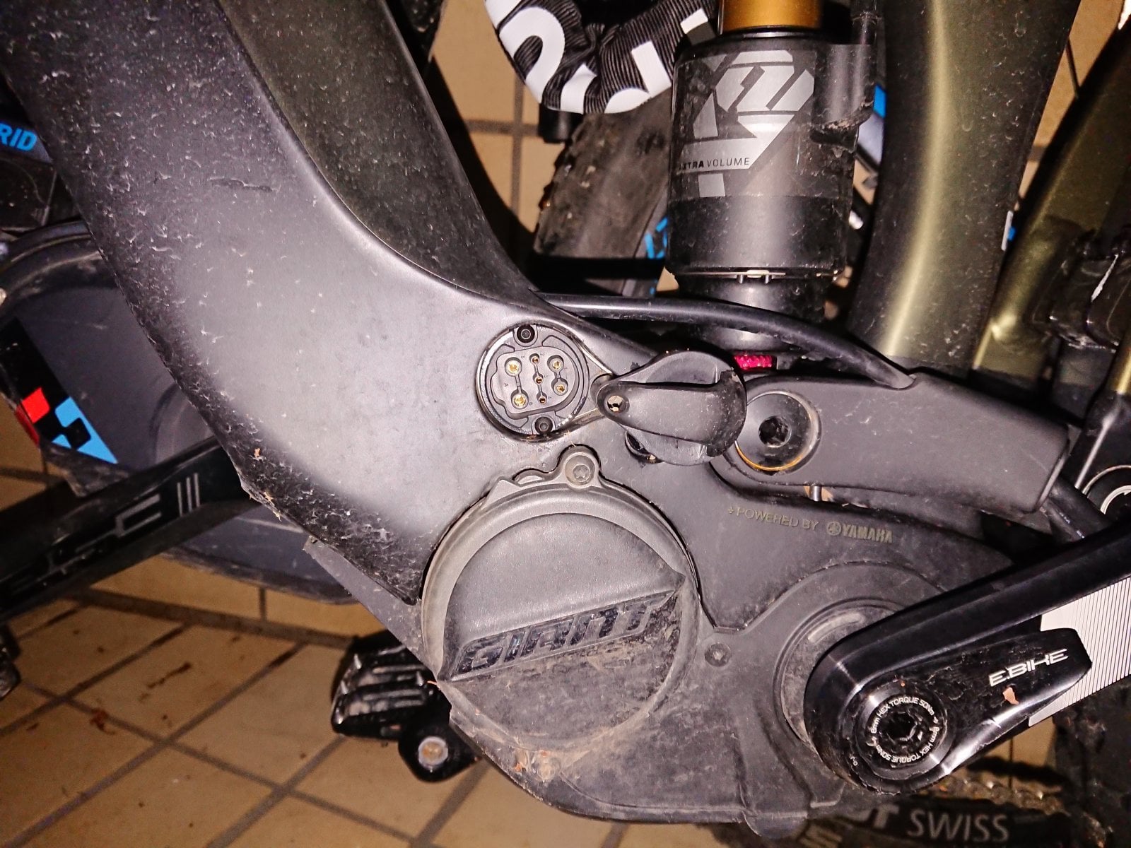

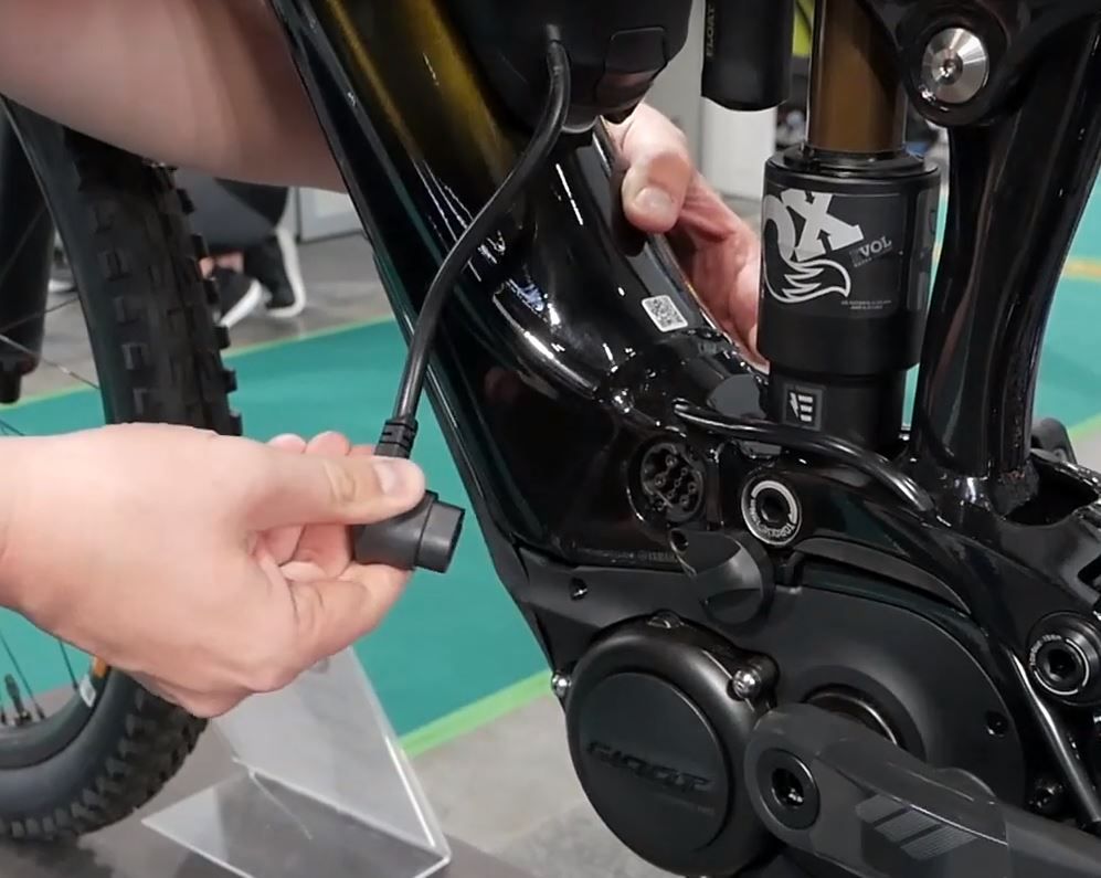

This cable looks super bad. In the old Reign e+ the angle at which it entered the socket was rotated 90 degrees. Is there any chance you put it at the wrong angle? Or that socket was installed incorrectly? This is like it used to look like:
Answering my own question. The old Reign had a socket at completely different angle. Pointing up towards the battery:
New one is pointing down. So basically 90 degrees change :/
I have my serious doubts if this socket could be rotated :(

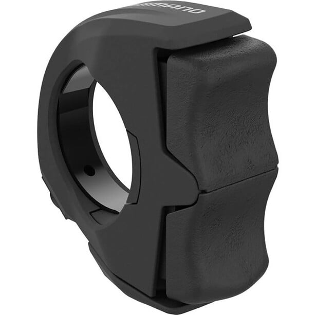

Wondering if the remote is just buttons or if it has real communication. If it is just push button nothing is stopping ppl to design their own or hack in shimano remote.
