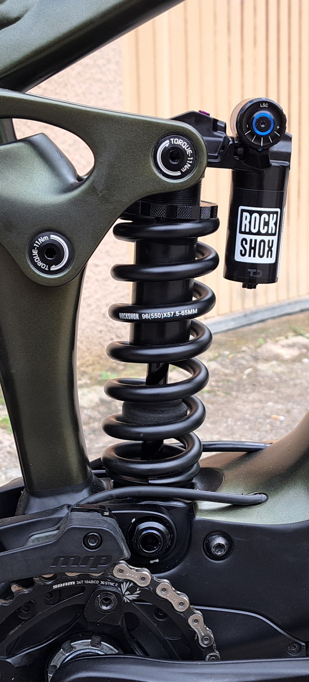

With Vivid Coil, you cannot adjust it because you have to put off the rebound knob (hit the frame).
I think SDCU rebound knob is shorter and can stay on the bike.
So do you have to remove the rebound knob to get the shock to fit in the frame?
The rebound adjustment can be done by making a modified tool from an Allen key.
So do you have to remove the rebound knob to get the shock to fit in the frame, and then once the knob is removed and the shock is in place, can you cut down an Allen key and use that to adjust the rebound?
Yes 👍
sort of helpful alternative, but after ANOTHER X2 shat itself, I went instead with a Bomber CR from J-Tech, they set it all up for me, installed it easily and it rides bloody superbly (and should I need, can access damper settings)
I tried a 205x65 suntour voro coil and it made contact with frame from the shock bottom retaining clip, slightly when full travel was reached and I removed it and put back the float x that came with bike
Thanks for the photo, yep that looks pretty tight, but looks soooo much better then the Float X. What kinda weight are you, I`m about 70kg and had a 500lb spring on my old ReignX2, The Reign E+ is obviously a fair bit heavier so not sure what spring to go for?
Keep your 500lbs
I am 85kg and 550lbs was perfect 👌
I just looked it up, apparently its the same as the fox vanRC, which is what I had on my analogue reign!
Keep your 500lbs
