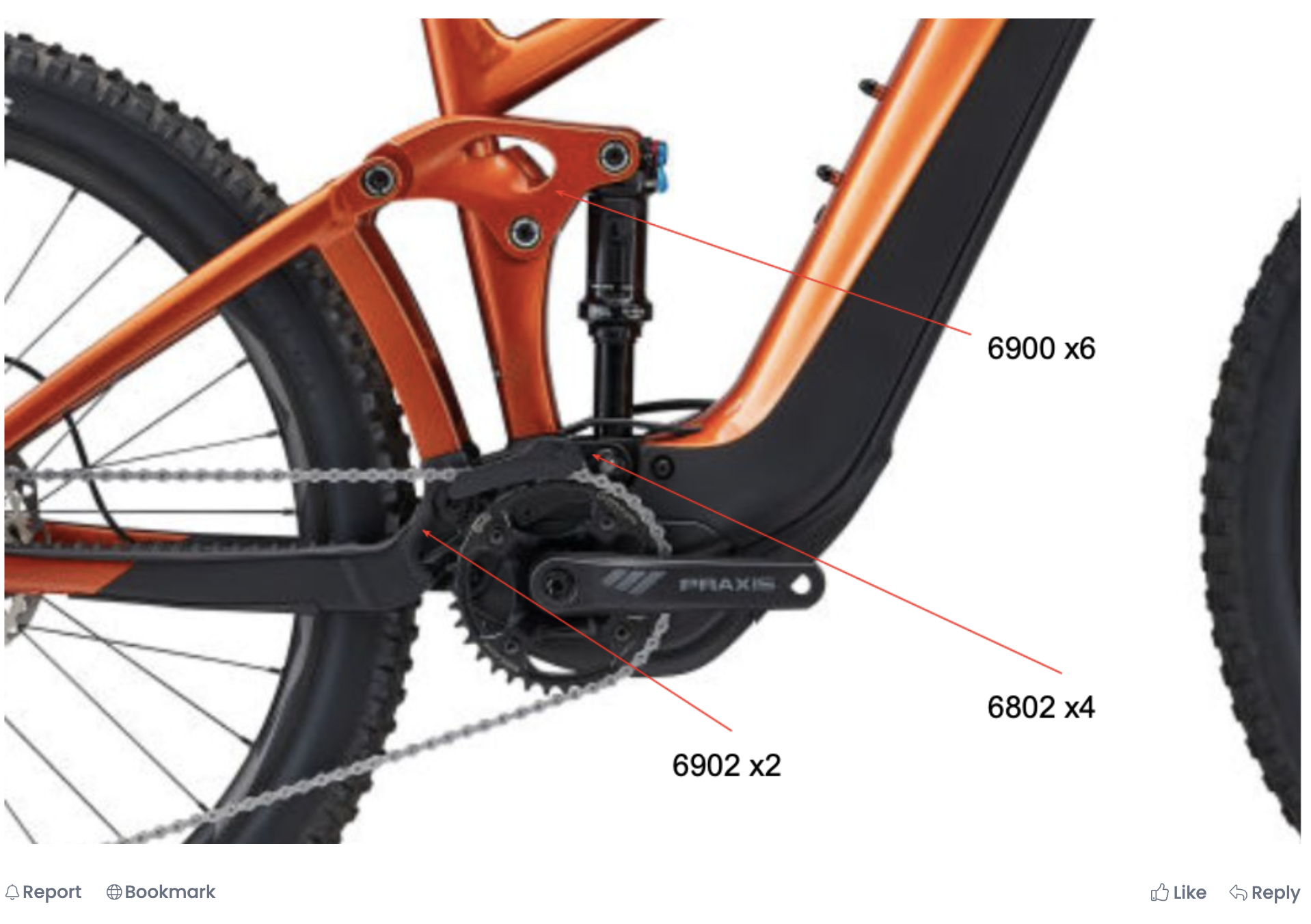

After owning the Reign E+3 for a little over 2.5 years, putting a bunch of miles and a lot of upgrades on it, I was thinking about servicing the bearings. Neither can I find any information whichs bearings I need nor do they sell any packages containing stuff for a full rebuild. I'd be ok with knowing the measurements and type of bearing, so I could order some on my own. Is there any reliable site to get those info without having to deal with the giant support via email? I know, I could just measure myself, but if I start to disassemble the bike, I would love to just get it all over with.
I lucked out and found a seller on eBay selling all the bearings as a set awhile back. They are the Enduro Max bearings. I have them ready for when the time comes to replace them.

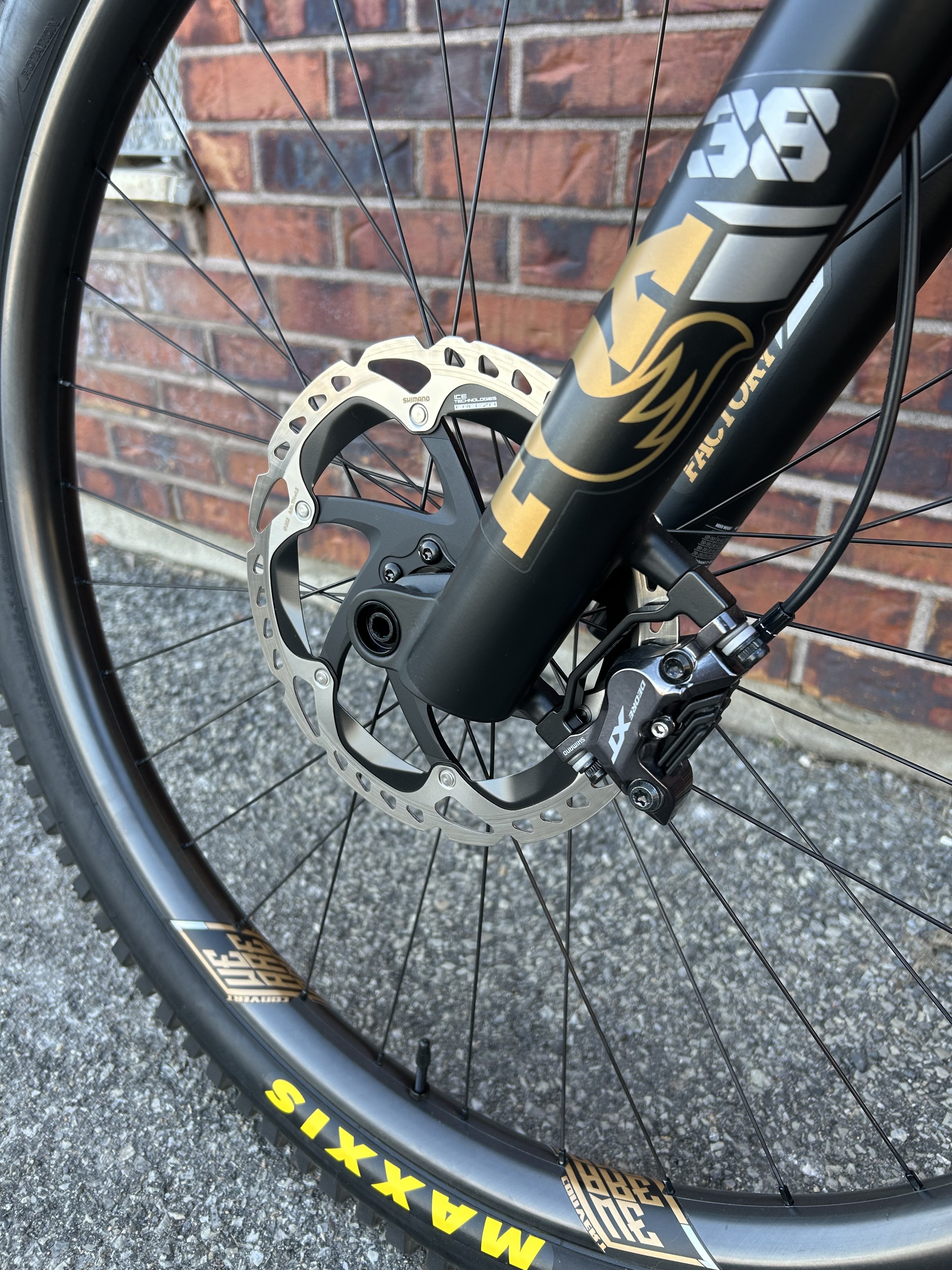

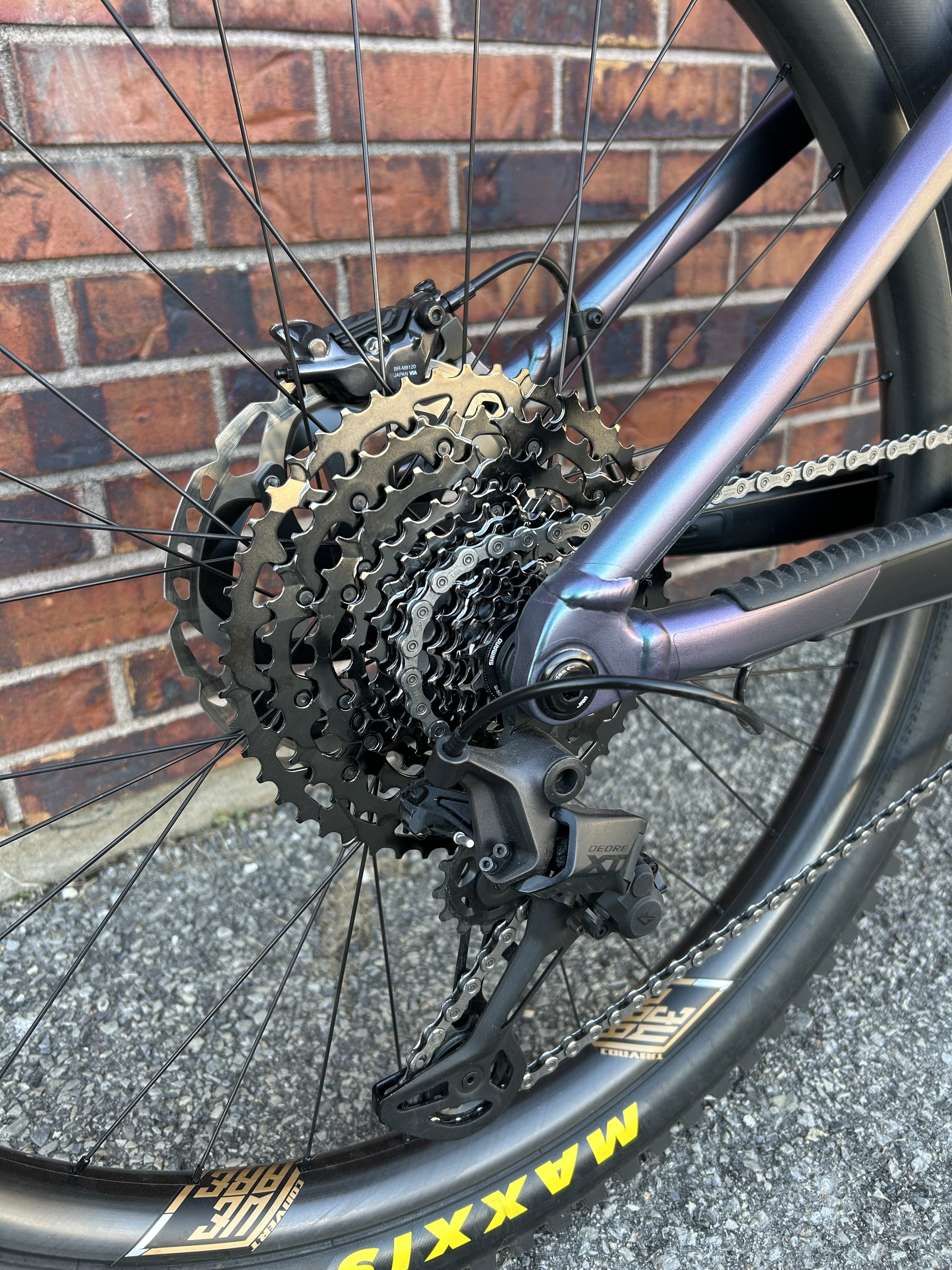

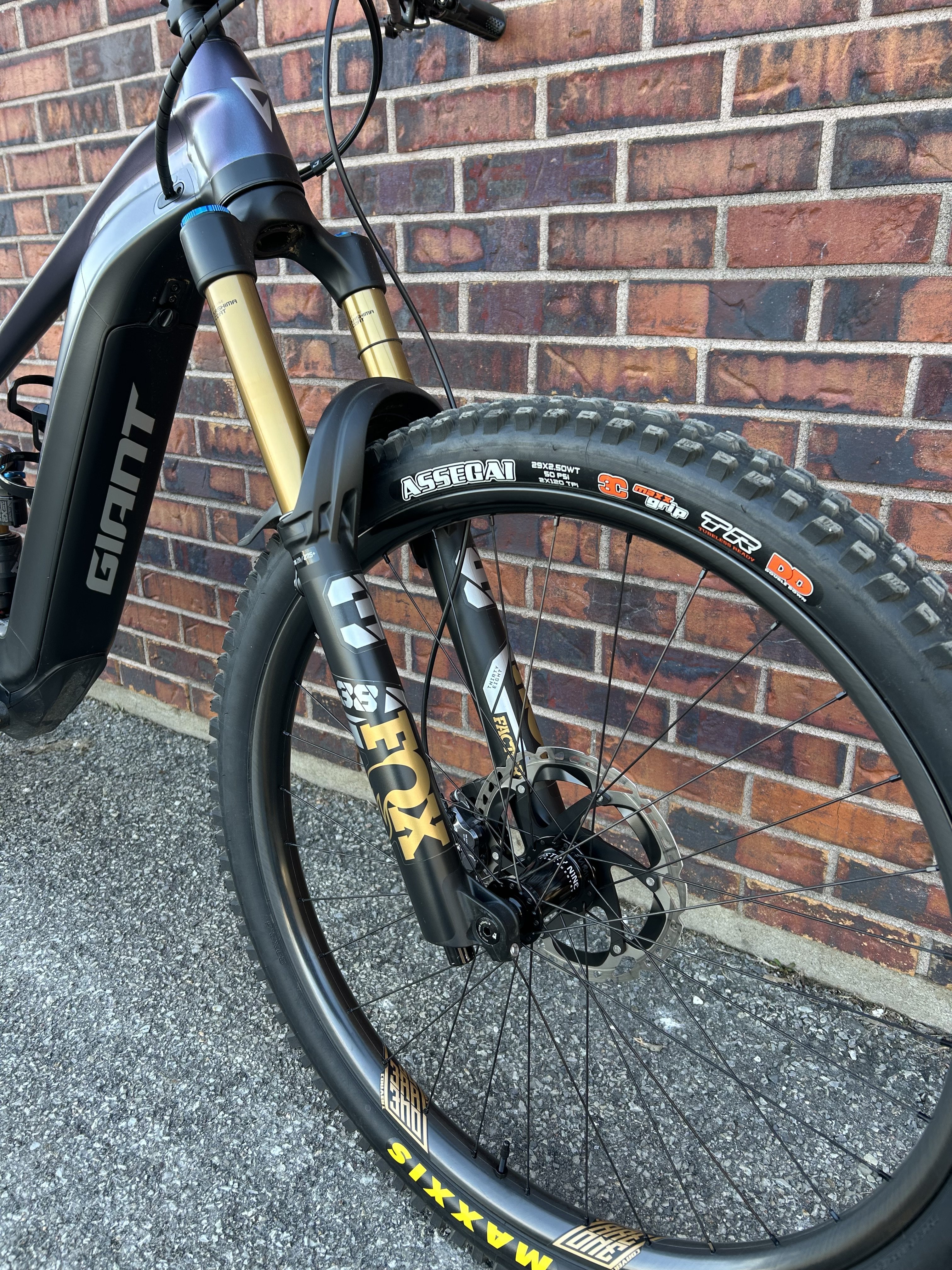

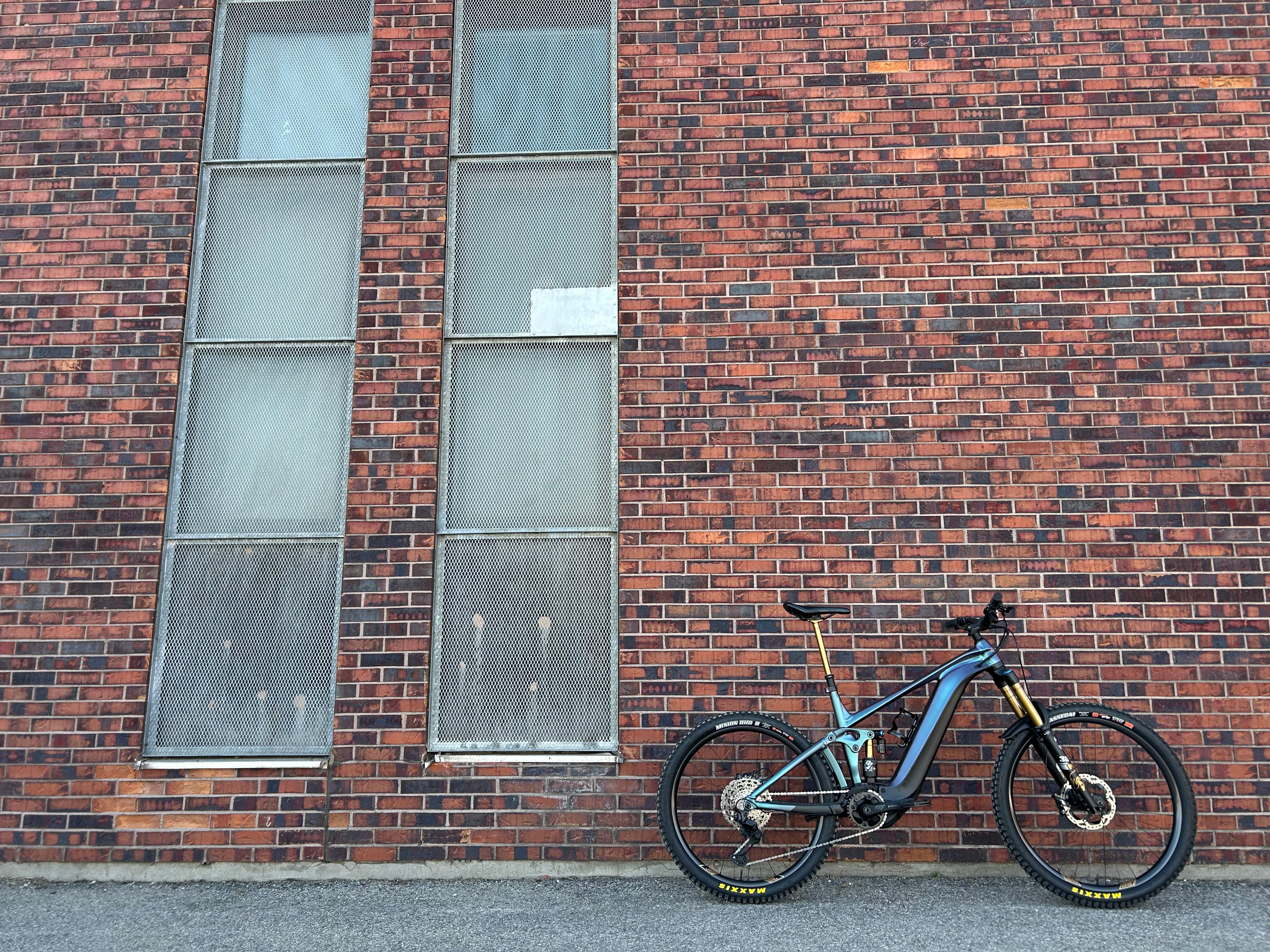

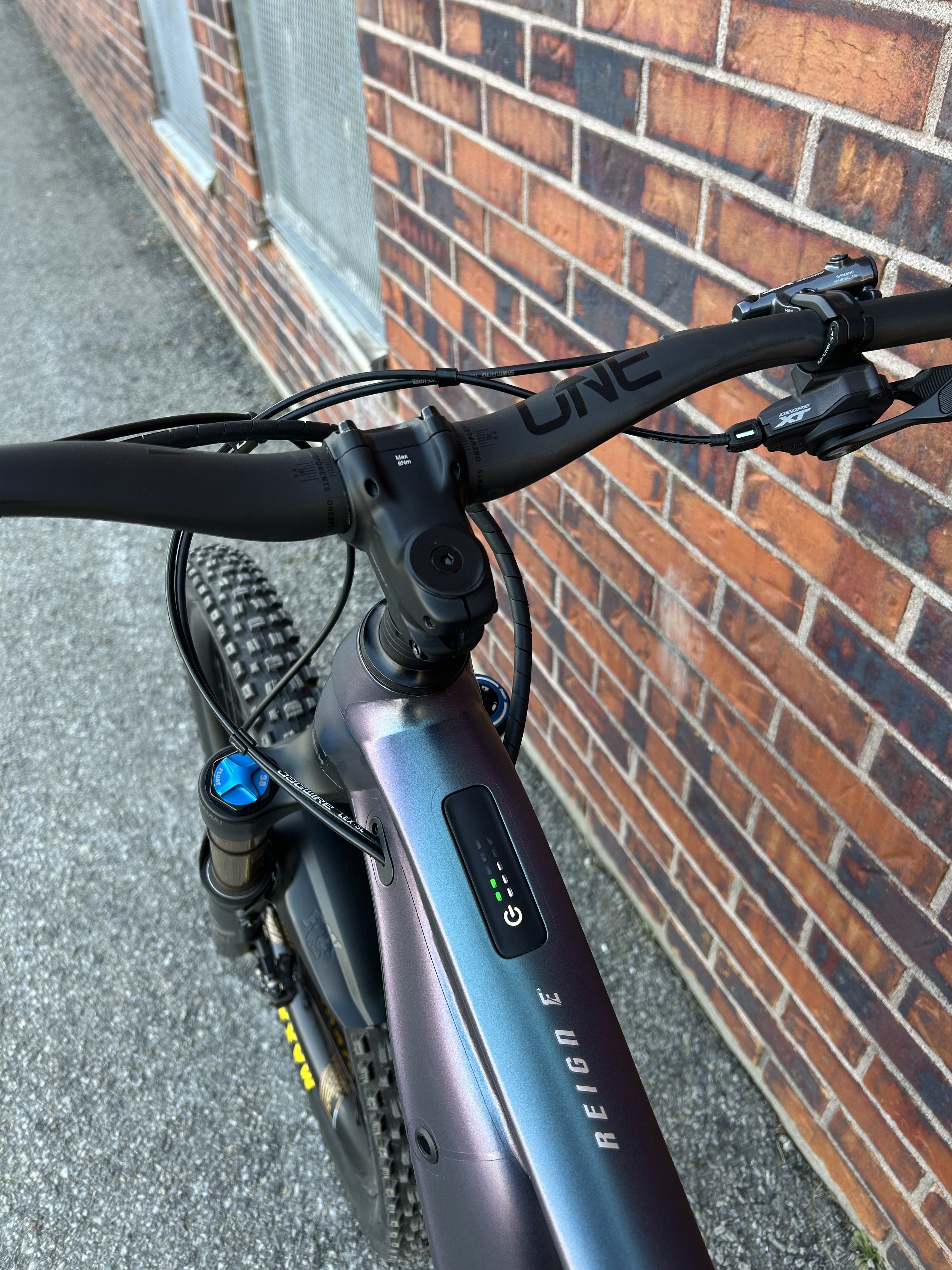

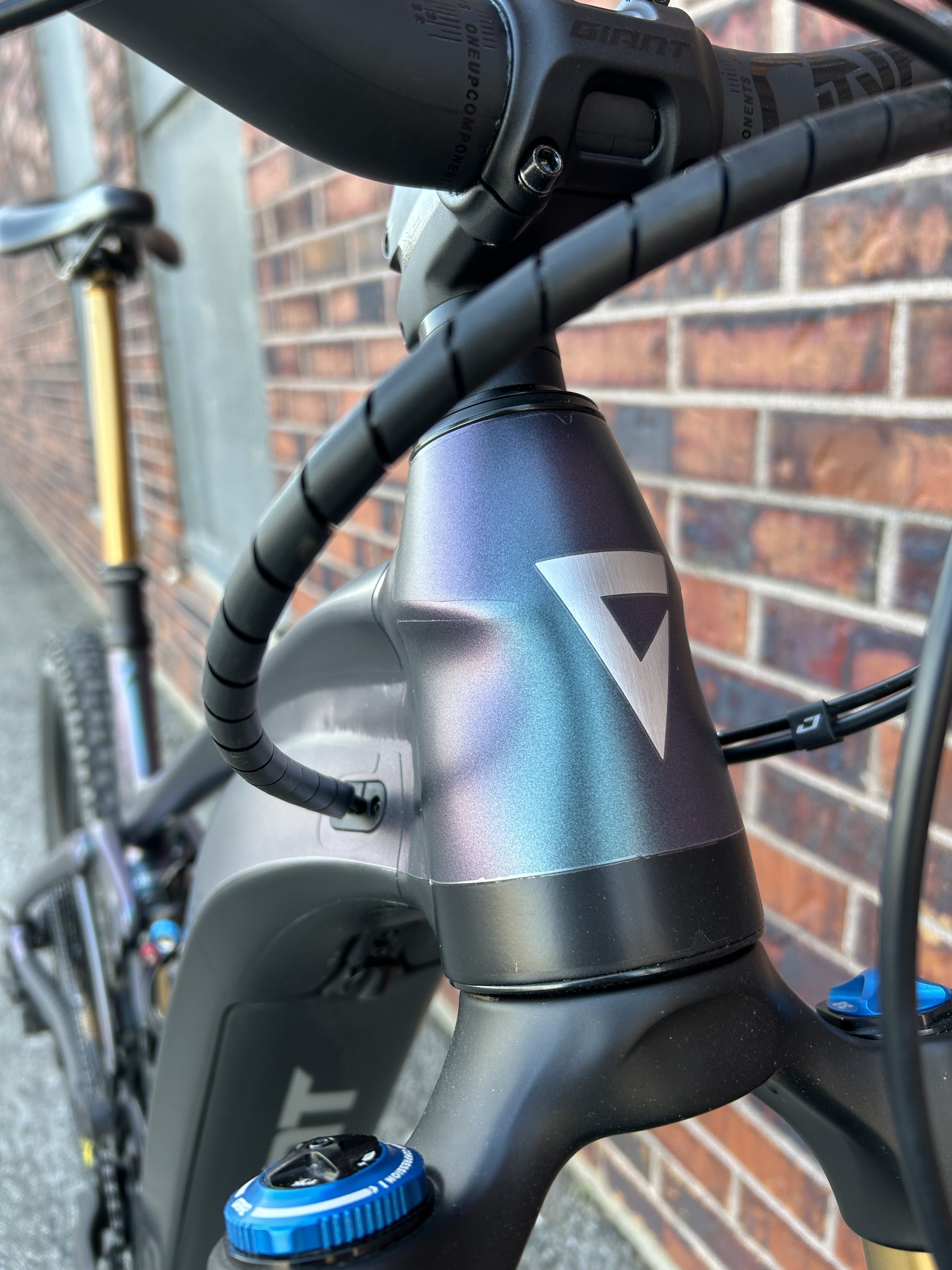

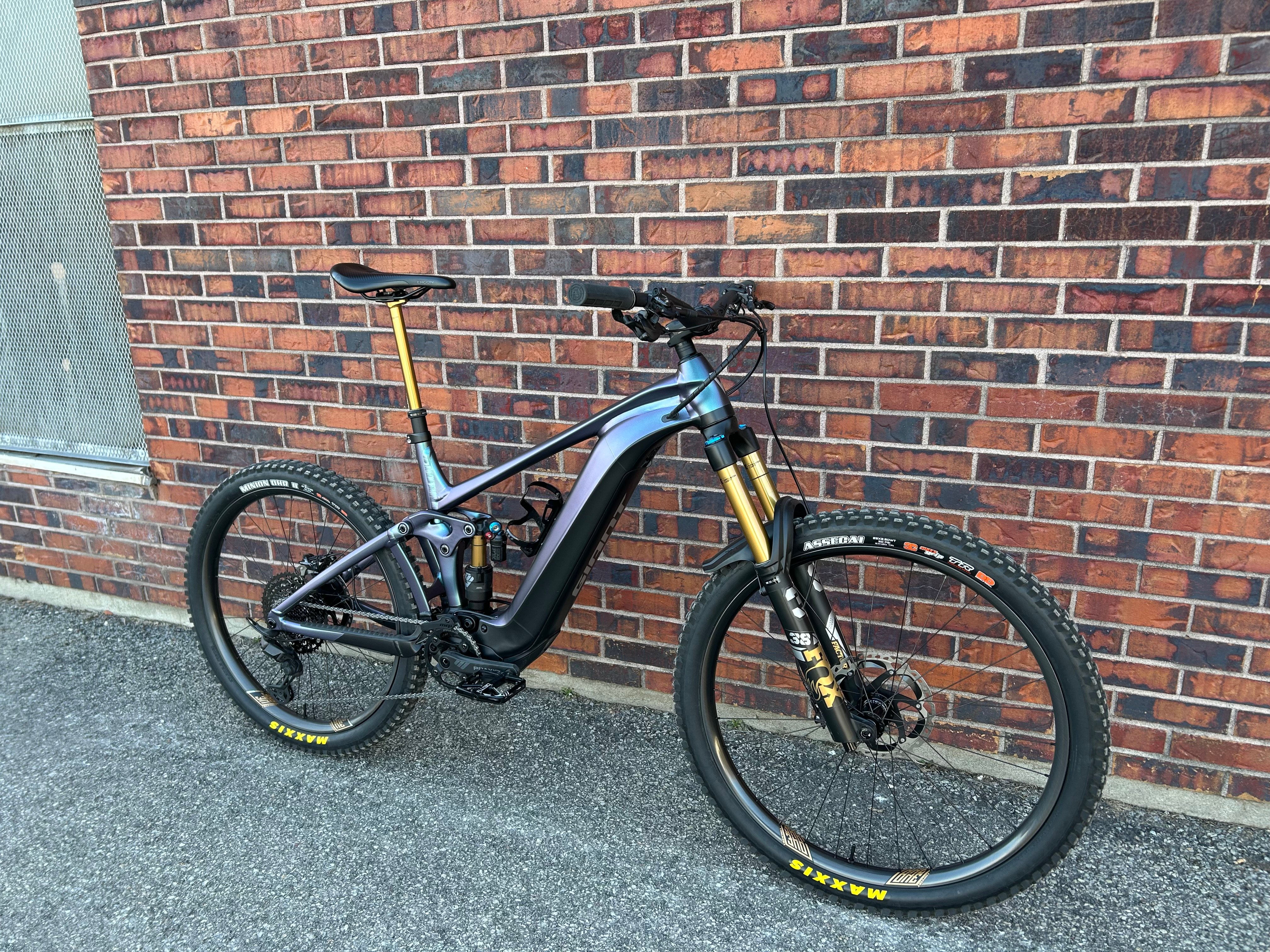

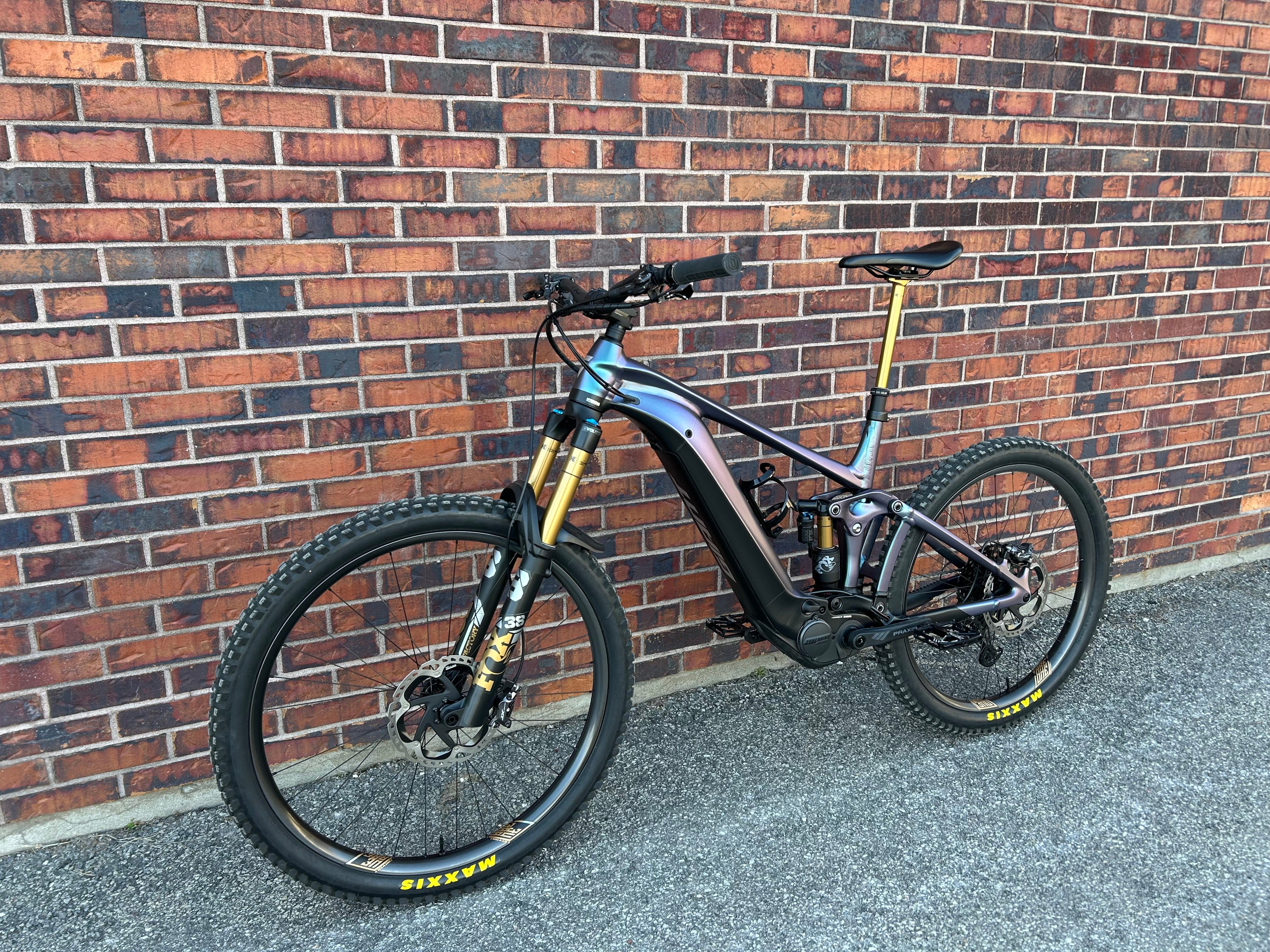

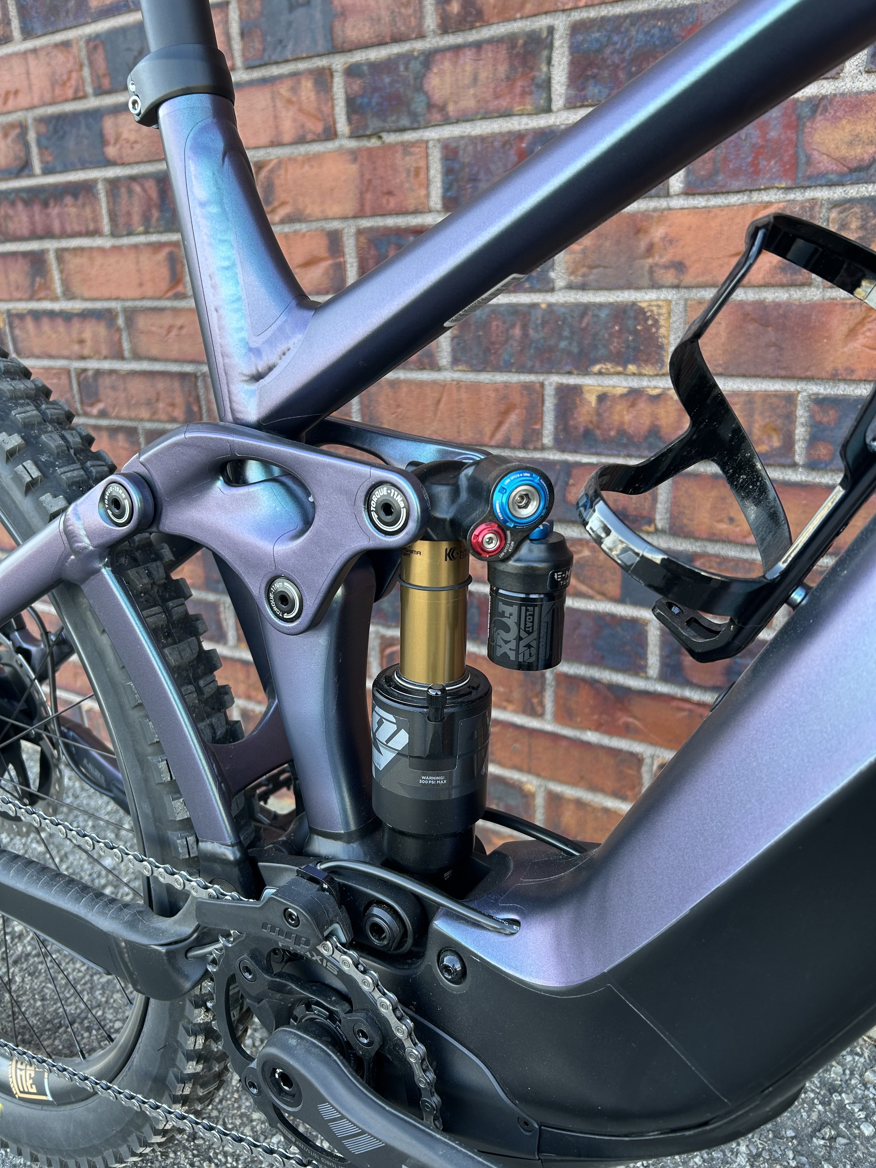

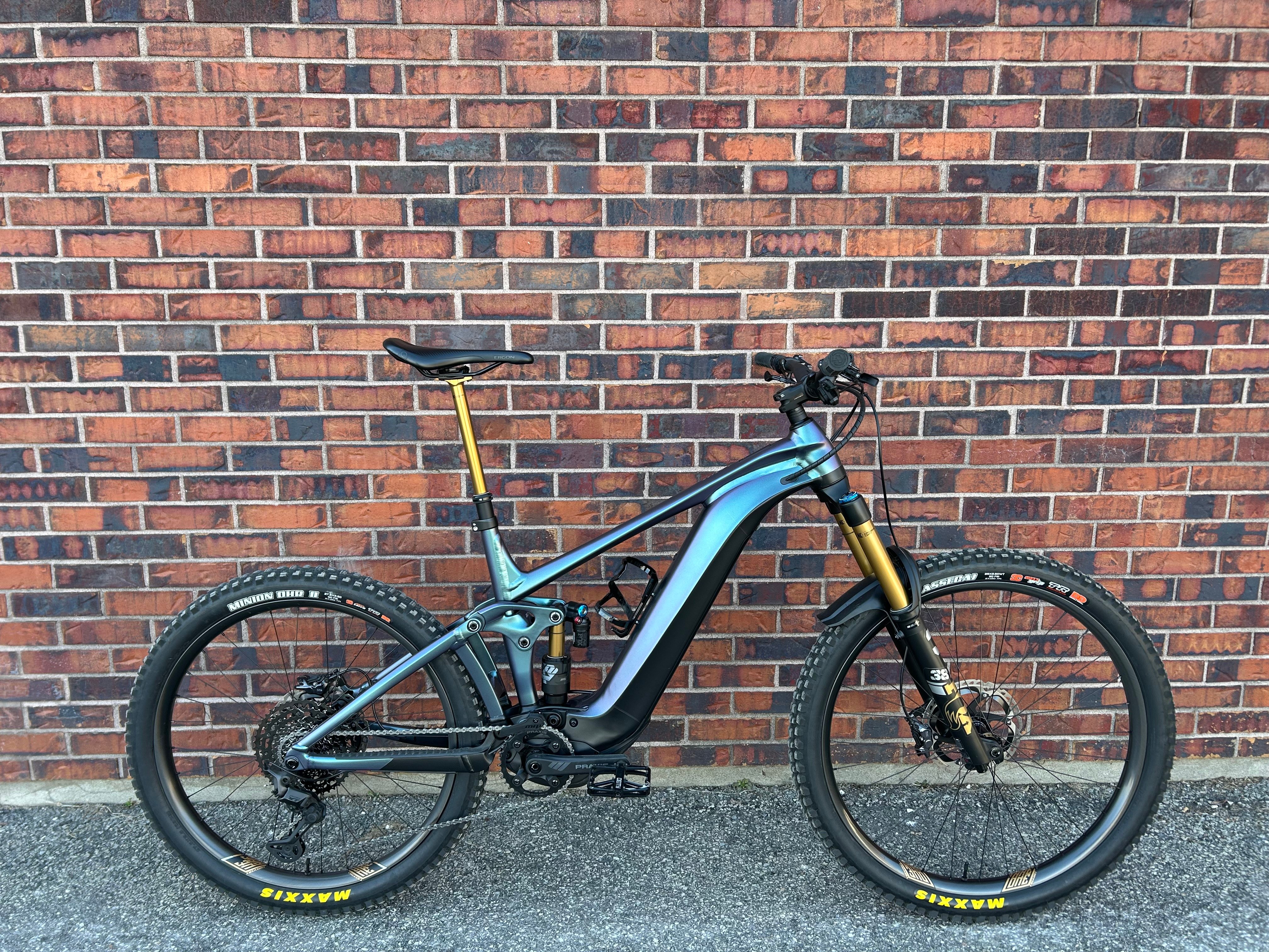

Build is complete for summer 2025, very happy with the bike. Giant is on to some crazy colors lately and this Dragonfly is no exception, color shift is insane.
Modifications / Add ons :
  • Fox Transfer Factory 210mm dropper
  • Shimano RT-MT905 203mm rotors
  • Shimano LG700 LinkGlide cassette
  • We Are One Composites Convert MX wheelset on i9 Hydra hubs
  • One Up Components E-Bar
  • Maxxis tires 2.5 doubledown F&R
  • Ergon SM E-Mountain saddle
  • Deity Knuckleduster grips
  • Deity Supervilain pedals

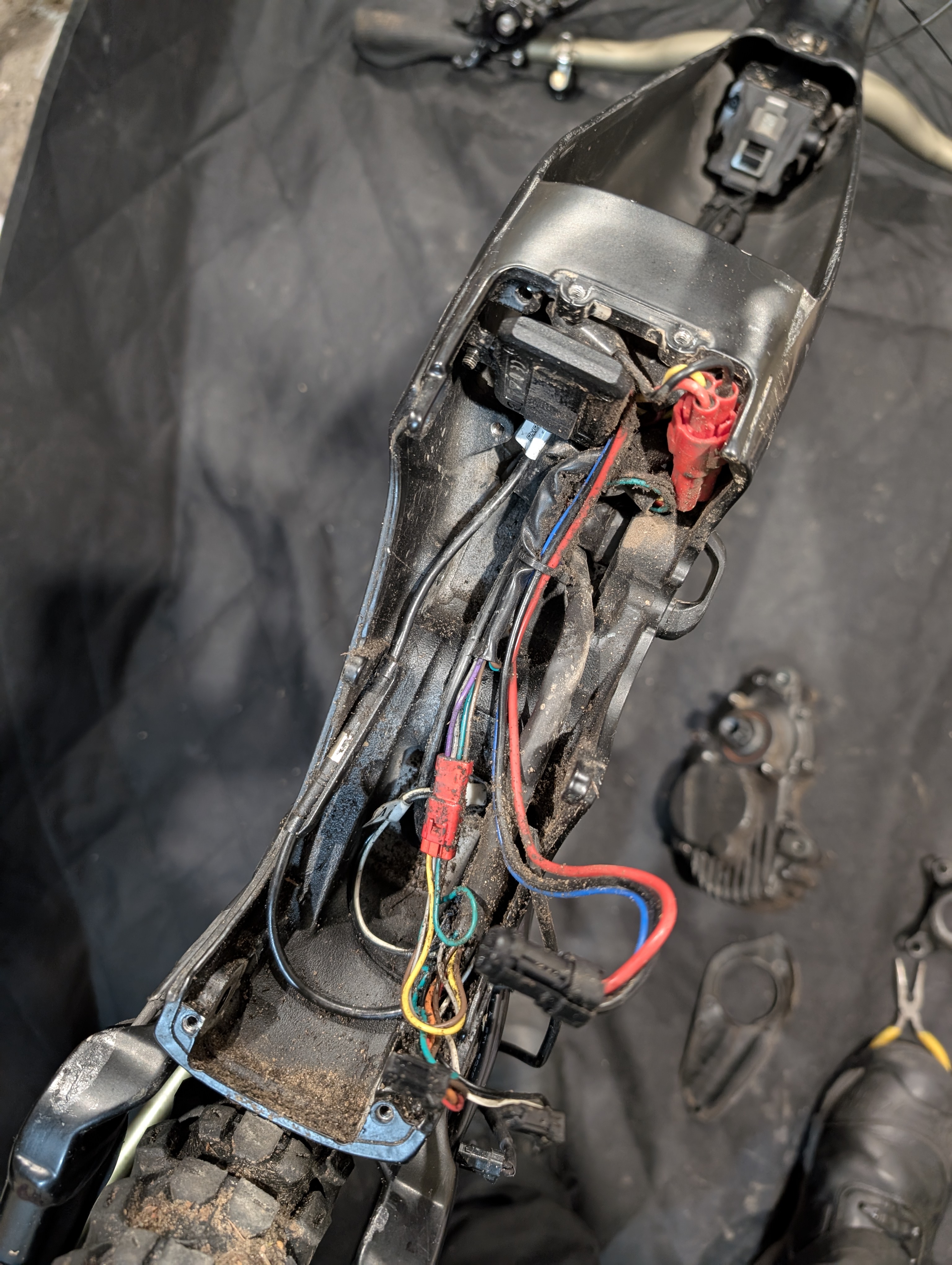

Anyone any tips how to get motor back in , I sent it off too perf line bearings and it's had 3 new bearings fitted now can get front bolts in but wires are in way for other bolts no matter how I try to arrange them

Looks sick, i think a stem upgrade is sorely needed though.
I removed mine half way after accidentally pulling dropper post outer past seat tube junction. Was not easy. Just gotta squish wire in / around motor as best you can. I know there are some wires at the front that sit above / in front of motor that can cause fitting issues. Work gently and im sure youll get it
