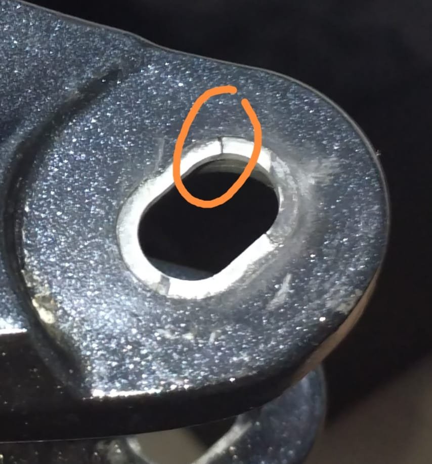

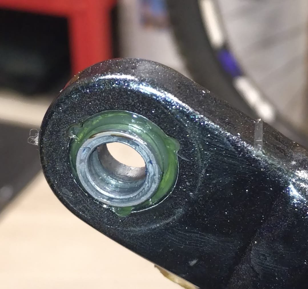

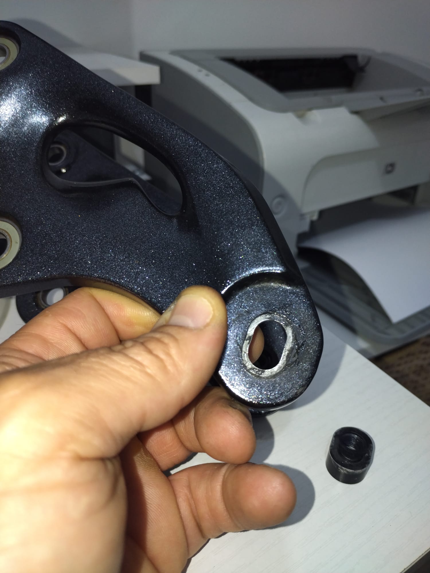

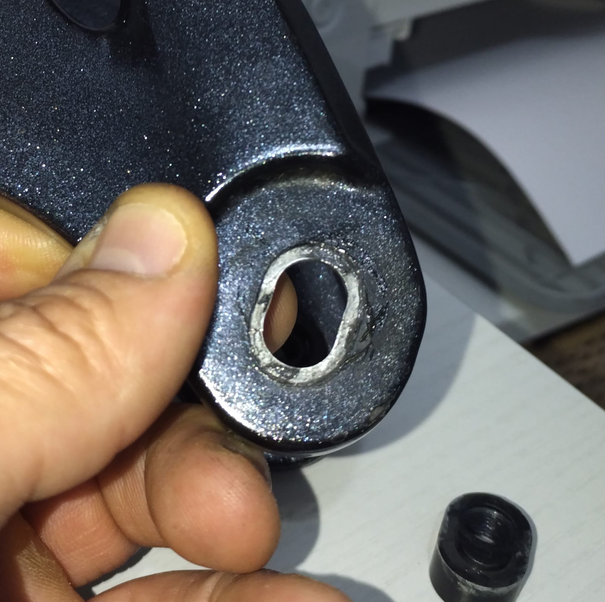

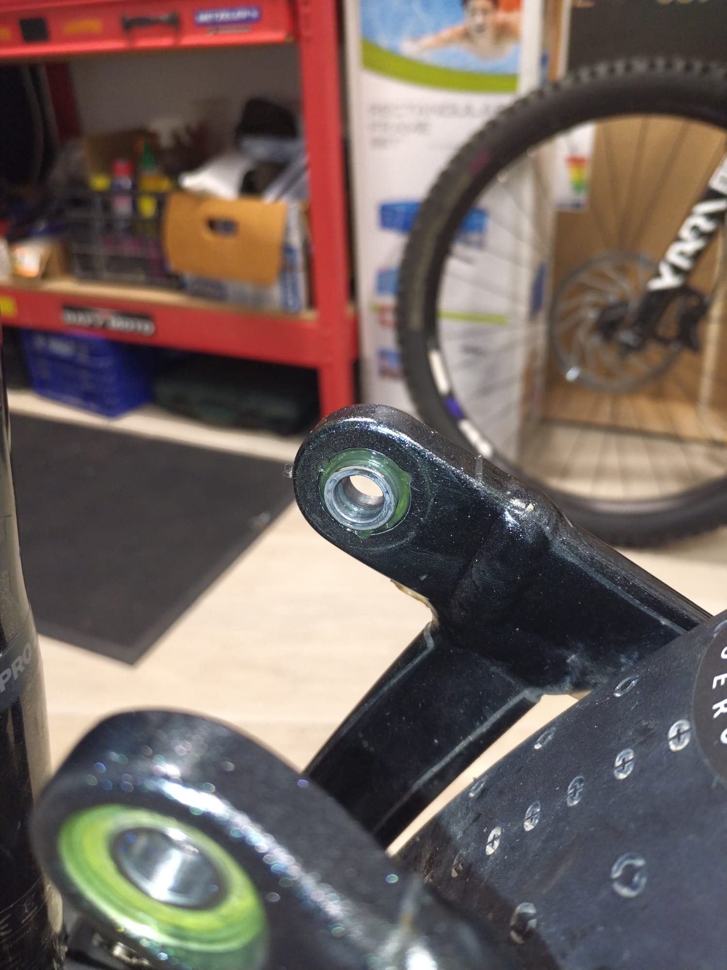

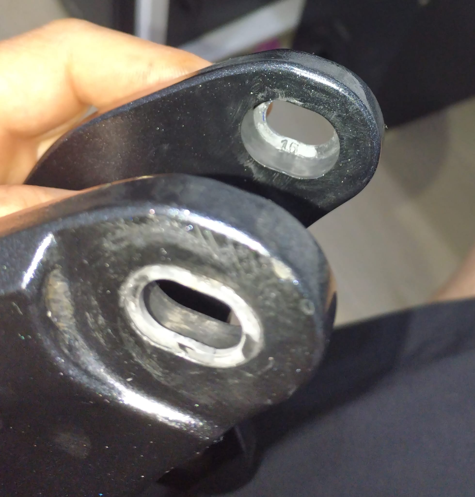

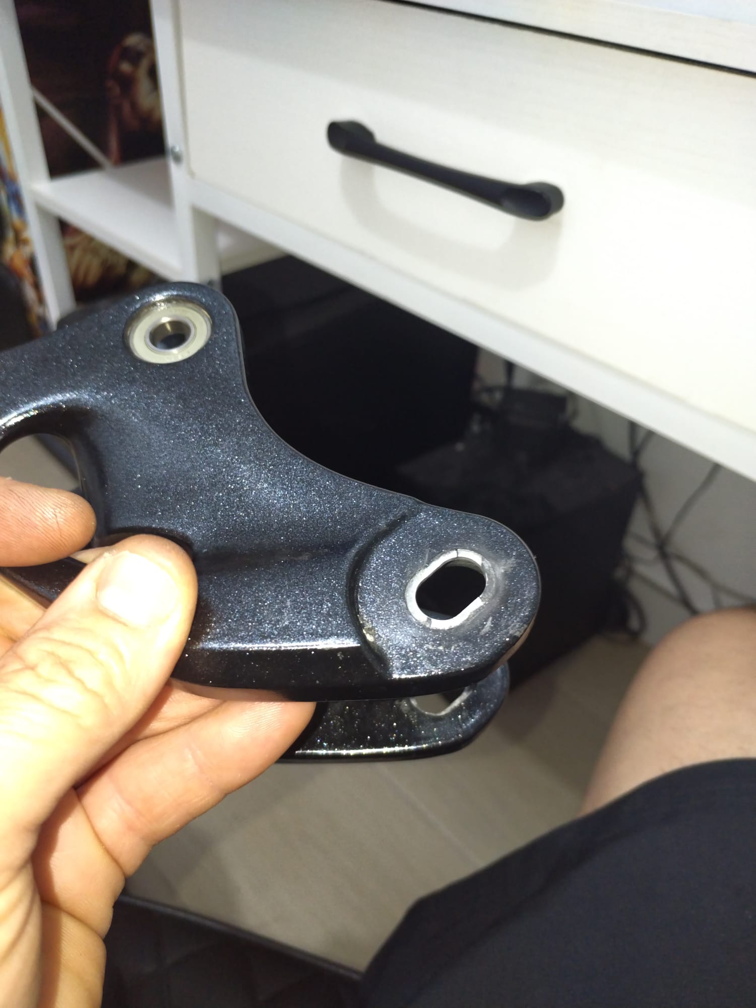

Tengo un problema con el soporte del flip chip, tiene holgura en su interior, parece que hay desgaste en el chasis en el varillaje, a alguien le ha pasado esto y lo ha cubierto la garantía? 1.jpg 2.jpg 3.jpg 4.jpg 5.jpg 6.jpg 7.jpg

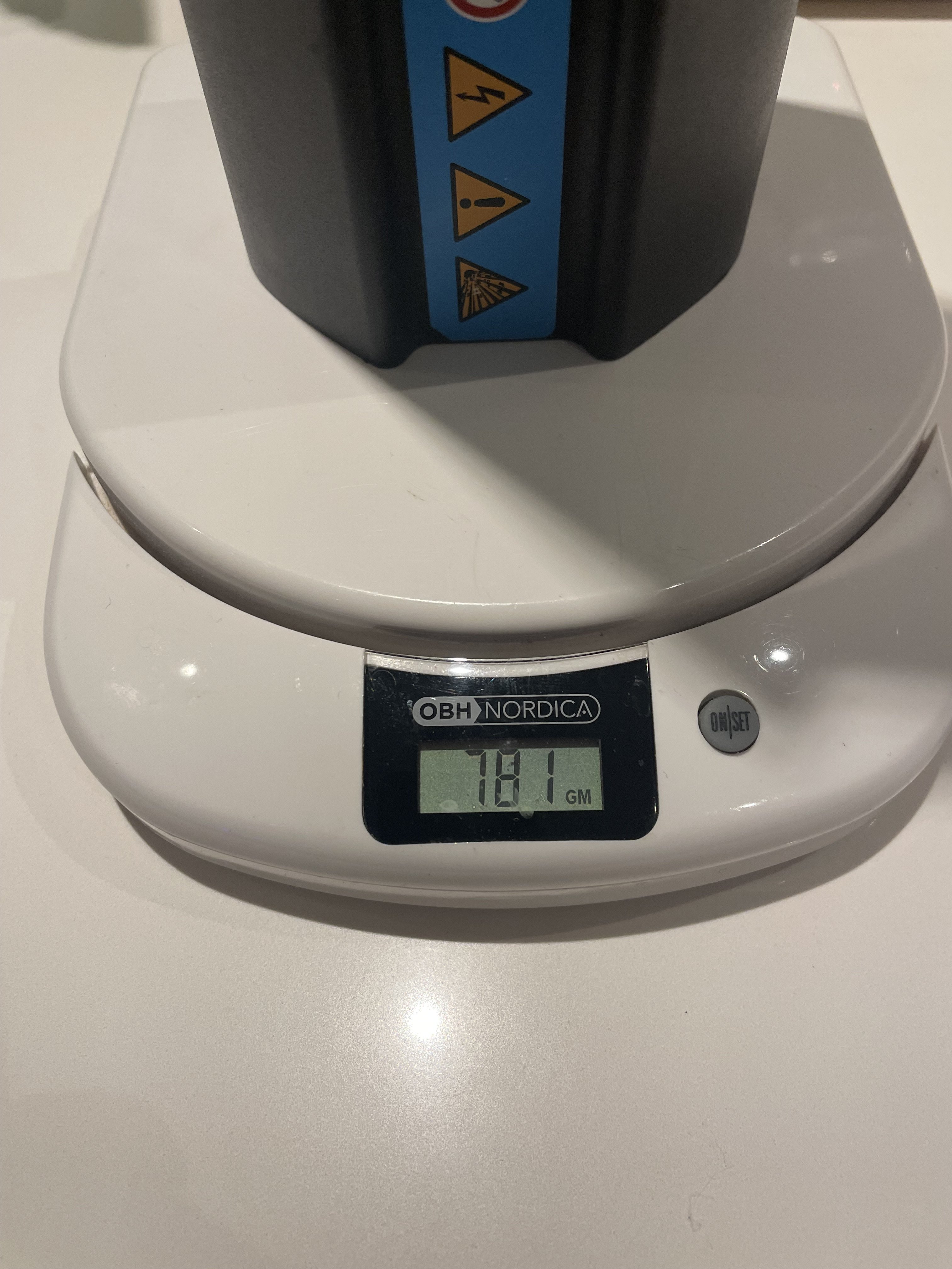

22700 cells in Giant 400/800wh are 20% more energydens than 18650 cells in 500/650wh energy packs.
But the reason for Giant 800wh being heavier than Dji 800wh, is because og heavy aluminum casing.

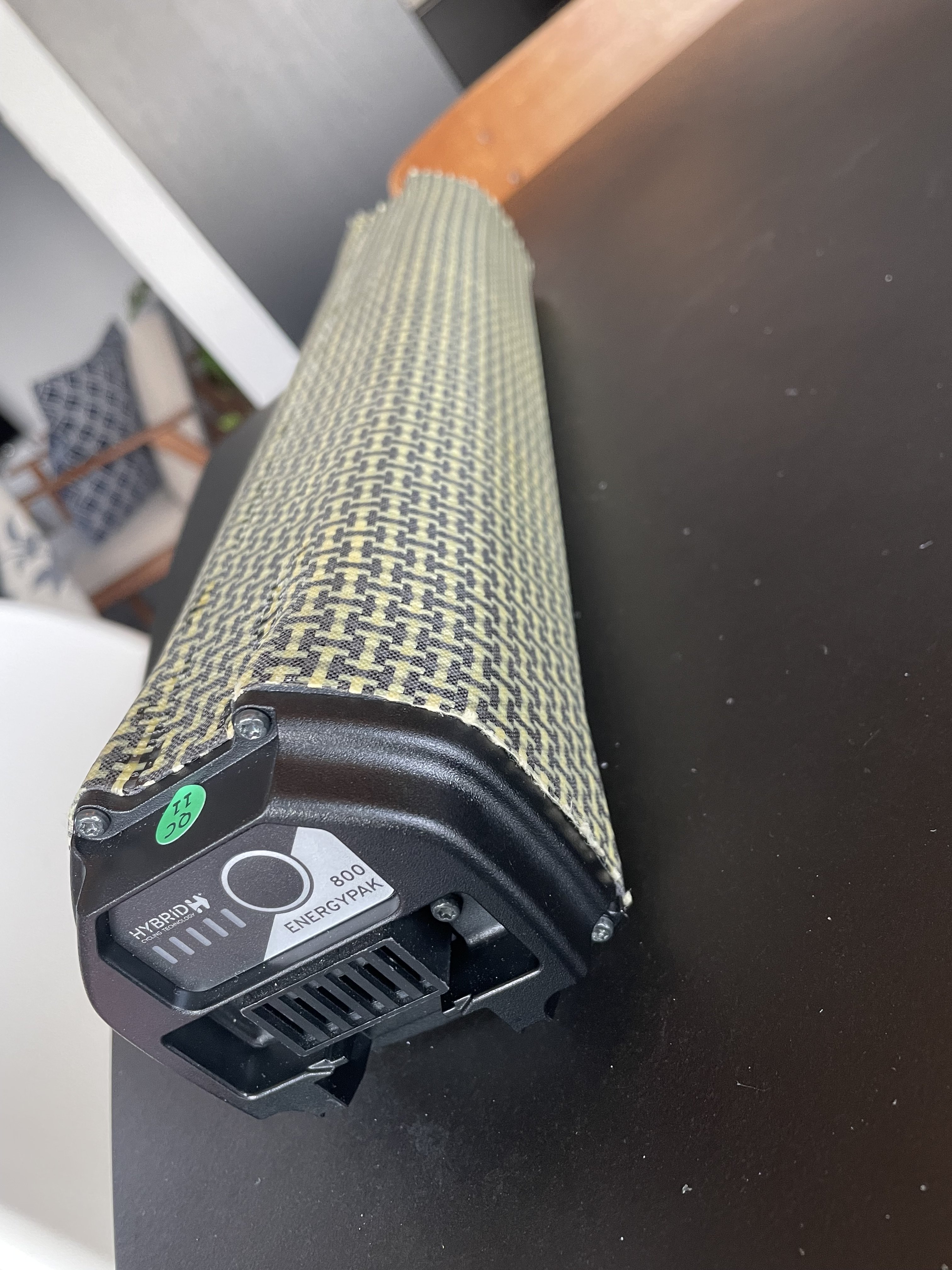

My carbon/plastic Giant 800wh is as light as Dji 800Wh

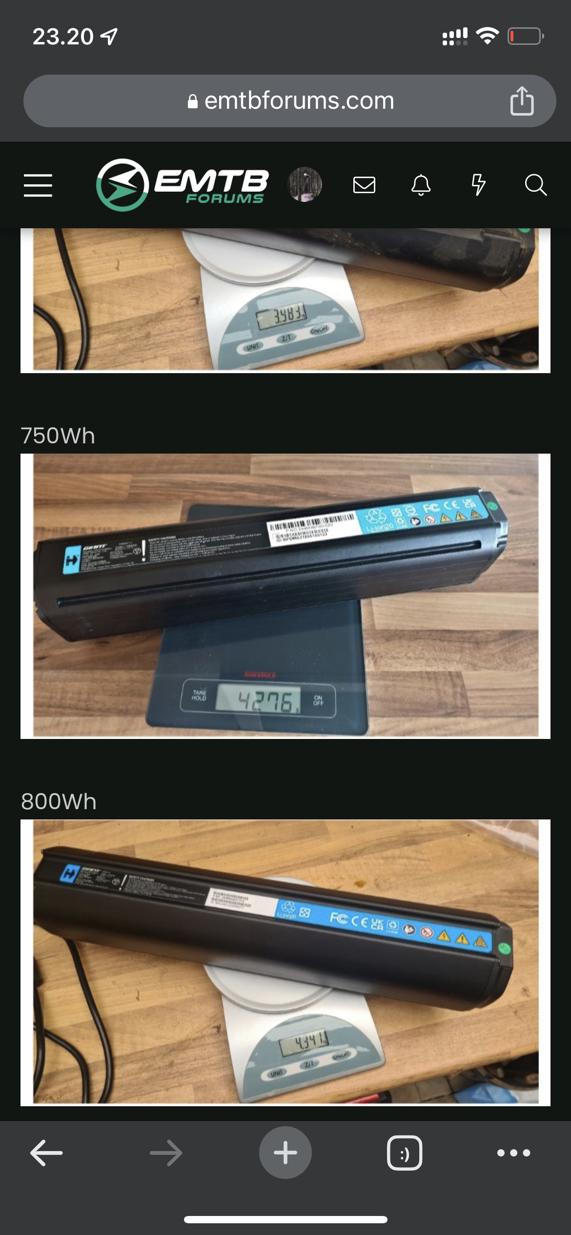

Just the cells for 800wh battery weight 3.000gr 266-280wh/kg so 3.300gr for a complete battery is highly unlikely.

What is that, a carbon wrap? I would be concerned that with void any warranty issues as could be altering the thermal properties of the battery?
That is a very valid point if your battery is under warranty. if not thou it would be a question of what the benefits would be and would it be worth it to you. Also any data on any negatives of the mod.
No issues.
Removes 600gr weight
Brand new battery, has about 900km on it now.
Plastic/carbon case to save weight.
Yes Mods often void warranty.
If you would look inside your battery, you can see how the battery cells are packed in plastic casing.
Plastic has ok thermal conductivety
No issues.
So about 559 miles and just over 1.3 pounds? If I got that right the weight seems pretty impressive as far as miles go I'd say more will be needed tell weather it effect it and a sample of more than just one battery but, it does look promising. Does make me wonder about finned aluminum cases wear heat is a issue.
In my experience the batteries don't hear up that much (original casing) compared to the Yamaha motor which overheats massively on hot days in the highest assistance.
Agree, only BMS gets a bit hot during charging, electroninc board is packed in plastic, the two boards are in a sandwich, covered in thick silicone , endcover is plastic.
So no part of BMS is designed to dissepate heat efficently
