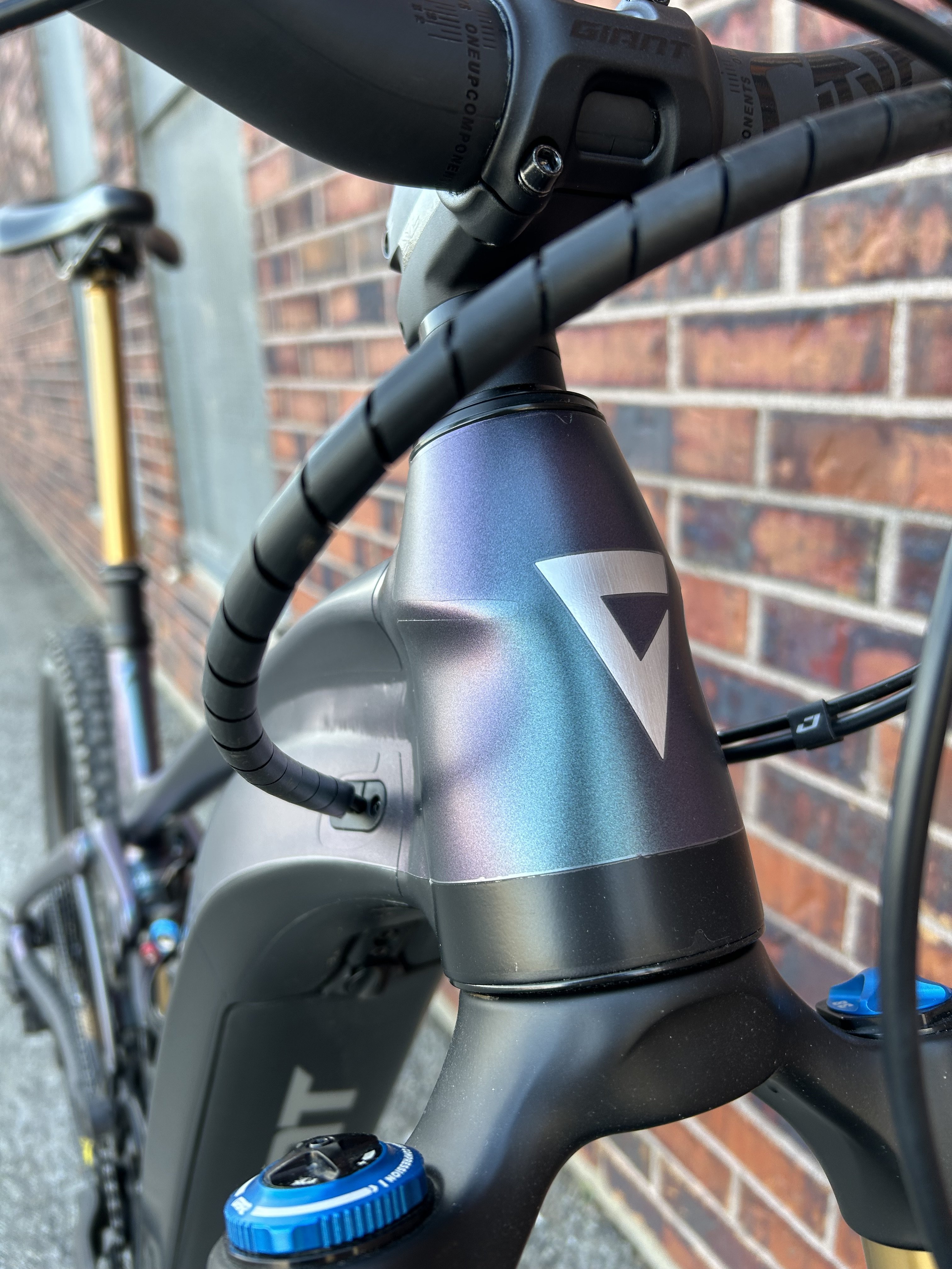

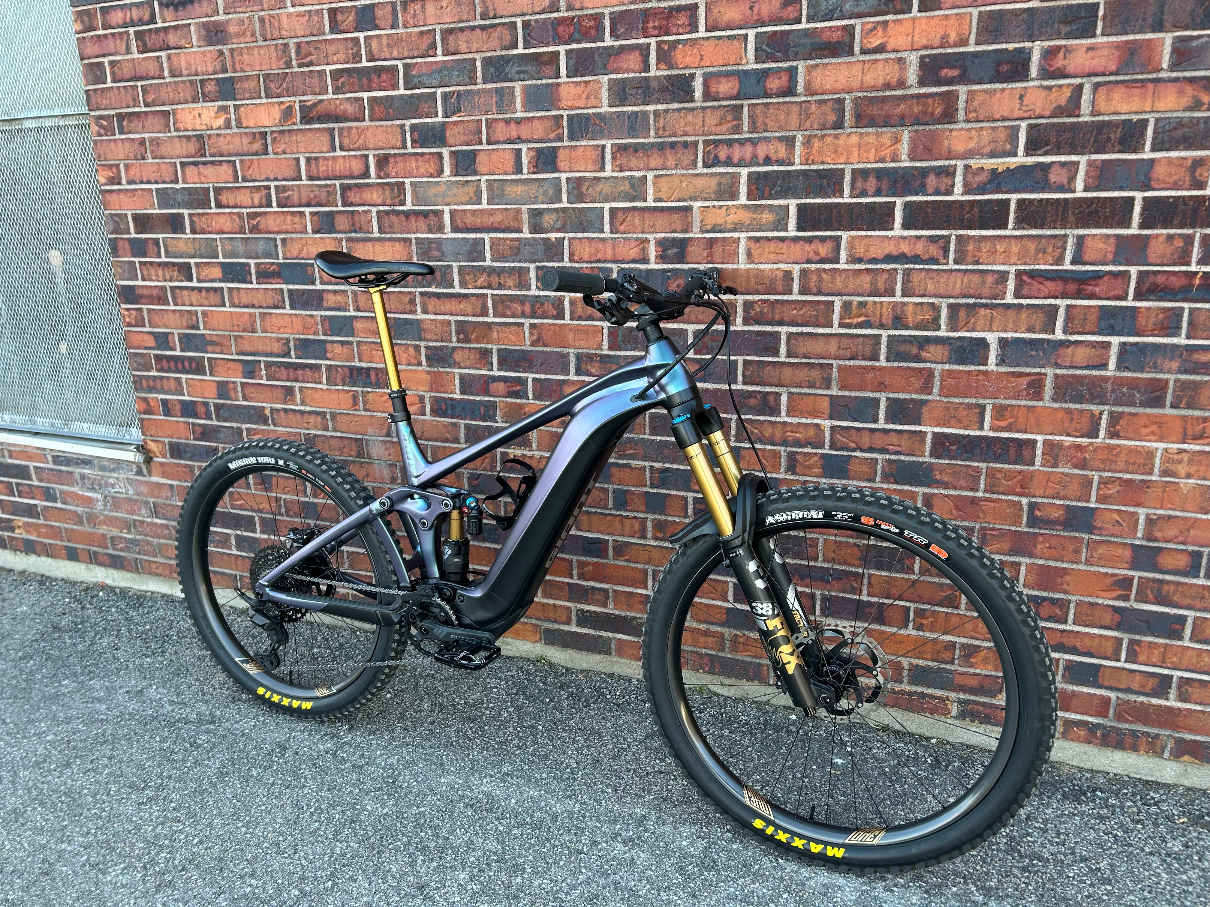

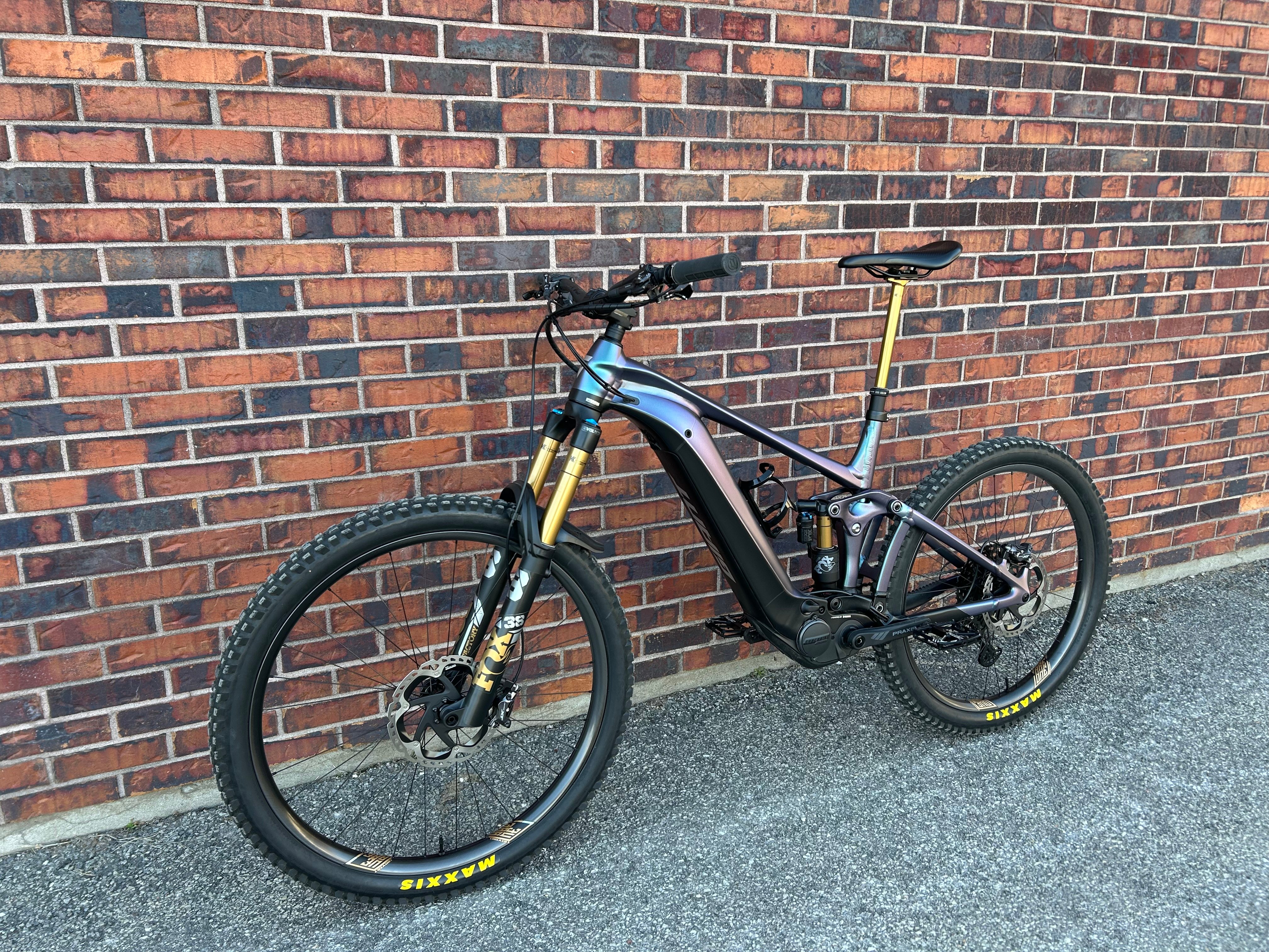

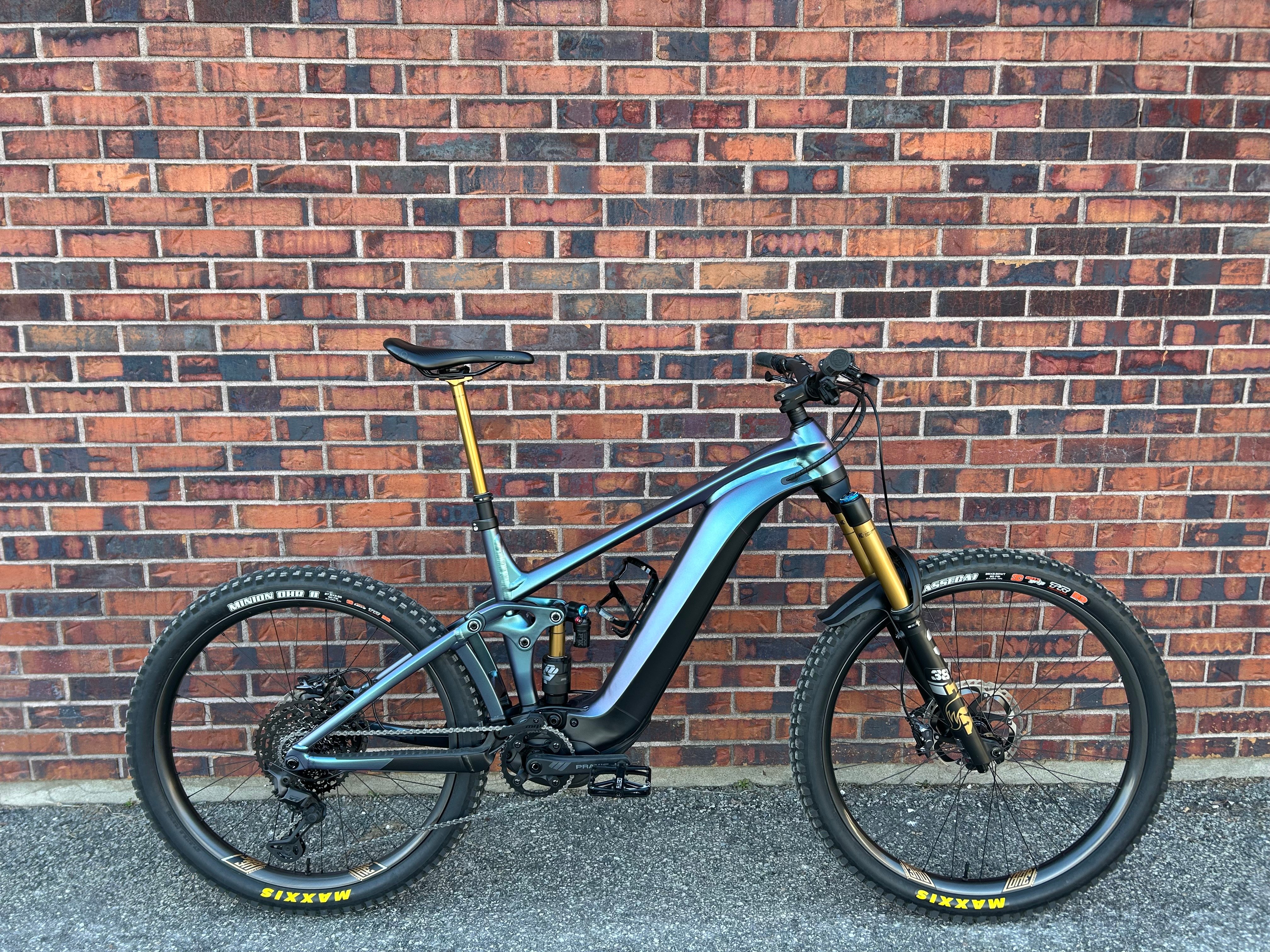

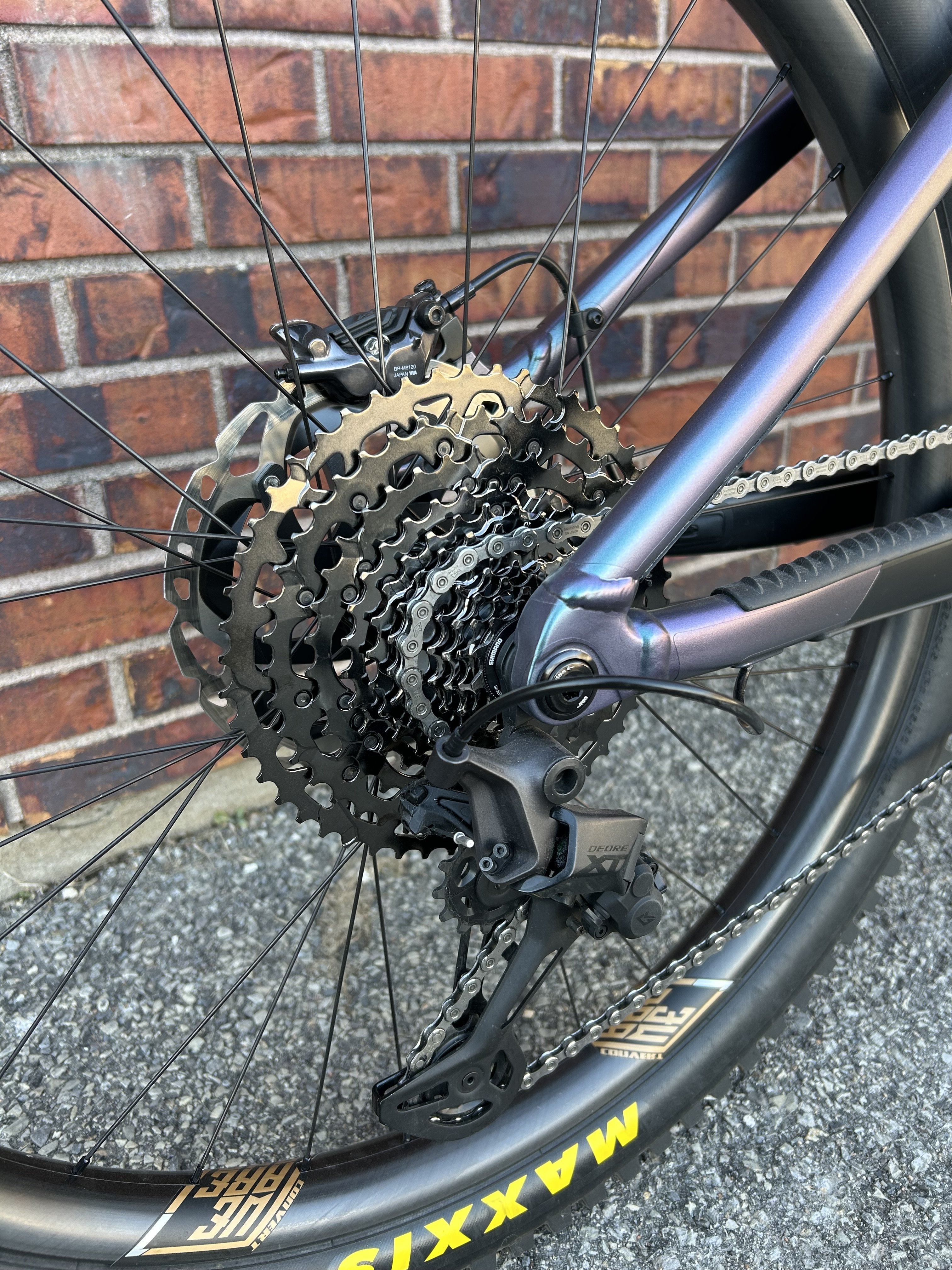

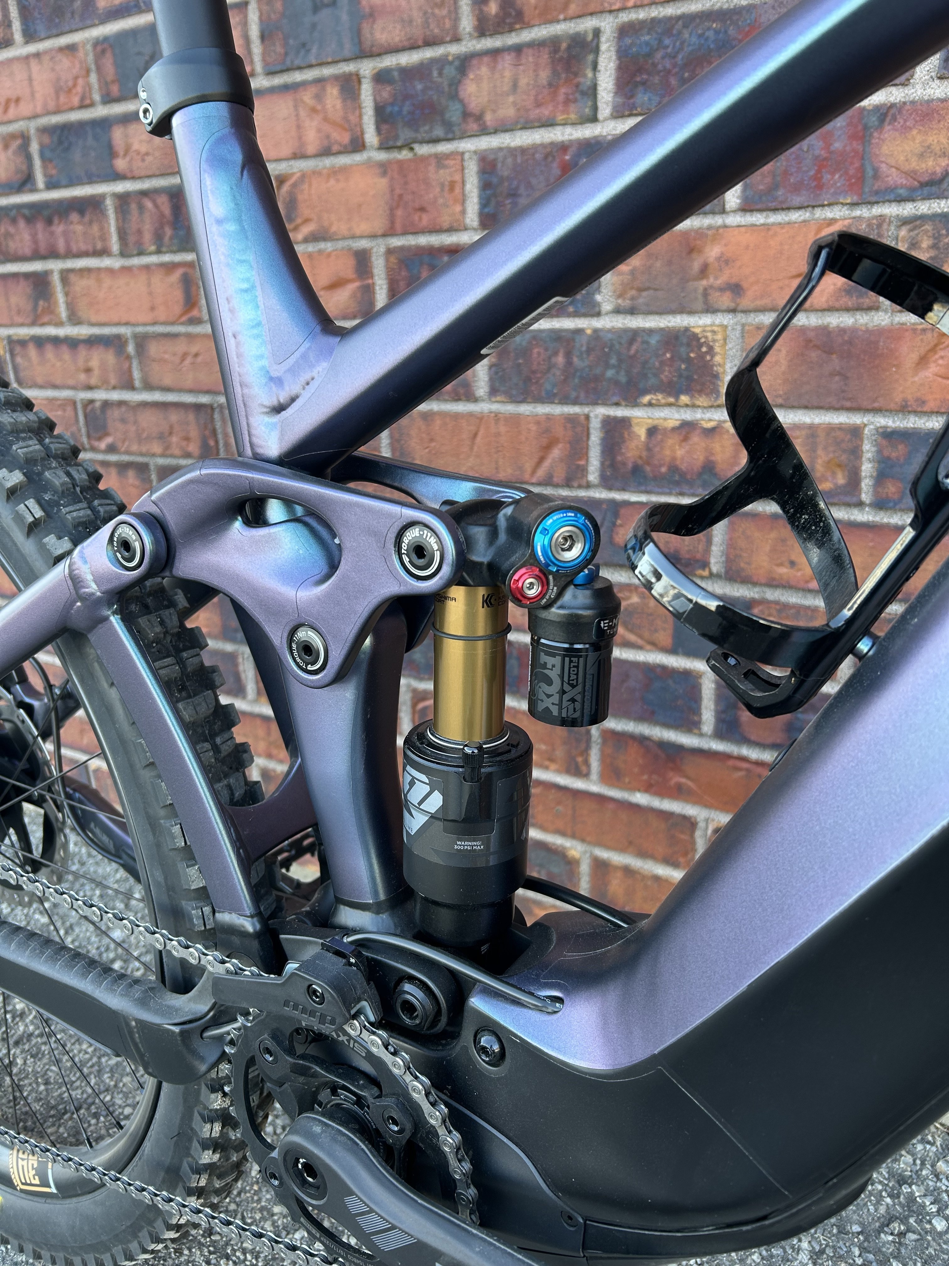

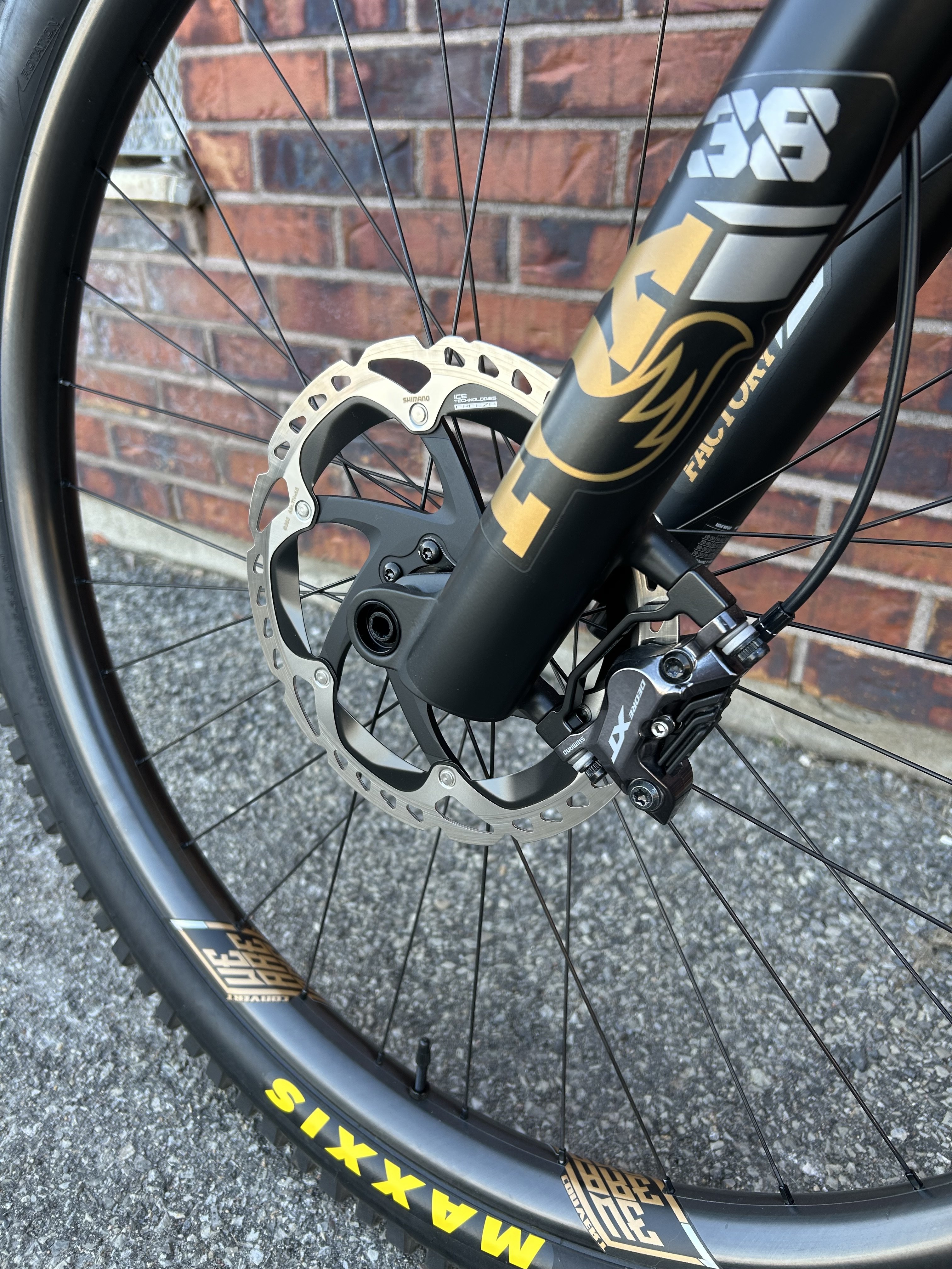

Build is complete for summer 2025, very happy with the bike. Giant is on to some crazy colors lately and this Dragonfly is no exception, color shift is insane.
Modifications / Add ons :
  • Fox Transfer Factory 210mm dropper
  • Shimano RT-MT905 203mm rotors
  • Shimano LG700 LinkGlide cassette
  • We Are One Composites Convert MX wheelset on i9 Hydra hubs
  • One Up Components E-Bar
  • Maxxis tires 2.5 doubledown F&R
  • Ergon SM E-Mountain saddle
  • Deity Knuckleduster grips
  • Deity Supervilain pedals
View attachment 156438View attachment 156437
Nice build...do you know the weight??

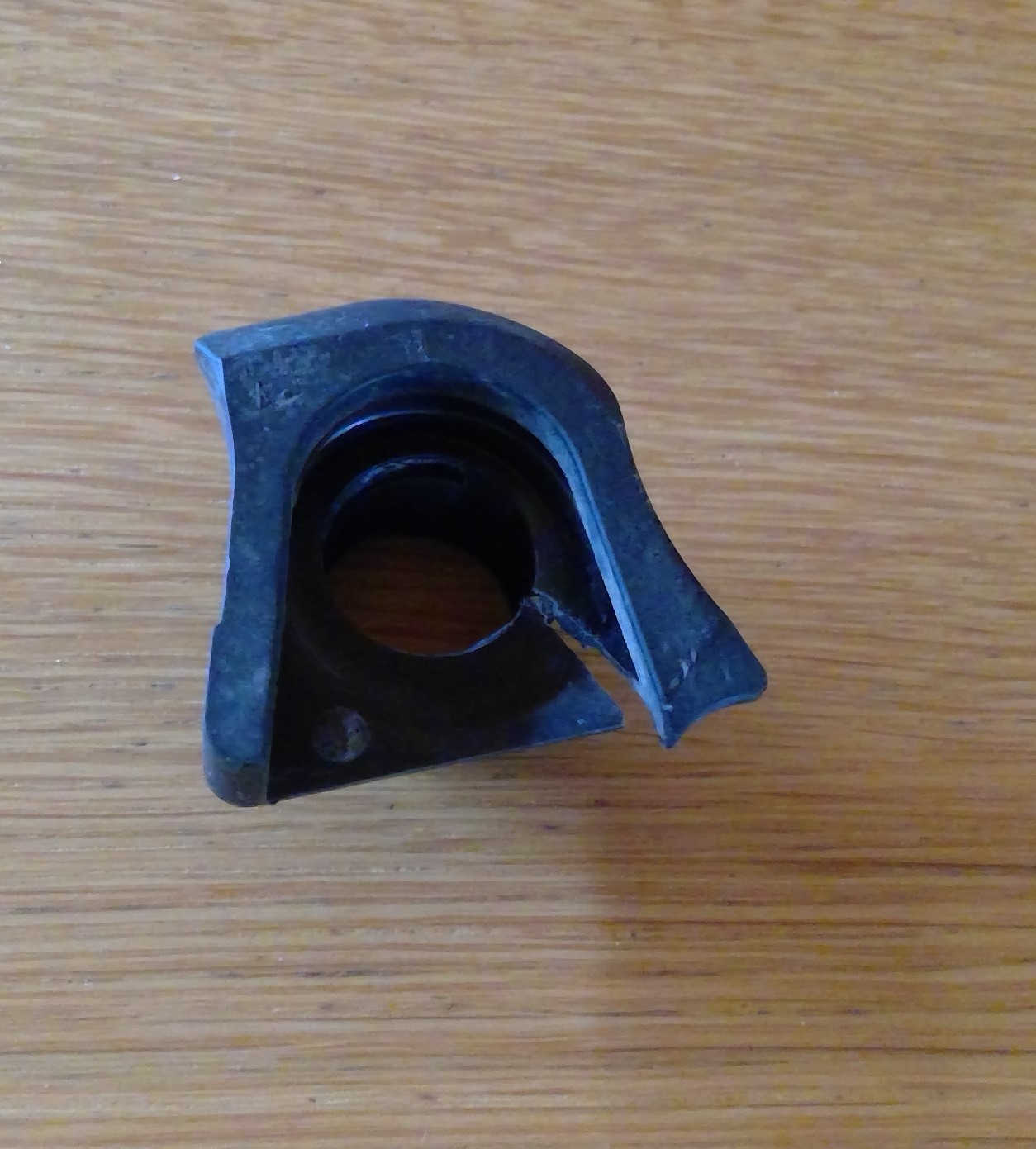

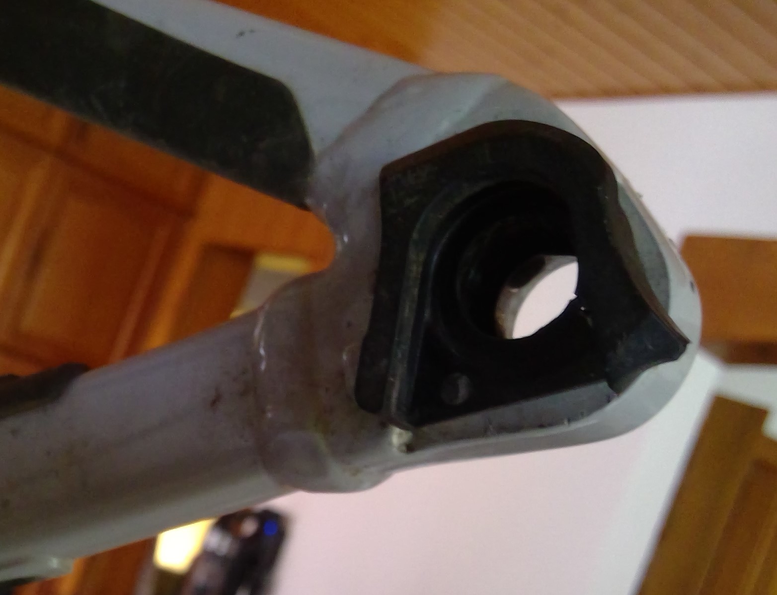

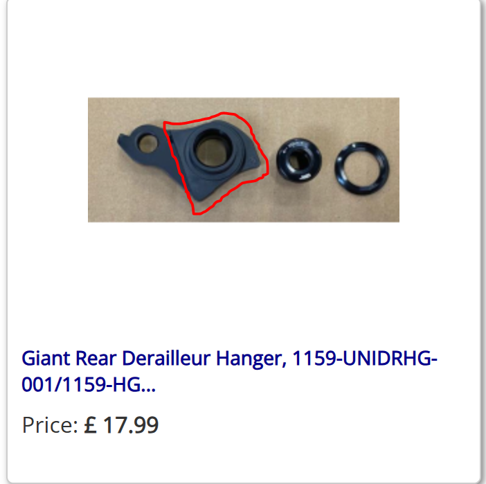

Hi all. Wonder if someone can help me out identifying a part.
Does anyone have a part number and/or description for this part of the rear axle?
Mine is broken after getting a huge stick stuck in the rear mech. Fortunately the mech survived but this is now broken and allows the rear mech to flap around. Everything still works but im struggling to get perfect shifting despite checking and correcting the rear mech alignment.
It looks to me like this part serves as a guide for the rear axle but also effectively changes the dimensions of the proprietary Giant rear mech hanger to the same dimensions as UDH. So the other question is - can I just ditch this and switch to a UDH?
Yes, it is an udh from factory. Just buy an udh for 8/10 €
Maybe u can find something here...
Perfect thanks. That is exactly the part. I already looked that that catalogue and convinced myself that the part wasnt in there. It is in fact shown as part of the rear derailleur hanger. Which after a bit more searching, I am convinced is just a standard UDH

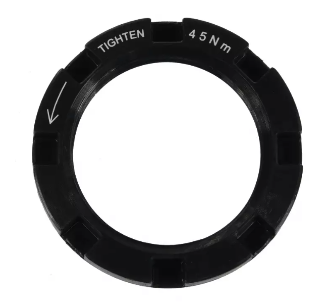

Hope some of you find this helpful doing routine maintenance.
  • I checked the lockring to make sure it was tight and sure enough it was not torqued down to 45 Nm. Lockring tool I purchased off Amazon: BikeHand Lockring Tool . This resolved the annoying, "clicking / toc toc / tick tick" noise I was getting while in the power settings 3-5 going up hill applying torque to the pedals.
Some of the other issues that I fixed in the past.
  • The crank arm bolts needed to be re-torqued to 50nm
  • The rear center lock bolt holding the rotor and speed sensor magnet came loose, causing the magnet to spin on the hub, throwing an error (flashing red) shutting down the motor at random times.
  • Almost all the pivot bearings where rough after 1000 miles and I replaced them all with Enduro Max LLU
  • Headset was creaking. Removed the bearings, cleaned and re-greased. The bearings were dry.
  • Battery latch was crooked and was rubbing against the battery case. Needed to be re-aligned.
  • Rear lower shock axle was bone dry and needed to be cleaned and greased.
Bike is now running smooth. Looking to get many more miles out of this bike.
