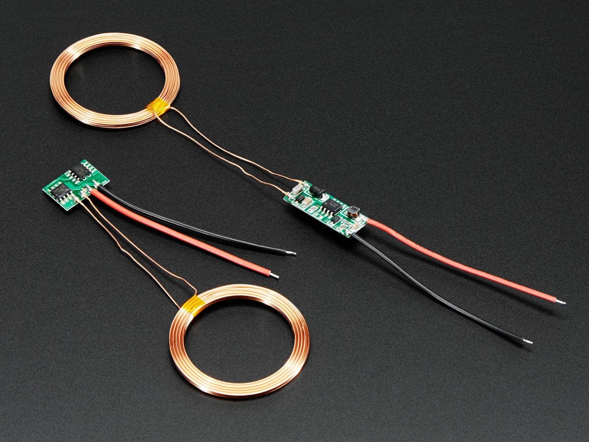

4) If you didn't want to mount the bridge to your bike then you could use an inductive charging adapter, then making a waterproof case would be easy. Though have also seen qi charge addon boards for phones which have a USBC output directly.

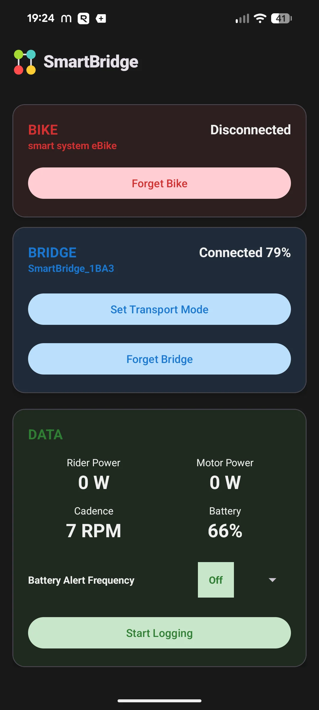

Hi, tested :
1: have to disconnected from my phone
2: than I found the KIOX and paired with bike
3: start logging button pressed
4: but all datas are 0W power , 0 cadence , 100% battery so it's like it's not reading the data
That's with a Gen 4 motor? If so that means it uses different encoding for the data. If you generated your log while riding (so it should have valid power data etc) please upload it to the Feedback discussion thread on Github and I'll take a look. The log file should be in your Downloads folder.

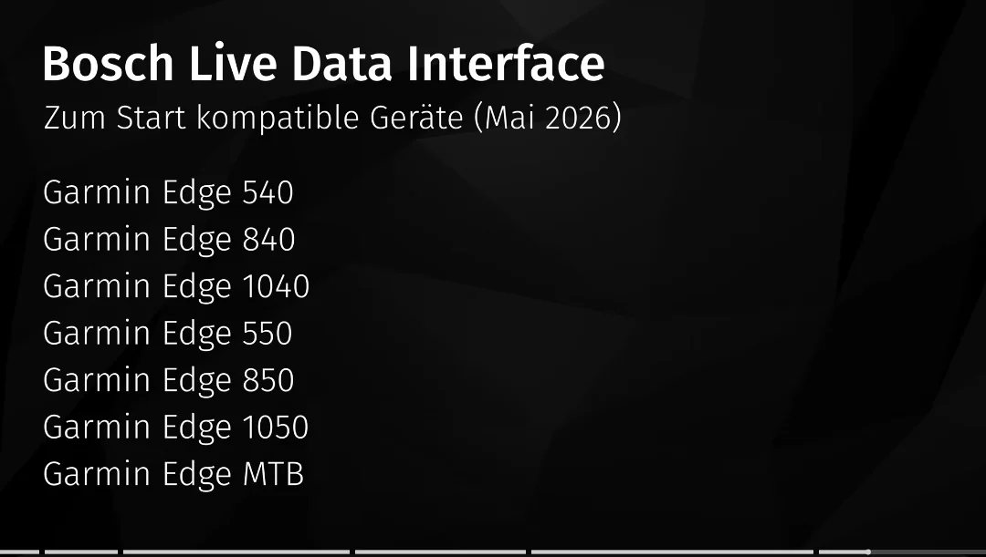

These are the Garmin bike computers currently supported:
More information here:

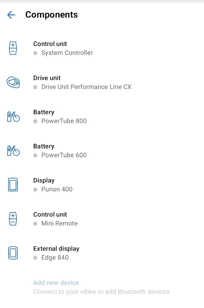

After updating my Garmin Edge 840 to the newest beta software 31.23 I can confirm you can already pair Bosh Gen5 with Edge via the Flow app (version 1.34) (Settings -> Components -> Add new device -> Accessories and on your Garmin you need to go to Sensors section -> Add Sensor -> eBike -> Bosch Smart System eBike). After you pair both your Garmin should show up in Components section of the Flow app as External Display (see screenshot below)
Once done your Garmin will now show/record: Power, Cadence, (didn't check Speed as I have external speed sensor), Gear Combo (though for me it's bit skewed since it shows 39T as my chainring whereas I have 34T one installed). Battery Level, Smart Range
It still doesn't show/record Assistance Level, Range and compared to Bulcan it also doesn't show L/R balance which in Bulcan is effectvely a level of effort from you and the motor.
Other then that - works great.
