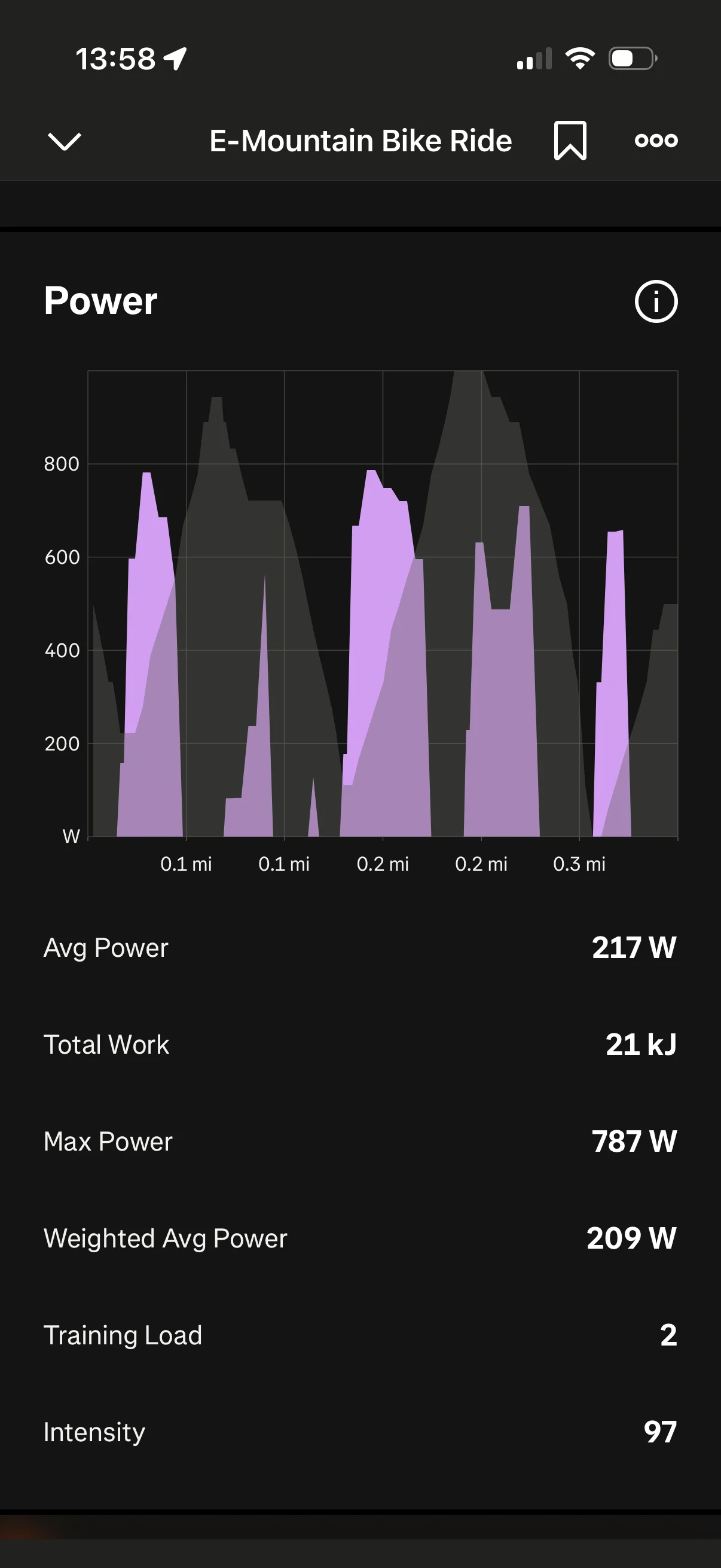

Quick test in the driveway and I am getting rider power. It seems to only update once a second or so. When you get on the pedals it takes a second to relfect. On my Levo SL2 it was more instaneous. Perhaps a non beta update will fix this, but I am happy to have this again in my data set. Now I need a power meter for my push bike

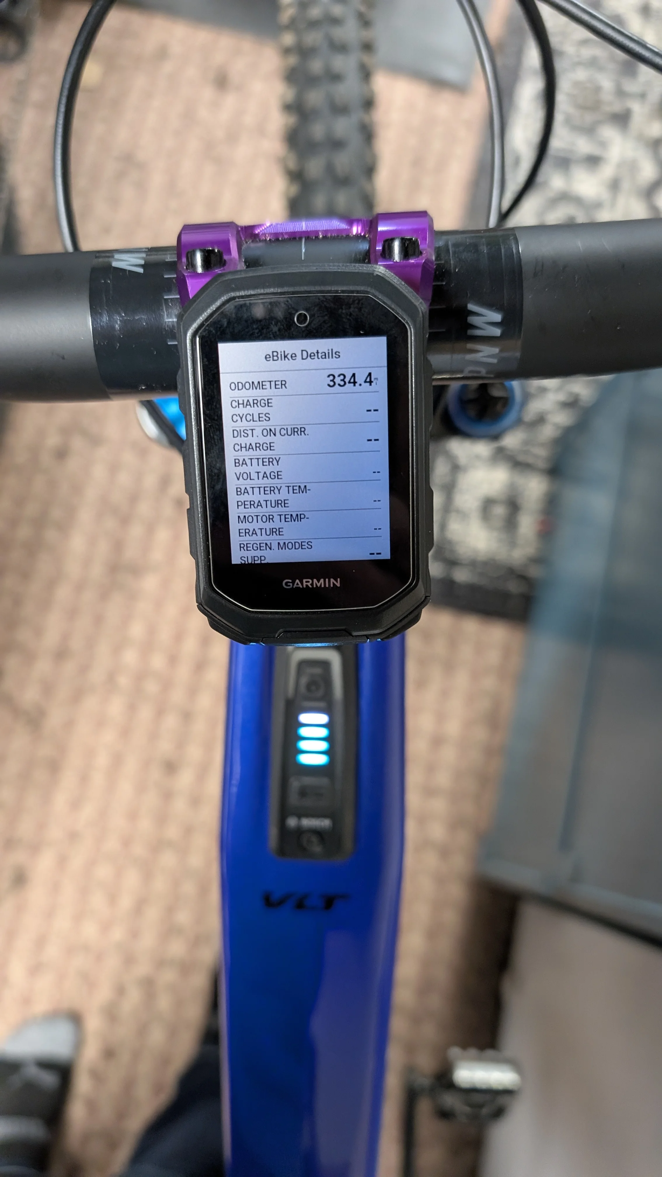

I had on the garmin Cadence, power, connectivity over a 1.5 hour ride was excellent, but it never showed the assist mode, which honestly i dont care about, nor the remaining battery, which I would have liked.
Edit: It does show the remaining battery %
