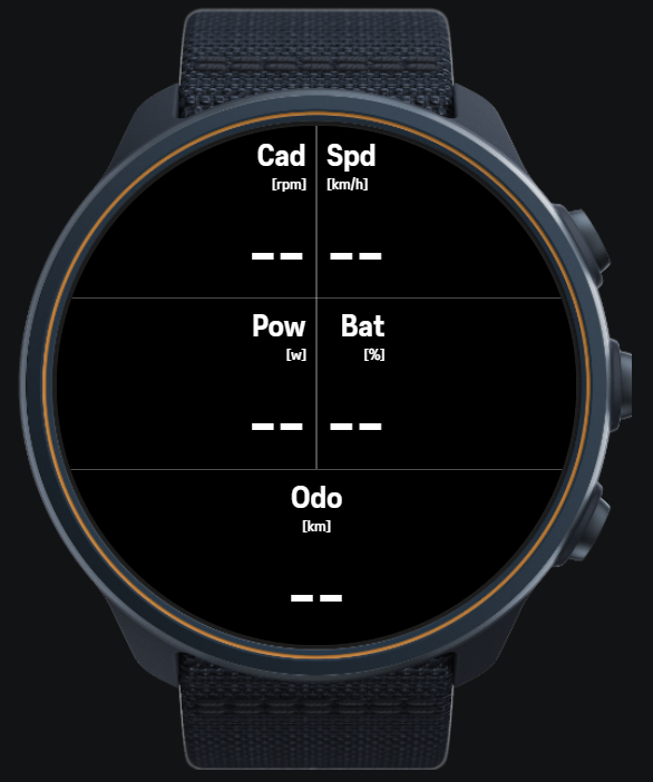

Hi all,
i've integrated the new Bosch protocol with and esp32 (as a gateway) to my Suunto watch. I needed the ESP32 because Suunto can only act as a Master in the communication and unluckily Bosch is also a master. I'm pretty sure it can be easily done also on a Garmin via Monkey C.
Don't have a lot of time to follow the project but i've make it open source so you can all take a look if needed.

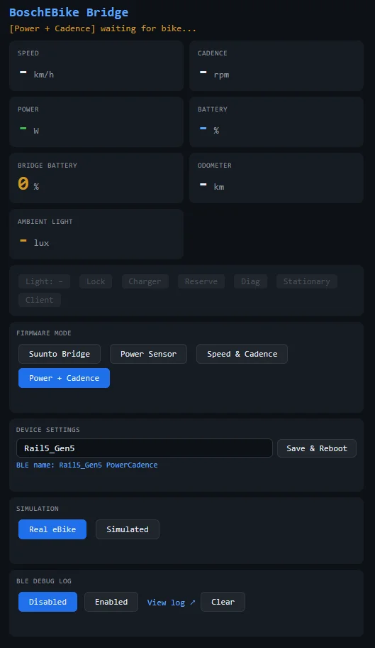

Quick update to share some updates I made to my personal project:
I’ve added a new branch in the ESP32 repo:
GitHub - SellA/BoschEBikeESP32 at feature/multi-mode
Besides the standard bridge mode, it now supports exposing standard BLE sensor profiles as well:
  • Power + Cadence
  • Speed + Cadence
  • Power only
These modes don’t provide the full Bosch telemetry, but they work without the companion SuuntoPlus app and integrate natively with Suunto’s internal metrics and training features. For example, power data is correctly used for Suunto power zones, training load calculations, and related analytics. Should be working with all other devices that support standard BLE sensor so Garmin watches and bike computers.
I also updated the integrated WiFi access point UI, where all bridge settings can now be configured directly from the browser:
There is now also a simulation mode that allows testing the connection with watches and bike computers without needing to connect to the actual eBike. Useful for validating the setup or experimenting with different configurations without having the bike nearby.

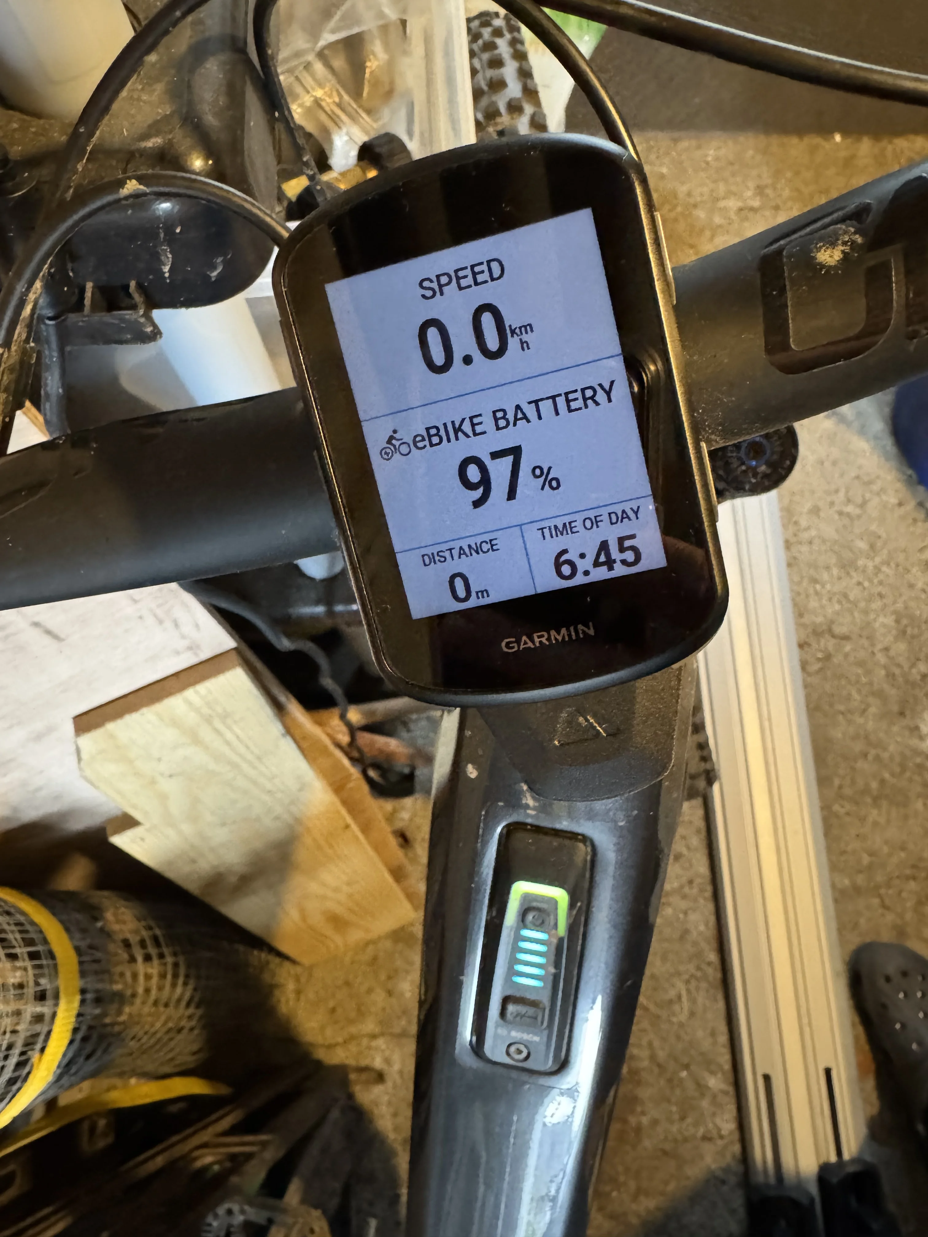

New release of SmartBridge, 0.9.4, now available. This adds the ANT+ LEV profile so you can now display bike's battery level, assist mode and estimated range on your Garmin. It also sends 'percent assist' but my 830 doesn't handle that so it's untested, but it's similar to the data that's already available via the 'Left/Right Balance' field of the power meter sensor. After uploading to Garmin Connect you'll now be able to find 'eBike Performance' charts that show assist mode and battery drain - on the Connect app these are linked at the bottom of the Overview tab of the activity rather than as a separate tab at the top.
You'll need to install the new app (APK available from Github) and to rebuild the board code with the latest version. Only doing one could be 'interesting'. Also if you're not using the ANT+ sensors you'll still need to update the board code if you update the app.
