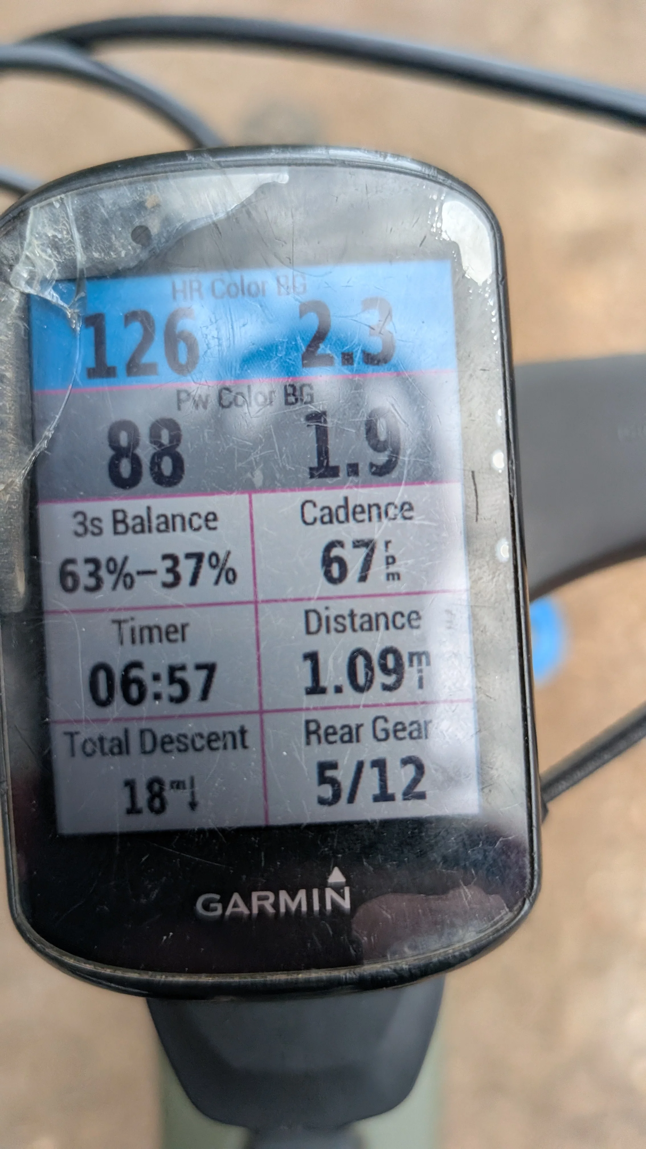

Just an update to confirm I'm still going with this - image from today's ride with nrf52840 acting as a power sensor and Garmin showing rider power (grey bar 2nd from top), cadence and I'm using left/right balance to show rider/motor contribution to total power.
Still a few details to sort out to get behaviour as I want it and make it as simple to start up as possible.
View attachment 181606Just an update to confirm I'm still going with this - image from today's ride with nrf52840 acting as a power sensor and Garmin showing rider power (grey bar 2nd from top), cadence and I'm using left/right balance to show rider/motor contribution to total power.
