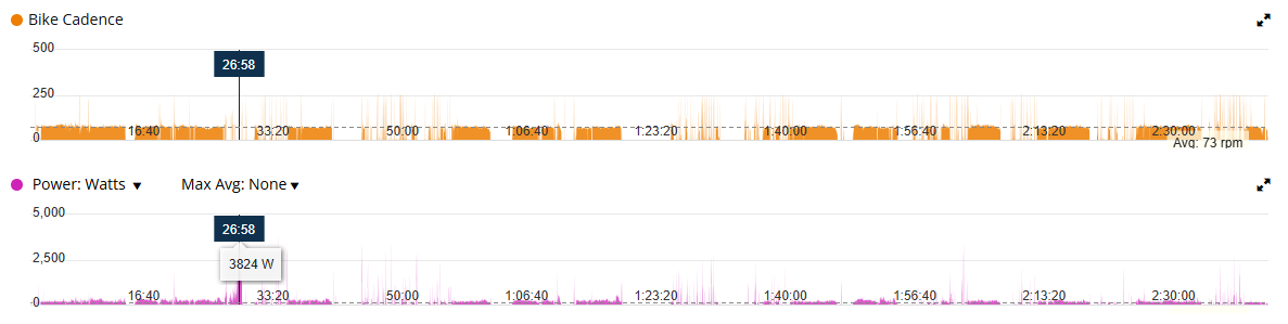

I have the non-smart standard gen 4 unit I am getting large cadence and power spikes when back pedalling on my bike or when pushing my bike backwards. This is throwing the power scales off and I assume ruining the data.

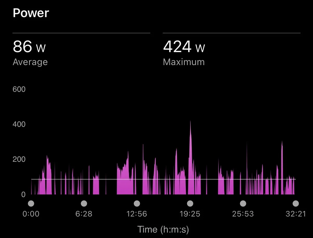

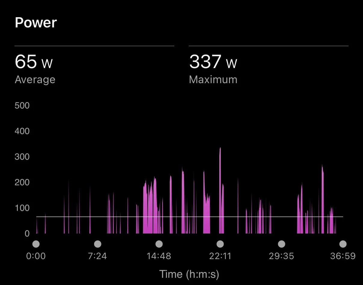

Hello all, I read this thread with great interest, as I'm another disappointed Gen5 Bosch buyer... Regarding the solution of using a 2nd mobile phone as proxy to my Garmin Edge 540, is there an app that I can download anywhere? I have an old Android sitting around and I'm willing to become a beta tester.
For those that have a problem with the Bulcan speed never dropping under ~2,5 km/h, would it help to setup your auto-pause with a custom speed, 2.8km/h for example? On a long steep uphill you may be quite slow eventually, but with a bosch ebike it is unlikely to drop under 2,8 km/h , unless you really pause, or run out of battery.

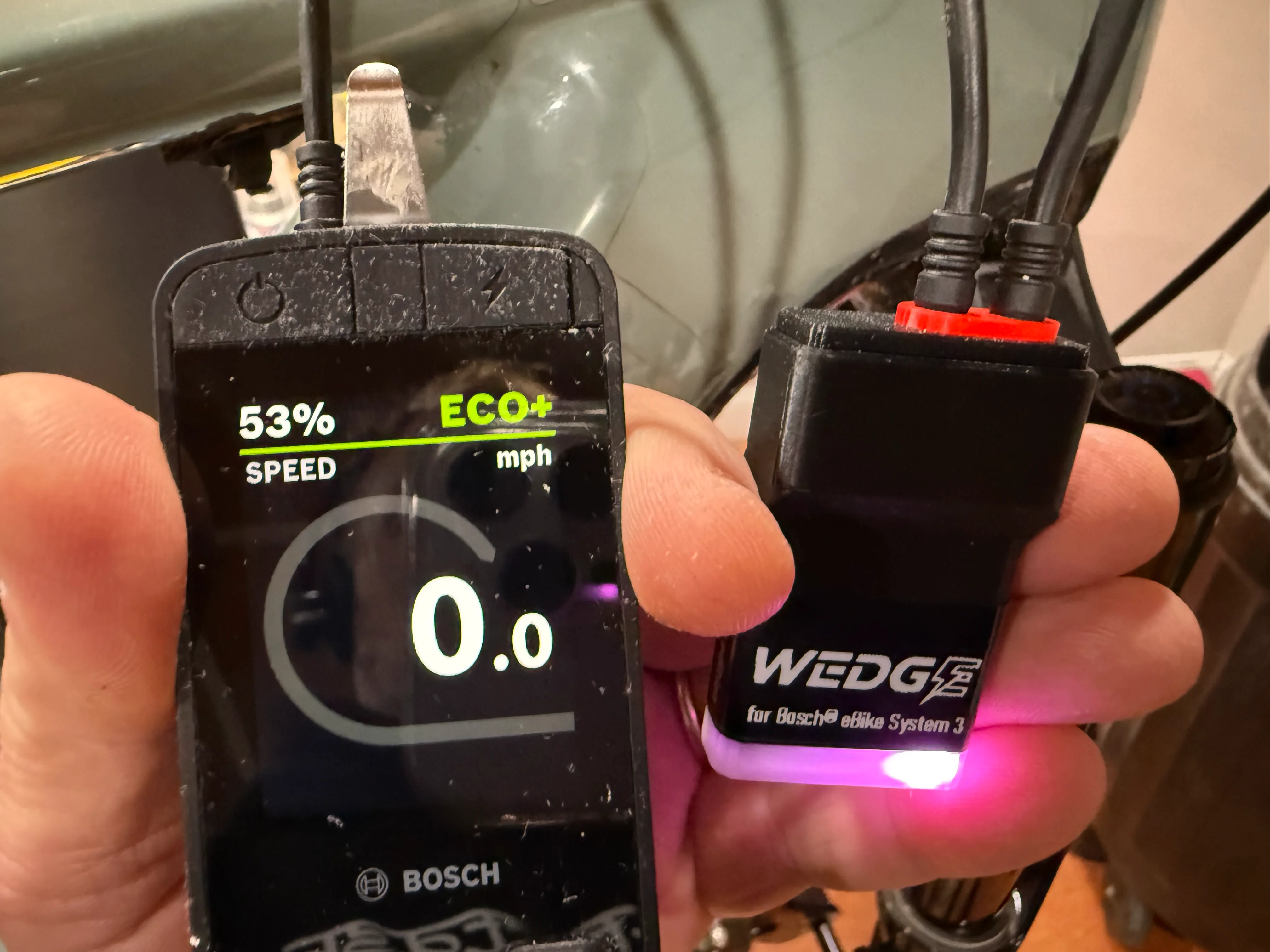

IDK if that helps but since about 2 weeks I'm finally able to ride my Bulcan equipped Bosch SX bike. 550km so far.
I use Garmin Enduro 3 watch for data recording and Edge 1050 as a mapping device/stats display. Both are connected over ANT+ only to Bulcan PWR profile which includes cadence as well. I do not use CAD and eBike profiles at all. No BLE connectgions as well. All data look reasonable and whole system seems to be working.
There's obviously a bug with speed not going to zero so I've added cheap Magene speed/cadence sensor for auto pause to work.
What I've discovered with Garmin on the other hand is that 'do not count zeroes' option works for average value displayed by Edge but not for stats in Connect web portal and Android app.
