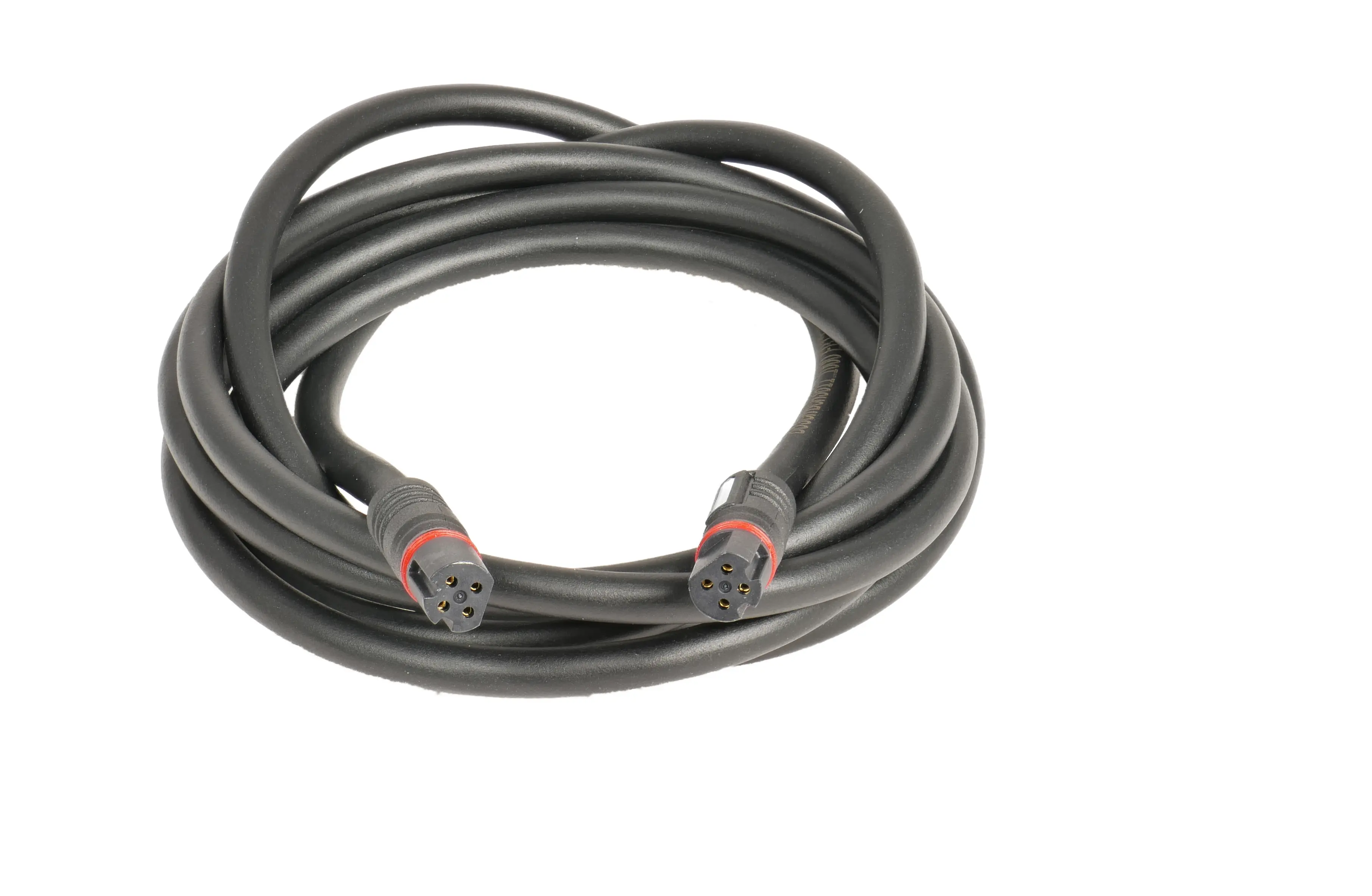

One further question, I’m assuming this can be connected anywhere inline of the display cable rather than just at the motor?
I have very little room inside the motor case of my trek rail bike and so am planning on installing it in the down tube near the system controller.
Not sure how you would connect the Bulcan inline.
The transmitter has two cables, one with a plug to fit into the motor display port and the second with a socket where you fit the display cable plug.
A display cable has a plug on either side and no socket.
If there’s a male and female connector it theoretically will work inline.
I should be able to unplug the display cable that is currently plugged into my system controller and plug that into the Bulcan, then plug the male from the Bulcan back into my system controller.
Or at least that’s what I’ll be attempting when mine arrives. I’ve already had a kiox 300 added after receiving my bike using this method. A new longer cable was used to motor to kiox300 (it used to go straight to the system controller) which then connects to system controller.
It’s the same method used by some to add the connect module if they don’t have room to fit it inside the motor cover.
I’ll update this thread once I’ve got it whether it works or not, pretty sure it should though.
I would have thought they were male both ends. From what I’ve seen on the instructions you unplug the current cable that goes into the motor, plug that into 1end of the Bulcan then plug the Bulcan into the motor, all I’m doing is moving the location of the plugging up the line. Or at least I hope.
This is a display cable, it has the same plugs on both ends.
Bulcan has a socket on one end to plug the display cable in and a plug on the other end which goes into the motor socket. On that side you can't connect your display cable.
Yep, that’s correct. So the socket on the Bulcan accepts the male end of the display cable which is currently connected the system controller and the male plug on the Bulcan will then plug into system controller instead.
It will be the same process as pulling the lead out the motor and plugging into the Bulcan and then plugging the Bulcan into the motor.
Just did it as you described. Works fine. This may actually be better setup as it protects Bulcan from moisture and grime compared to when mounted next to the motor. Good tip!

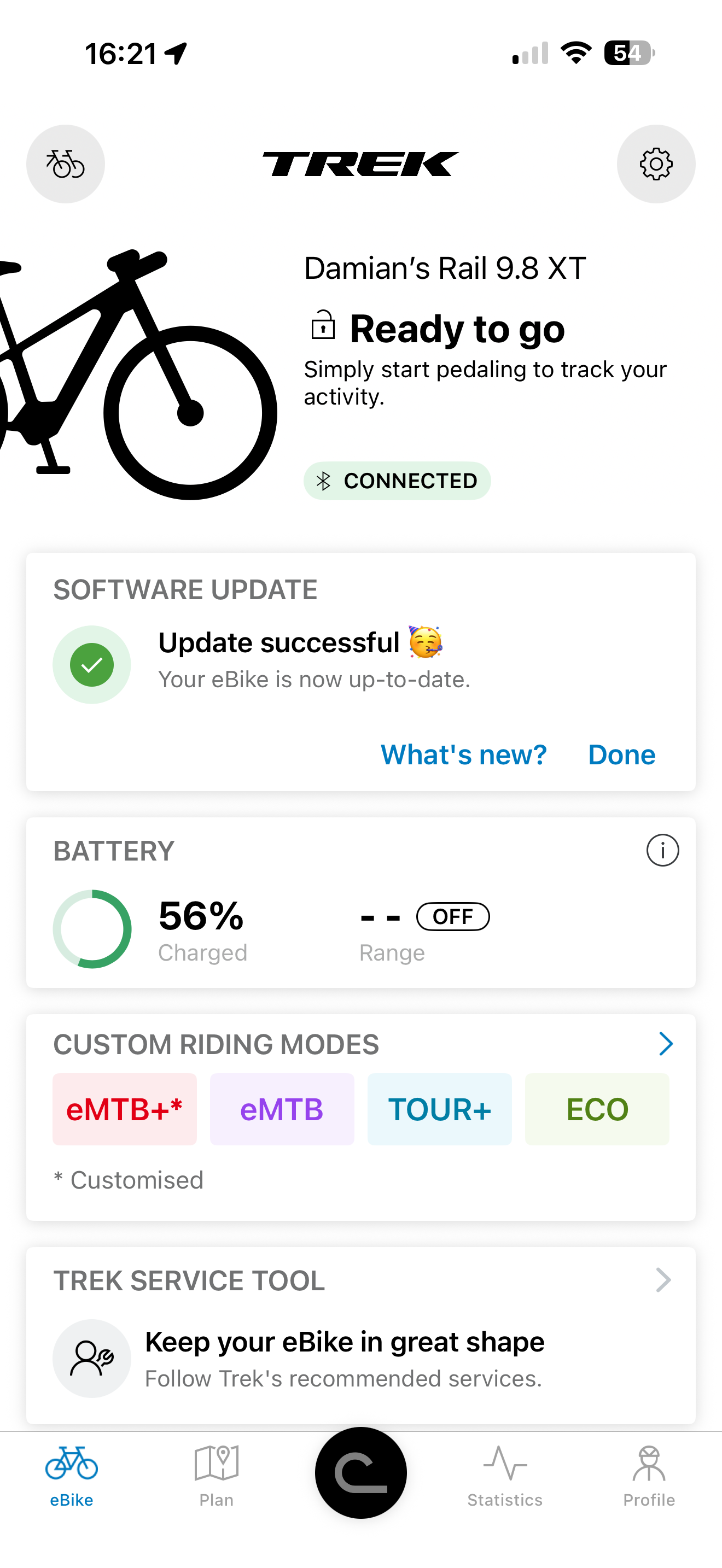

Thanks for the update. Did you experience any issues with updating to the newest Bosch SW updates (included with the Bosch Flow app v1.30)? I've run the update recently with Bulcan connected and it failed to install. Disconnected Bulcan after the initial fail, but getting same results (failed to install the update). I'm wondering now if Bulcan could have anything to do with that.
I’ve updated the app to v1.30 already and rode since then no issues. I can see there is a firmware update too. Just about to try installing it. Will report back.
