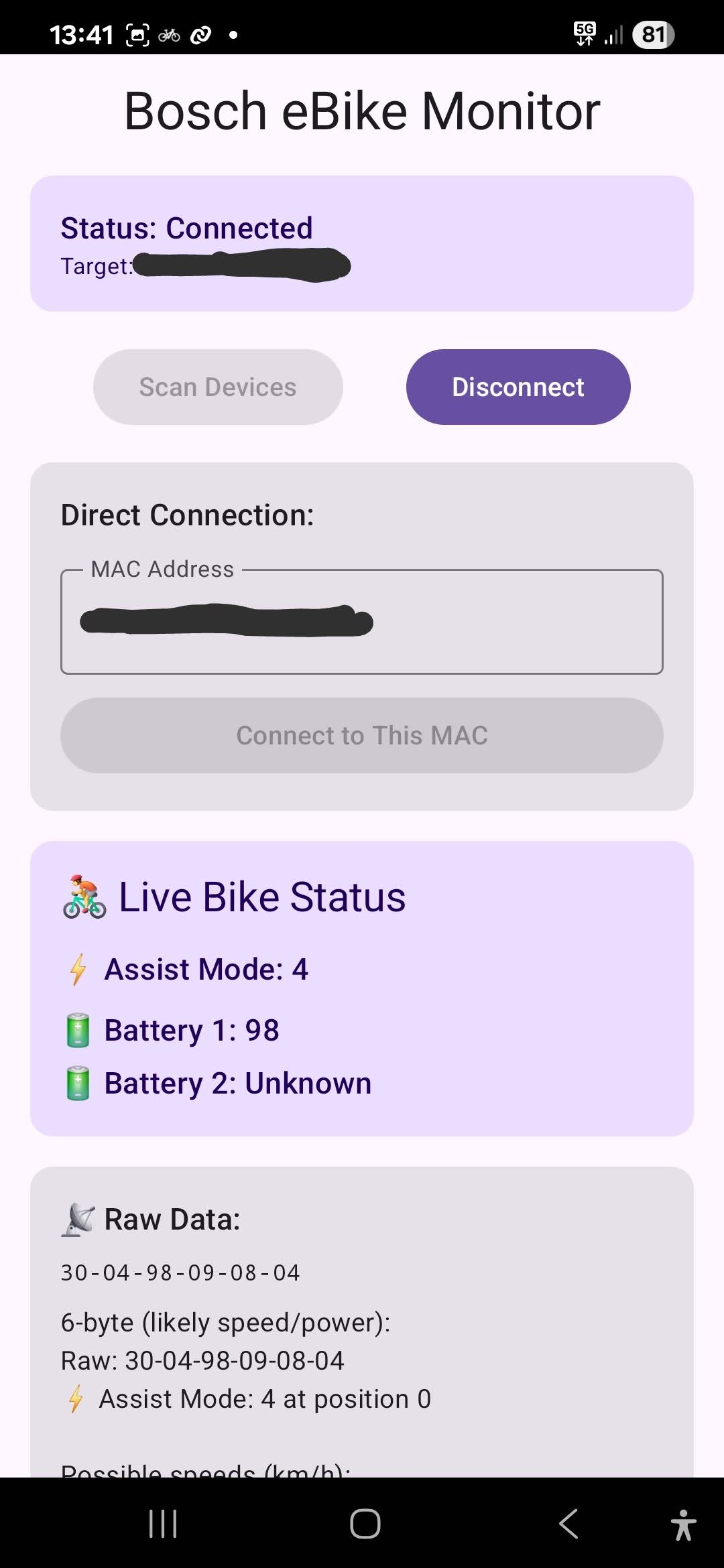

I think I decoded the battery info....
Each bluetooth message seems to start 30-XX where XX is the length of the message
When I looked at the data, my battery was at 99%.. there were only two messages showing the value 99 (63 in hex notation), one of them was
30-04-80-88-08-63
Which I think is the battery level. 80-88-08 must be the code that give battery state of charge.
I cycling a bit more until the battery level dropped 1% in Flow app to 98% and it matched up in the little app I built (well, Claude coded most of it)

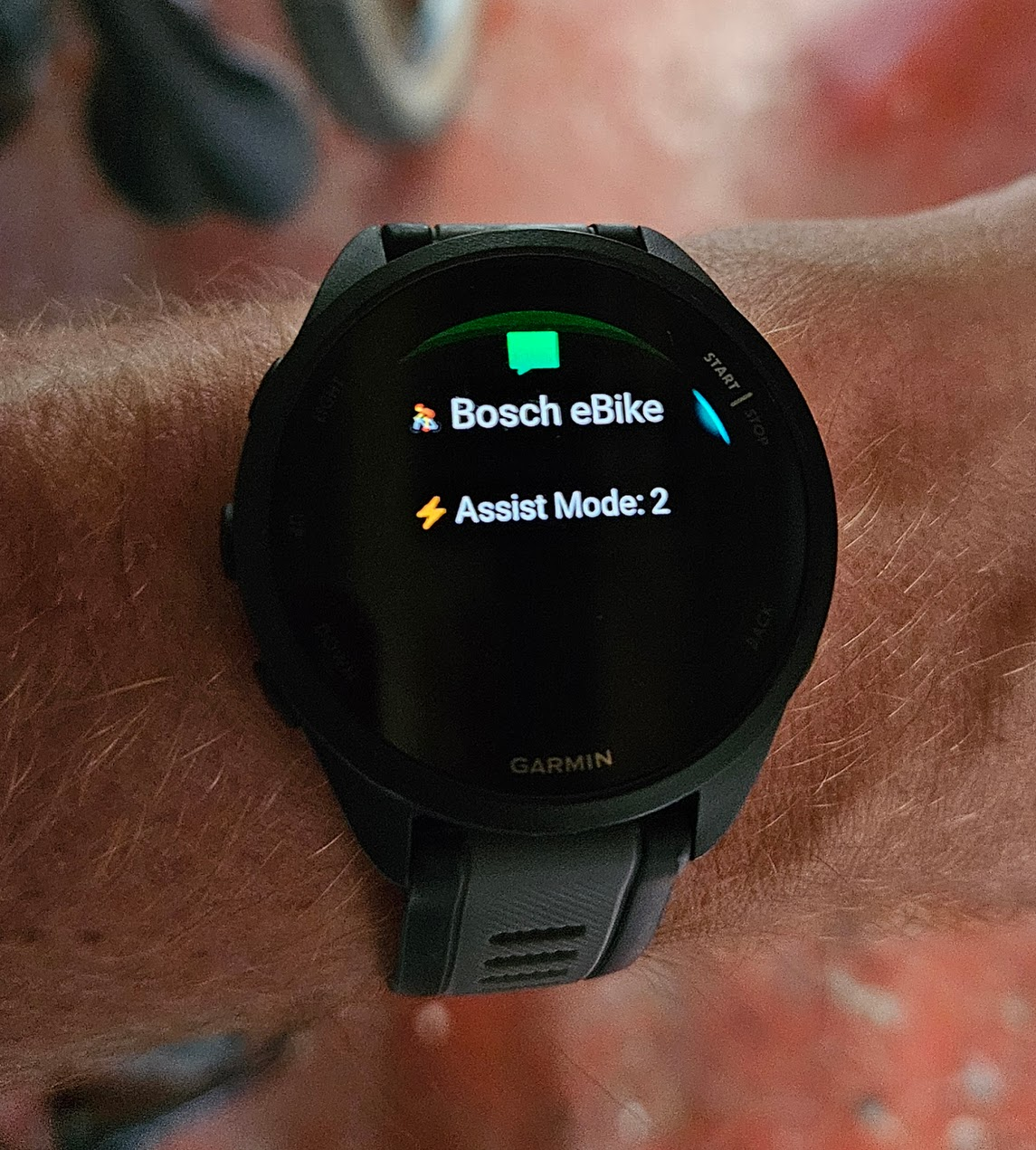

If i publish this as notifcation on phone, it will automatically sync to my smartwatch

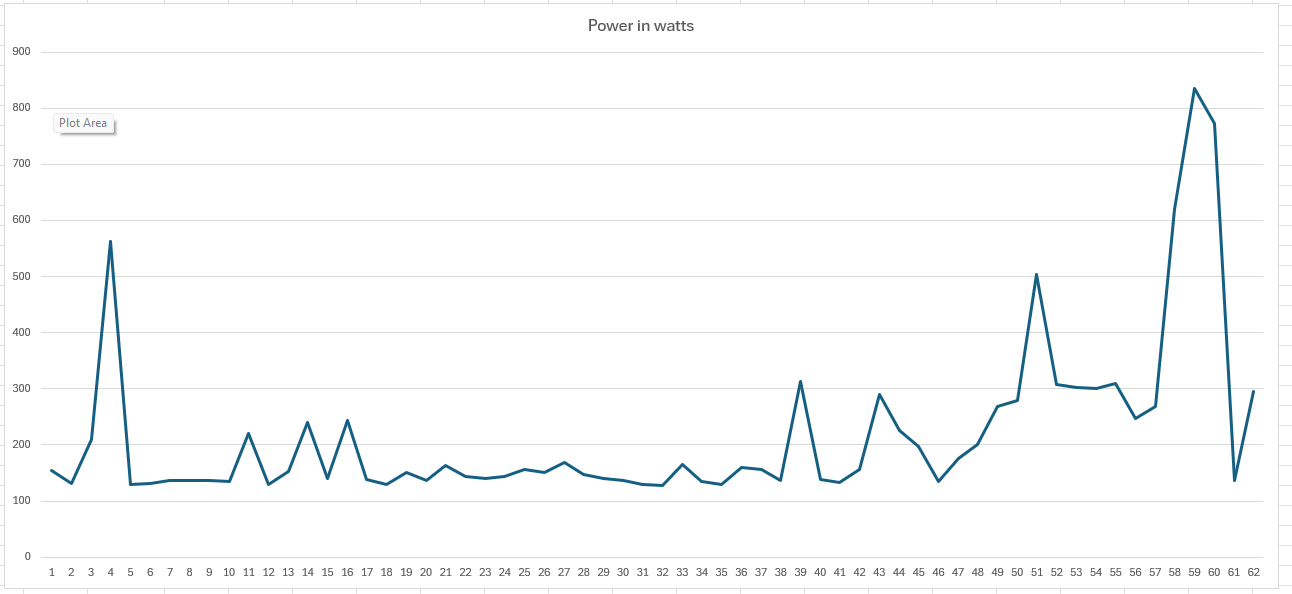

I've figured out the power data!
It's in field
30-05-98-5B-08-XX-YY
Where XX and YY are the bytes for the power data in "varint" format (Encoding)
i get this data out...
Which exactly matches the data saved into the GPX from the Flow app
Now to update the app and push it out as a power meter over BLE
