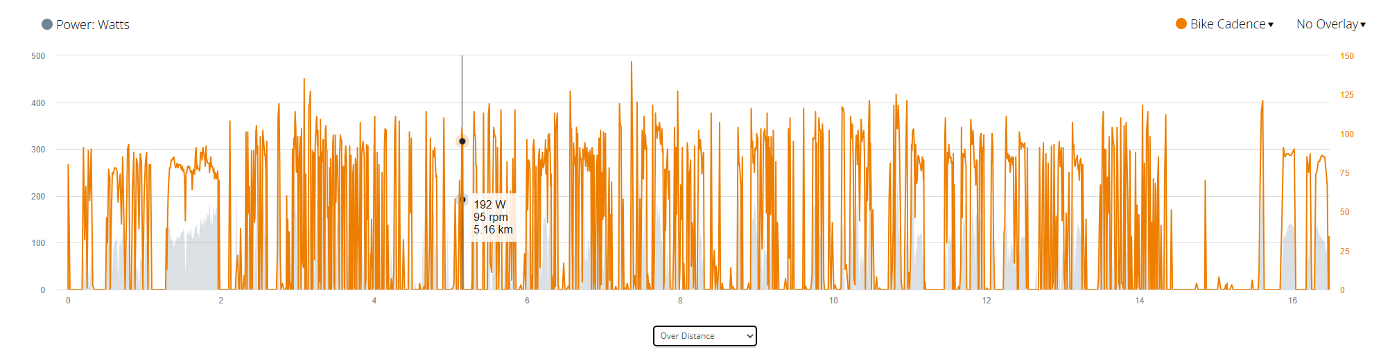

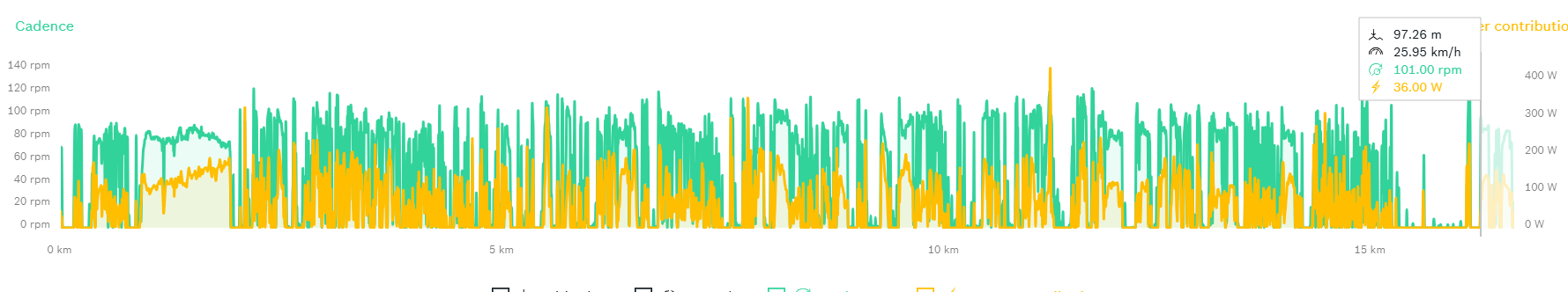

its not too far off for me.
same ride :
bosch portal view
sync to strava, export TCX, import to garmin. garmin connect view:
same ride :
bosch portal viewView attachment 149751sync to strava, export TCX, import to garmin. garmin connect view:
Looks like I was uploading the wrong file type. I guess it’s time to update my Bosch firmware so I can sync my HRM. Apparently the Apple Watch app doesn’t sync HR to the ride file just the Apple health app 🥲

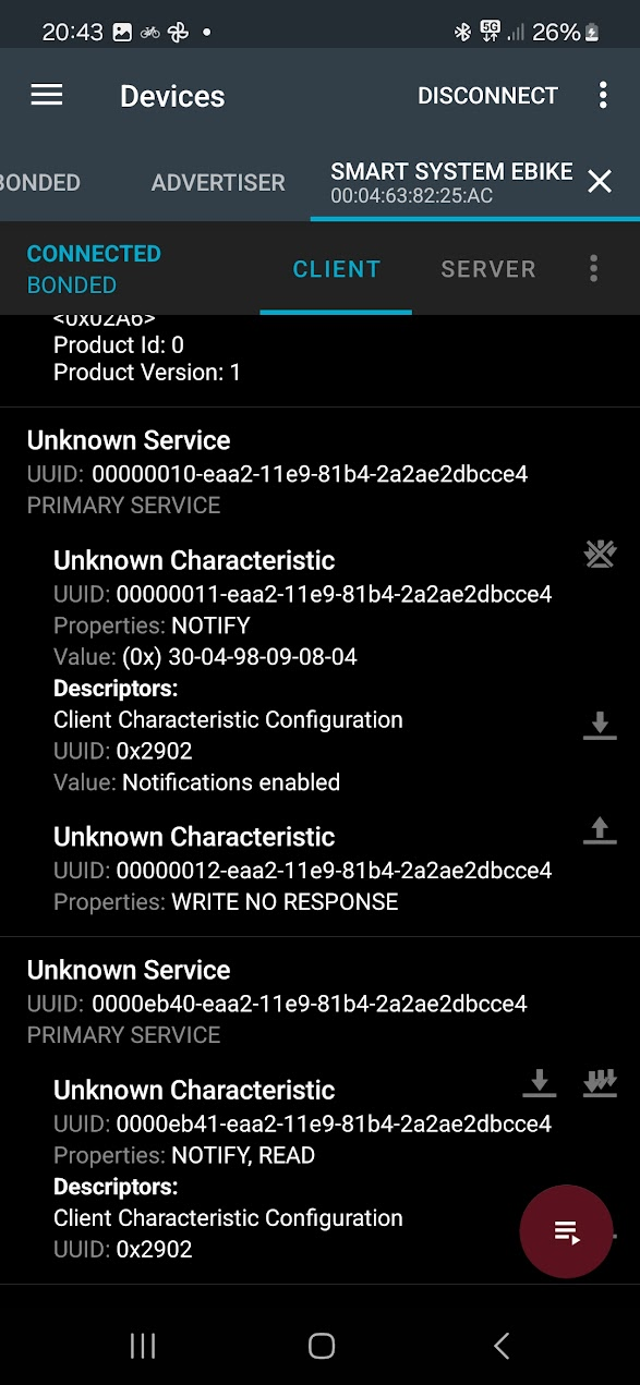

Did anyone figure out more about the BLE connection?
I would love to have the battery level of my bike read using an ESP32 so I can remotely read it without having my phone in range....
I tried reading the data with NRF Connect, but it seems to be encrypted somehow (also, I can't simulate battery level changes and would thus have to read it while riding which is impossible for me...)
I scanned it too, I noticed the last digit of the NOTIFY Value field change when I changed mode on the controller. I don't think it would take to much work to reverse engineer it and get the battery level
Was having a search about sniffing ble and there are some decent blogs on using wireshark to get the details.
I need to find time to see if this works
There's some stuff on stackoverflow
Do I need additional hardware to do this? The first link mentions a "BT Sniffer Board"....
It would be great if I can do it directly from a BLE-enabled laptop (ideally even from a Linux system but I also have a Windows system on another laptop with Bluetooth laying around).
