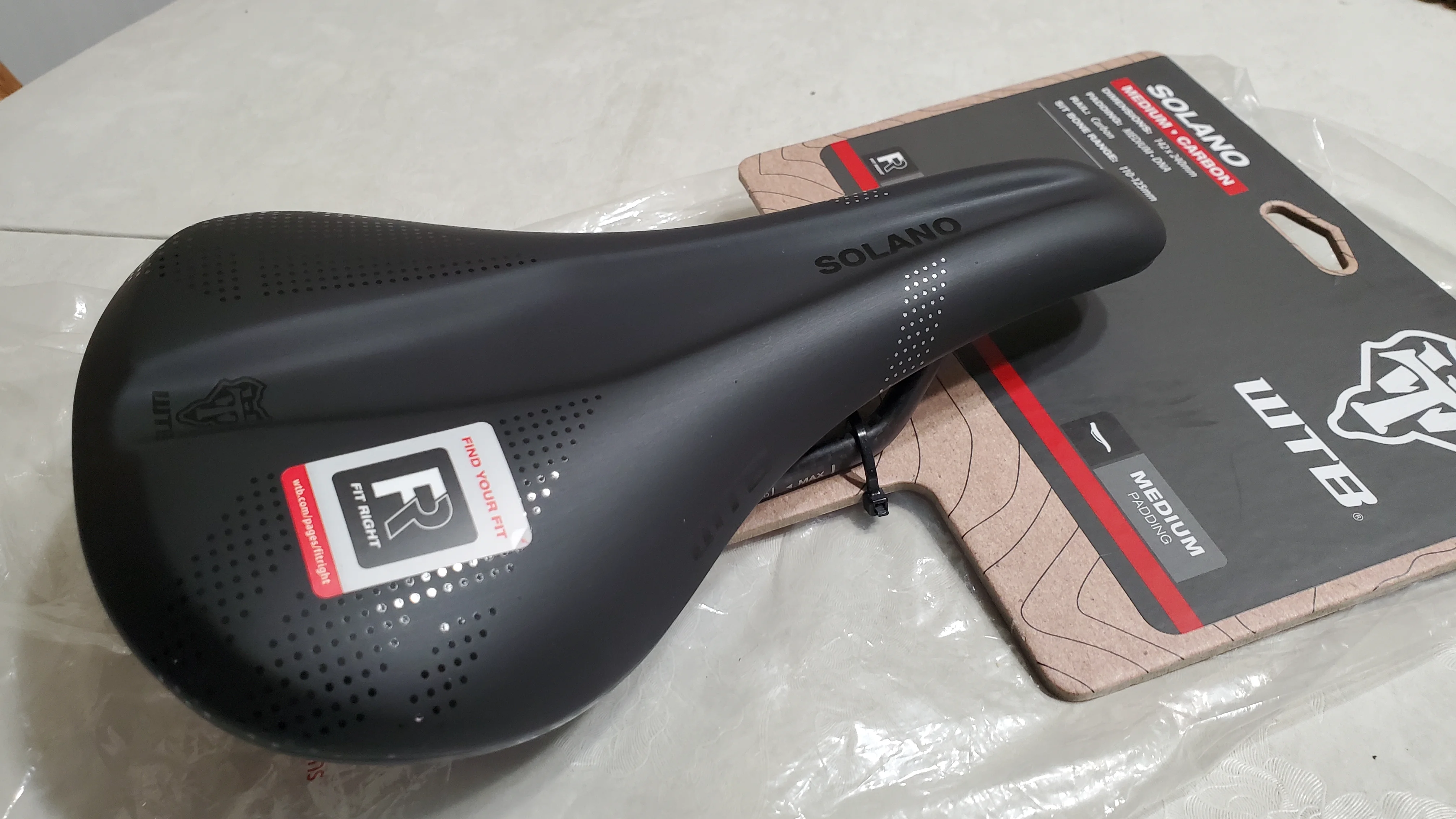

Been wanting to try out the WTB Solano short nose saddle and see how I like it. Just scored a deal with this extra 15% promo for $175 for the carbon rail version to save weight way up top which will help the handling a notch more!
Just dropped 98 grams over my old saddle in the process, and this is not the SL version even.. hope I love this thing!!
Edit: I got the Medium size despite the screen shot, my rear is not quite that large..

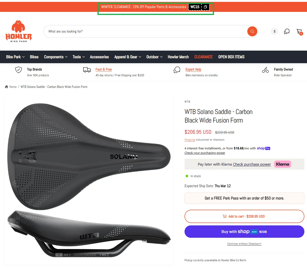

I'm interested in how Howler treats you. I'm almost 100% sure that they just drop ship everything, because there are products on their site that I can not find anywhere that they claim are "in stock". Also, just about everything is on sale there too. another classic drop ship site ploy.

Full disclosure, I had ordered this saddle already but forgot to add it to my weight totals above. Placed the order with howler actually March 4th, received March 7th. Boom, done!
First time with them, but they "delivered" the goods as seen on my dinner table!!

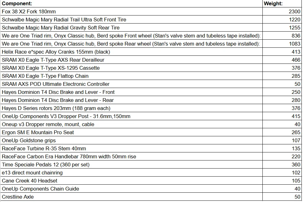

Due to popular demand and fear I am tossing Walmart grade goodies on this Crestline to save grams, I will share my 25 lb "all mountain super dh trail enduro" build groupset with vendor weights for reference!!
Totals up to 11,029 grams which = 25.3 lbs. Add this to the 21.1 lb fanatik math and I am getting the 46.4 lb total without a pound or two worth of misc items (cable, screws, etc).
Dont blame me for going shopping now..!!

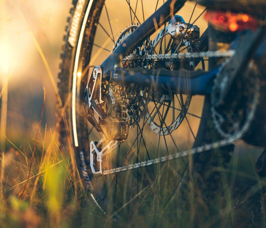

A XX derailleur would be lighter and just as reliable. Is money dictating why you’re choosing an XO?
As far as OneUp goes and the VPP tunnel, my plan was to run the stiffest cable I can find that will fit to help reduce kinking.
I spent some bread at Howler and had the goodies faf. Ordered 3/2 and took delivery 3/6. Hard to beat with 15% off too. Not sure where it came from, but I’m in the middle of nowhere, NW Florida.
Oh, and a free park pass with my order. Too bad its a 12 hour drive. Maybe if I hit Bentonville this year….
An XX derailleur would be lighter and just as reliable. Is money dictating why you’re choosing an XO?

XX only 12g lighter…
Check this out SR52T Cage for SRAM Transmission - Ratio Technology
the x0/xx cage is less sturdy. if you really use your ebike, you have a gx derailleur for its strength, the x0 cassette for its weight and the xx chain to keep both running for a long time.
Dont worry, I didnt pickup an XX! I was actually being sarcastic, as I thought that question for me was surely sarcasm as well. Weird when strangers on the web are asking if you are having money trouble when purchasing a $15k bike!!
I am pretty sure the good old mechanical is the lightest and most affordable option still if that is the game which I think we all agreed it is not. I took an Amflow for a demo though, and that damn auto shifting without pedaling got me before my first ride was done!
The ultimate question (not really) - Why XO then? Seems to be the goldilocks group.. Not to heavy, not too pricey, and I will gladly admit that I am keen to it's bad ass black tones to match my raw carbon!!
Ok all, I actually did not buy the lightest weight parts I could at every turn for the record, I was simply asking about the weight of the frame since I was stoked seeing this thing is going to be 5+ lbs lighter than my current bike as I totaled up the weights.
My build is curated for how and where I like to ride, and the components I simply am drawn towards accordingly. I am very active in the saddle or when standing, and appreciate sharp nimble handling. Shedding weight enhances everything I do on the bike to a degree (accelerating, braking, changing directions, jumping, etc), but I also need the ebike to keep on going through the rough, really fastly!
So I did my best to source components that will strike the balance of high performance I desire by shedding weight on rotating mass, unsprung weight, and weight up high like the dropper, bars, and seat which I can feel improvements in performance. And of course, they got to be SEXY in my eye's too!!
When I totaled up all the parts other than the carbon frame and saw a 39.1 pound total I wanted to get some confirmations on the frame weight to get more accurate.
Reached out to the "T-man" and believe it or not he told me he does not have the frame weights for these things. Does the last gram matter? Of course not, this girl is BEAST already!
Do I want to know how much my mystery bike is going to weigh? Hell yeah I do!!
FWIW, I've used all models of T type derailleur and in my experience the XX (not SL version) performs substantially better than lower tier models with not difference in durability. XO and GX performed the same for me.
In what aspect? Rob tested them and said he couldn't tell the difference. I suspect the higher end chain is going to be what could make things smoother due to the full chrome plating. As a Shimano guy it was a hard pill to swallow but I'm doing GX transmission with with the XX chain. Mostly since the Avinox already has integration in place, and the new Shimano has no clutch. The XX chain wasn't cheap @ $155 but I had similar experience with XTR chains lasting way longer which are also plated so I think it's worth it.
In the same boat, I was ready to order the new di2 wireless stuff then saw the no clutch and no guarantee there's avinox integration (I heard it's happening at some point).
I cannot find any fundamental difference in shifting performance between any of them.
I'f I was building a bike, I'd go for the S1000 level mech (not sure it's available aftermarket).
The rest is superficial IMO.

To keep it short, the GX has 2 very well-known issues: pogo pins breaking (I didn't experience this) and play in the frame mount causing inconsistent and rough shifting. XO wasn't any better with shifting consistency; it often needed resetting for no apparent reason. I could only guess why??? XX has been flawless for 9+ months. I've read reviews on all sides so YMMV, but have you seen how Rob is running his bars/stem these days... do you really trust a guy that likes that setup!?!?!?!? 😉
