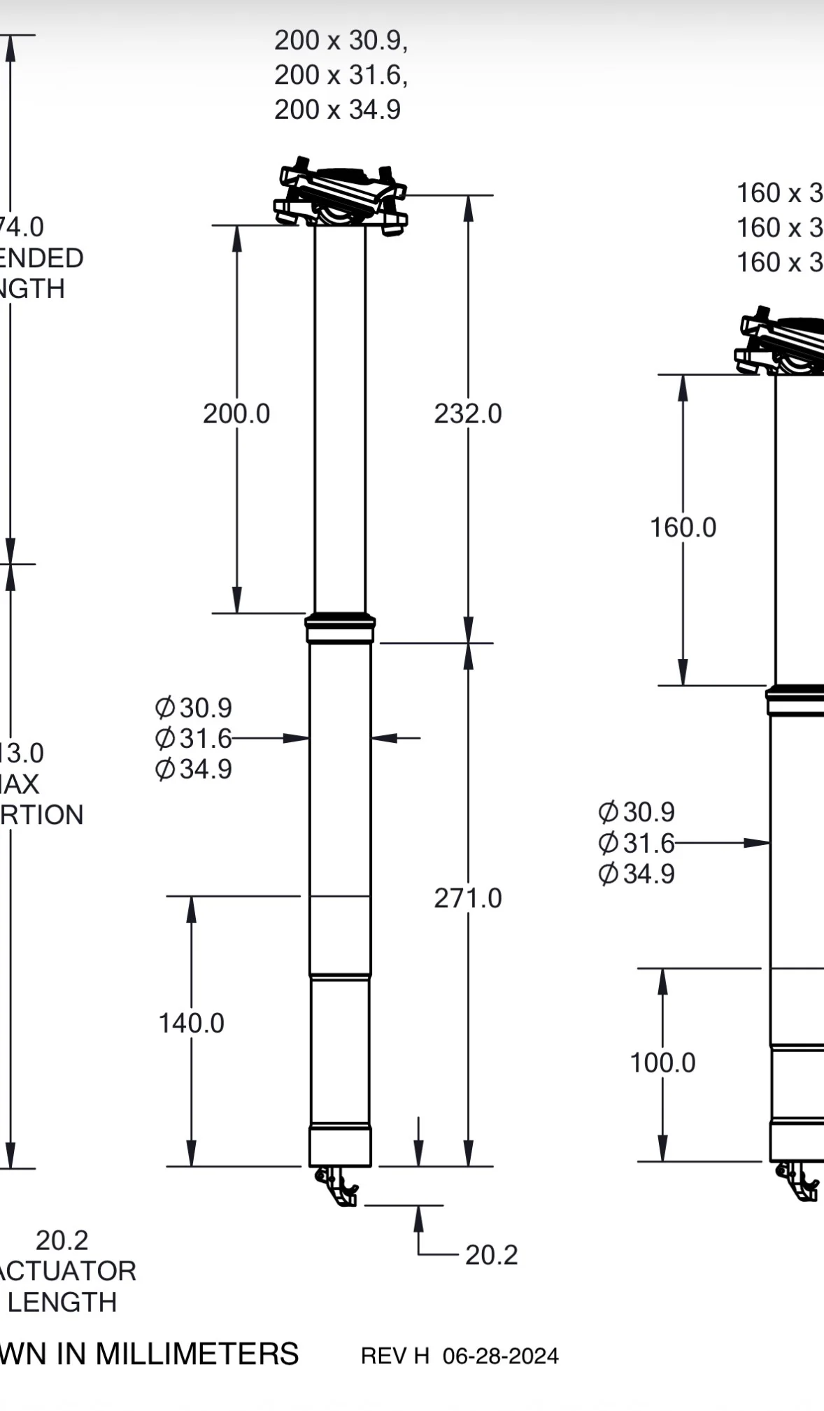

Check out the 200mm offering from Wolf Tooth. It has a much lower insertion length. I posted about this a few back. Seems to be the best solution for those on an RH3 around 6' tall looking for max riser and being able to get as close as possible to fully slammed. One UP 210 mm insertion length 305 vs 271+ 20.2 (291.2mm) on the Wolf tooth. That's nearly an inch!

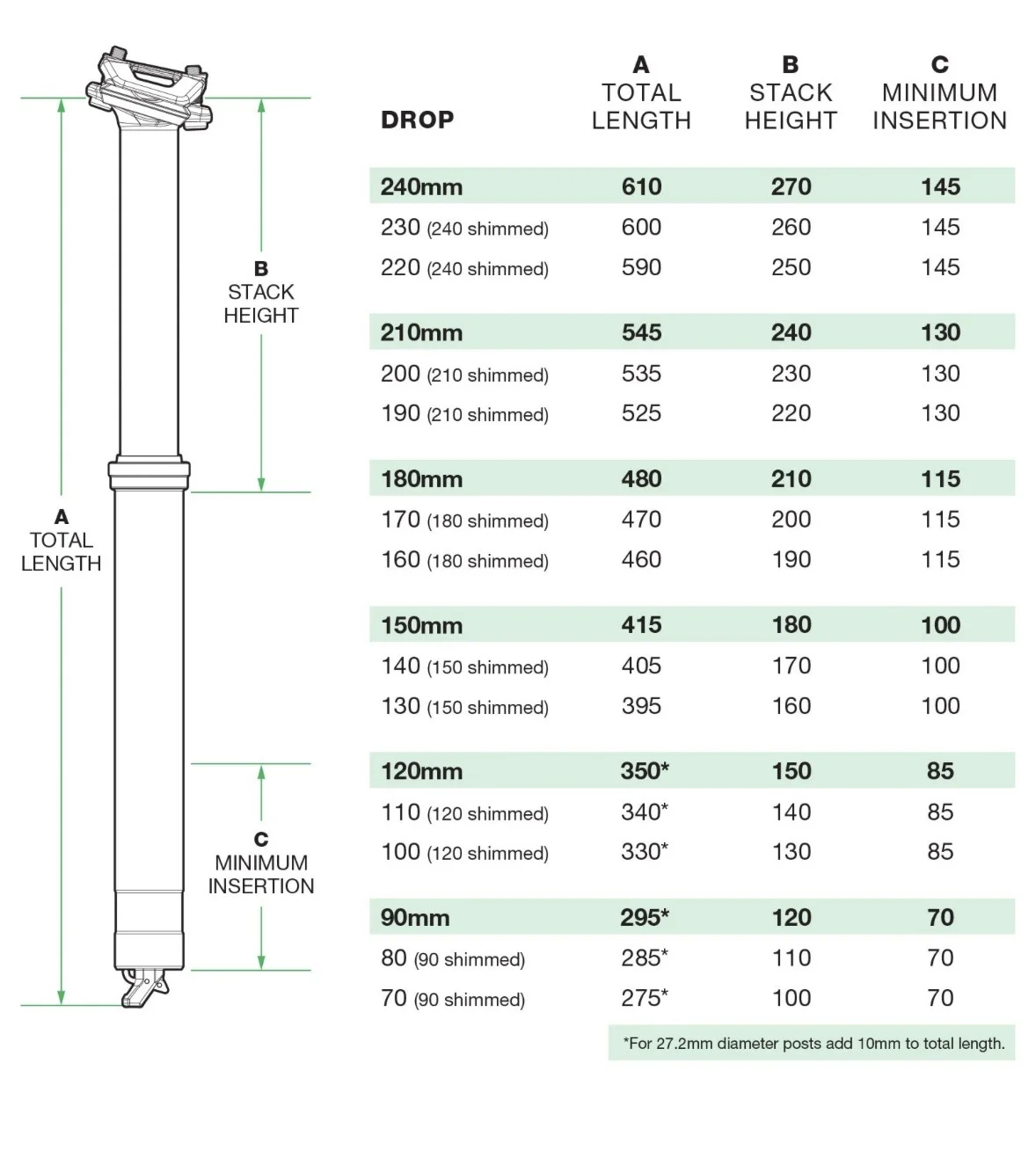

The 200mm WT’s insertion length is 21mm longer than the 180 OU according to the specs online.
I'm comparing the 210mm vs the 200mm since this will provide the height needed for me. Haven't bothered looking at the 180.
The OU 180 has the same insertion length as the WT 200, on second glance.
And it's a bit suspect to me that OE doesn't list their insertion length and requires some math to sort out...
Gotcha, if you look close at the added 20mm’s for the cable connector, it’s 21mm’s longer from the collar down.

Its not. I added that and noted it in the math. its checks out . 271+20.2=291.2 vs 305. The WT has a shorter insertion by ~15mm. I am hopeful I can squeeze out a couple more mm with some creative cable routing. I like my seat slammed.

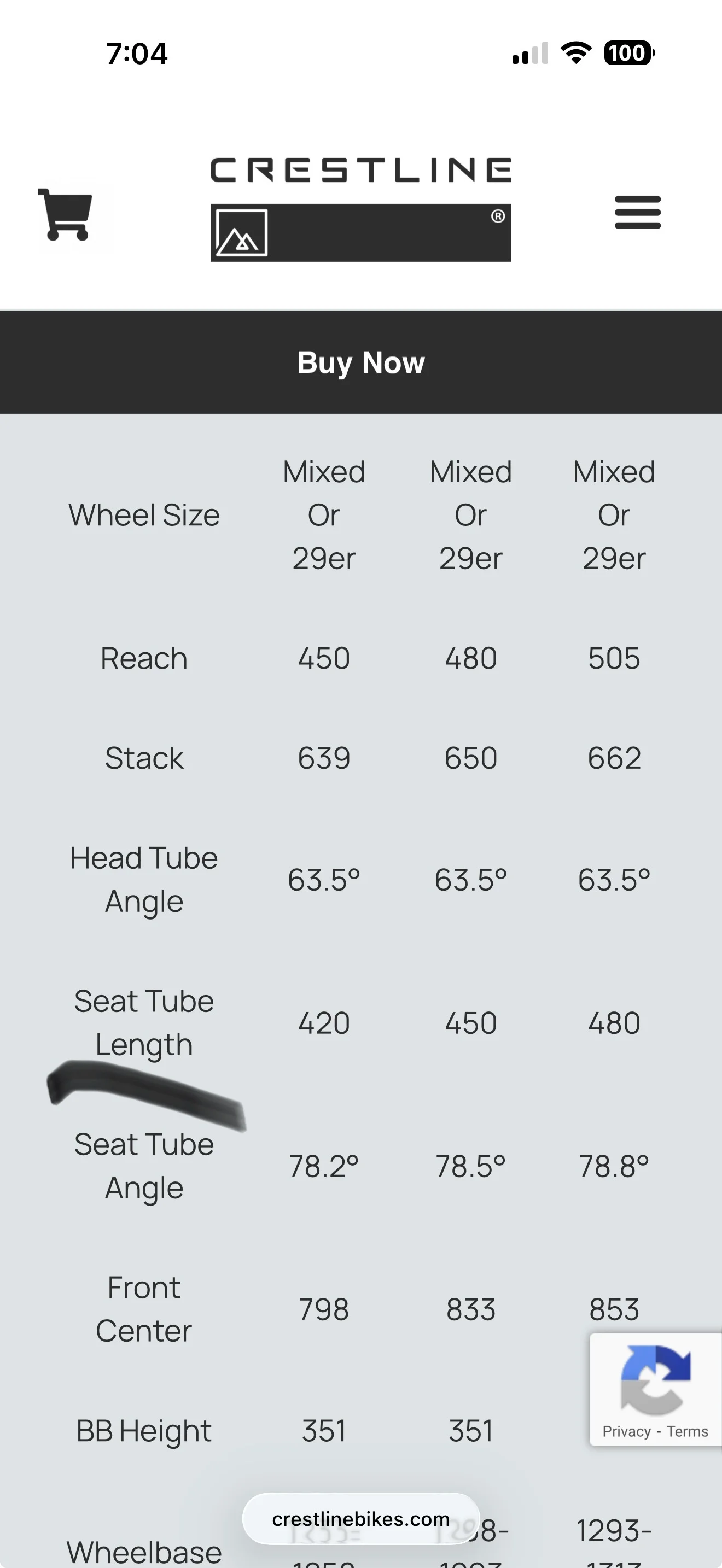

Does anyone know if the sizes have the same rear triangle for the 29 vs MX versions? The RH4 only had an MX option but the other sizes had both an MX and 29er option. I was hoping to use the 29er wheels from my current rig.

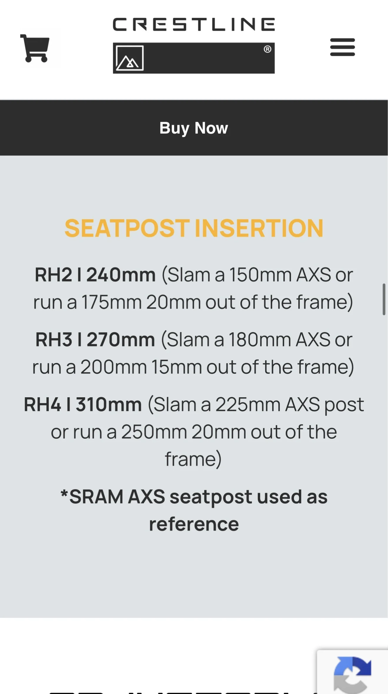

I currently have a reverb axs 200mm post I was going to use, but curious if it will be too long for me, sitting 15mm out of the frame. Kind of bummed it won't fit slammed into the frame but oh well.

I know youre being sarcastic, but isnt the info everyone needs right on the website?? Add that with the saddle height on your current rig and you should know what you need.

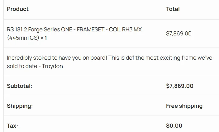

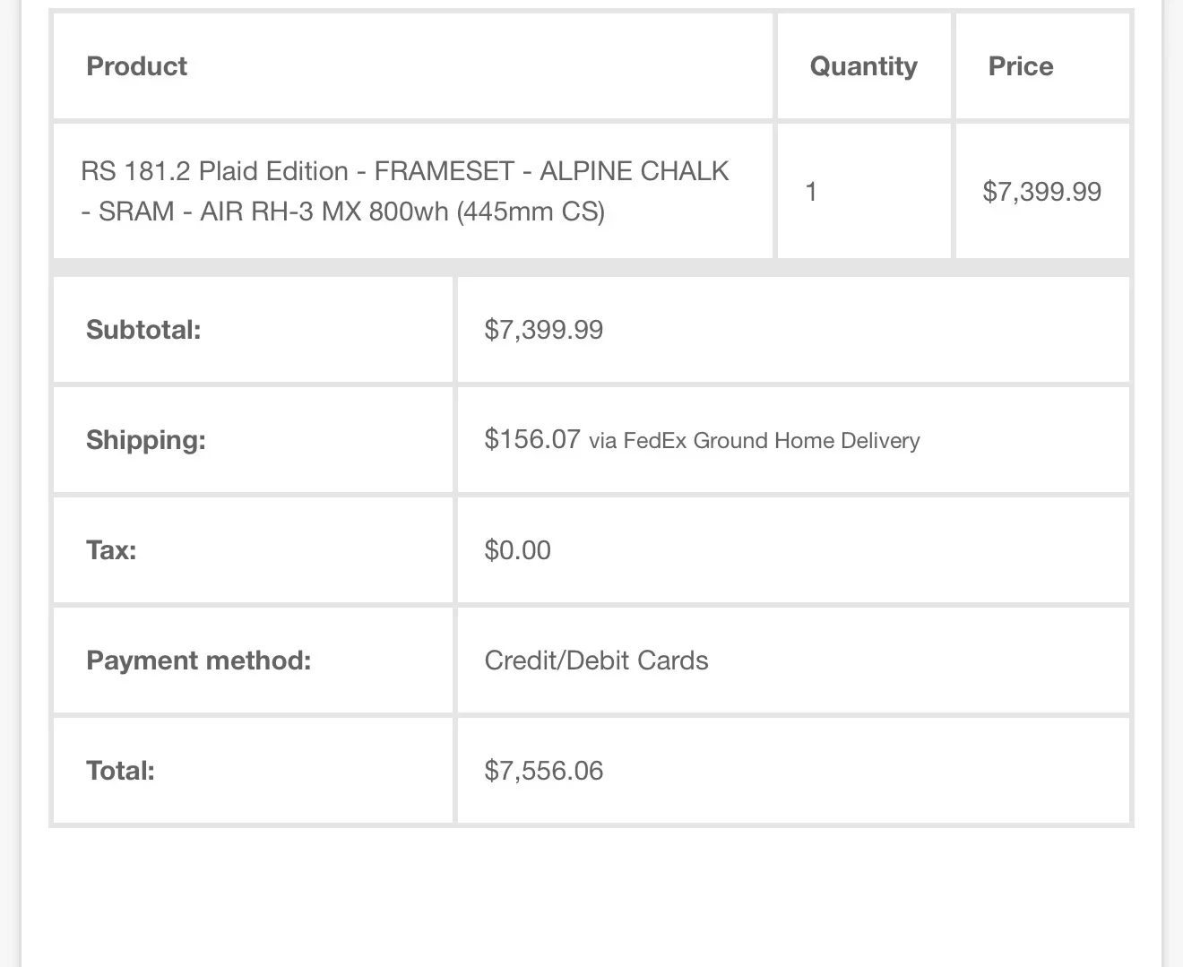

Do people outside of CA get dinged for state sales tax on their Crestie purchase price?
Not sure if it varies state to state, but I am in currently living Florida and didnt have any. IMG_6316.webp
