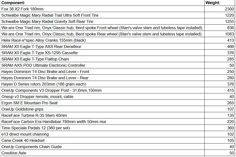

Due to popular demand and fear I am tossing Walmart grade goodies on this Crestline to save grams, I will share my 25 lb "all mountain super dh trail enduro" build groupset with vendor weights for reference!!
Totals up to 11,029 grams which = 25.3 lbs. Add this to the 21.1 lb fanatik math and I am getting the 46.4 lb total without a pound or two worth of misc items (cable, screws, etc).

Are you accounting for the shock (and spring)?
Dont blame me for going shopping now..!!
Fork is likely 2400 grams+ (they vary).
That rear tire is probably a bit more as I recall.
You are saving a ton on that dropper. Literally my 200mm AXS is nearly a pound more. I did this on my new build due to HCR and hopefully for better function.
Add .5# for sealant. Did you know manufacturers don't include sealant in their weights?
I try to buy the good components that have good weights, however the bike is going to weigh what it's going to weigh in the end to do the job that is intended.
Good points all around guys,
I didnt include the shock and spring specifically above, but I did extrapolate the total weight from a fanatik site build which I assume included the shock, although it was a Rockshox vs Fox.
The Fox fork weight was an estimate as I could not find the actual factory 180 mm X2 damper list weight, so there is likely a bit more in it for sure.
I did not add sealant weight individually either. In my overall spreadsheet I added 500 grams for miscellaneous, so this may be too light of an estimation on my part also.

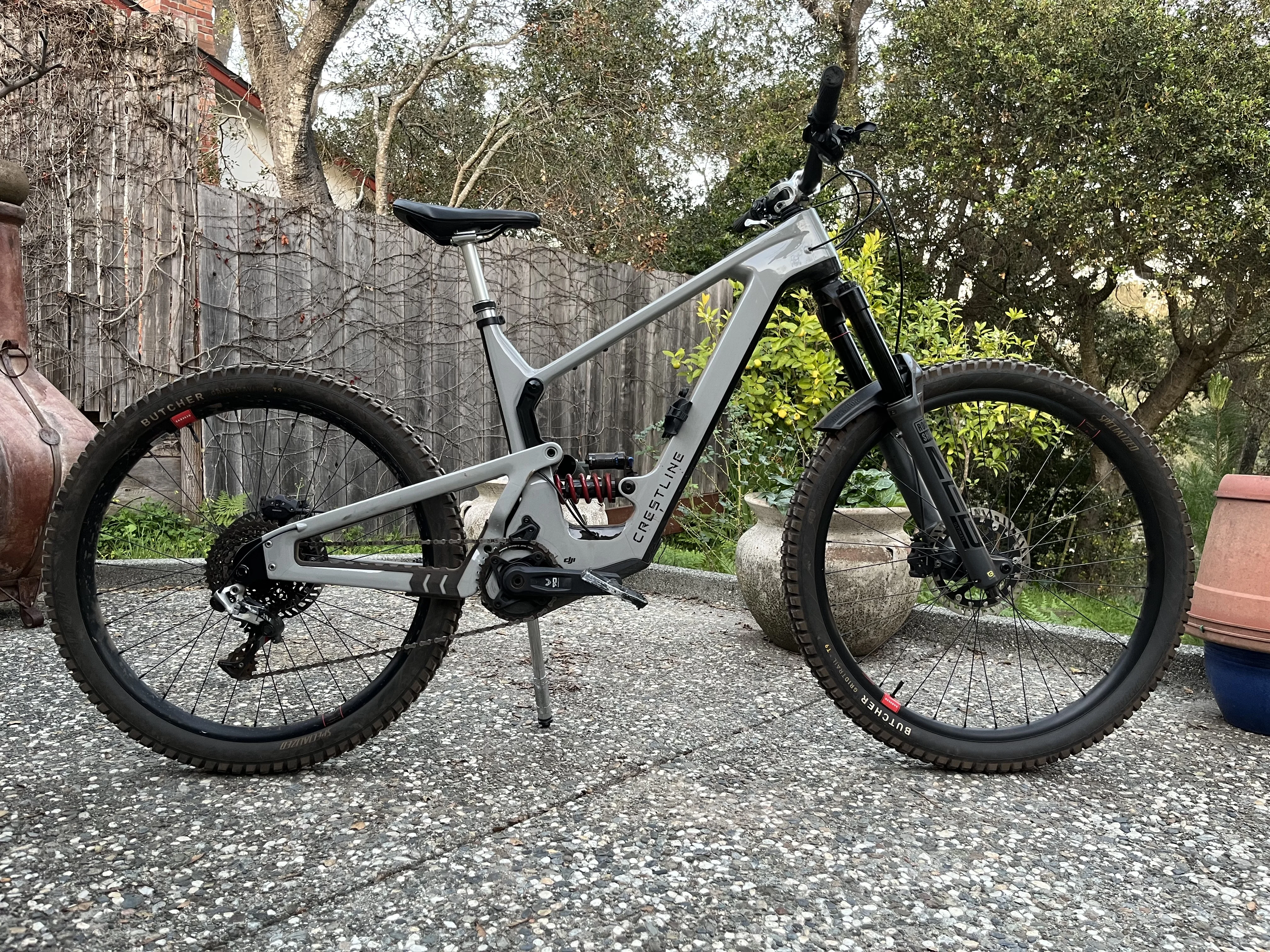

Shooting for total weight of 47.5 pounds (RH2, mx), why not?! ;)
RH3, 600wh - 50.3lbs with pedals. I wasn’t going for ultra weight savings but was being relatively conscious about it. Reserve al/hd wheel, zeb, coil, aluminum bars, grid gravity rear tire, grid trail front, xx1 11sp, shmaven brakes.

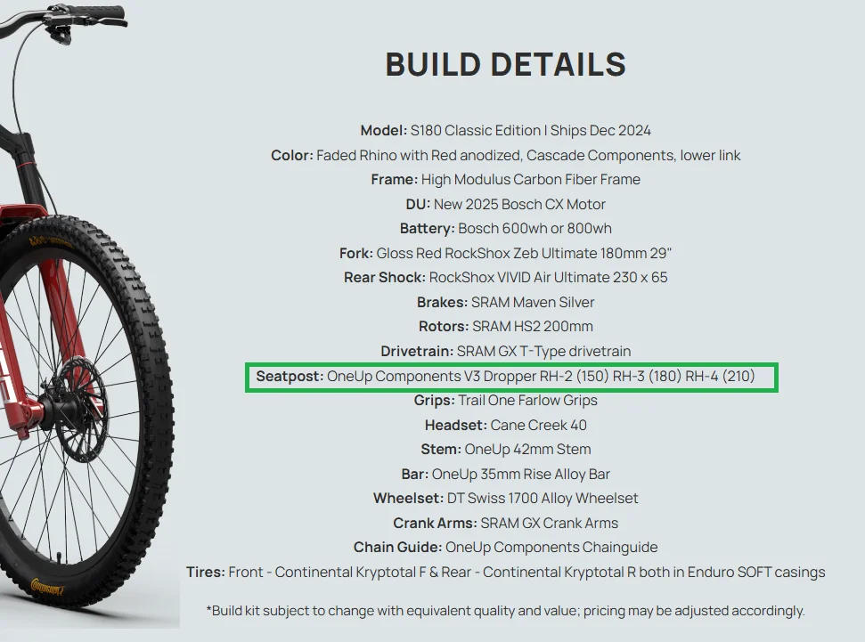

Is anyone bothered by shorter droppers on these frames? I now run 213mm, but on RH2, the maximum is 175mm.
It had me slightly concerned but I think I'll be fine with a 200 v3 on the RH3 after mental mathing it for like an hour.
