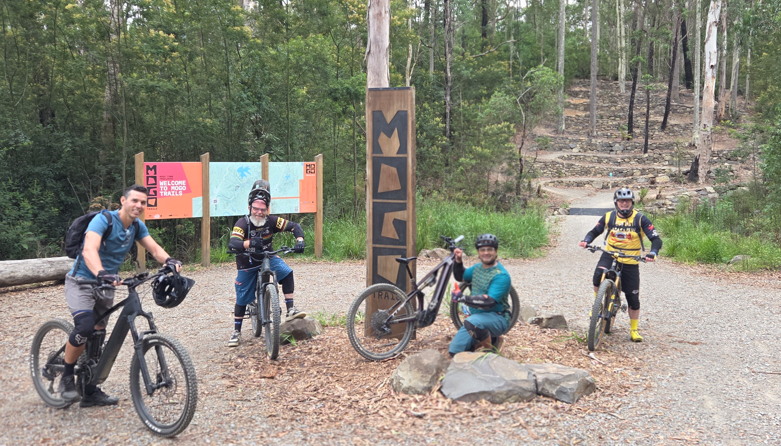

Went to Mogo Trails about 4hrs south of Sydney and what a fantastic ride. Had an absolute ball. Favourite run was "Big Dog's Bone". So much speed. So much air.
Rode with this new guy James. OMG he was fast downhill and wow, did he have skills on his 180/170 Giant Reign. I managed a graceful second fastest downhill in the group of 5. But on the climb up, the Amflow just smoked them. I was 3-4 mins quicker on the climb and only using Trail Mode.

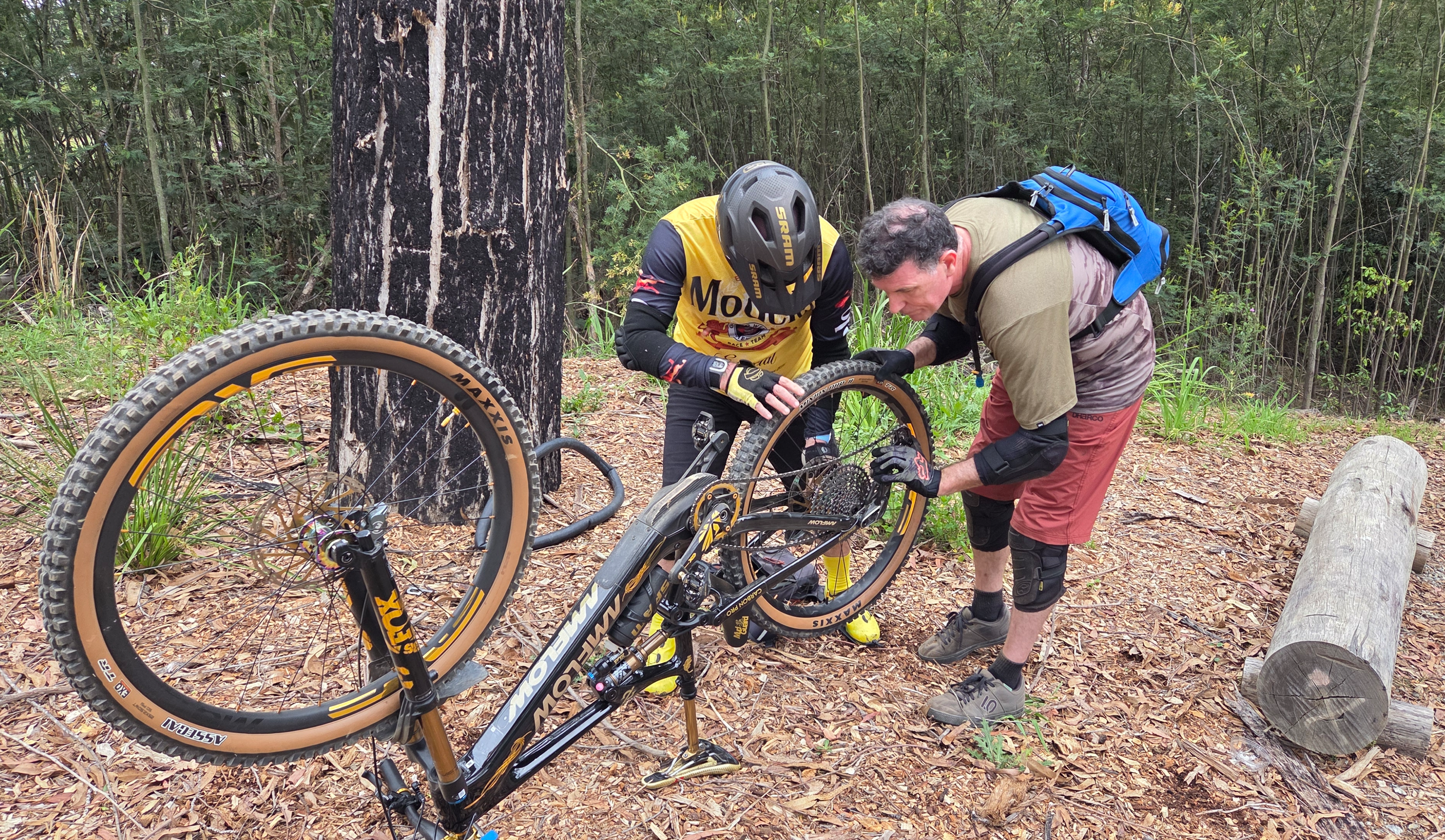

I am riding so much more aggressively now and have pinched rear tubes in 3 of the last six rides, despite increasing tyre pressure to 28psi. So I have fitted Tannus Amour Insets to the rear wheel, with 60gram TPU tubes. This means I can still run the really grippy DHR 2 rear tyre with EXO casings. Total weight increase compared to going to tubeless, sealant and DD casings, is only about 100 grams.
All reports say this should fix the puncture issue.
