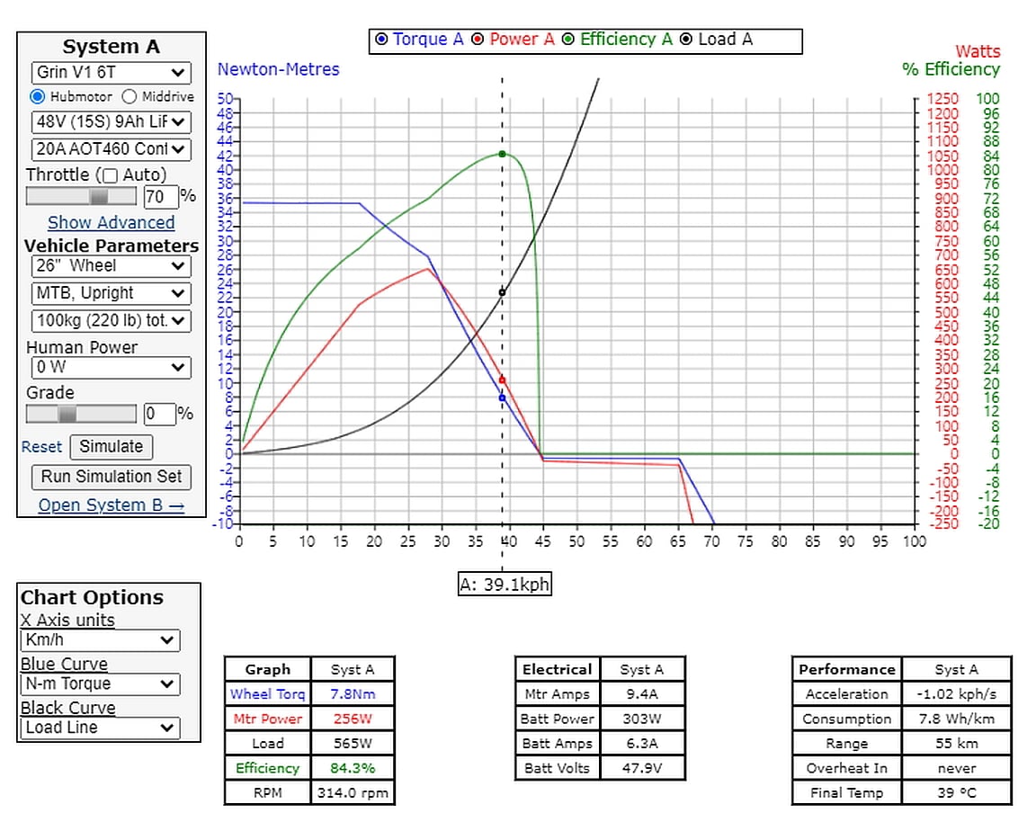

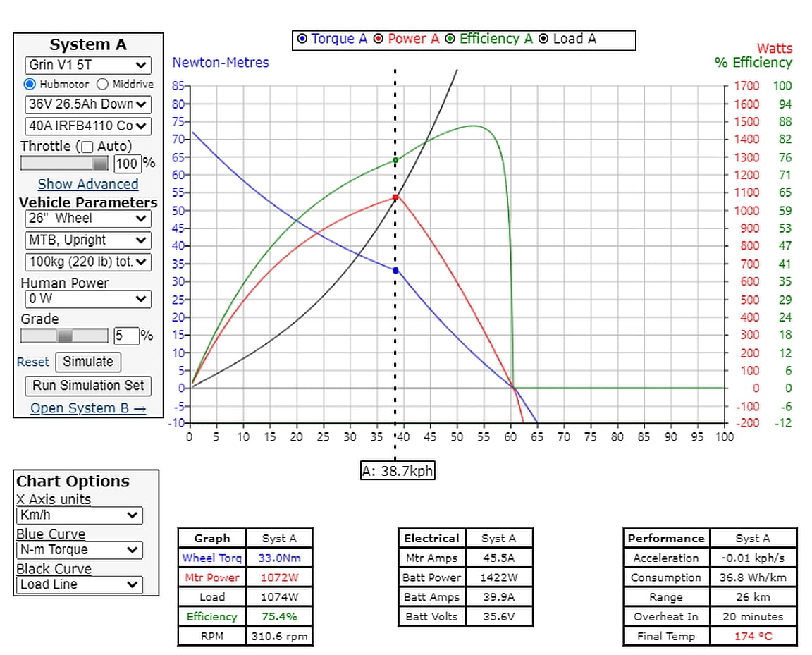

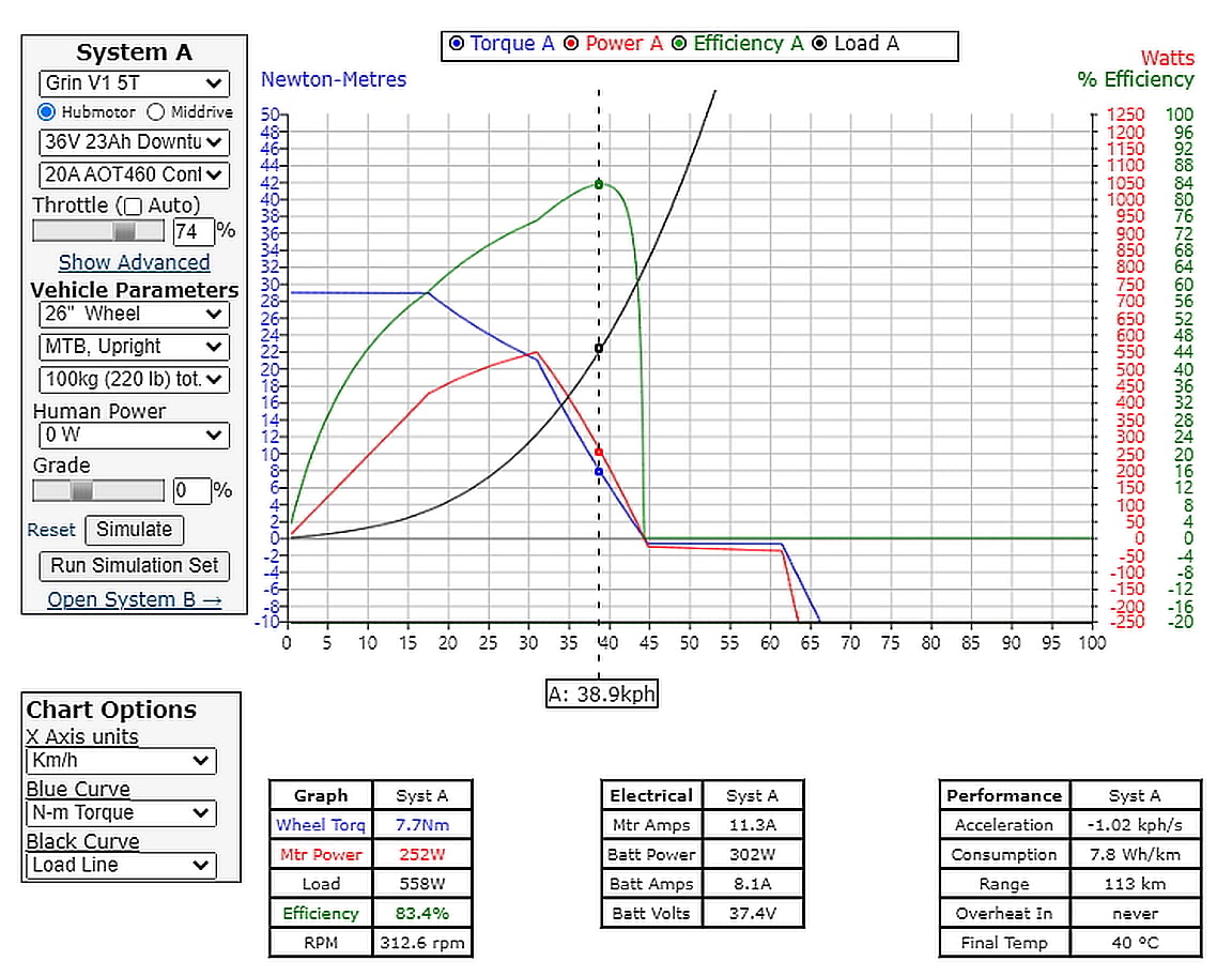

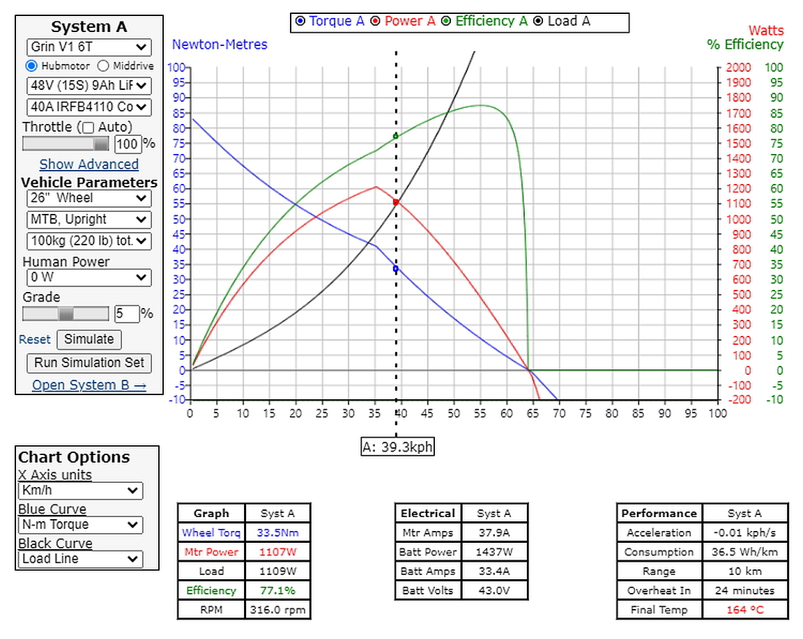

Not quite, I made a video about 36V vs 48v systems.
:)You sent me down a rabbit hole. Thanks.
The excellent motor simulator on the Grin Tech site gives us some clues as to the possible efficiency gains from increasing system voltages. I set the throttle to yield the same motor power of 250 watts and chose a 6 turn motor for 48v and 5T motor for the 36v system to get the best efficiency for each that I could come up with. Which showed the complete system of battery/ controller/ motor, losses and efficiency to be only about 1% better for the 48v system.
Very weird result, that there should not be any difference at all. I checked with people who work with these systems that claim that there is a significant difference in efficiency due to thermal loss (which absolutely differs), power drops from the battery and added electrical resistance due to higher temperatures. But I will gladly check your link!
Would be fun to send Mahle an email and ask why they went for a 48V system. I guess that they will not agree with Grin Tech.
