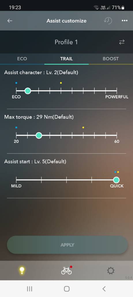

I am 72kg and ride medium size M20. After average ride of 40km and 800+m of elevation I still have 3 of 5 bars of battery left. 90% in trail mode in 10% boost (profile 1). My wife who is the same weight and ride same type of Rise, consumes one bar more of the battery at the same ride.

This is my setting.

Right that makes sense. I also notice a massive difference between muddy and dry conditions and between max grip and max terra tyre compounds. Now that we have dry trails and I’m running max terra on back it’s much more efficient. I’m in Scotland btw. Very muddy winters.
