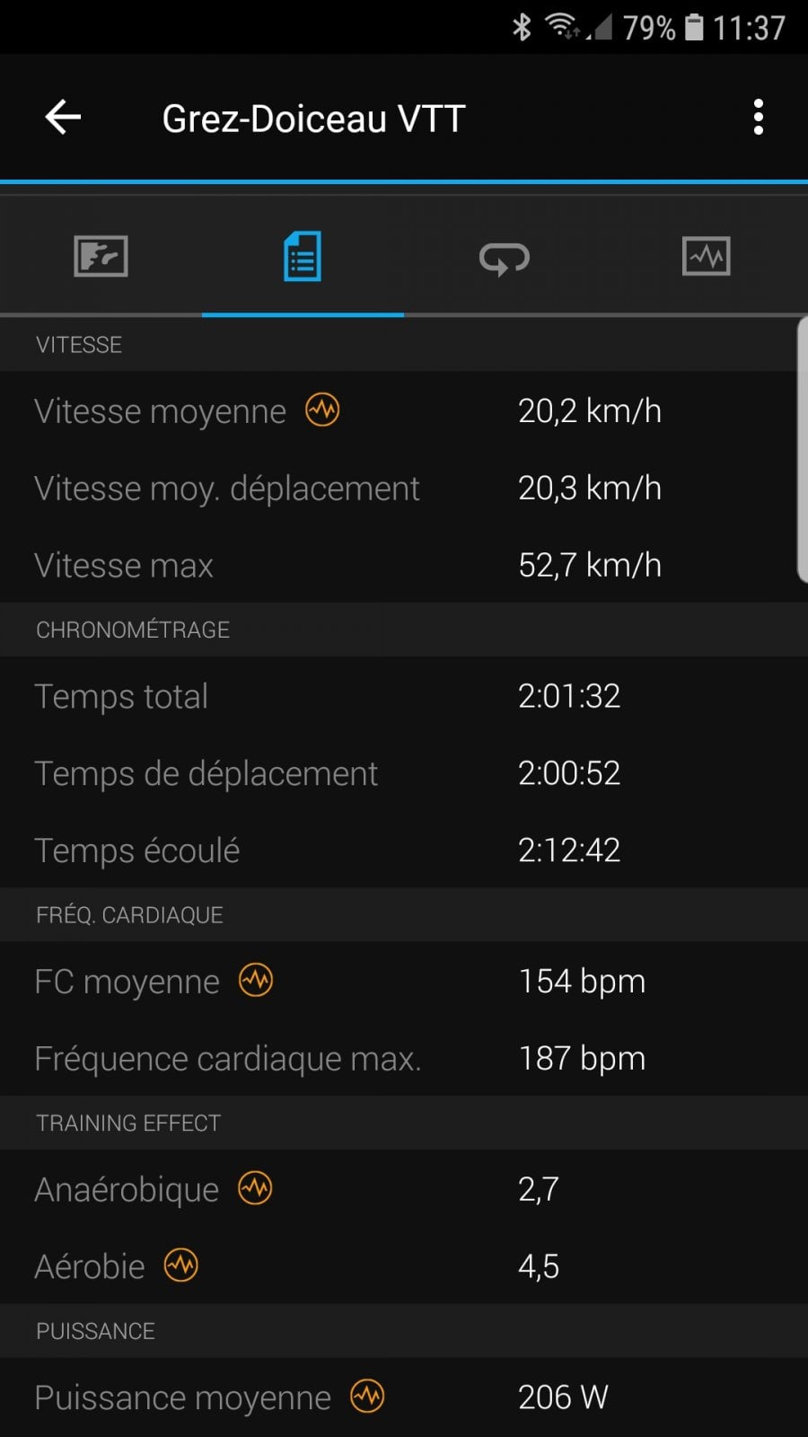

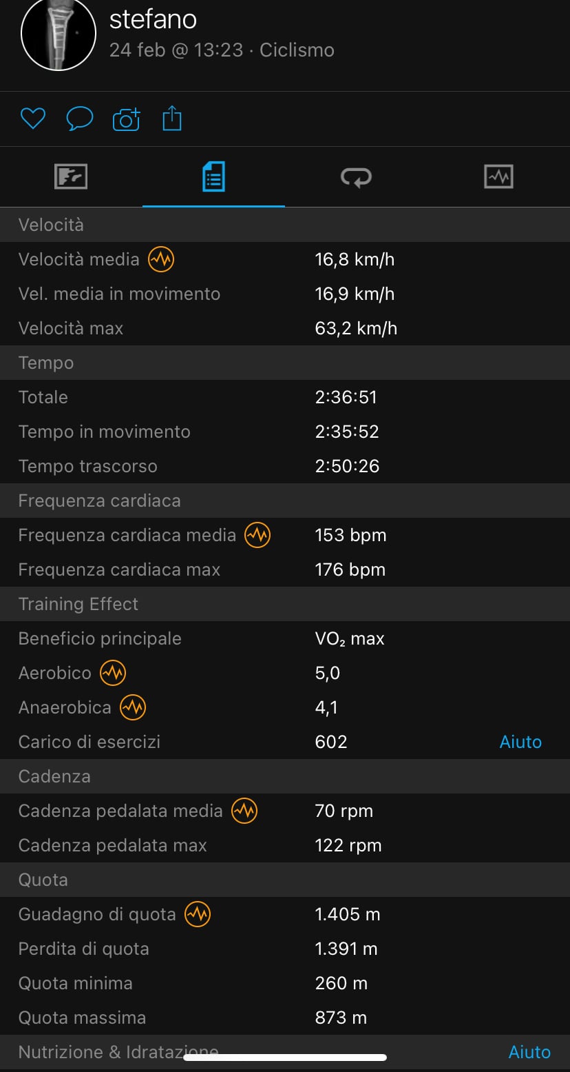

Yesterday , very hard....16,9 km/h avg

avg ? With extender? Total km?
Sorry, that was without a range extender, just the battery. It´s straight from the GPS but i want to run it through a program i have to get more accurate. 78km. The average speed isn´t right so I need to get that. I´m doing a series of tests with different weights, modes and comparing HR and range to the Wild FS and to a normal bike. The biggest effect we have seen so far is conditions, mud / snow and cold on the first test meant we got about 50% of that.

The lap I did the other day was at 17 km / h, your average will certainly be much lower. However good result
but too much data is missing

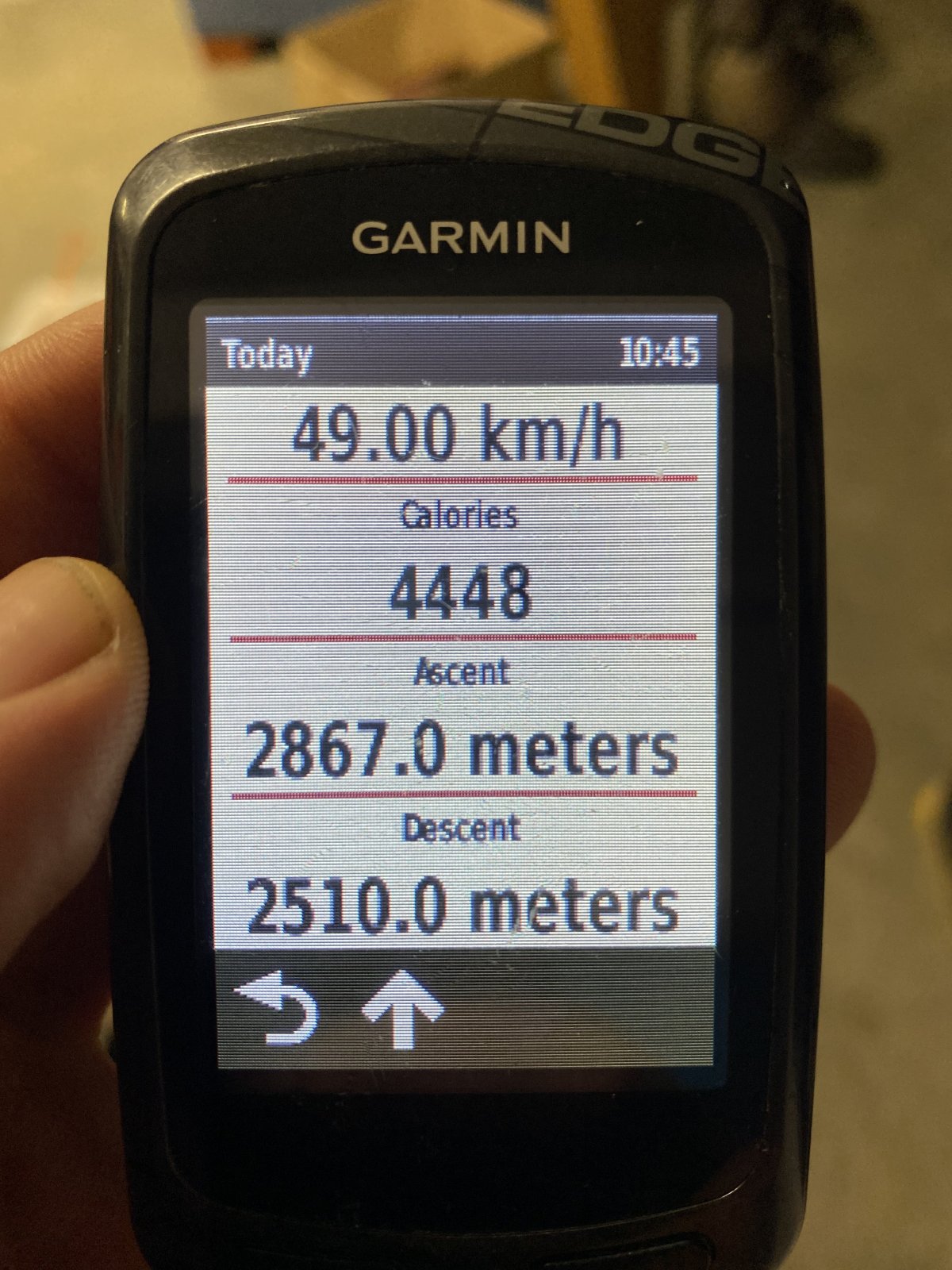

Thought I’d chime in. I’ve had an orbea rise for 4 months now. I would say I’m in strong cardio shape. People are as fit as me uphill, and people are faster, but I’m always pretty surprised and impressed by it. My wife is a strong rider and a very fit lady, but the ebike almost quantifies our differences in output. She has the same bike and I typically ride about 2 out of 10 power levels higher than her to go the same speed, and get about 20% more range than she would.
Just getting back from a trip, my battery completely died doing 28 miles and 5800 vert in power 2/10 mode 80% of the time 4/10 mode 20% of the time. My wife got 4500 vert in 4/10 mode and 6/10 mode.
Did a 3800 18 mile ride today in power mode 4/10 and just ended up in the red on the battery.
My wife did the same ride in power 6/10 and her battery was basically dead.
I basically set up my power profile based on the ride I’m doing and where I think I can ride and have ample battery to get it done.
For me that’s 6000 in 2/10, 5000 in 4/10, 4000 in 6/10 and 3000 in 8/10. This is rough estimate, I think 7/10 is actually the highest turbo mode I’ve set with full 60nm output.
And my wife would be about 20% less than that. The takeaway is that for rides that are long enough that battery is a concern, the power mode you ride in 80% of the time makes a big difference, and the amount of power you’re adding makes a huge difference. I ride my ebike like my regular bike, and I put a similar amount of power as if I was on my regular bike.
