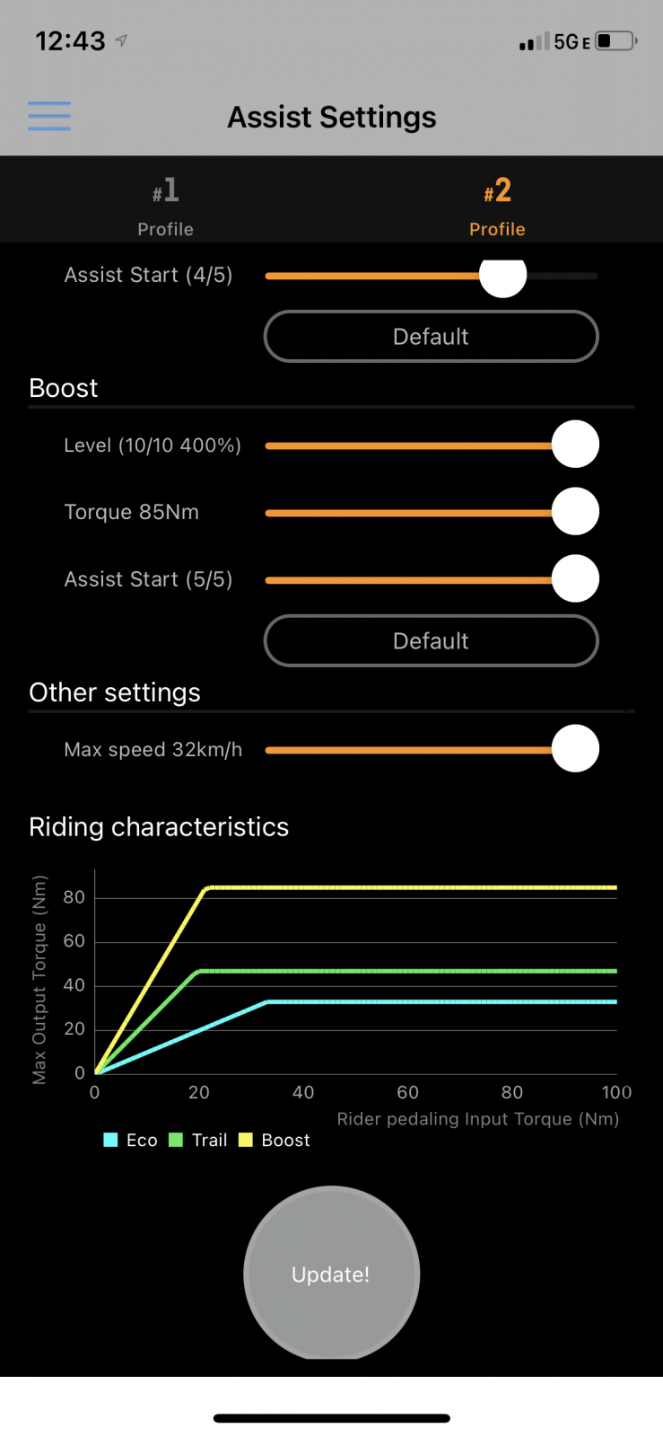

Not sure if anyone’s mentioned this yet but ST Unlocker app seems to allow upping torque to “full power” aka 85nm torque. I haven’t actually tried it myself yet though!
This might be something I might use later in life but the trails I have ridden so far (North Carolina, Georgia and Florida) i have not had the need for the 60nm but a few times and I am only in mediocre shape and 57...
I'm no electrical engineer so take this with a grain of salt but can the smaller battery found in the rise tolerate the higher amp draw required to run at 85nm or will you be cutting the battery life short?

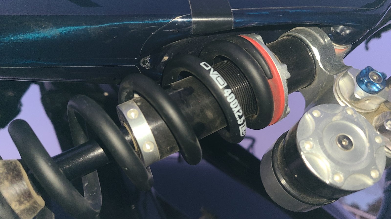

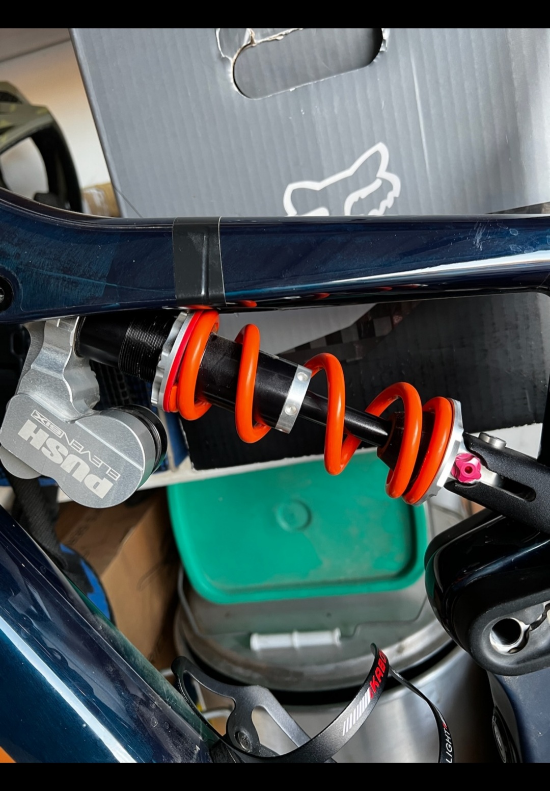

My friend converted his M10 Medium to mullet setup based on users feedback on this forum for a couple weeks now.
Front Fork Fox 36 160mm / Rear Shock Plush Coil 160mm = 216x63mm (8.5x2.5) with one offset bushing (tail).
In the past couple rides, he started to hear some weird friction noise below the frame when going over some bumps - not all the time - and so did I when I took the bike for a ride. So we looked closer and found that the rear shock coil has come into contact with the frame when the rear frame triangle compresses and has left some marks under the top tube. We are a bit concerned as wondering if it would cause any damage to the carbon frame.
Anybody has experienced with this issue and how would you resolve it?
FYI there isn't enough clearance to fit an offset bushing on the head of a Manitou Mara Pro shock (maybe 1mm clear static).
Tried to fit a 216x63 with two offset bushings. I was trying to run 160/160 29er keeping the HA and STA in check with stock, static BB would raise a bit, but once sagged would be close to stock. No go, so I just kept the single bushing in the tail. Paired it with my Mezzer up front and we will see how she goes.
So my friend added an offset bushing at the top along with a FOX SLS coil and the clearance (visually) seems to be better compared to before... see pic attached. Now let's see how it would perform on the trails...

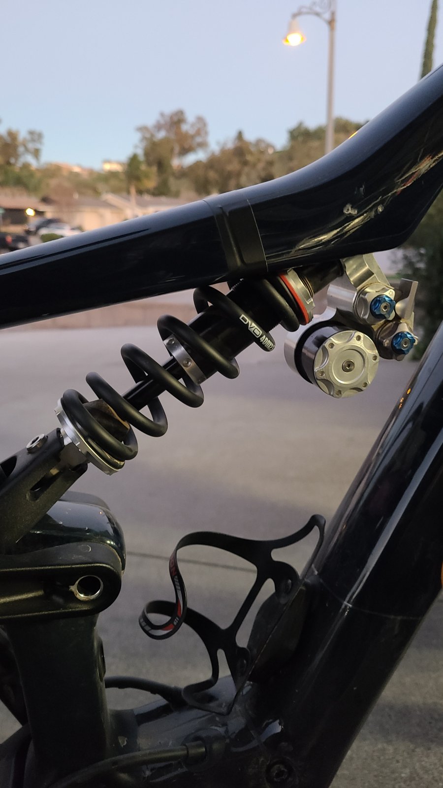

If anyone wants to try out 160mm travel, I'm selling my coil shock setup. Worked great for me, but I'm selling my Rise and going back to non-e-bike.
It does NOT have the rub issues pictured above, on my large frame.
