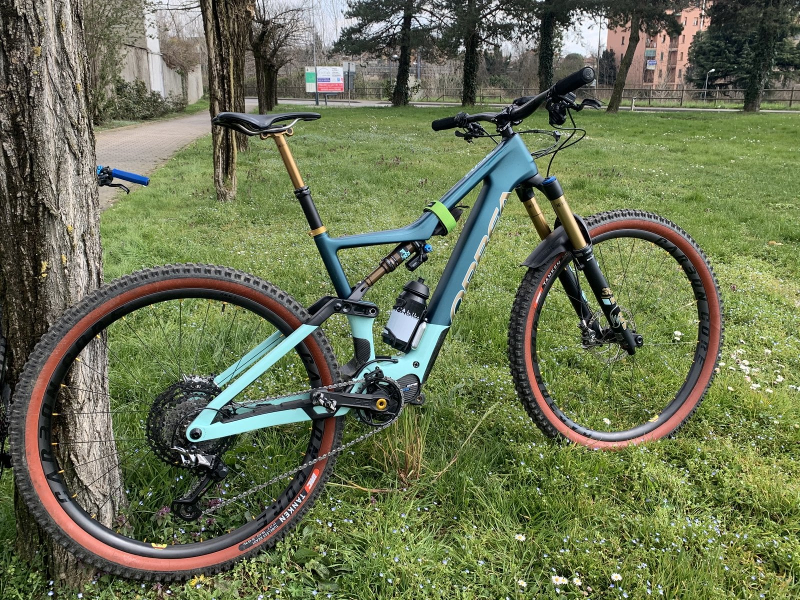

Orbea Rise Custom M10
Just saw these in person for the first time yesterday. Looks very much fit to be ridden like a regular MTB. I'm very glad to have my Wild with a potentially ridiculous amount of battery power/range on tap, but I can really see the appeal of this.
SLX Cassette sticks out like a sore thumb on an otherwise very blinggy build.
First thing I’d do is up the fork to 160mm and change the shock out from a 210x55 to 216x63 and run the Bike as a Mullet setup which gives you approx 162mm out back.

Had mine a month in UK South East. Was in stock at ebikeshop, so drove over and fetched it. Only Rise they had, XL, in white. They said they had a delayed shipment due if I wanted to wait for more colours etc, but I care little for aesthetics.
I'm 6'4", and it fits very well. I run 85psi and only a touch of compression and rebound. I've some more volume spacers at the ready as I want the plushness for the trail, but don't want to run out of travel for the dropoffs. Haven't tried them yet.
Fitted a Hope 220mm front disc, as the 180 up front wasn't cutting it. £50 and 5minute job. 221g including adapter Vs 123g for 180mm Galfer. I'm happy with that tradeoff.
Deathgrips is my only other tweak.
Links to my Garmin edge (clunky setup) so no extra display needed as I always take the Garmin.
That ep8 rattle - yes it's there if you're looking for it, and if mine were the only bike making that noise, maybe it would bother me, but if it's 'by design', it's soon forgotten.
On my home scales my M10 with standard tyres and pedals weighs 19.4kg. But I wouldn't swear by my home scales.
Standard tyres are ok enough for British winter, my winter tyres are with ebikeshop who will post them when the range extender arrives. However, as the trails dry, these lighter tyres are doing better. I'm no expert though, and I don't ride that hard and the trails have few square edges and sharp rocks.
Those with this bike on order, honestly, this bike is stunning and I am smiling and whooping all the way through the trails like a mad man, it's the ultimate cheat. A MTB with all the boring hard work bits removed.
I also ride with my analogue mates, and this works very well, quiet motor when alongside for climbs and for challenging you to work a little harder yourself.

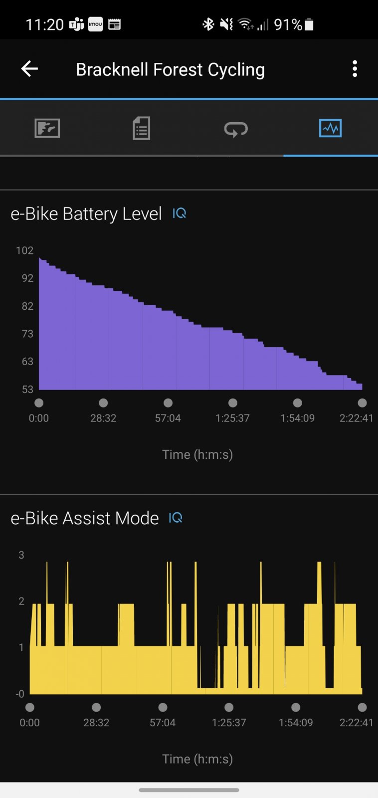

One thing I didn't mention that is questioned a lot is range. I hear a lot of Youtube reviewers demanding from manufacturers bigger and bigger batteries, and that obviously comes at a significant weight penalty. Clearly the goal is to have 'just enough' juice for every ride.
Here's my experience:
I weigh 75KG kitted up. 6'4" on XL. Bike is an M10. I live in the UK and ride muddy trails, hills and forests, not jump parks. I like to head out on it for an hour during the week for a blast, and then do 2-3hrs on the odd weekend on trails with friends. Most important for me is that the bike is light and fun and 'poppy'.
An hours heavy blast of 13km will cost me 30% of my inbuilt battery if I boost through the hills to get to the fun stuff and keep boosting back to the top a jump run. Gloopy mud. That is the highest usage.
25km for 2 hours (moving time) at Swinley trail park, riding with an analogue mate (thus slower) used 45% of main battery. Also, as you can see from the chart, sometimes I'm riding with the motor off. That is probably the key benefit of lightweight ebikes - The impact of a flat battery is not nearly as significant - It's not as if you're stranded. What will inevitably happen for the huge rides is as your anxiety for running out of juice increases, you'll put more effort in and increase the range.
I have the range extender on order, and thus could theoretically get 7h+ riding in a day, which is more than enough for me. I imagine riding with FF ebikes would dent that range significantly.
So for me, I'm very glad to only have a 360wh. In fact, I'd be happy if it were a touch smaller and can only imagine needing that range extender for those rare mammoth days. Also, the range extenders I've heard are compact and only 1.4kg or so and £450 in UK. Seems pretty reasonable to have a second in a rucksack if you're frequently traversing the Scottish highlands in a day.
Just my use-case, and hopefully useful to others wondering about range.
Key for graph:
3-Boost
2-Trail
1-Eco
Below 1 - Off
