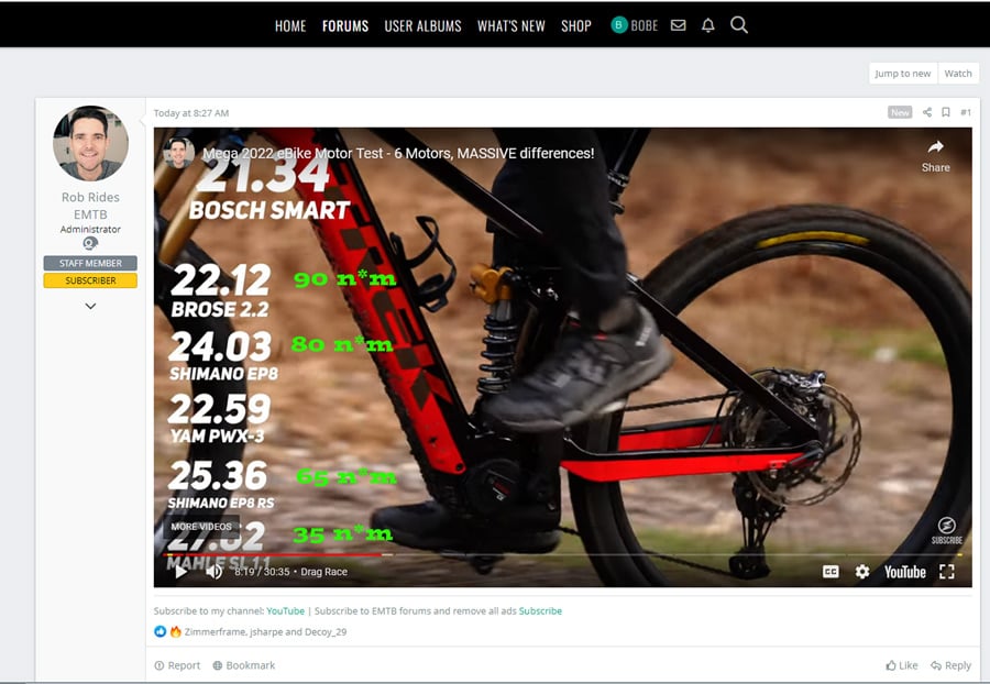

If the Levo SL is truly discontinued it is a victim of marketing, not poor design. Like the automotive horsepower wars we are in a newton-meter war and selling the least powerful e-bike is not a winning strategy. It is not that 35 n*m is insufficient, it is in most cases. Take a look at the motor test numbers in the image.
Going from 35 to 65 n*m gets us less than 10% gain! Someone is measuring torque differently of just plain fudging the numbers. 80 n*m starts to show improvement but still little more than 10% faster. Finally at 90 n*m we see some real gains, almost 20%.
