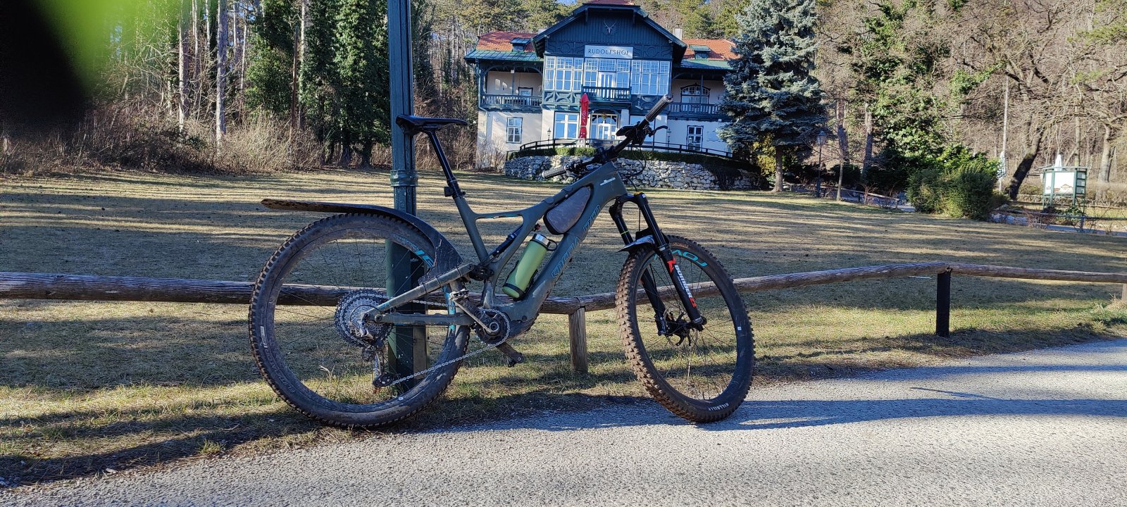

Looking at changing my forks to Lyrik Ultimate 160mm. The 42mm offset is cheaper than the 51mm. Is there going to be much difference by going this route or best sticking to 51mm?
Current SL is the last Specialized 29" trail bike with old/longer offset. Definitely get the 42mm offset. It won't make any dramatic difference, but the increased trail will provide additional traction and calmer steering.
Levo SL can only benefit from that in my opinion and having ridden my wife's SL with ZEB fork, it rides fantastically :- ).
thx for sharing your experiences.
yesterday there was a warmer day, about 10 degress, and it seems i have a different fork.
the harshness on small bumps has reduced so significantly that I will not change to the Z1 coil.
so thank you everybody for sharing your opinions and experinces with 51/44.
one final thought for 160mm. if for some other reason
I will change fork I dont think I go for 160mm.
the seat angle of the levo is not the steepest, so I think with flatting the angle
I will loose more of pedalling comfort and effeciency than I can gain from another 10mm on the front in the downhills.
one year later and after a couple of cold harsh rides i decided to switch to the Z1 coil.
I just mounted it, switched the coil to xtrafirm an give it try.
AMAZING.
uphil and downhill is going so much better.
I dont know what it is specifically, but 36 instead of 34, 44 offset instead of 51, coil instead of air,
it just works for me. so happy i finally changed it.

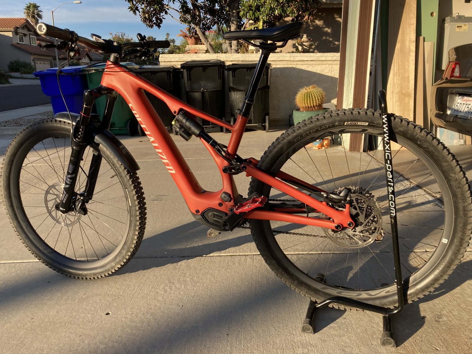

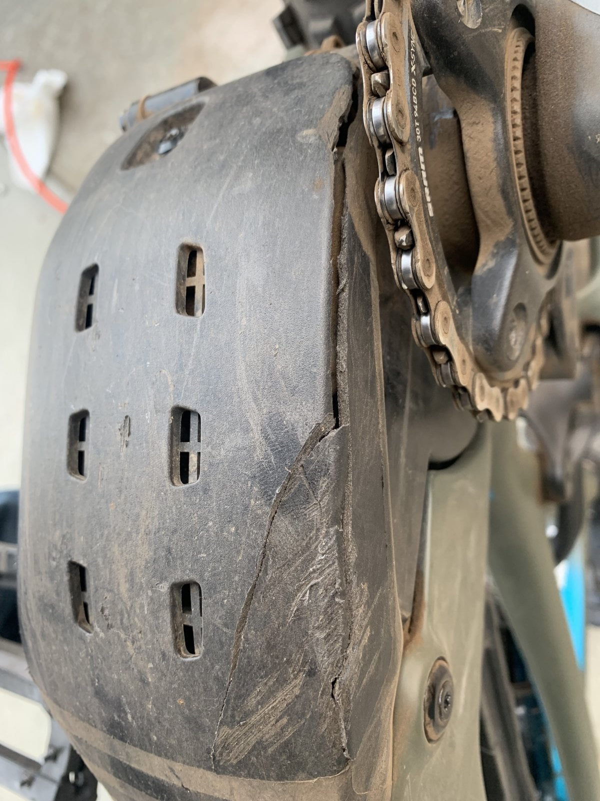

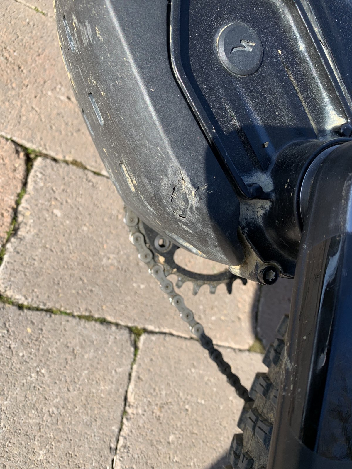

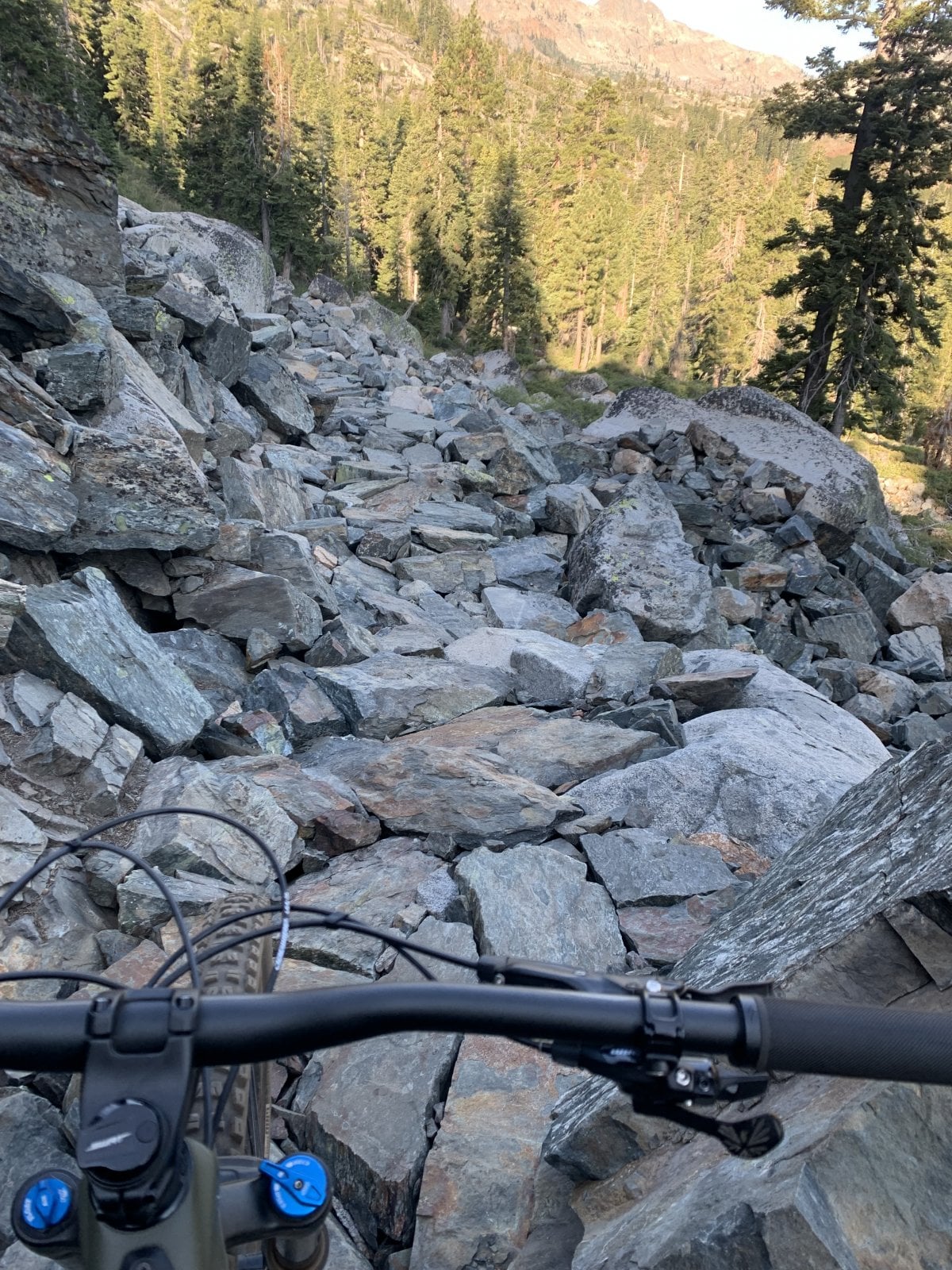

I have a 2020 SL Expert, and I ride some rocky terrain (new fav trail pic) and have cracked my bash guard (aka rock guard).
I'm looking at replacement options... weighing between just get a Spesh OEM replacment, or there are a couple aftermarket metal guards. I'm tempted to go aftermarket metal, but I'm wondering if anyone here has run one longer term and how it has gone. It occurs to me that the design of the OEM version might be semi-fragile on purpose.... meaning, breaking it is part of the design to keep the frame safe, vs having something unbreakable and transferring the shock energy to the bolt holes or elsewhere. or maybe I'm over thinking it. :)
thoughts?
Did you replace it? I'm in the same issue

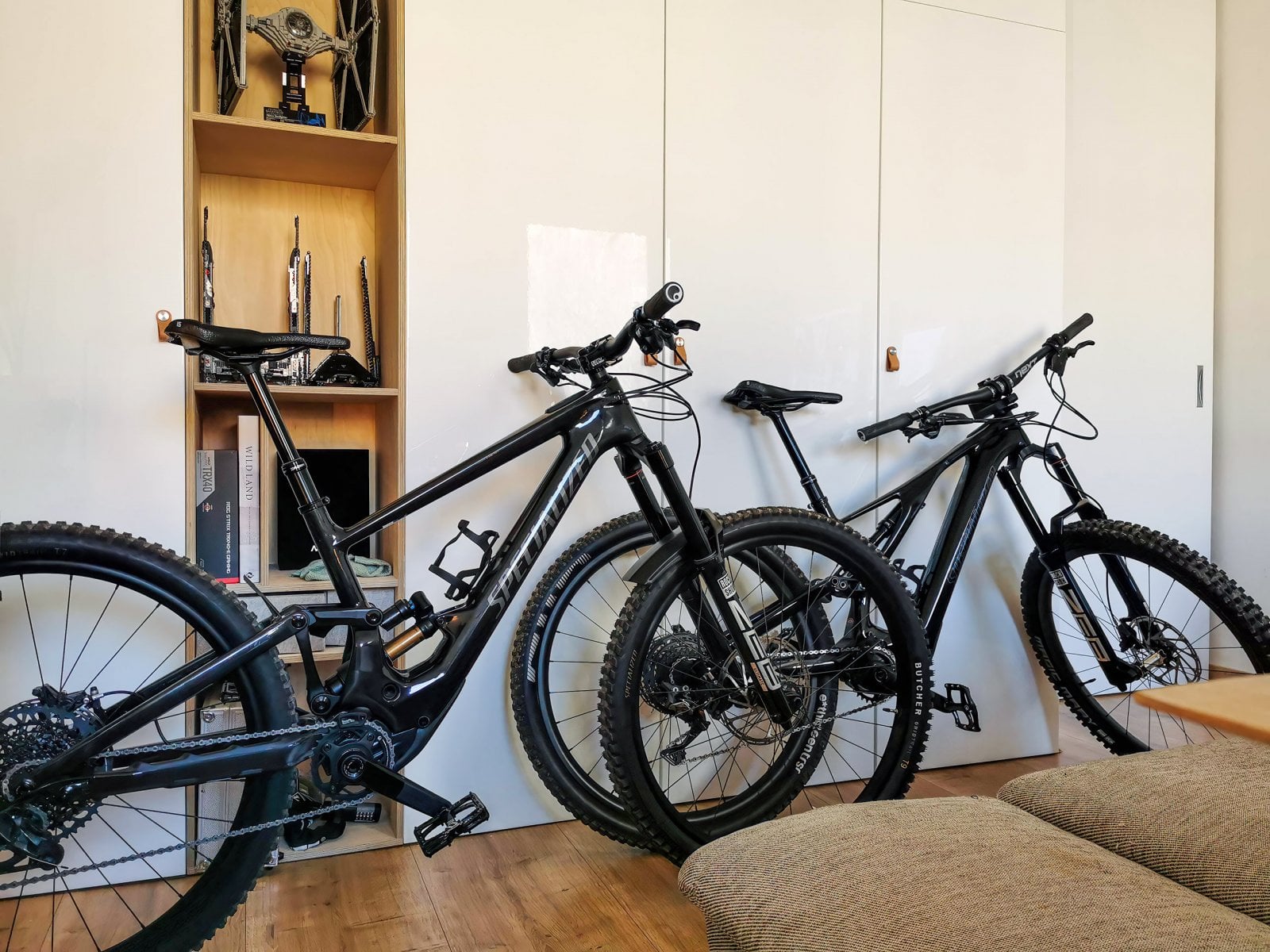

Love it ! Tell more, what sizes are these? Medium both? Standard shock size, BB flipchip in which position?
Any chance you could photograph one of them with seat up?
I actually put 170mm for on wife's LevoSL as well as instead of KSL wanted overall lighter bike for her.
I am debating mulleting it as well, but the seat angle might become issue, although the seat can be slided pretty far forward to offset it partially (it negates roughly 2 degrees).
Yes, they are both medium. My wife an I are almost the same height 5'7-8" but she has longer legs. The shocks are 210x55. I run a Cascade link on mine. The flip chip is set on High. IMHO, mulletting the bikes have made them more maneuverable on the predominantly techy type trails we ride. I have ridden mine on every double black trail in the Whistler Bike Park and on a variety of trails throughout BC without issue. We care more about riding down hill than riding up hill so the seat angle is not that important to us. Besides, my wife can kick my ass riding up any climbing trail we have around here and she says its the nicest climbing bike she has ridden (ok, maybe its the motor ;)). She is in her early 50s and I am turning 60 so your experience may vary!

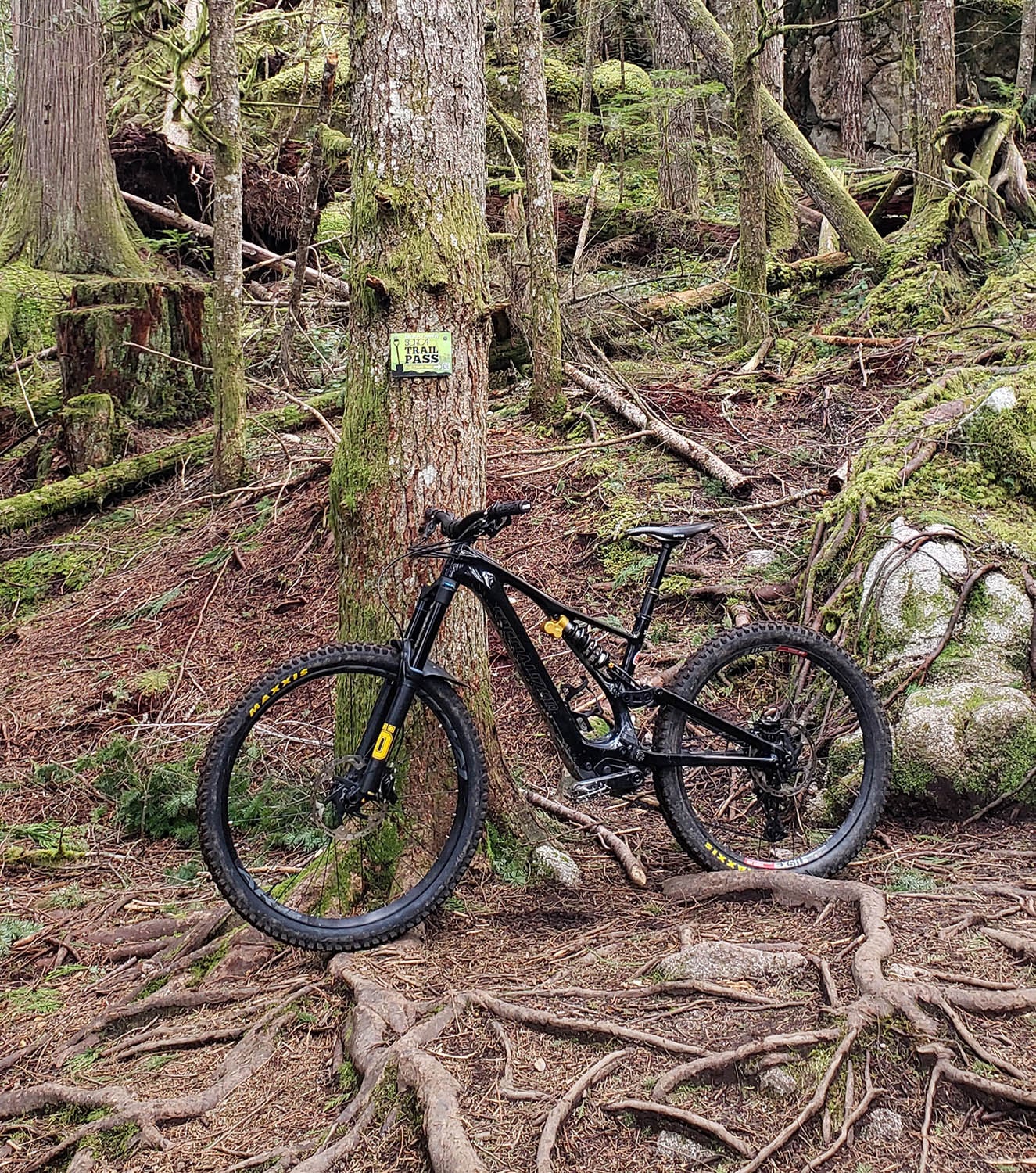

Where we ride:
Ok that's really nice riding and very inspiring. You guys are the age of my dad and also my wife's parents and I wish they would be active like this. We give them all the support in regards to bikes but to much avail. I will keep showing them your video for the rest of the year. You
You will love the KSL when it comes. I had one for few months, same as LevoSL for my wife. At first I thought of doing two KSLs, but despite the KSL being better in every single way almost, the lower weight of SL and more nimbleness in the end proved to be better choice for my wife who isn't such a hardcore rider. With similar builds except shock, the KSL is 20KG and SL 18KG. Sounds about right and my wife says it's the best bike she ever had, and the happyness she has every time she goes for ride is insane :- ).

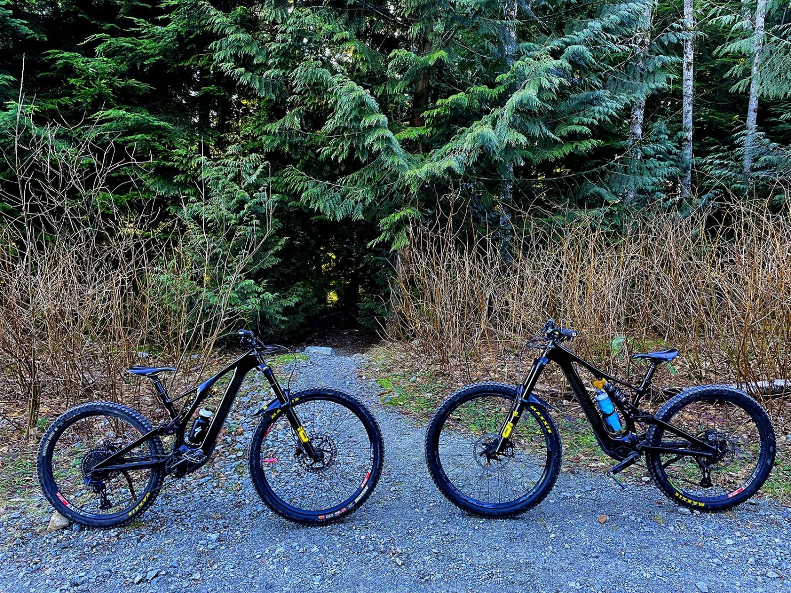

Our 'stealth' builds. No mud because recovering from Omicron (despite booster in December). Not enough energy to run up the stairs :- /.

Where we ride:
So does running the flip chip on high give you additional clearance when the shock is bottomed out? In my case I didn't want more than 66 deg fork angles either so I am in the low flip chip setting if I understand this correctly. In checking my 2021 sl expert carbon I found that I barely had 2 mm of clearance before their was contact with my 210x55mm DVO shock (using this instead of the 210x52.5mm dpx2), which would lead to the frame cracking on a very hard bottoming hit IMO. The DVO has a bottoming 0-ring too and so in checking it I had my shock travel limited to about 51mm and it was very close, adequate but not enough to go another 2.5mm, too close to risk damaging a very expensive frame for 2.5mm of shock travel so I installed the spacer to limit travel and 52.5mm and sleep better at night, lol.
Very nice! I think the best thing in the my life is getting to ride with my wife. We are both very fortunate men! You; however, are in the luckiest category by finding two black bikes. The only Kenevo SL they will send to Canada with be the crappy white and grey color version. I may have to bring out a can of spray paint, if it ever arrives! Happy trails!

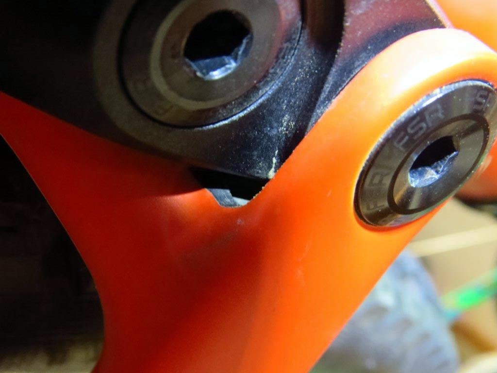

Well seems to me it would only take one unexpected hard hit to crack a frame. And we all know how "unexpected" things just seem to happen on mtn bikes right? I have bottomed out the shock or nearly so off of some smaller jumps and while tuning with a volume spacer might reduce that possibility (I did add one to the DVO after that) I think with the std components Specialized must have had this in mind limiting the shock travel to 52.5mm. Like me I trust they are engineers that design things for a reason.
And the pics don't lie, lol. I was not able to slide a 2.5mm hex wrench into that gap and 2mm barely fit. It's a very good spot for a crack to initiate too by the looks of the machining done there. Maybe I'll take the volume spacer out of the DVO one day and run it down to close to 55mm just to take a pic of that. But is the minor gain is worth the risk to the $10K+ bike? But I do wonder how others were getting around this. I think the Casade link (they only talk about results with 52.5mm travel) and flip chip on high is one way probably but would love to see a similar pic of how close it gets. I'm sure you've checked that. The reverse mullet setup will also mitigate the less slack resulting from putting the flip chip on high too.
And while I don't go crazy on downhills I do the drops, rocky technical section and faster riding of my younger partners with a bit more caution on loose SoCal downhills. I started riding at age 68 but rode Observed Trials back in the 70's for at least 3-4 years so those skills allowed me to progress pretty fast...too fast for my own good I think and broke my collar bone, 2 ribs and my shoulder blade on one of those stupid unexpected crashes that should never have happened. So I now know I am mortal and ride accordingly to live to ride another day rather than surf the recliner for 3-5 months healing up.

While I agree that things can happen at any time while riding an mtb, these bikes are designed to take hard hits and with properly set up suspension and proper technique, one should be able to land off of any 3-4' drop without feeling anything. Altho I try to avoid dropping to flat, over 4', as I too consider myself "older and wiser" with a multitude of ongoing injuries. It sounds like you know a enough about bike setup to consider increasing your HSC if you are bottoming out that often on high shaft speed impacts. When I had an air shock, I was using 2 volume spacers. Much can be said for proper technique which we can all benefit from working on, at any age. Personally, I switch between two drop techniques as listed below. I much prefer steep tech but the second drop in my video is over 5 feet to flat and I didn't feel a thing. YMMV. Know your limit, ride within it!
and everyone's favorite Pinkbike instructor:
My first jump trail of the year:
So there's the key in my opinion, the bike was designed for a 210x52.5mm shock and it shows. I was very careful to check first seeing so many using the 55mm travel. I suppose it's unlikely you will bottom it completely but the possibility is there from what I can tell.
My issue is more of trying to use full travel or close to it given my weight and riding. My Focus was so progressive after mid stroke that there was just no way to use that last 10-12mm even on the hardest intentional hit. I think I'm getting closer with the DVO and found that their newer bladder design allows me to lower the bladder pressure below 170 to 150 psi. The Spec feels much more controlled and pretty linear which so far is working out for me. The Focus wallowed a bit thru mid stroke but this Spec doesn't and really isolates things like wash board surfaces so well. I am using my Lyrik Ultimate instead of the fox 36 grip2 but they both worked well.
Like I said, Your Milage May Vary on the setup, the type of trail you enjoy riding and your level of expectations as to the capabilities of the bike. I didn't like the linear feel of the stock rear suspension so I upgraded to the Cascade Link. I don't like the maintenance costs of air shocks and like the feel of coil shocks so I went with the Ohlins. In the end, I waiting for a Kenevo SL to show up, which I think has a much better suspension setup, but it weighs more. First World problems;) Happy trails!
