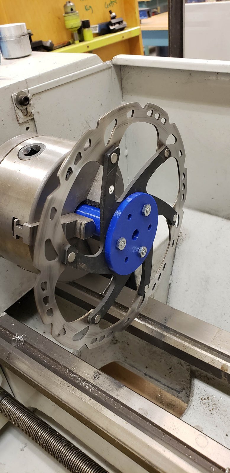

I hope you get more ride time with your resin pads than I ever did! If my metallic pads are glazed, I lap them using 400 grit sand paper and blow them off with compressed air. After spinning my rear wheel on the bike for what seemed an eternity, I 3D printed a rotor holder to deglaze my Shimano rotors on a lathe. If you look closely, you can see all the grooves from using metallic pads. Something has to give and the rotors are only going to shave off only so much of the brake pad, especially if they are metal. Hmmm, maybe the shaving of the pads is causing the noise as it is way louder when they are wet. :unsure:
Nice set up. Yeah metallic can be louder and probably wear out the rotors faster. In wet there is no getting around the noise. I bedded my front brake again and while it still noisy it's mostly the intermittent scraping noise I get on light actuation that I don't like. Maybe still a stuck piston? They do not align easily either. But I'm going to continue to use them to see if harder braking levels things and also how long they wear. Is there a good alternative to SRAM that less expensive and organic that is available?

While the sram centerline rotors are supposedly designed to be quiet, I was surprise how easy it is during cleaning with brake cleaner and a blue towel to turn them into a tuning fork. They literally sing and resonate without much effort. I put my fingers at the 5 of the 6 bolts and was able to dampen this sound...maybe a few small snap on 3d parts here would quiet them a bit? The Shimano rotors don't have this characteristic.

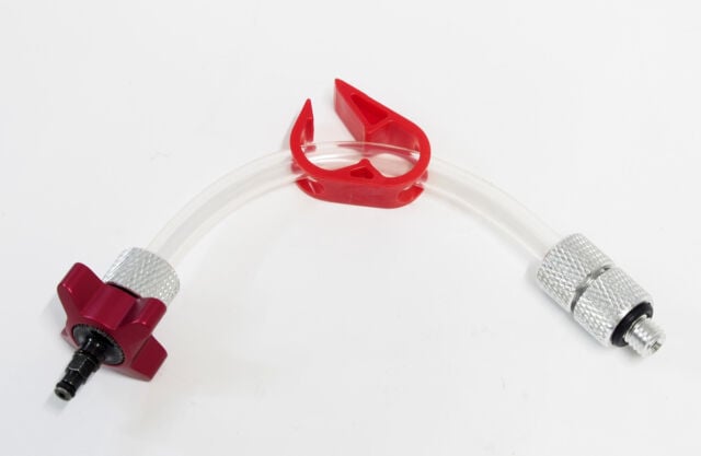

I was going to ask if you had tried to isolate one of the pistons and squeeze the brake lever gently to get the sticky one to behave but you answered that. In the past, I have modified a bleed block to do this by isolating only one piston at a time, its easy to get a stuck piston moving, unless its REALLY jammed, then you have to take it apart and clean it out. I have only every had to do that once. I don't ride on wet gritty trails all that often so a piston getting stuck is pretty uncommon. One one of my bikes, I have run the same Code RSCs for almost 10 years. I use pliers to snap the hose clamps onto the bleed tubes syringes. I am not hurting my fingers for nothing! I usually pull the syringes back around 5-10 times for maybe 10 seconds at a time to get rid bubbles. You will never get rid of ALL of the tiny bubbles. You are supposed to use a new bottle of brake fluid every time as Dot 5 will absorb air if the bottle is opened. Then again, I usually just do a lever brake bleed and not a full bleed if my brakes feel off. I hope you are happy with the Code RSC brakes. The pad contact adjustment dial is what made me switch to Codes from Saints in the first place. I use rubbing alcohol to clean off my rotors. I switched to Shimano IceTech rotors years ago.

Lever bleed did the trick.

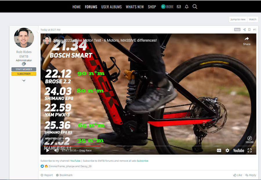

If the Levo SL is truly discontinued it is a victim of marketing, not poor design. Like the automotive horsepower wars we are in a newton-meter war and selling the least powerful e-bike is not a winning strategy. It is not that 35 n*m is insufficient, it is in most cases. Take a look at the motor test numbers in the image.
Going from 35 to 65 n*m gets us less than 10% gain! Someone is measuring torque differently of just plain fudging the numbers. 80 n*m starts to show improvement but still little more than 10% faster. Finally at 90 n*m we see some real gains, almost 20%.

I agree on the marketing, though - if they advertised it as 230 w , the magazines would be talking about 10 % power vs 25 % weight loss!

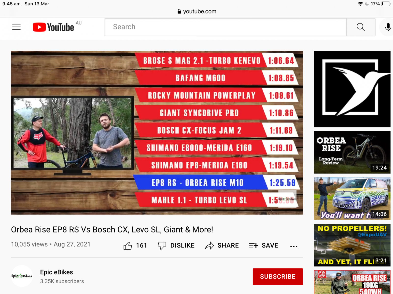

BTW, the real gap between motors is even closer than that video suggests - he's comparing a 170 mm to 130 mm bike climbing!
From another climb test ( and a non assisted bike took 3.22) -
