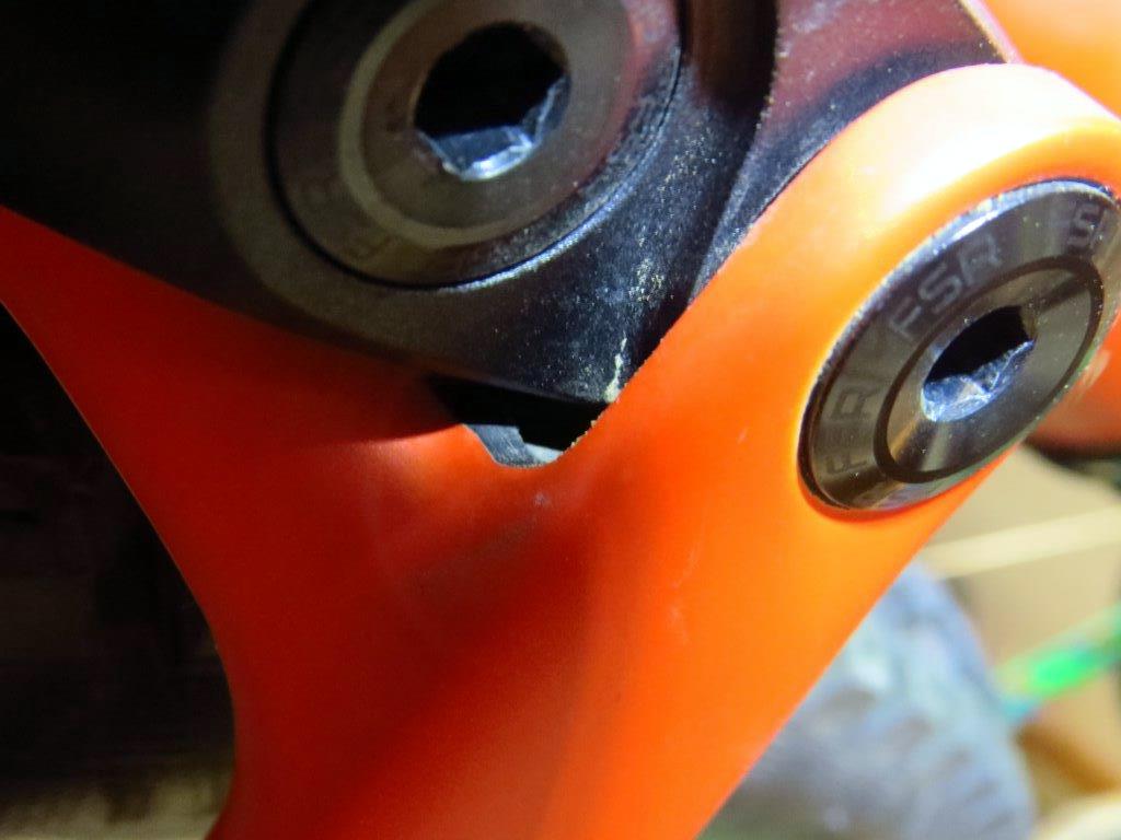

This is after drilling out the cage mounting holes a bit to lower it a little, I'm going to make a bracket to get it a bit lower yet if I can, but it seems like there is sufficient room, it is tight though.

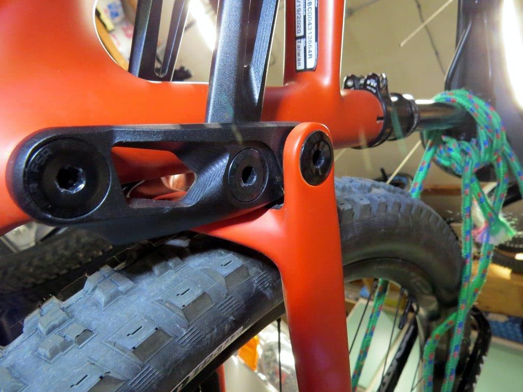

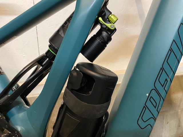

I had my first ride using the Lyrik Ultimate and DVO Topaz and the correct aluminum wheels. The dealer even thru in a hg-1295 cassette although it's 500% not the stock 520% but still very light. I would say it's very comparable to the stock Fox 36 Grip2 and Dpx2. I did have some issues getting full travel out of the DVO with 30% sag.
I ran it with one positive and one negative volume spacer. I also made my own 2.5mm travel spacer from a 5mm travel spacer (sine 2.5mm is on B.O.) since 210x55mm seems to come just too close to hitting (yoke to frame). I may be too conservative on this but better safe than a cracked frame. While the travel spacer doesn't go in the positive volume space of the DVO I think it might be reducing the overall internal volume enough to affect the progressive nature of the shock. I'm running 170 psi and weigh 145 lbs plus gear with 170 psi in the bladder. Anyone out there using the DVO Topaz T3 on the SL care to comment?
The included pics show about how much clearance there is with the 210x52.5mm DVO shock bottomed out. This is about 2.5 mm clearance, which is why I didn't want to risk using a 210x55mm. Flip chip is in the low position. Thanks

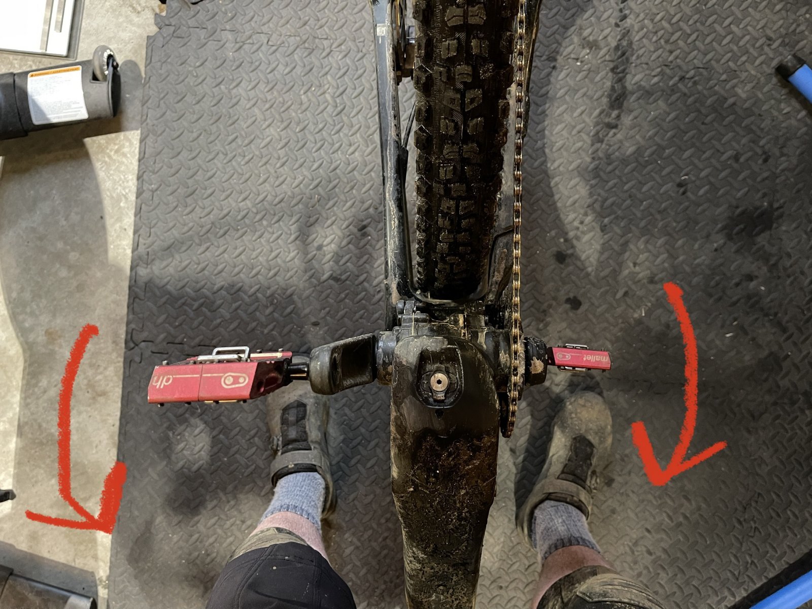

Anyone ever hear of a bent SL crank/motor spindle?
On my 3rd set of alloy Praxis cranks (warranty… they’ve been great about it) and just realized the this newest set of crank arms feels bent right out of the gate.
It’s not the pedals - cross checked those on my other bike.
There’s a healthy about of huck to flat in my zone, but never bent a pedal or crankset before the KSL. Pedaling with a bent setup is starting to graduate from annoyance to a real pain in my knees so definitely want to get this sorted.
