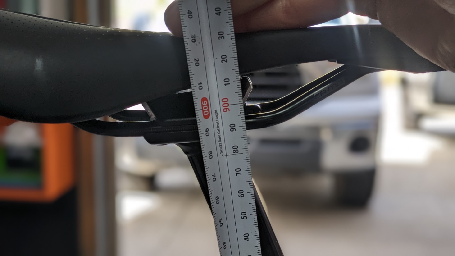

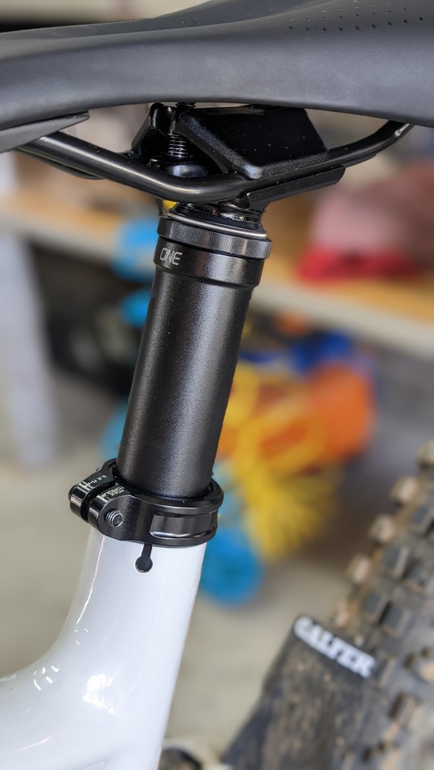

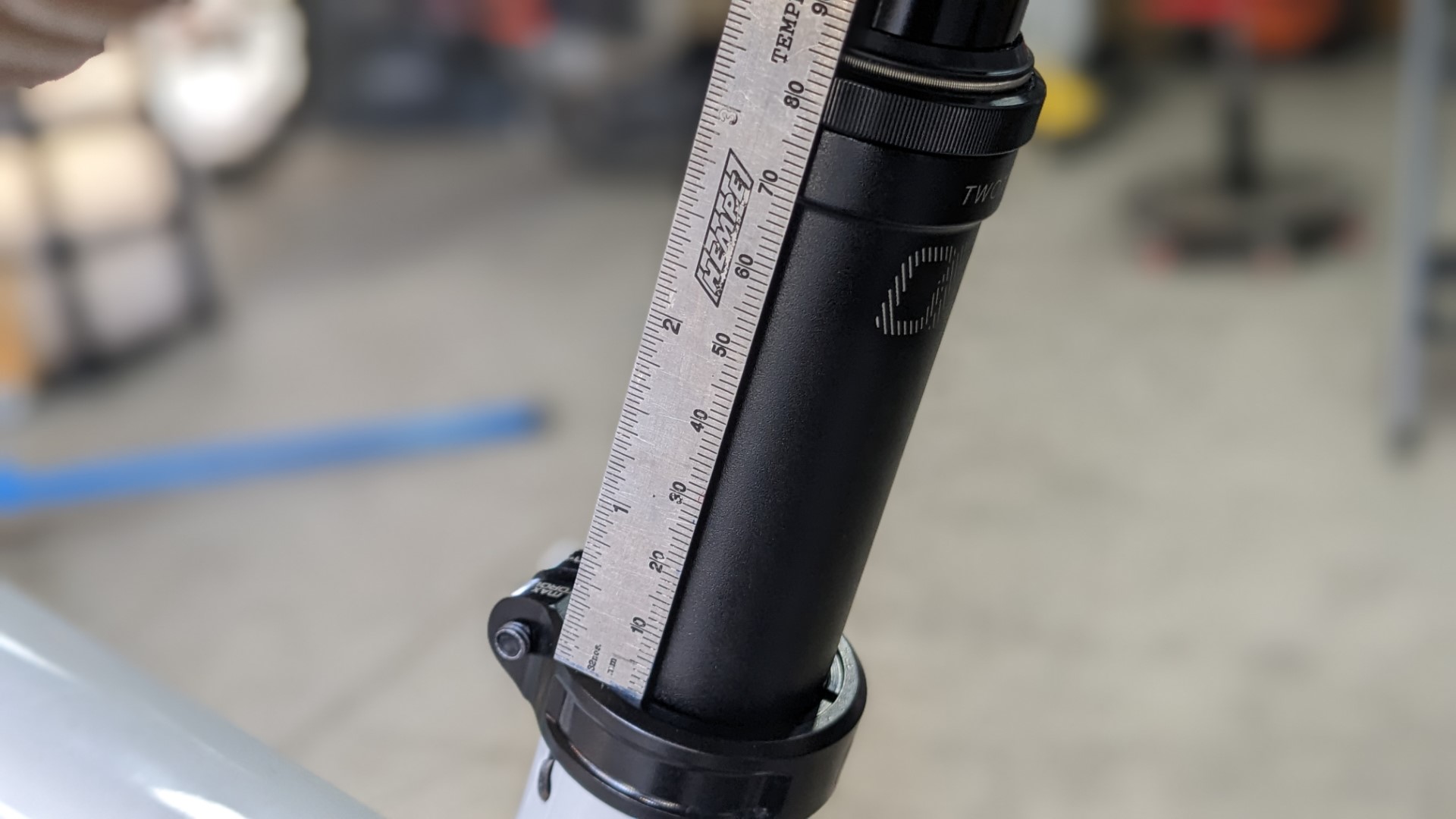

Howdy, been lurking here for 10 days now reading over this thread since just getting an expert s4... great info here!
Just wanted to throw my .02 cents in for droppers even tho its been heavily discussed.
I'm exactly 6' (183cm) with I think a 32" (81cm) inseam on an S4.
After buying 3 different droppers on pinkbike this last week I've settled on the Oneup dropper 210mm 31.6mm shimmed down to 190mm. The 31.6mm probably doesn't matter much even though someone said it squishes down a tiny bit further, I just get them that size cause they fit all my other bikes.
Slammed the dropper sits 68mm out of the seat tube, not ideal but very manageable. The oneup was better than the PNW 200mm because of the shorter overall length mainly stack height. I think I had to shim the PNW down to 180mm. And from flat pedal at lowest point to seat rails was 893mm which turned out to be perfect pedal position and still low enough to be happy with descending.

@jacksonj51 You give me hope that I can run my spare 210mm OneUp. I pick up my SL next week and figured I'd have to order a 180 to get by. I'm anxious to give a shimmed 210 a go.
I just ordered a 180mm 1up based on the mathes I put in their calculator with my current setup. I went with the 34.9 though.. I don't think the smaller ones can handle the weight on the bike stand. I'm 6'3" with about a 34 inseam. I don't mind if there is an inch or so hanging out.. right now, with standard is about 2.5 ins with a 175mm.
