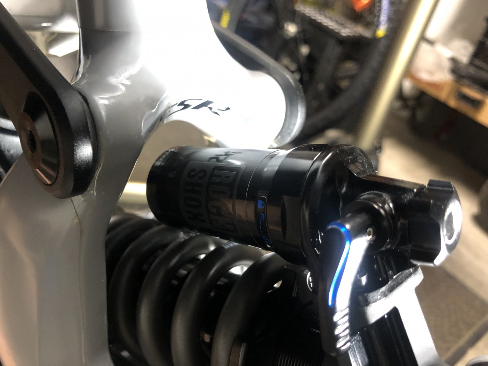

Sad news. A RockShox Super Deluxe Coil does not fit the KSL.
The reservoir is just a few mm too long for the top of the shock tunnel during deep compression.
Lucky I added RideWrap there.
I also tried it the other way around but the LSC knob hits the linkage plate.
Oh well. Now we know.
Bummer ?
