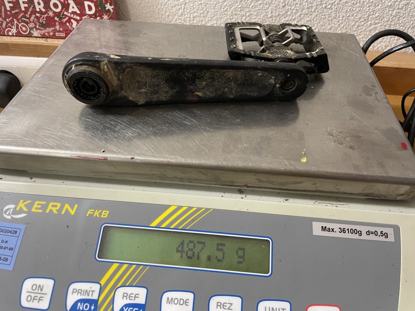

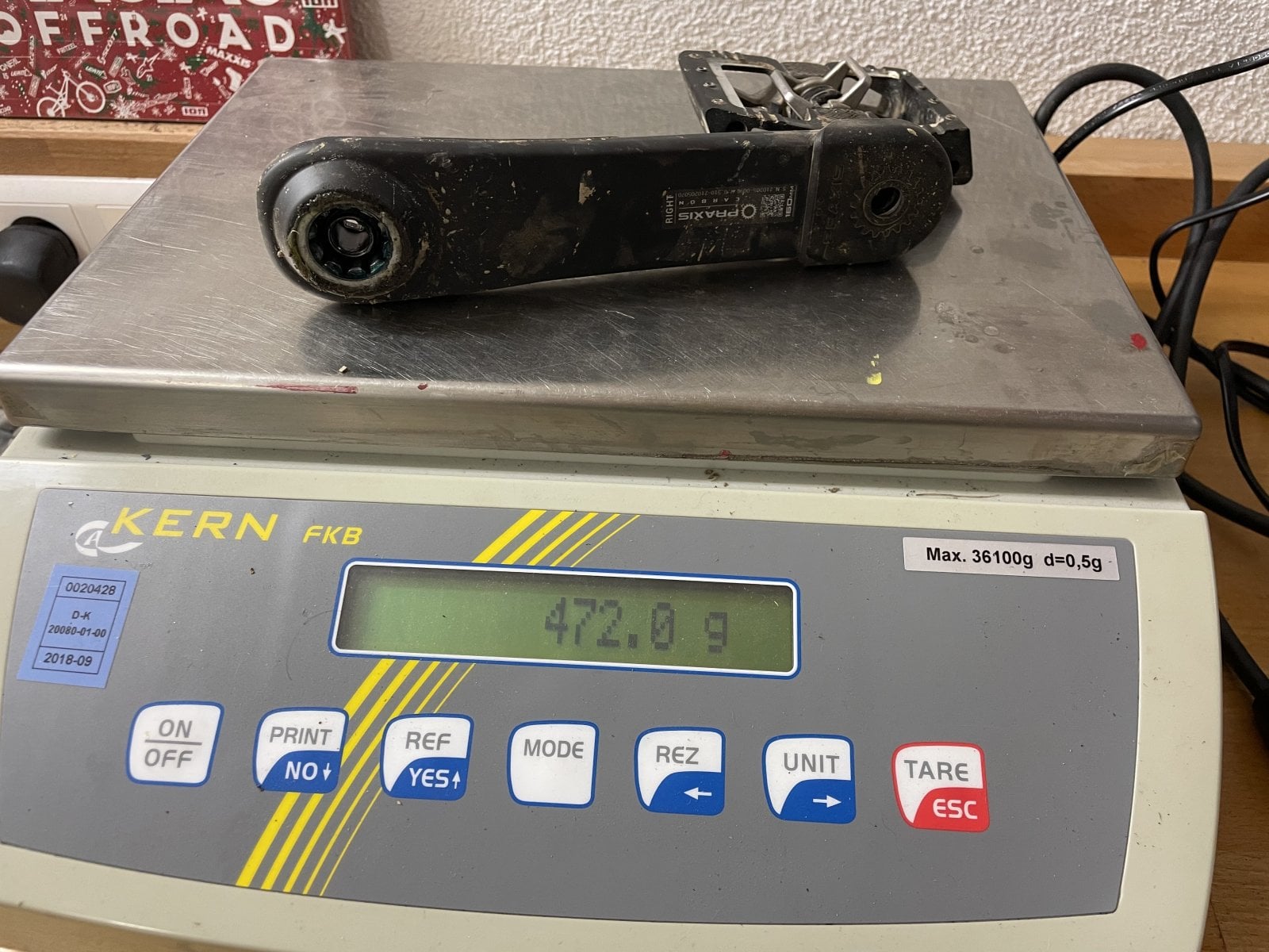

The many threads with cracked crankarms and the actual huck-testresult drove me to swap my carbon cranks from my Levo22 SW to Alloy.
I weighed the right crankarm. 165mm Alloy from Ken22 only weights 15gr. more than the 160mm from Lev22 :oops: (if same pedals have no weight tolerances)
So for me: No chance for carbon cranks !

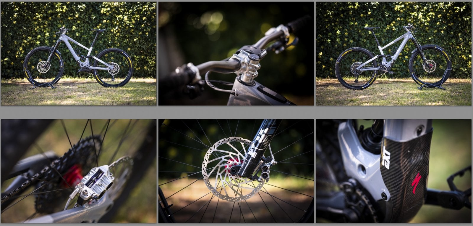

It's not an EXT piece, it's only a carbon motor protection by Rockguardz. EXT logo is only a sticker! :)
I see, funny. Looks intriguing :)
