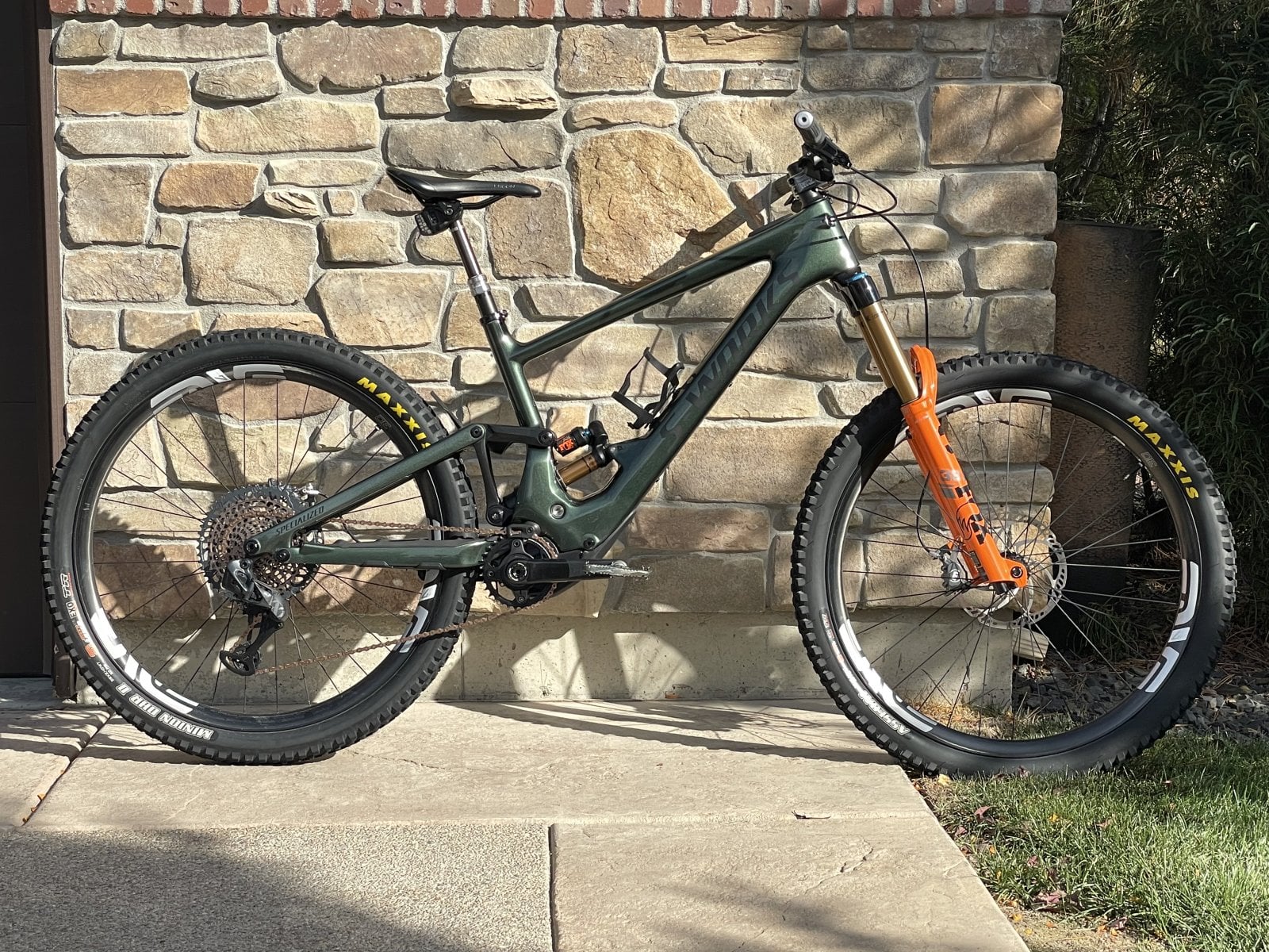

With aluminum crank swap 😂
And my previous build. Let me know if you want to grab this green frame.

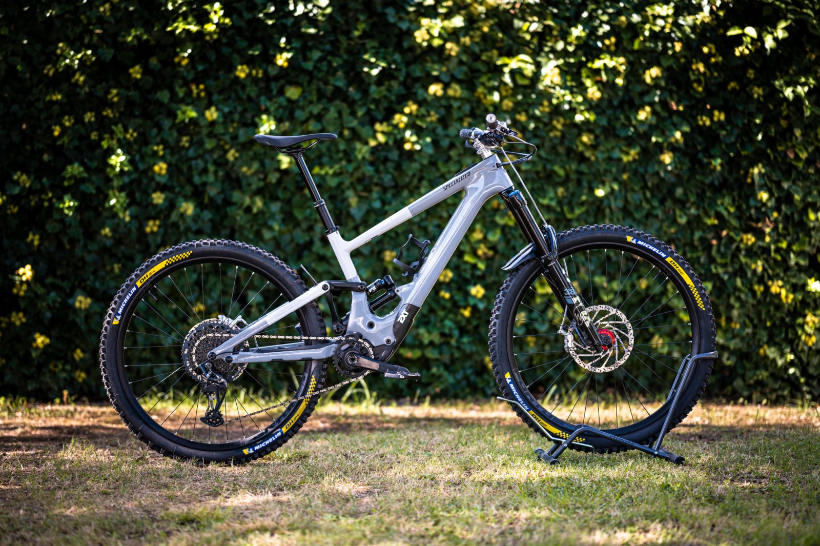

what size did you choose?
I’m 5’9, 176cm. Before purchasing my Sworks frame I had hard times to pick between S2 & S3. Size chart puts me on S3, but GEO number says S2 would suit better for my riding style. In the end I went for S3, simply because I couldn’t get S2 from any of my local dealer without huge lead time. It turns out S3 fits me very well with a 35stem. It’s longest bike I have ever ride but it didn’t feel that way. Very nimble and poppy. I’m happy with it. So whilst the numbers looked it’s a huge bike once it’s start rolling it’s prefect, the faster you go the smaller it feels. I would say go with what the size chart recommends.
The spring is the original EXT and the lenght is choose from Ext calculated on my weight and characteristics.
My EXT is 230x62.5

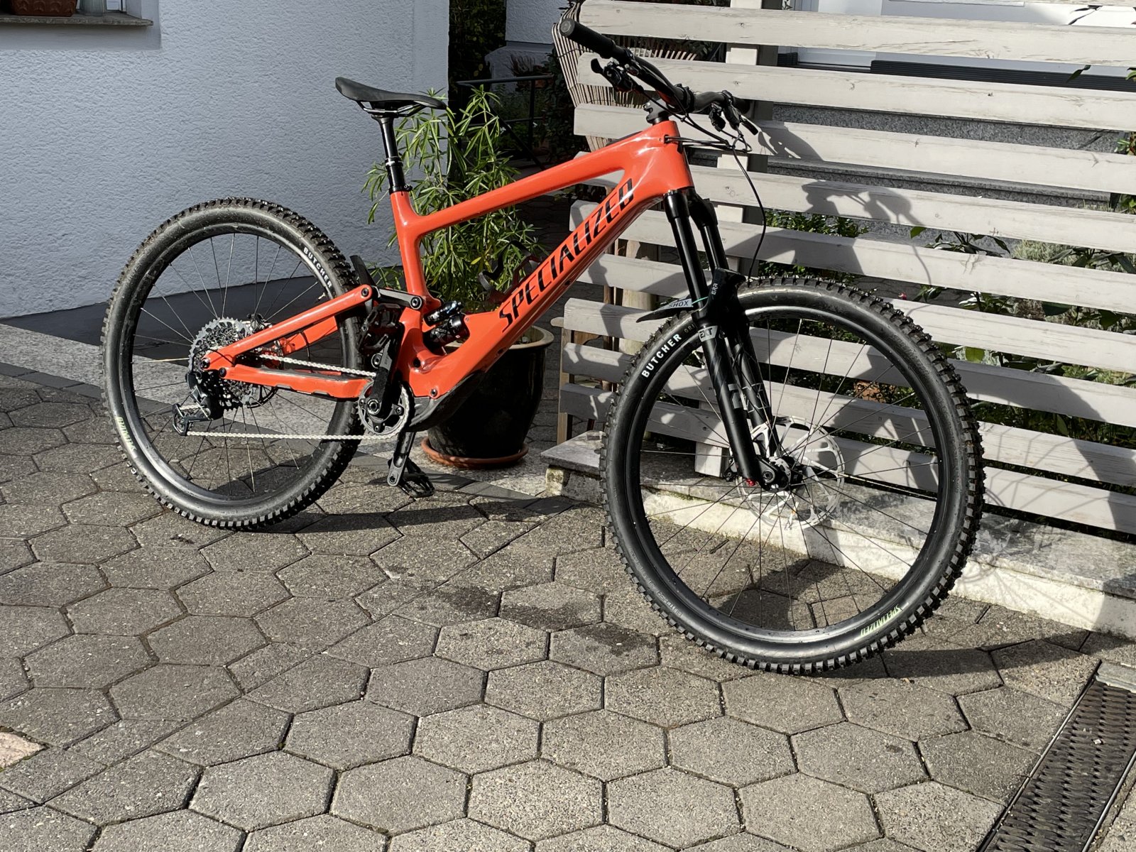

Hi Members,
since Friday happy owner of a KSL. What a nice bike. It is a S5, which fits perfectly to my 1,93 height, first improvement is a new EXT Era Fork.

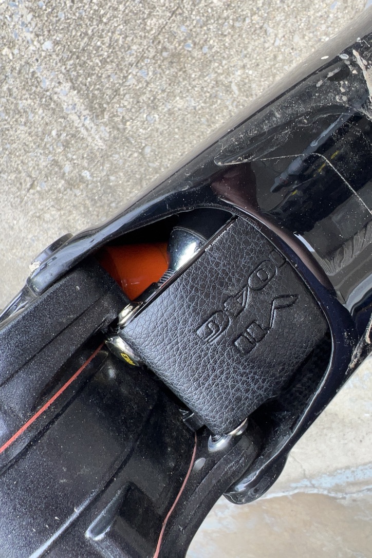

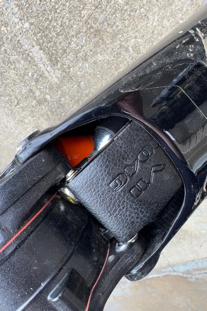

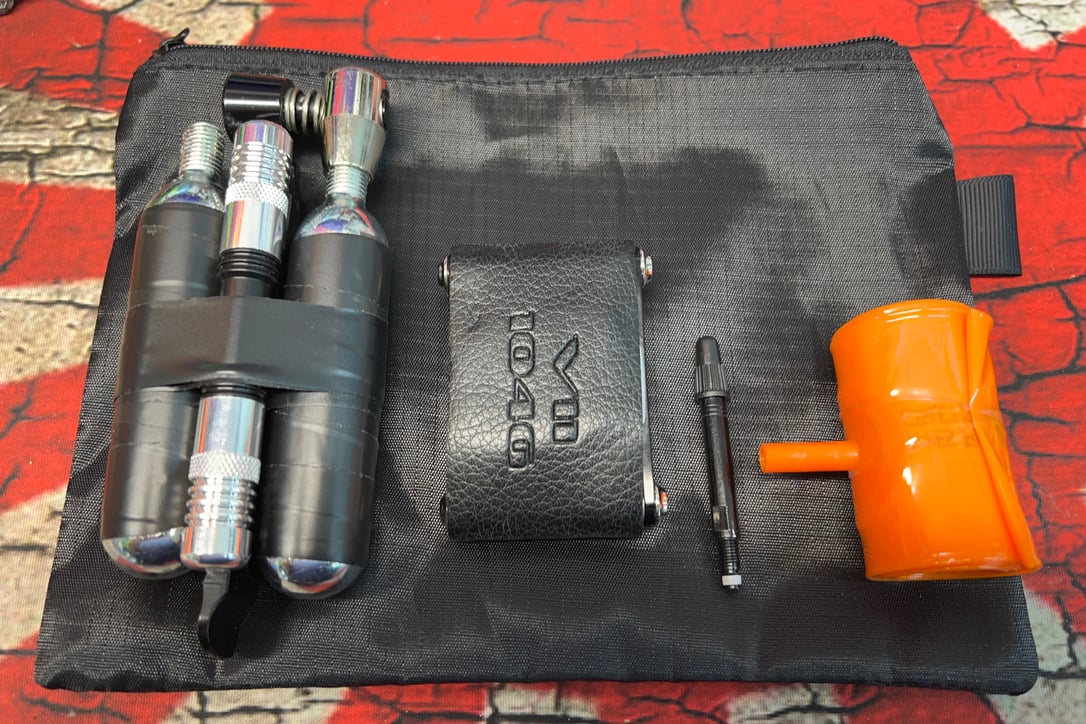

I’m trying to get away from the heavy backpack and really don’t want to strap stuff to my frame and scratch it all up over time.
So I present to you....
The Prison Pocket
:ROFLMAO:
I wasn't able to use the nylon ripstop bag, also was only able to fit one co2 cartridge, but this will work.
The Prison Pocket
:ROFLMAO:
Looks good! Did you make the holder or is it available somewhere
First day on my KSL, right away in a bikepark. This bike really rips. Rides like an Enduro, maybe even a little bit more poppy and more planted on the trail and on jumps. Blown away how well it pedals up without motor support. Not a big difference to a heavier enduro rigg.
Will be selling my raspberry S-Works Enduro frame. I freckin love this frame but don’t see the reason for keeping the Enduro next to the KSL.
BTW, does anybody know what´s the best way to shorten the mode shifter cable? Just stick it more into the frame? Is there a proven solution to this problem?
Which holder, the black bag? The co2, Racer Dynaplug, Wolftooth Pack Pliers are just taped together with electrical tape.

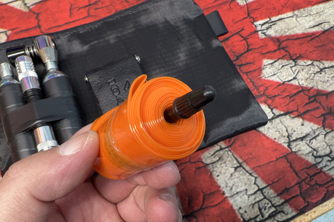

That Tubolito is very impressive! I rarely puncture bad enough to have to throw a tube in on any of my bikes, so I think I'll replace the regular tubes with these in my seat bag on my gavel bike and XC bike just to save some weight and space.
If you find the Tubolito's useful as backup, then I'd recommend trying the Aerothan tubes from Schwalbe - they are the same idea but higher quality and more reliable when you need them. I've had several Tubolito's fail on first use, whereas the Aerothan's have been faultless so far!
Thanks for the info, I'll keep that in mind.
