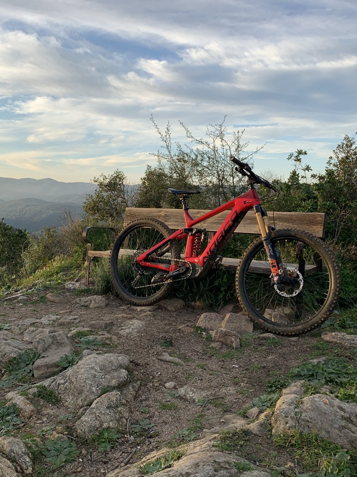

Damn That fork really pops. How is the shock going comparing to the stock one? I’ve owned a diamond before and loved that but never one of their shocks. Is it shock size too?
the shock is legit love how it has volume spacers and everything you need to fully customize to your liking

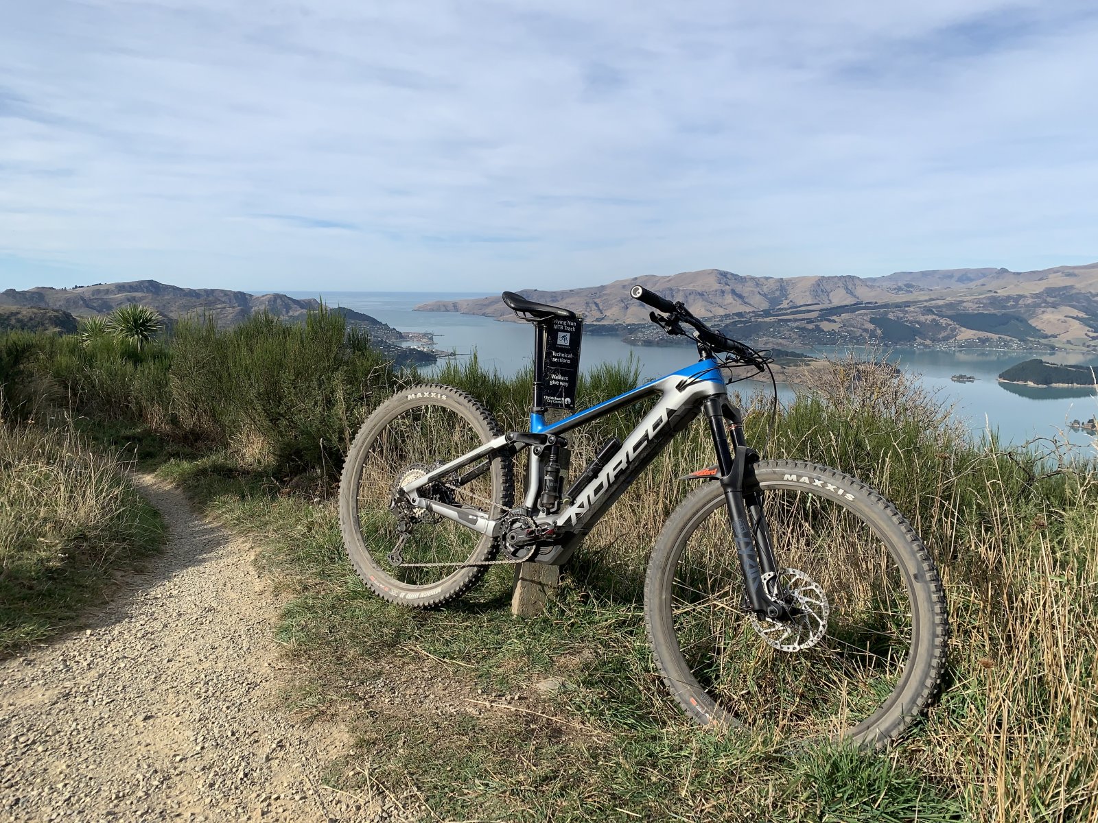

Picked up the Sight today, wow what a bike.
Straight off the bat I installed CushCore, riding in Christchurch NZ is quite rocky, bike has E13 rims which are made out of cheese, so wise investment.
Rode 36km, mix of eco / trail / boost, just getting a feel for the bike, finished up with 2 bars of battery left.
Thinking of upgrading the fork internals, the basic select Lyrik is fine but blows through it's travel fast.
The modern geometry on the new Norco's shines on the downhills, rode a mix of mellow flow right through to steep double black DH trails.
the sight ate it up no worries, great all rounder.
Off on a few more rides this weekend, might put up a youtube video for the hell of it.
shred on!!!

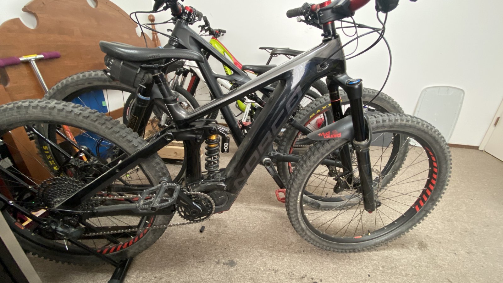

suspension upgrade:
fork Fox 36 float grip2 170 factory 2020
shock Fox dhx2 2 position, used, disassembled from knolly fugitive lt with nukeproof light spring 450lb
nice suspension set up upgrade. would you please share your experience with that set up please.. i am running a cane creek db coil shock with 500lbs spring and everything is great except bottoming out in 3feet drop or jumps.. please please let me know what spring works for you. im about 70kg in weight..
thank you

evilleView attachment 31372
Here running a Rock Shox Superdeluxe Ultimate coil and no worries on bottoming out.
Weighing 93 Kg and with 600lbs spring. On the other hand,I think it’s normal,bottoming out in 3 feet o more, mainly on drops
The vlt has very little progression built into the suspension......unfortunately. I heard the range and 29er now play better with coils
try the cane creek progressive spring. I put a mrp progressive on my vlt and it lessened bottom outs for me.
that is awesome to hear guys.. should i say 500lbs progressive spring then or 450-550lbs? im only 70kg in a good side?

thats good to hear.. i am thinking 450lbs-550lbs progressive spring from cane creek. do you think this will be good for my 70kg weight?
that sounds like a good spring weight to go with.
hi guys. i found a cane creek 550lbs spring and manage to try last weekend and it feels more support in everything i do but unfortunately still bottoms out in 3 foot drop.. so i decided to buy myself a cane creek progressive spring 500lbs-610lbs.. i let you guys know..

You need a progressive spring. The Sight isn’t designed for a Coil like the Range is so a progressive spring will fix (help) that
